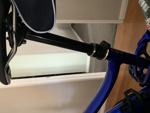

PNW Components 125mm Rainier. Medium Frame Stance. I have a 30 inch inseam. The housing is close to being bottomed out in the picture. This Post is better/smoother than my Specialized dropper.

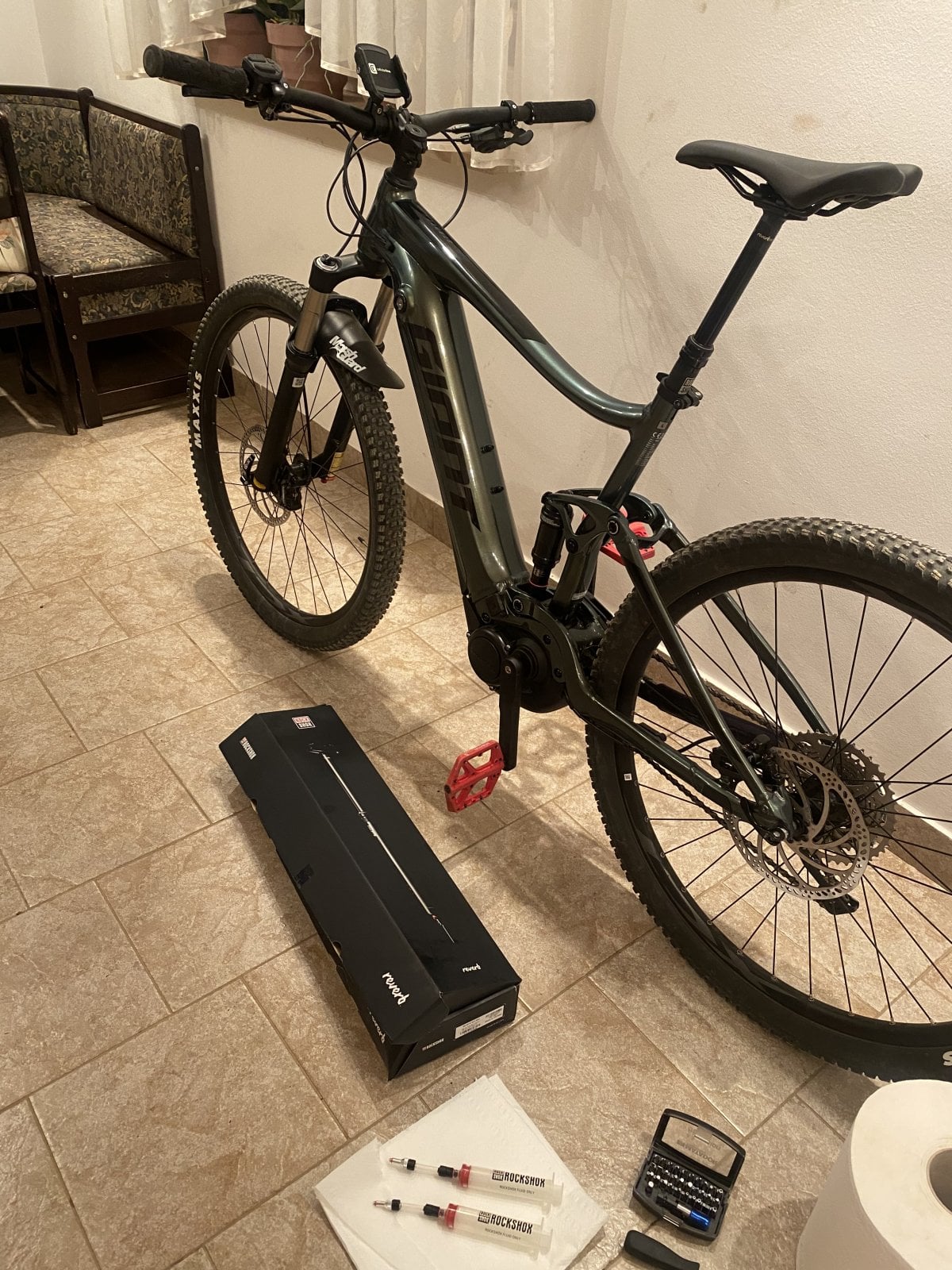

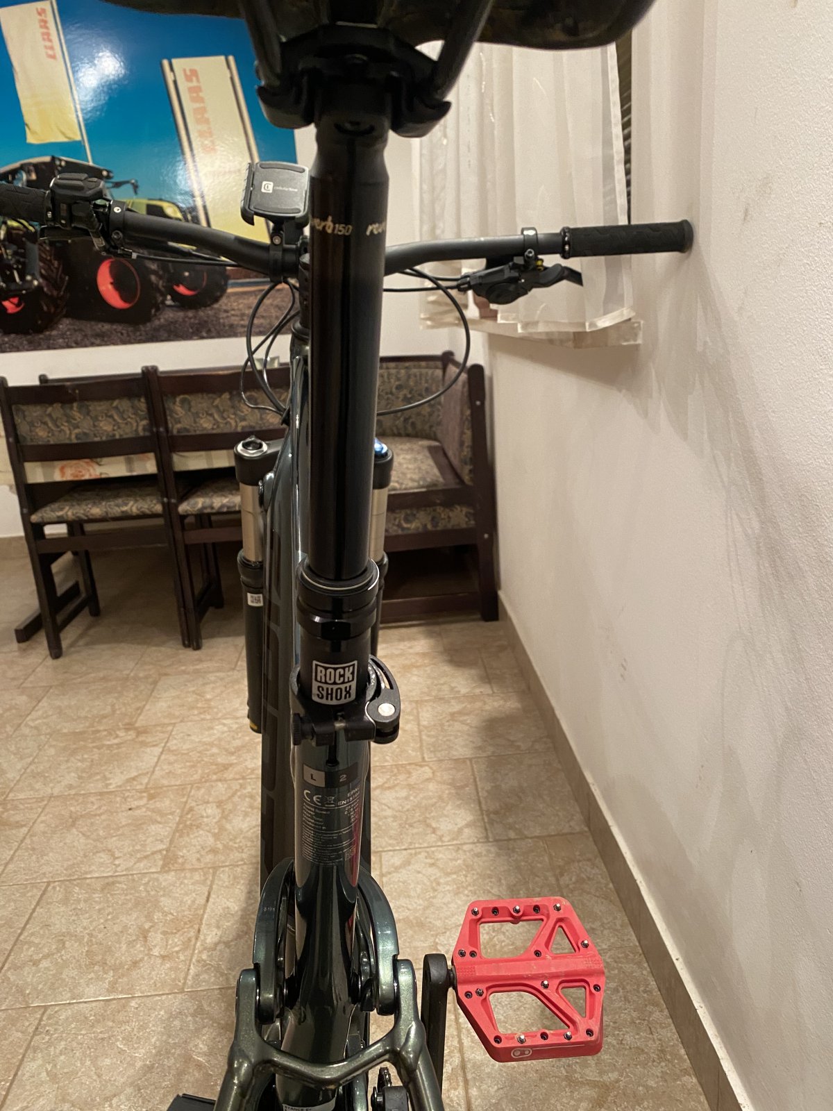

Installed Rockshock Reverb today on 2021 stace E+2. It took me and friend about hour and half with bleeding, had to remove motor mount bolts just to lover a motor a few centimeters then you just need a bit of nerves and luck
Fahrmecan
Aug 22, 2021
7
Slovenia
Its Large frame and im 192cm tall
I installed 414mm long post with 150mm travel, it fits great but if i were a few cm taller i would choose one with 175mm travel
