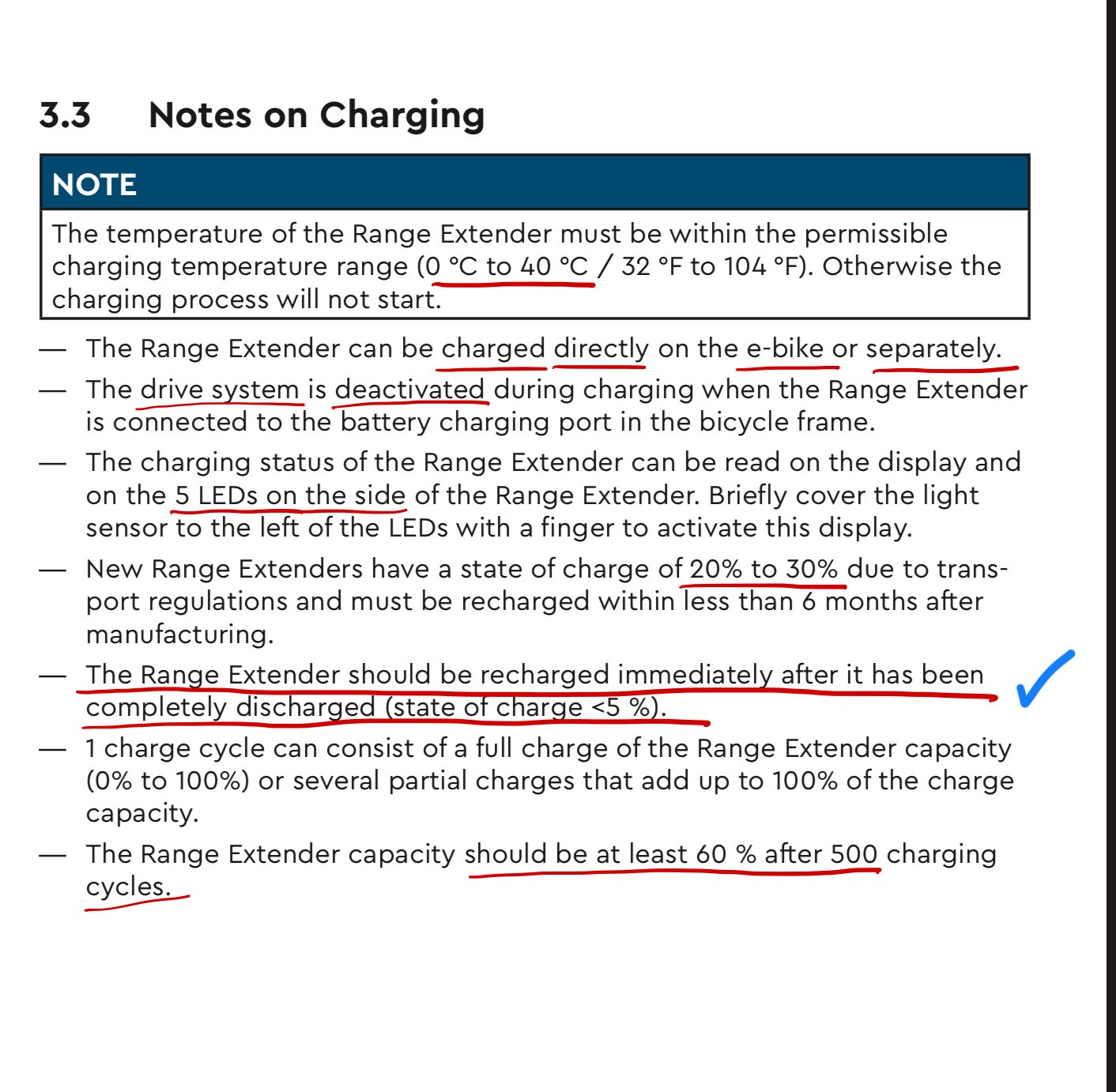

One question ; in TQ e-bike system , the e-bike use the range extender battery power first unit it comes to 0 % then switch to main battery so, which one is better to do,
1)connect the range extender when the main battery is discharged to less than 10%
2)The range extender battery to be connected to the e-bike permanently and charge it with main one together.
Maybe read the manual?

In the manual, it has mentioned that charge the range extender immediately when it reached to below 5% , since range extender discharged first then TQ drive switch to main battery, so it is strange.
