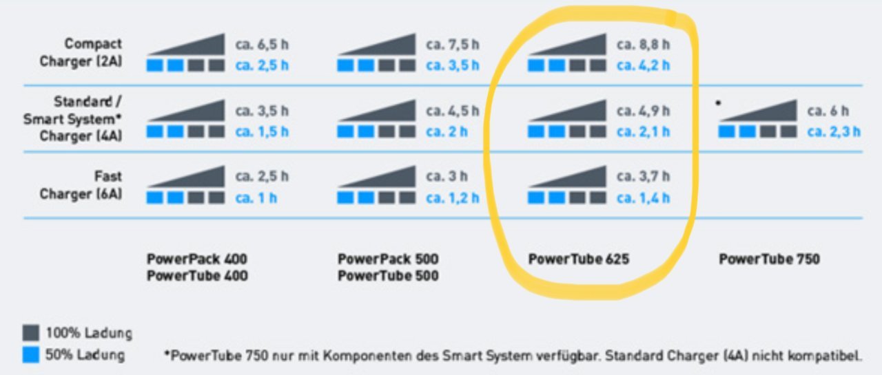

On the recharging topic, I saw that Bosch offers different charger types, a 2 Amp version (slow charge), a 4 Amp version (standard) and a 6 Amp version (fast charge).
Besides recharging time, are there any reasons to use one or the other? Is using a 2A charger better for the battery (maybe less heat generated) Conversely, should 6A chargers be avoided?
I suspect the main reason for introducing the faster chargers was to keep charging times reasonable with the introduction of 625 replacing 500w/h and now of course 750w/h. I have seen no reports a bout ideal charge rates but on the basis a larger battery is distributing the charge a cross a greater number of cells maybe the higher rate chargers are ok on the larger batteries.
I have a 2A charger available as it came with our Cube town e-bike. I must admit I've started using it as an alternative to the 4A quite a lot of the time for my Rail's 625 battery on the unscientific basis that slow charging is likely to cause less degradation. I also always leave the battery at about 50-60% until the day of a ride, and I'll bring the battery inside to charge when it's really cold.
