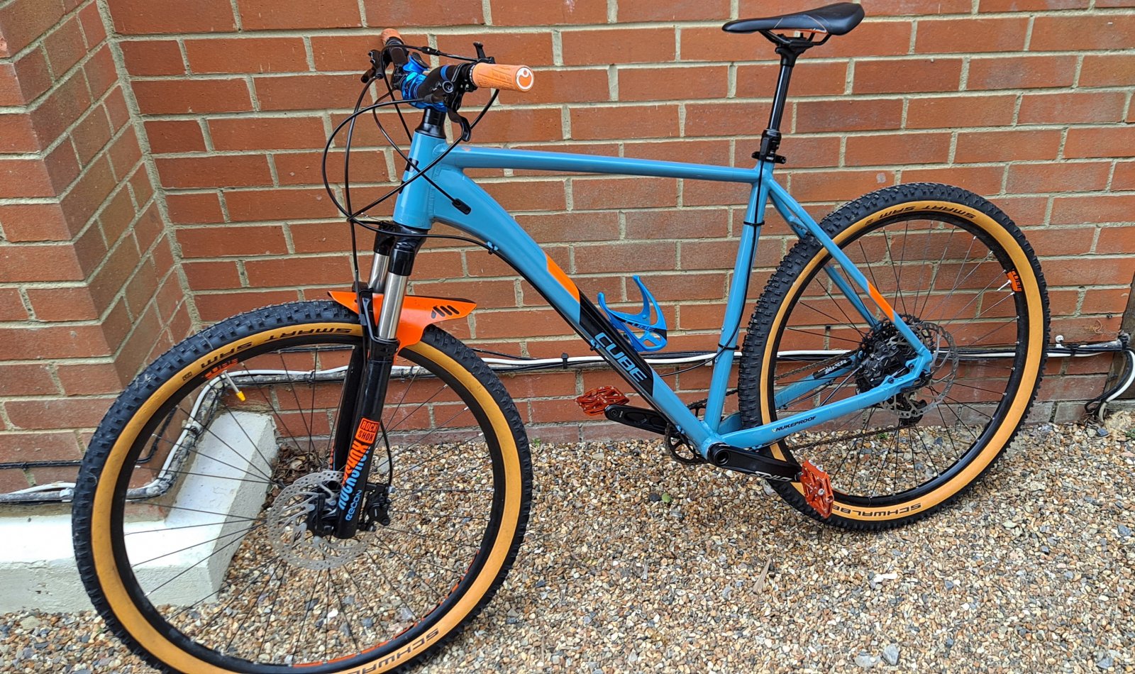

Don't know about it's suitability for a conversion but have a 2020 Cube Acid XXL frame size hardtail for sale if interested. 29er. Only used for 3 months before upgrading to full suss.

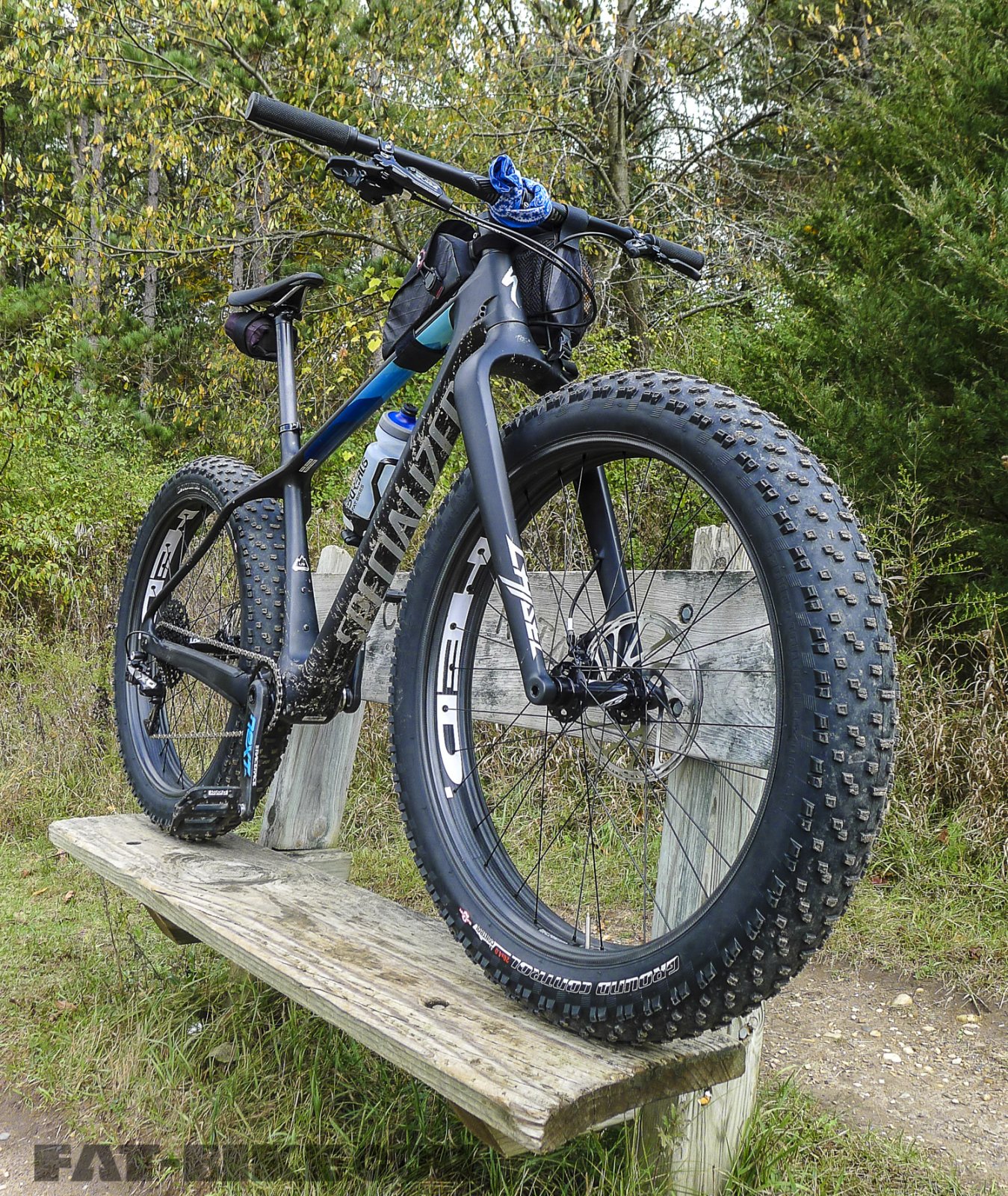

You can get some cracking carbon hard tail Fat bikes off Alibaba and Dengfu do both hard tail and full suspension frames and wheels.
The only motor that will fit the 100mm BB is the Bafang HD engine at 2000W‘s which should keep you up with your old Bafang M500, well just when you work out the weight of the battery to do so.:)
