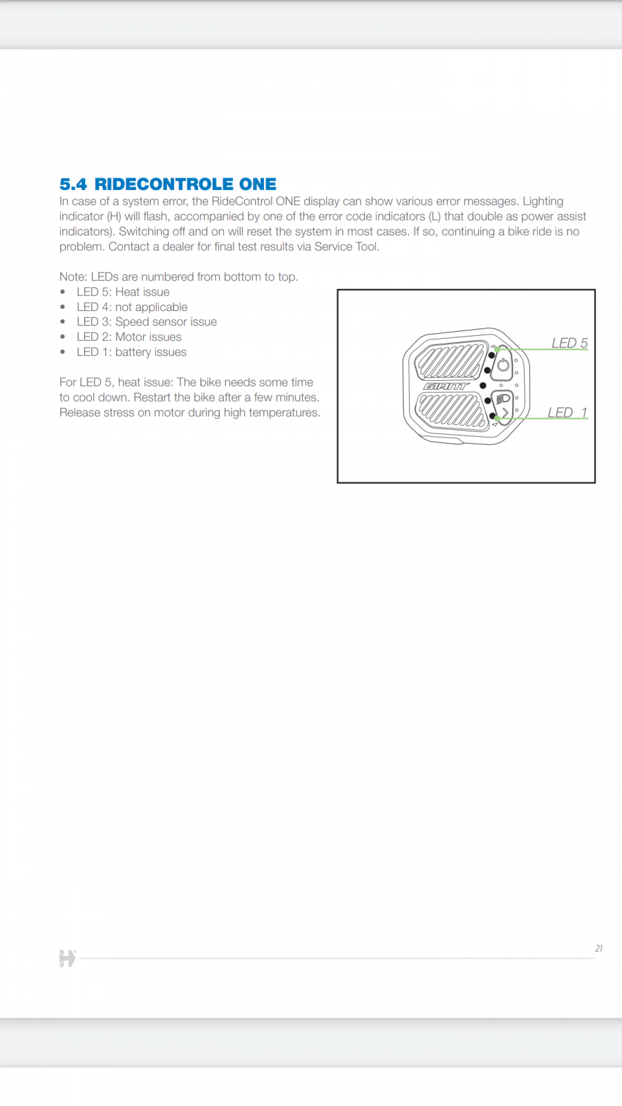

Can any Giant riders tell me what this red light on the control unit is warning of or its possible cause?

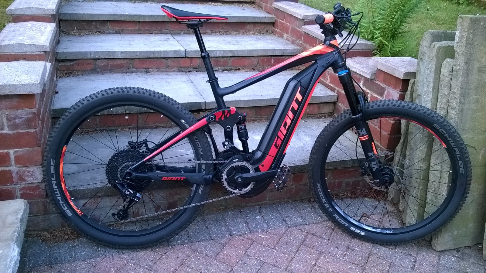

hi
looked at these this year to either buy a 2019 or the 2020 model.
asked lots of questions and pretty much got the same answers as
"peaky rider" lots of problems. ive got a full e +1 with an 0 sx pro drive train (fitted myself) 50t on the back
and since new in 2018 no problems what so ever, im 60 and this bike still
gets me into the hills at derwent, granted maybe not as fast down them
(not as daft as i used to be)but every bit as quick up.
so maybe a morel to the story, save a **** load of cash forget about the
street cred run the old model and have fun
oh one more thing in the mathematical equations of the universe does
DEPRECIATION =FUN

My mate's Giant Trance has given him a tower of pain, of particular concern to me as I recommended it to him.
It is twelve months old and so far it has had a new motor, a new front hub, new front brake lever as the brakes kept seizing on and the dropper post is now playing up. He is on his third control unit. The first developed a mind of its own and would engage walk assist when just leaning against the wall. The second one, supplied by a distant dealer for my mate to fit himself, would not engage walk assist just made a pretty light display and the third, which he bought himself works fine until it decides to flash up a red light and then becomes inoperative. This bike really is a pile of squit.
Which red light is showing Peaky Rider?
It's number 3, which we now know is the speed sensor, as confirmed by your post.
The strange thing is this warning light didn't show until a new controller was fitted, the third. Bit of a coincidence that.
It's now at the LBS for them to investigate and he's so fed up with it that once it gets fixed, he hopes to get shut.
Reckons he's going back to his old pedaller.

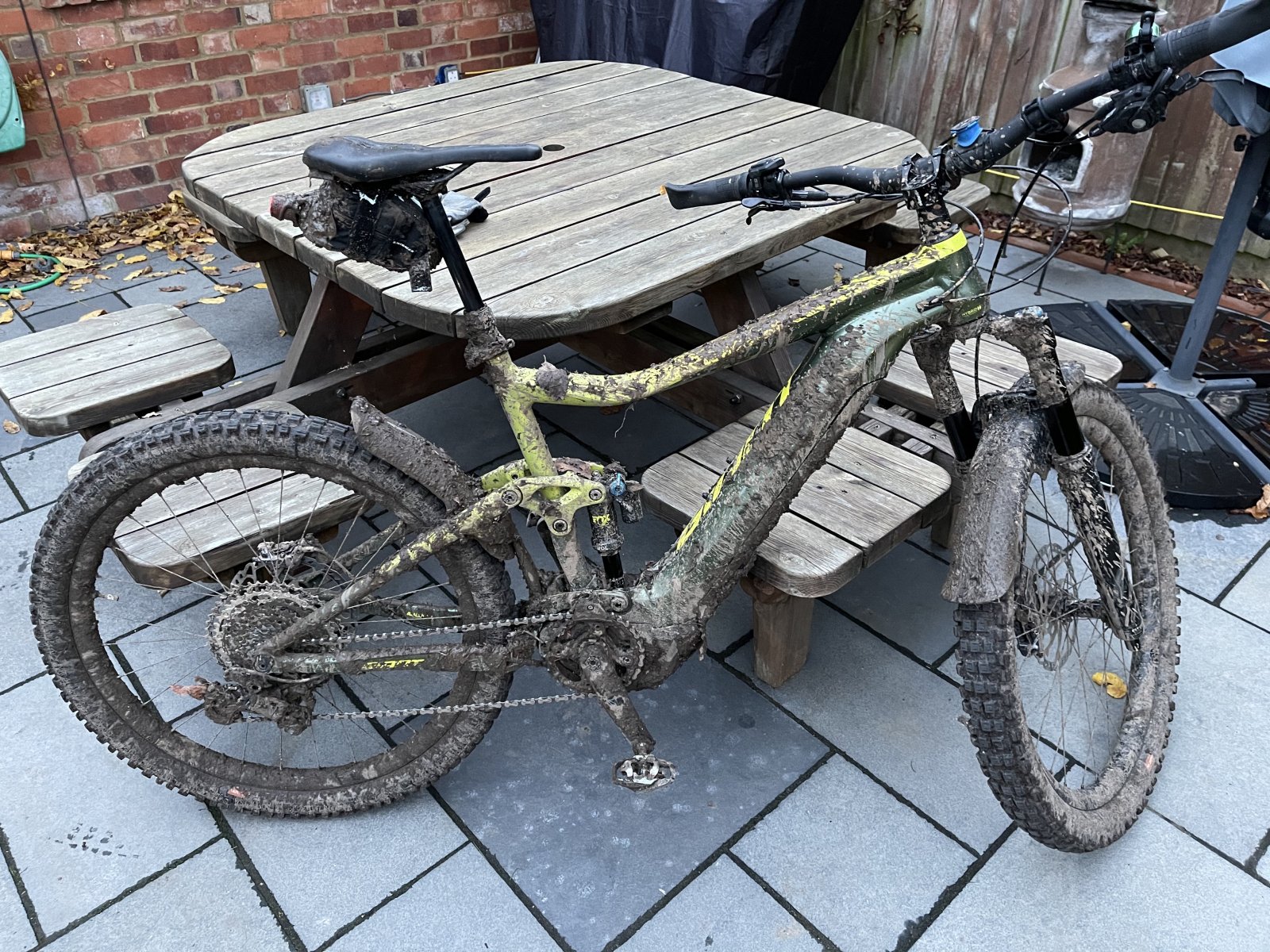

I see this is an old thread but my 2020 Giant Trance E+ has been flawless apart from a badly fitted dropper when first bought.
I’ve covered 2300km and replaced chain cassette and front ring. Rear derailleur will be replaced next week.
It had a tough summer and even tougher winter but is still as it was on day one.
It’s has been like this all winter.
