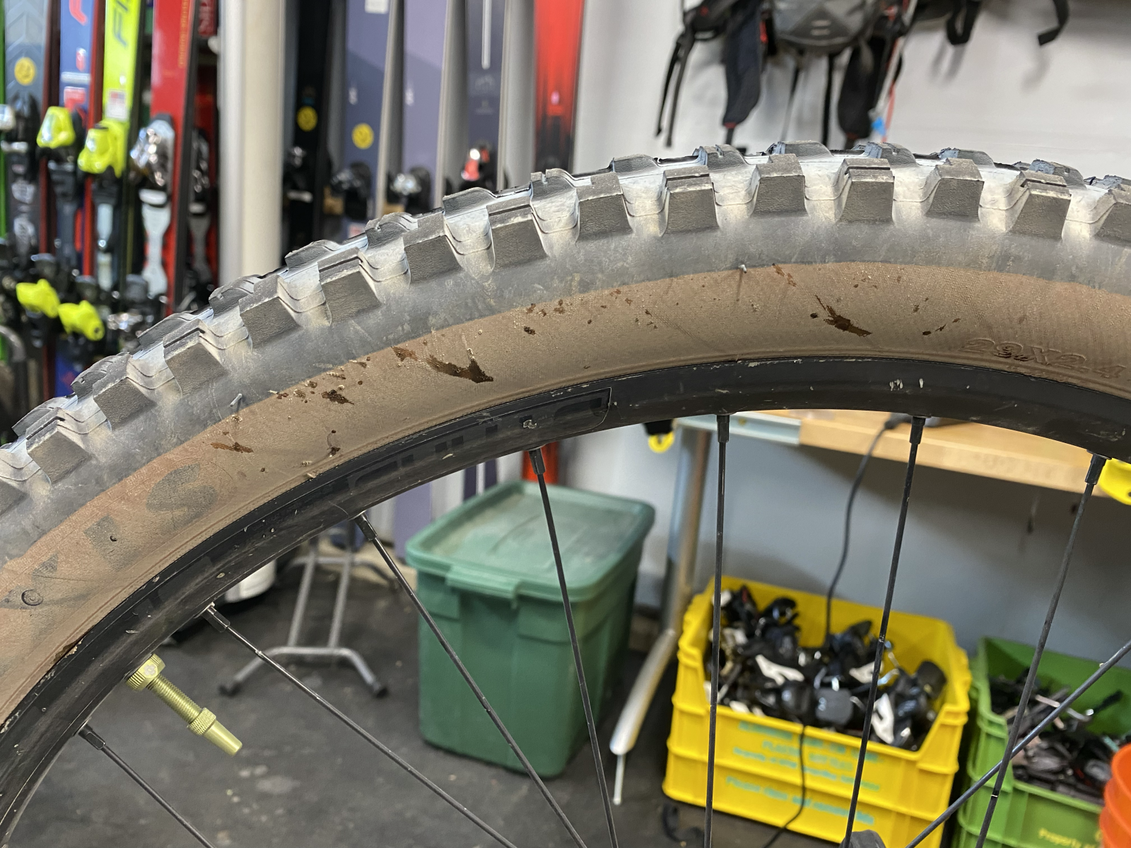

I am having issues with my Maxxis weeping. Not happy with it. This is not the first ones I have had this issue with bit it will be the last.
It will stop, may take a few days. If you are not riding, increase the tyre pressure and lay the wheel on top of a bucket for a few hours on each side. It never occurred to me that this might be a brand specific problem, I had thought it was a tyrewall weight issue. I have had this with some Continental tyres and some Maxxis tyres. It has never been an enduring problem, not for me at least.
I do know that latex based sealants do a much better job of sealing the sidewalls than the non-latex sealants, but they all work in the end.
If you otherwise like the tyre, it would be a shame to ditch it just because of that temporary issue.

Always use a latex based sealant as your first fill on a new tyre, give it a month and then put in the correct amount of a non latex sealant, the latex fills any porosity on the sidewalls.
