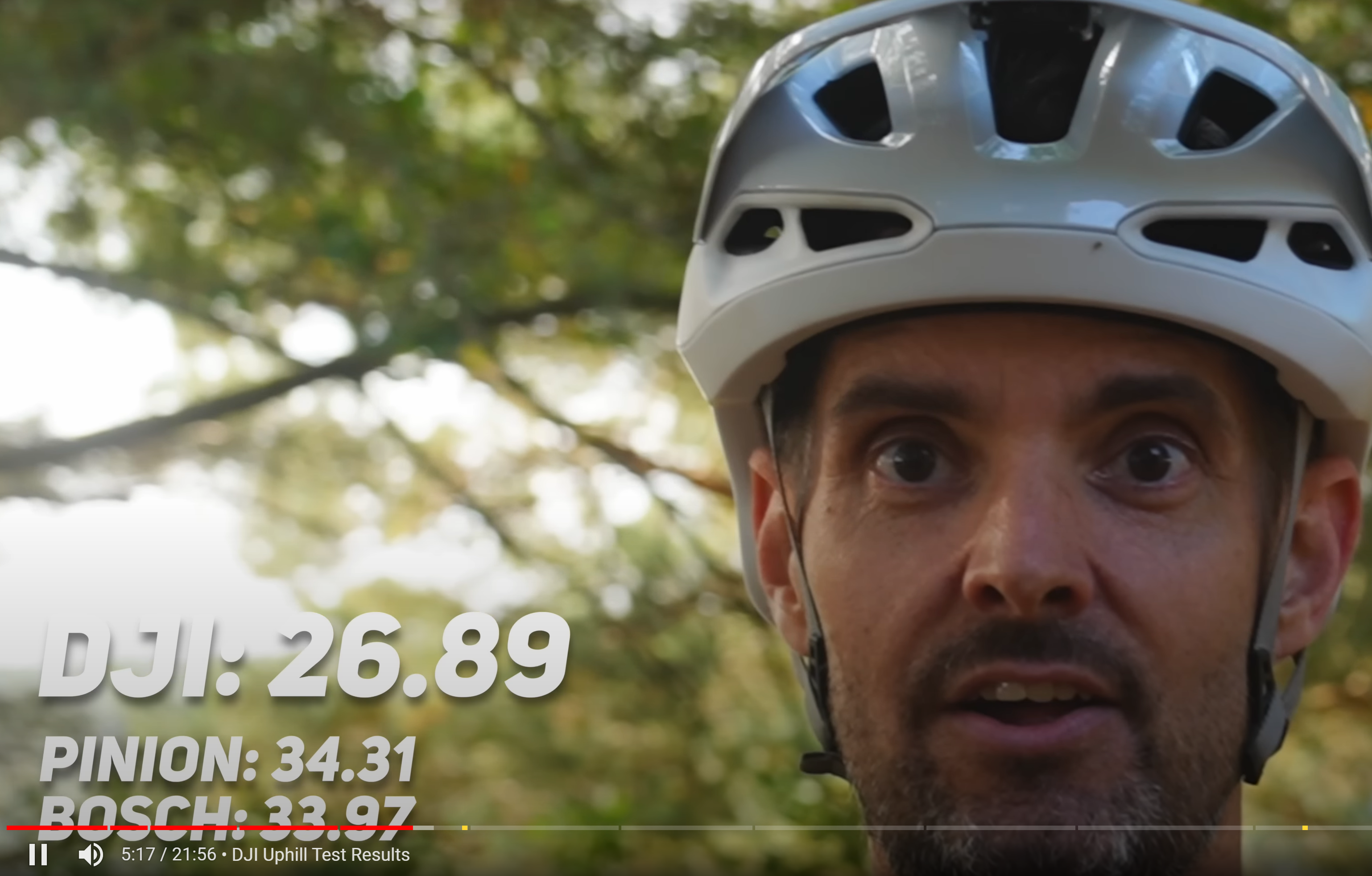

Fascinating Lab test. I'll be sure to keep it in mind when I need an EMTB to ride in a Lab .......... :ROFLMAO:
Meanwhile ....... What is more important, is someone riding The DJI Vs the Bosch up a mountain, because that's where most people ride Mountain Bikes. And in that test, the DJI was 21% faster than the new Bosch motor. That is a significant improvement.
I ride a Shimano EP600. My plan was to upgrade to the EP801, as all the electrics are compatible. The Amflow has me now in a holding pattern, as a more than 20% improvement in climbing speed, would really impress my riding buddies. :ROFLMAO:
But I need to see some more longer term riding and longevity reports ......... Not lab tests ....... :p
In fairness, the Surrey Hills are not exactly mountains! :) Impressive demonstration though, and the first time I’d heard of the Avinox.
I ride alone, who am I going to impress! :(
I still love riding my old E8000 Jam 2, it‘s such a good bike for me, and the 378Wh battery keeps the weight down and covers all my rides fairly easily. It’s ’only‘ 75Nm as well, but still hauls my, ahem, substantial frame up the steep bits without my chest exploding.
Still, I keep going back to the Amflow website, such is my EMTB Acquisition Syndrome (EAS)…

Interesting tests by velomotion.
It shows in numbers what the testers in the real world are seeing also, ie its noticeably more powerful than bosch et al. But also interesting that it doesnt seem to hit the numbers that DJI use in their marketing - That doesnt take away from the fact that its still pretty much the most powerful motor right now.
Will be interesting to see how the motor fairs when its out in the wild with more people and used by a wide range of people in a wide range of temperatures over the longer term. that thermal (was it thermal, or just a shutdown to maintain 250w nominal?) shutdown was interesting, hopefully in the real world you'd never be able to recreate the conditions that lead to it.
If I'd just bought a new bosch bike I wouldnt be feeling that I had made the wrong decision right now - personally I'd favour a known e bike player with a bit less power over a new unknown (in the ebike world) player - obviously over time DJI can become the known player. I havent bought a new bosch bike though - Have a 2020 orbea wild fs, and a trek fuel exe - and currently no plan/desire to change either, so will keep watching from the sidelines

Testing differences vs claimed are interesting but could be explained. We still don't know where DJI is getting their power figures. It seems in the EMTB motor world the big players go off power at the crank, notably not bafang though which is at the battery. From my prospective of high power "ebikes" or emotos though, and other electronic gadgets though I'm used to claimed power being from watts pulled from a battery not at the motor. Could be DJI is just going with that figure instead. Could explain the figures not matching.
But I also wanted to point out though that I've been a little skeptical of velomotions test figures again. The reason why I bring it up though is when looking at the Bosch power figures compared to ebike-mtb the bosch was roughly 200w less. Which also would line right up with the DJI being 200w less than claimed, though not tested. I thought that was interesting thing to line up. Even more interesting though is the panasonic ultimate power figures tested are closer between both sites, so not sure where / why the bosch has such a huge difference.
But I also did see some people in the comments (using google translate) making comments to suggest they were using the smaller 600wh battery, and that it could have given worse results. As I've seen some data to suggest that in the right conditions the battery might overheat for the 600wh model, if my guess its the LG M58 cells inside is true. But I also would say the idea that it being a test bike with maybe older software could play into this. Maybe even the Region set, if the idea its trying to keep to 250w average we wouldn't see that (or shouldn't) in the USA. Hopefully it doesn't take velomotion that long to publish online so I can translate it, or post an English version like they did for the Bosch Gen 5. I also hope Ebike-mtb will also test the power figure now that it has been questioned, that way we have another source to look at and compare
Butt-dyno is notoriously ineffective for cars, I would assume it’s the same for bikes. Lab testing is an interesting demonstration that DJI’s power figures are made up, but maybe Bosch etc are also optimistic?

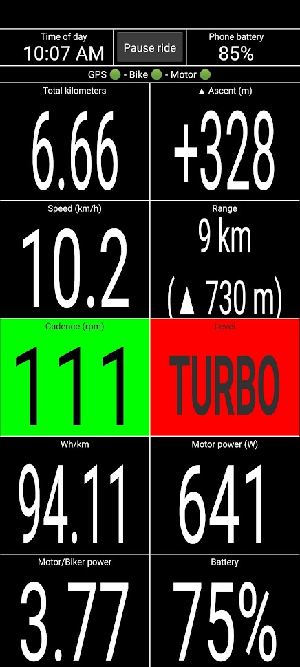

Would make sense. No one is ever really that clear if they're talking about battery draw or power at the cranks, spesh included.
If the DJI is producing 780w ish at the cranks, then that's going to be about 1000w draw from the battery.
An older Brose 1.3 running Spesh firmware above 5.4.2 will draw 20 amps, fully charged, that's 840w from the battery (newer ones draw less).
Wh/km is also very terrain dependant and not always a very good guide to how far you'll actually go from just a snapshot. Generally, if a bike is pulling more watts, then you're probably going faster than a bike pulling less watts. So in any given second you've travelled further - meaning that drawing more power isn't always directly proportional to a drop in range.
