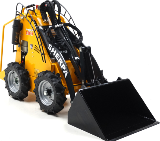

Thanks for your reply! I will think about it. I will anyway never cut the original cable. I would buy a spare one if I start experimenting.
I recognize your bottle, they use it to store manuals like on the mini wheelloaders below:

Yeah, that's it. The bottle even said on the cap "User manual inside". Over here, guys have been using those to store tire tools etc. on their BMW GSes etc. such bikes. I had a similar idea, but never implemented it, before I sold the Beemer. Now I just have KTM EXC and Levo, but all the rides I did last summer were with Levo.
