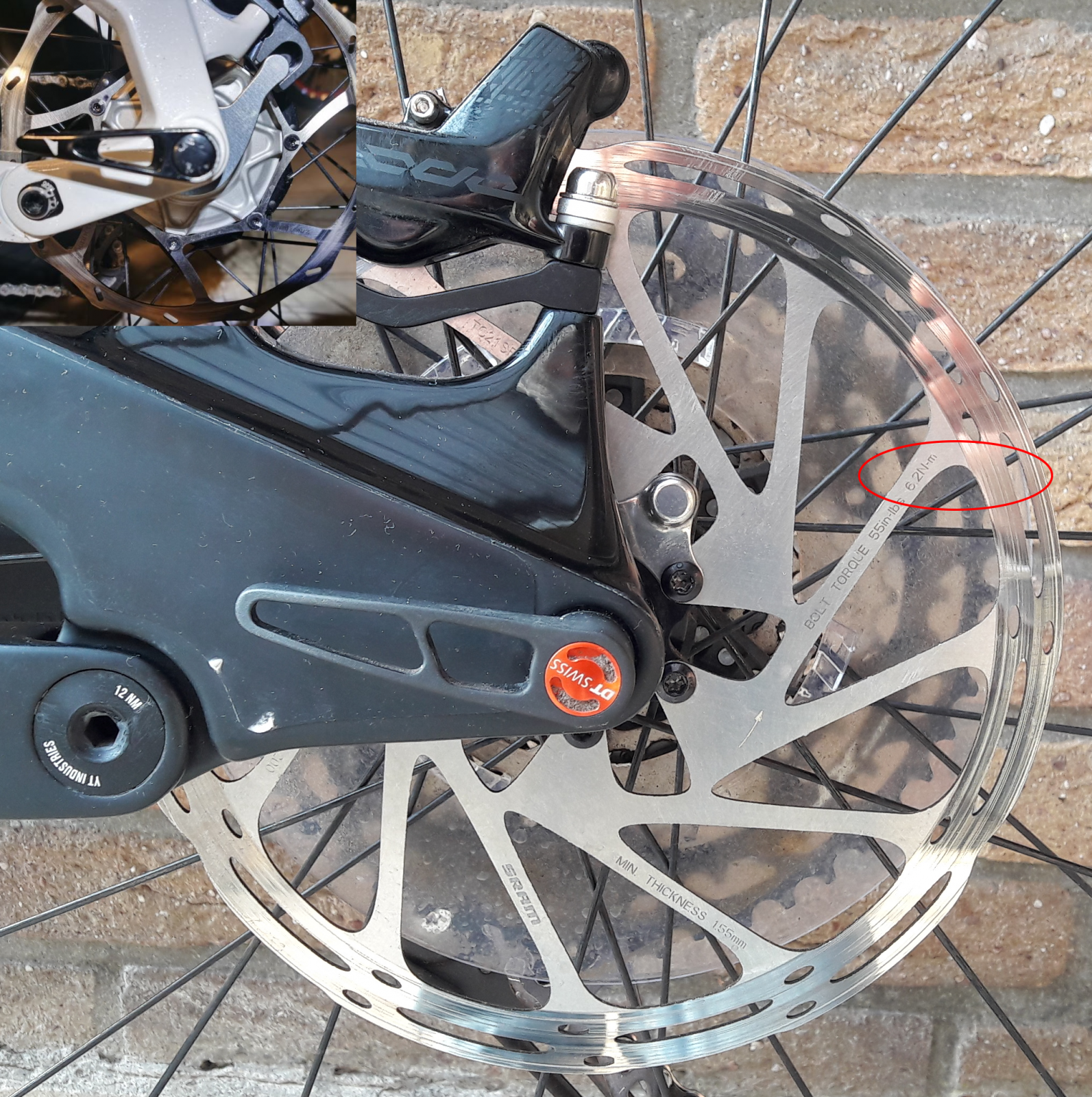

Wow, very extensive, complete tutorial and review.
I would also consider a Kindernay but with what I read/see here, its not for me and it wouldn't fit my YT (even with all of their options).
Newer emtb's don't have a spoke magnet but its integrated in the disc brake, see picture.
My YT has all cables guided through the carbon frame and there are no 'free' holes.
Drilling into the frame for the 2nd shift cable ? And lose the warranty ? No way.
Having separated up/down shifters is nice but the handlebar becomes more cluttered and by the look of all those handles, shifters and triggers, longer fingers and more fingers seem to be needed.:)
Note that SRAM engraved a bolt torque of 6.2 Nm in the disc.
