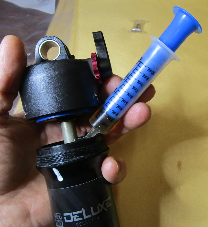

Shock had been leaking oil, past the seal, from the negative pressure side. I realize that most of them do leak. Bought the rebuild kit from SRAM. It was easy peasy.
Interesting that functionally it is pretty much identical to the AER air fork on my KTM's. Test rode it yesterday and it is perfect.

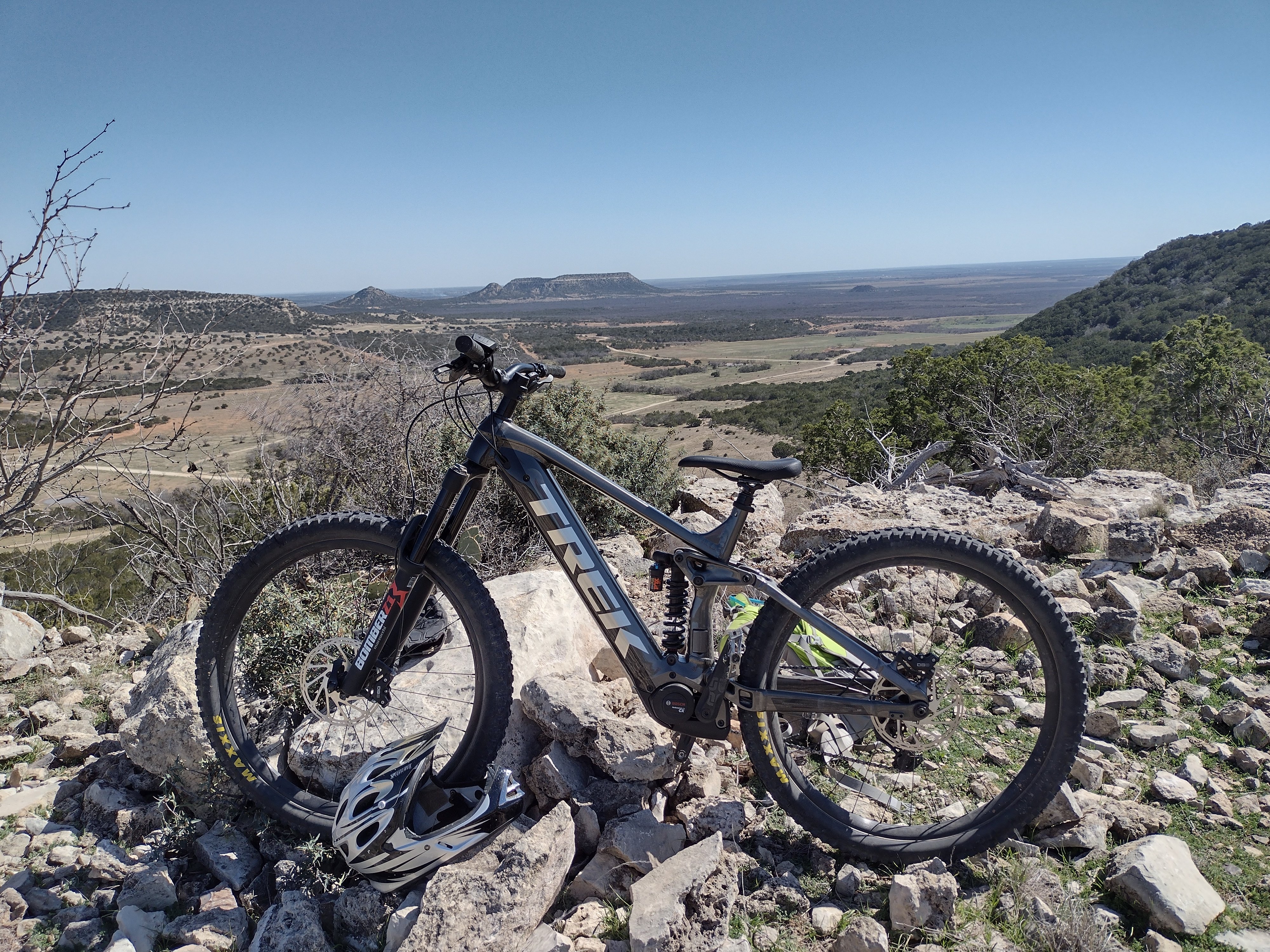

Earlier this year I bought a Trek Rail 7 and have been riding the wheels off of it at our local trail in Abilene, TX and riding it out at Bronte, Texana Ranch, Ross Creek Trail Riders. Here's a pic of it recently out at Texana Ranch, and you can see I've already changed out the suspension to full coil...old dirt motor preference on the coil deal, of course...LOL!

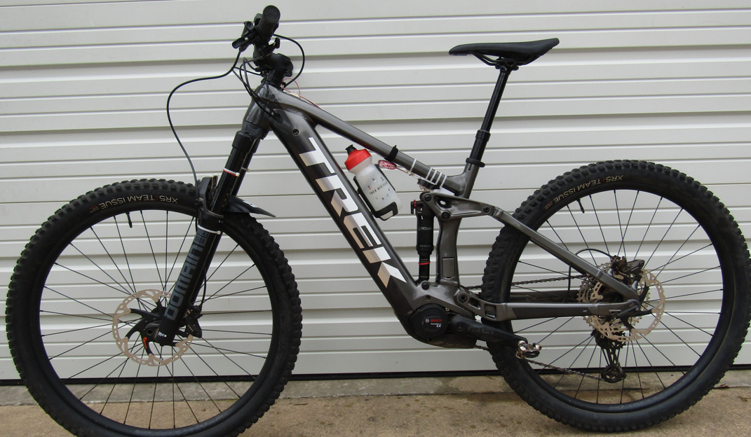

Here is mine... may be the same color as yours? totally stock except for pedals, bottle cage and fender...

Nice bike... that is certainly a step above my Fuel EX 8! Thank you for the offer, however I best pass at this point in time.
