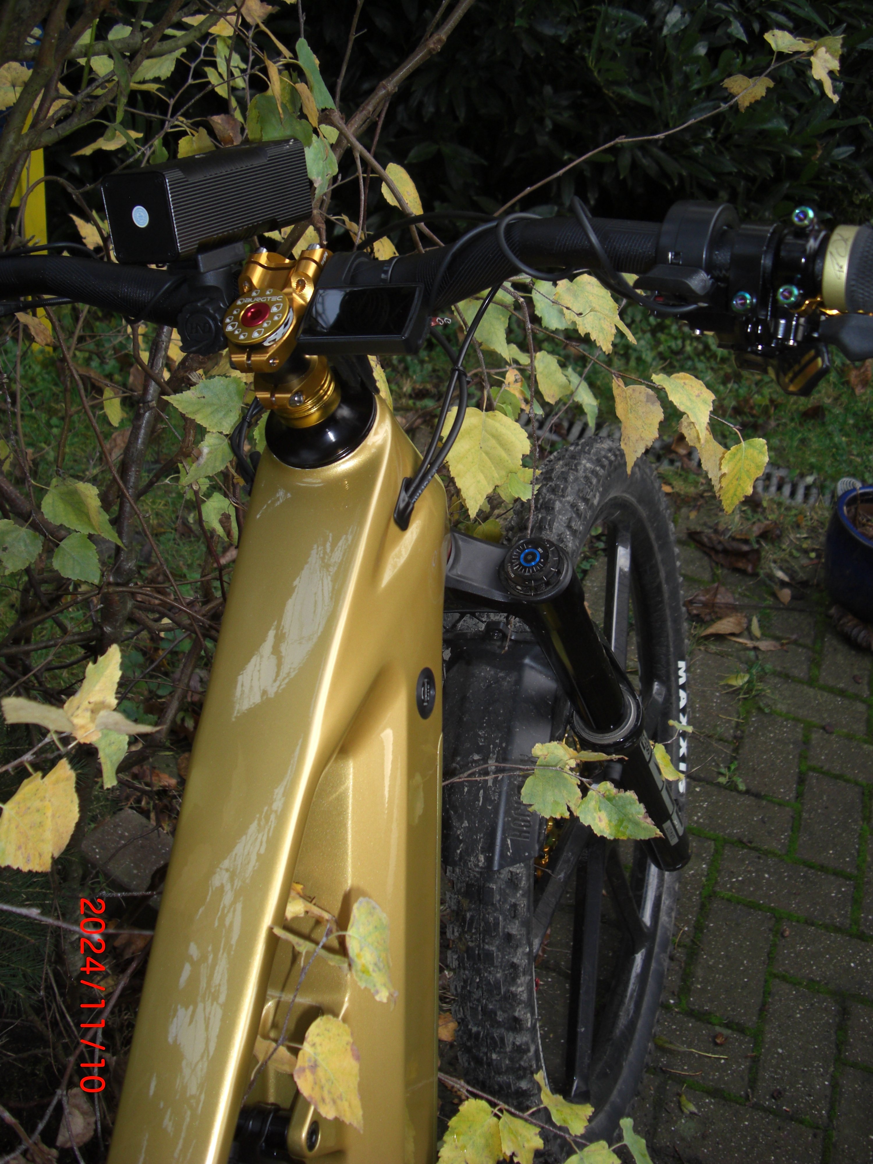

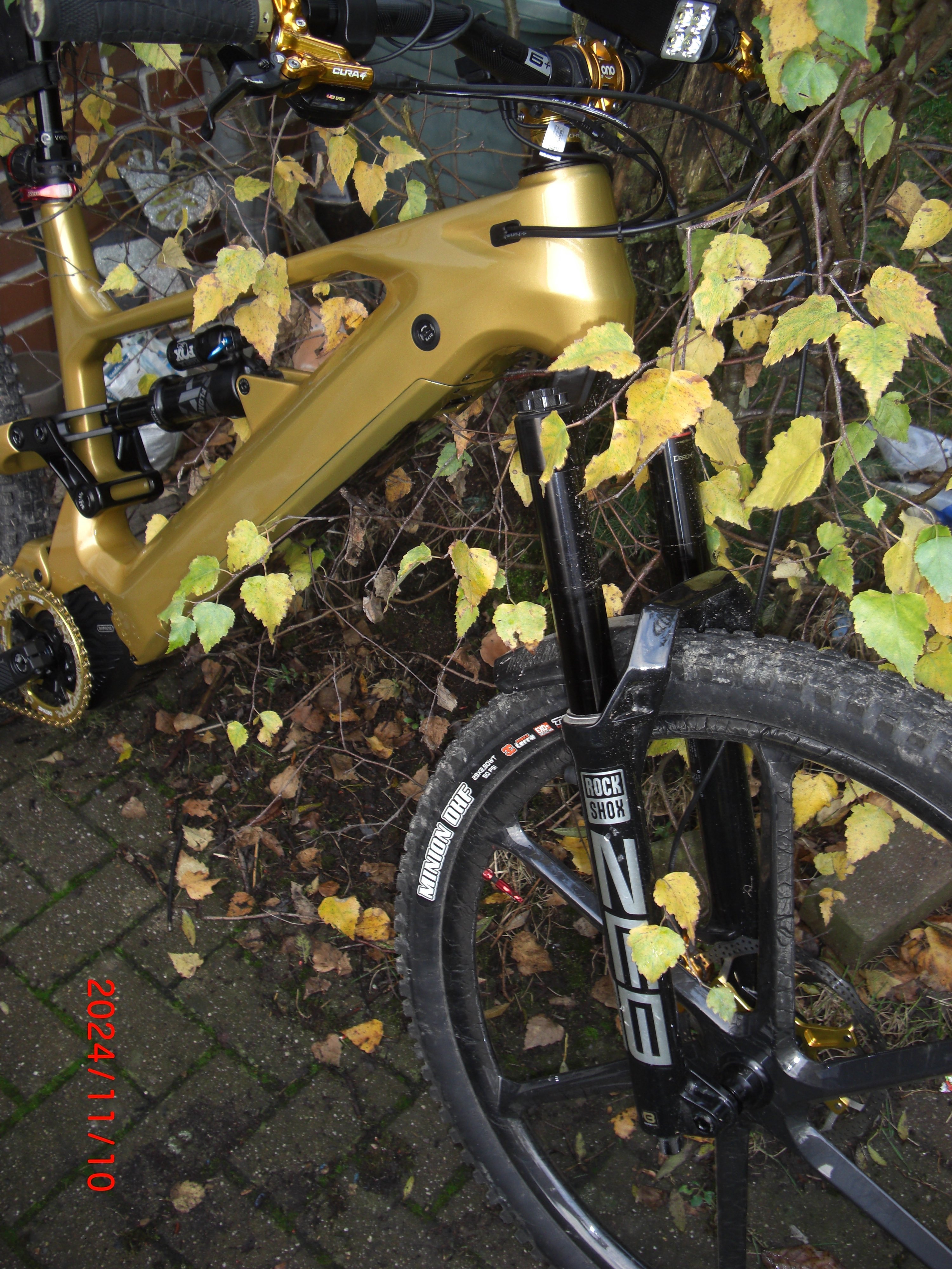

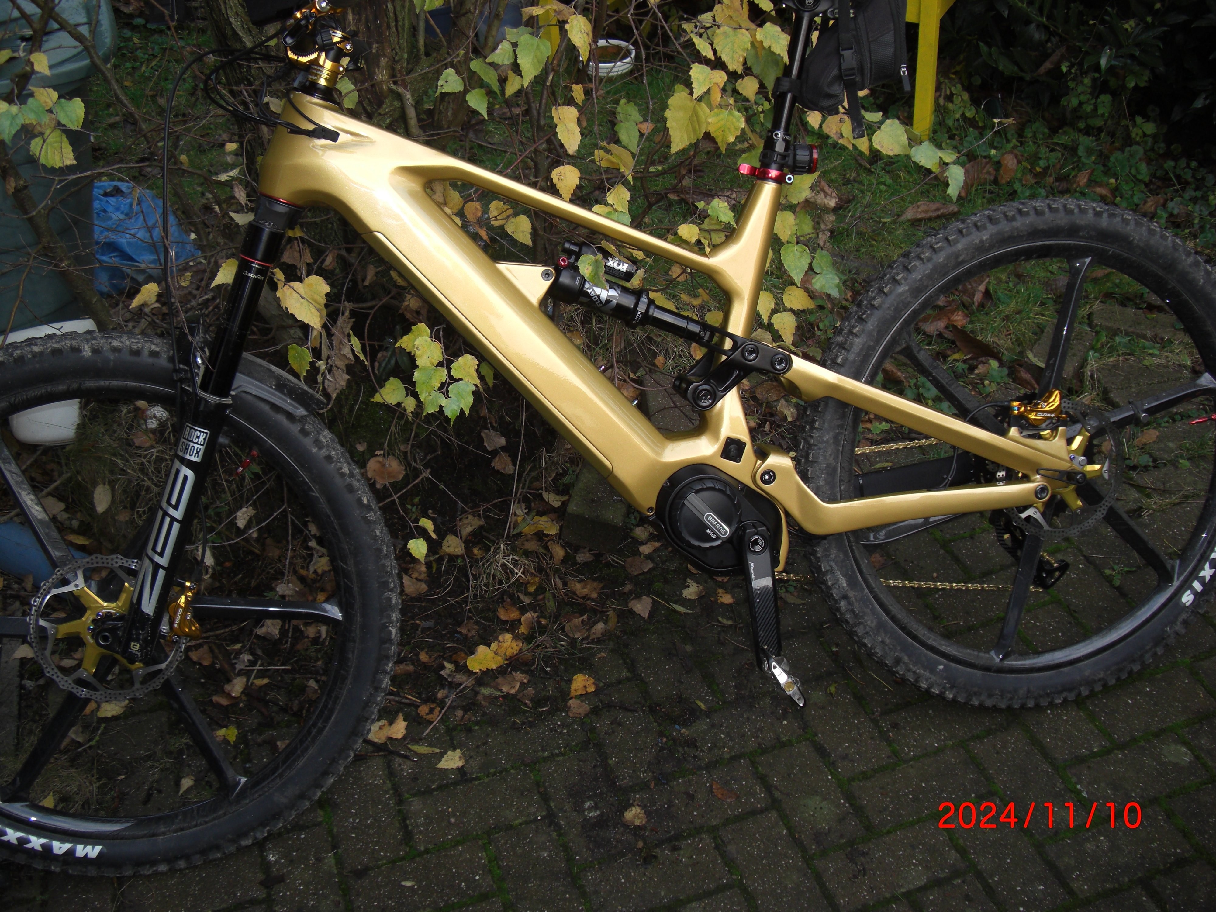

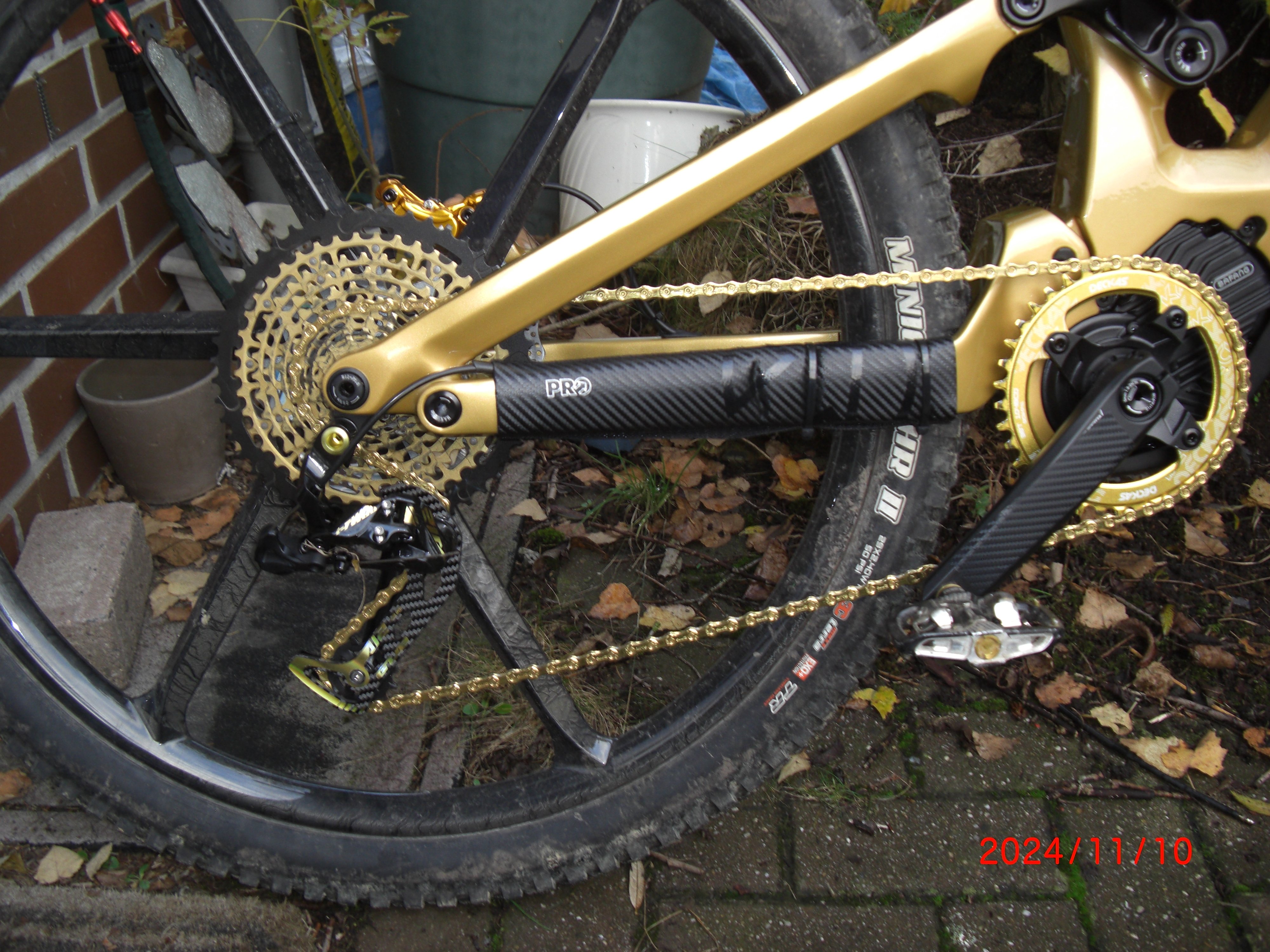

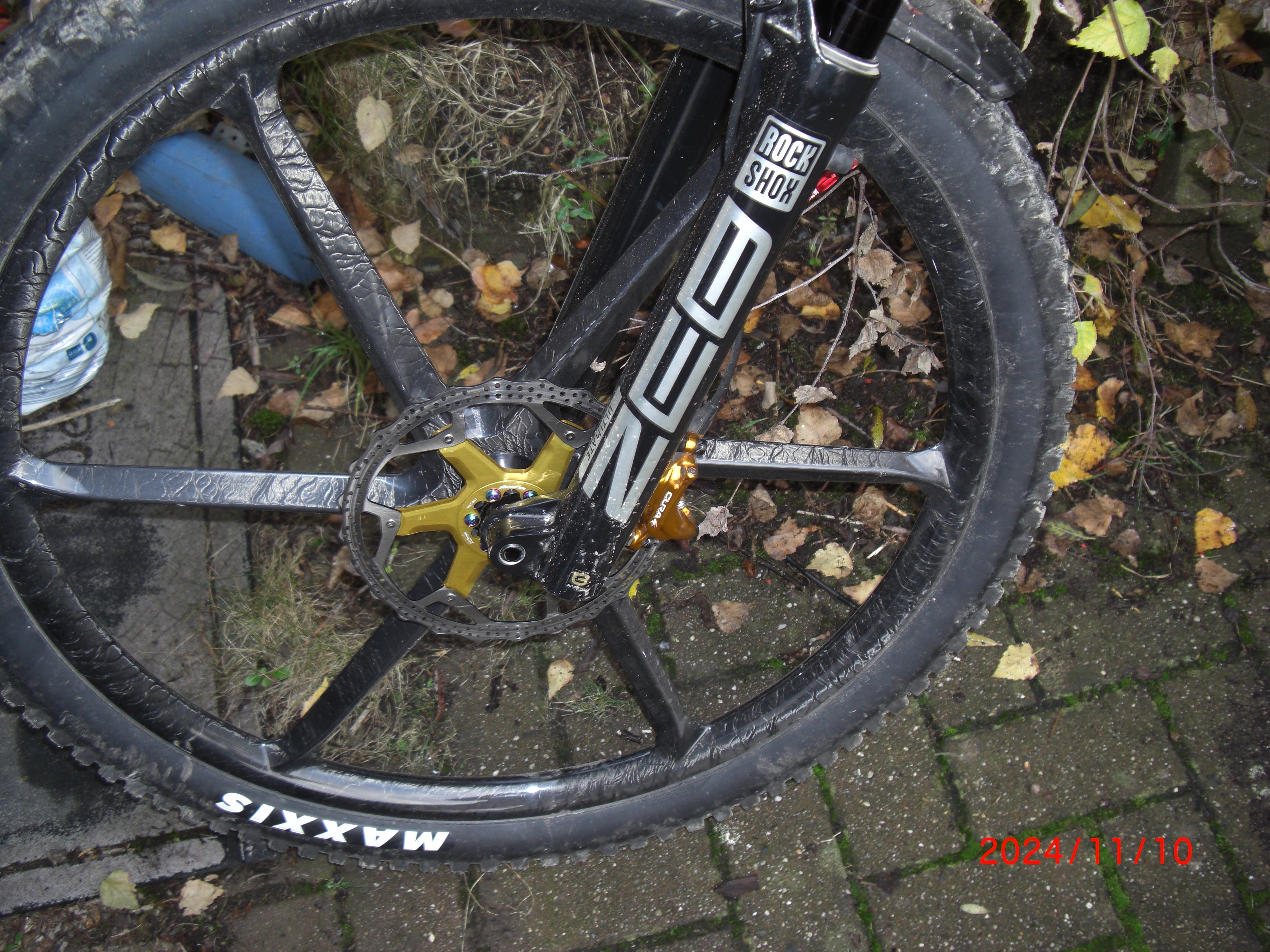

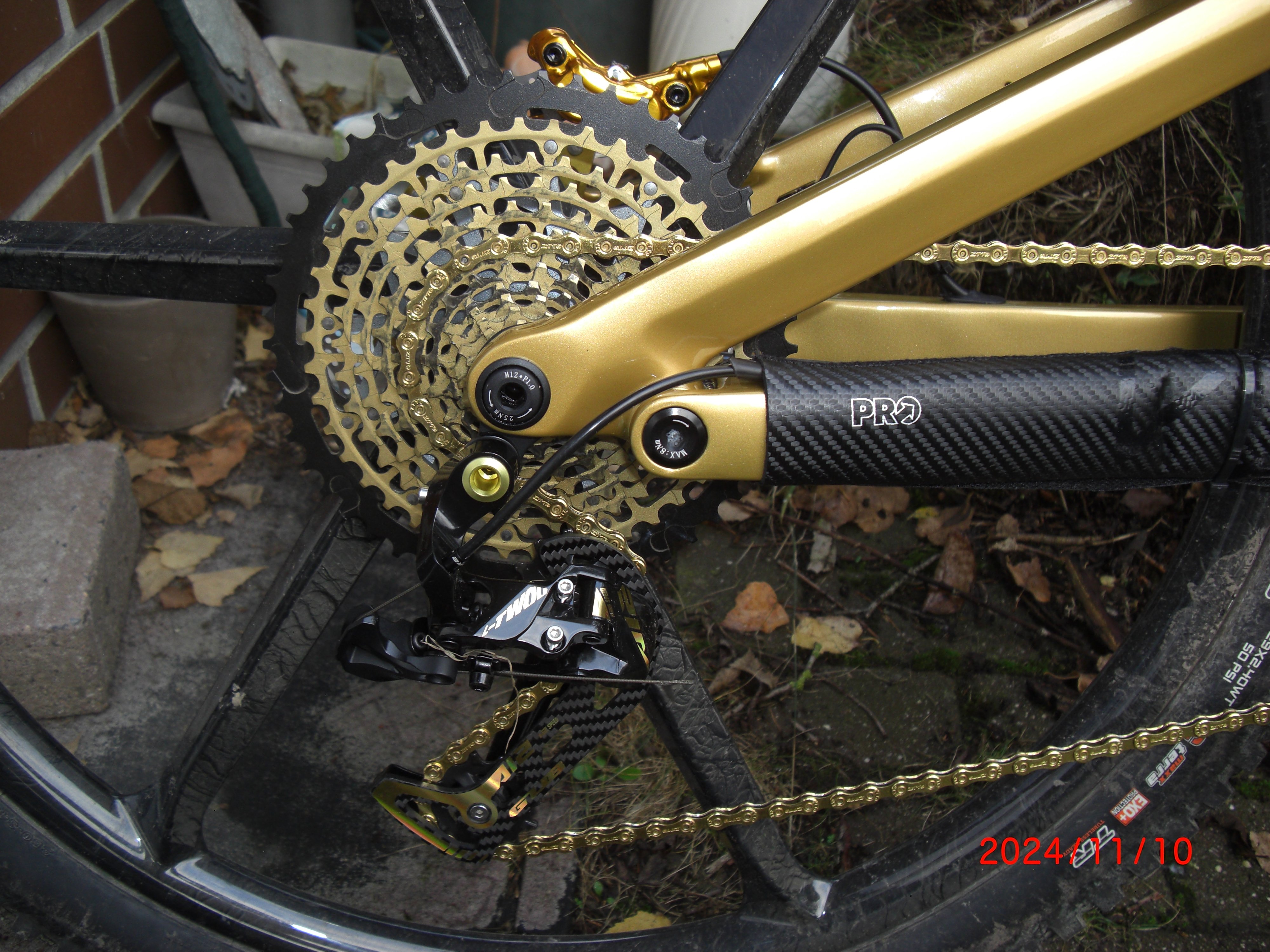

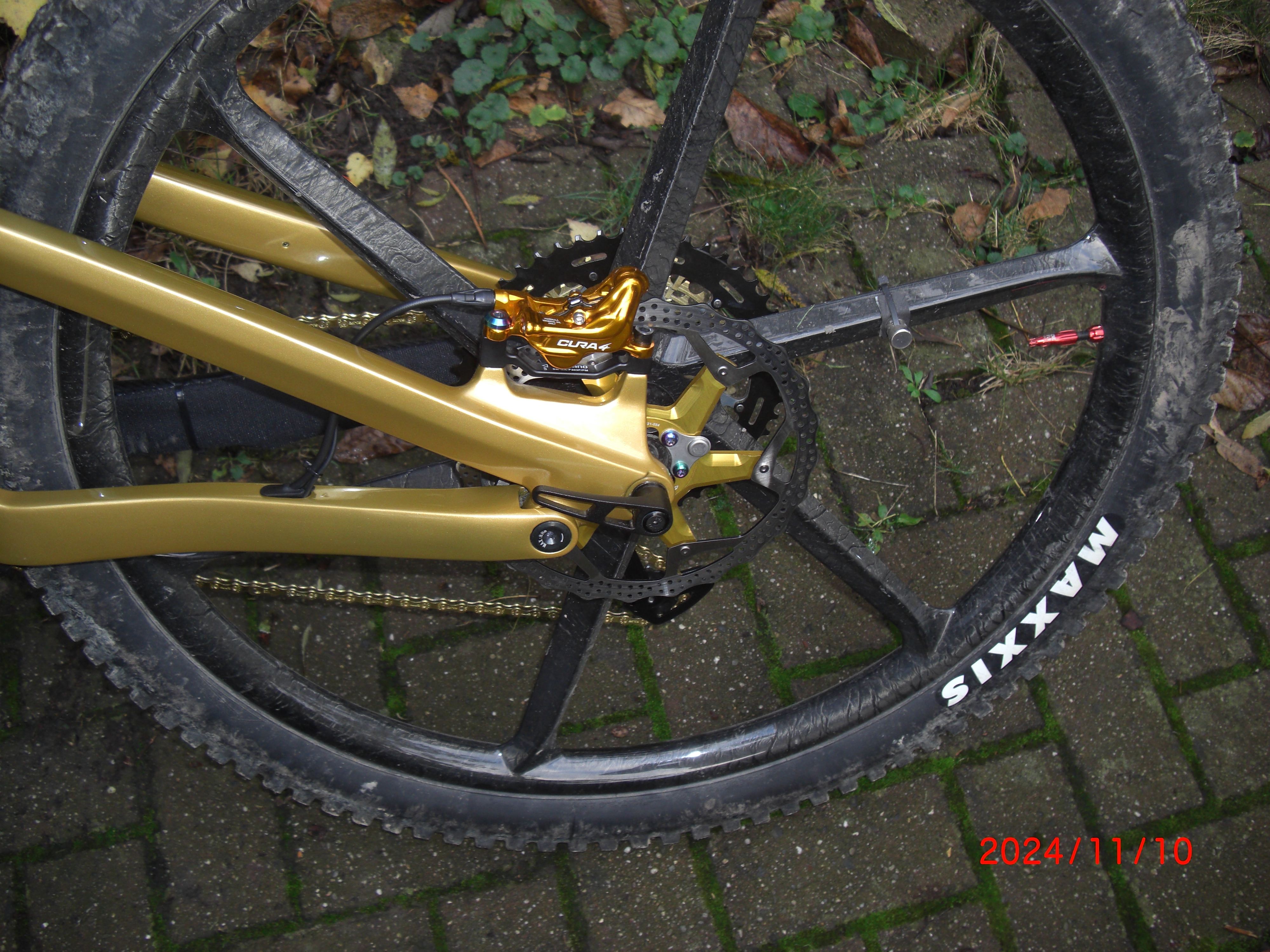

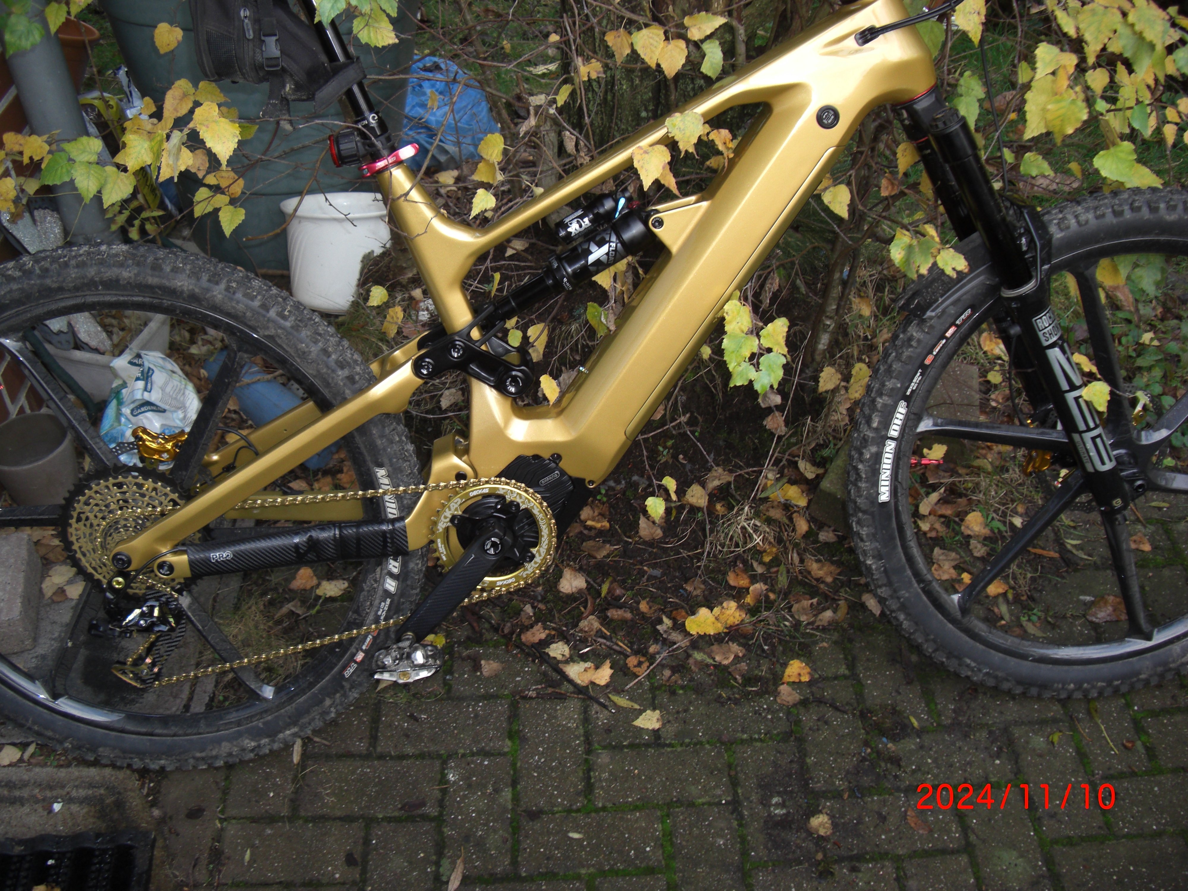

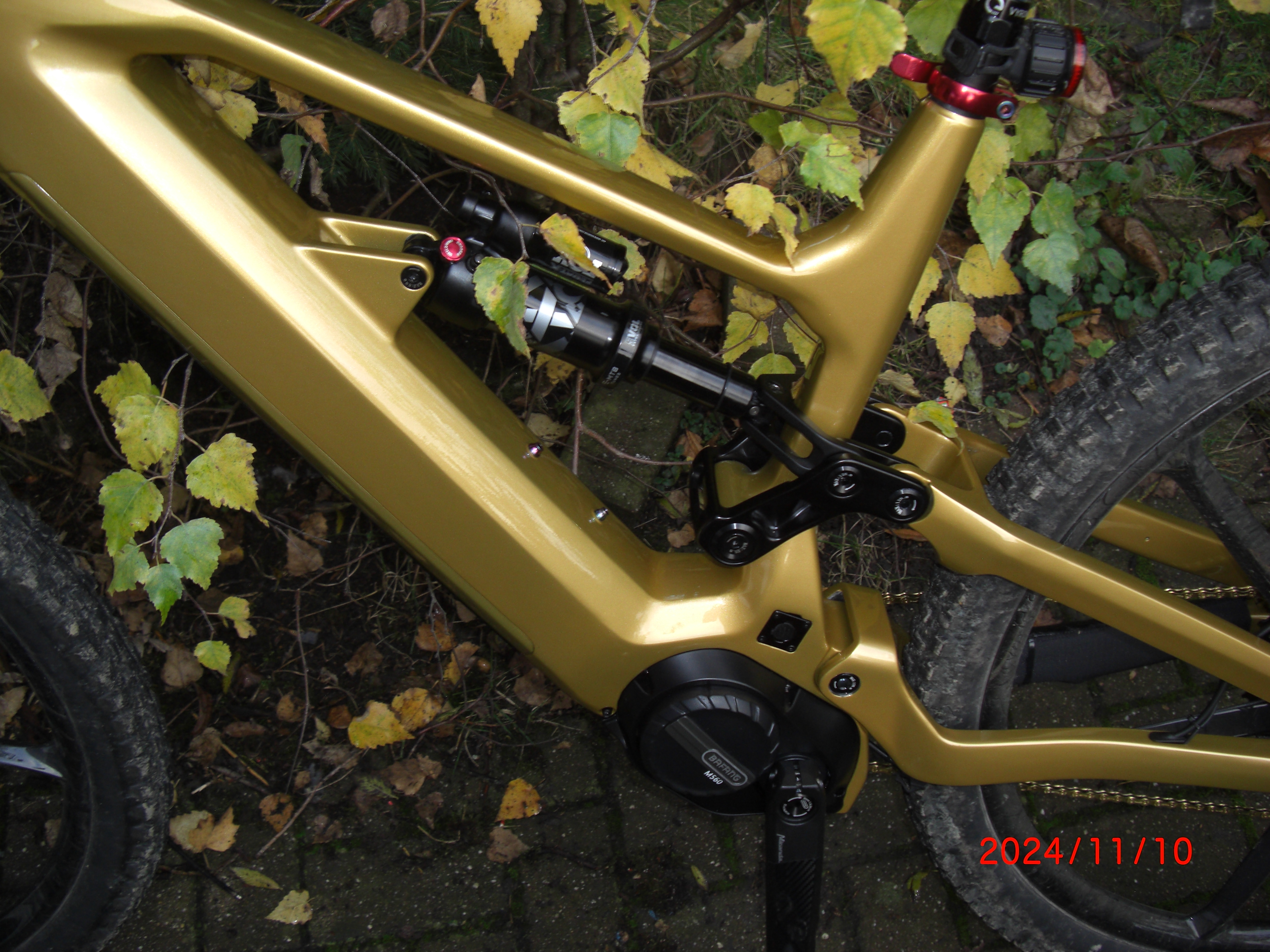

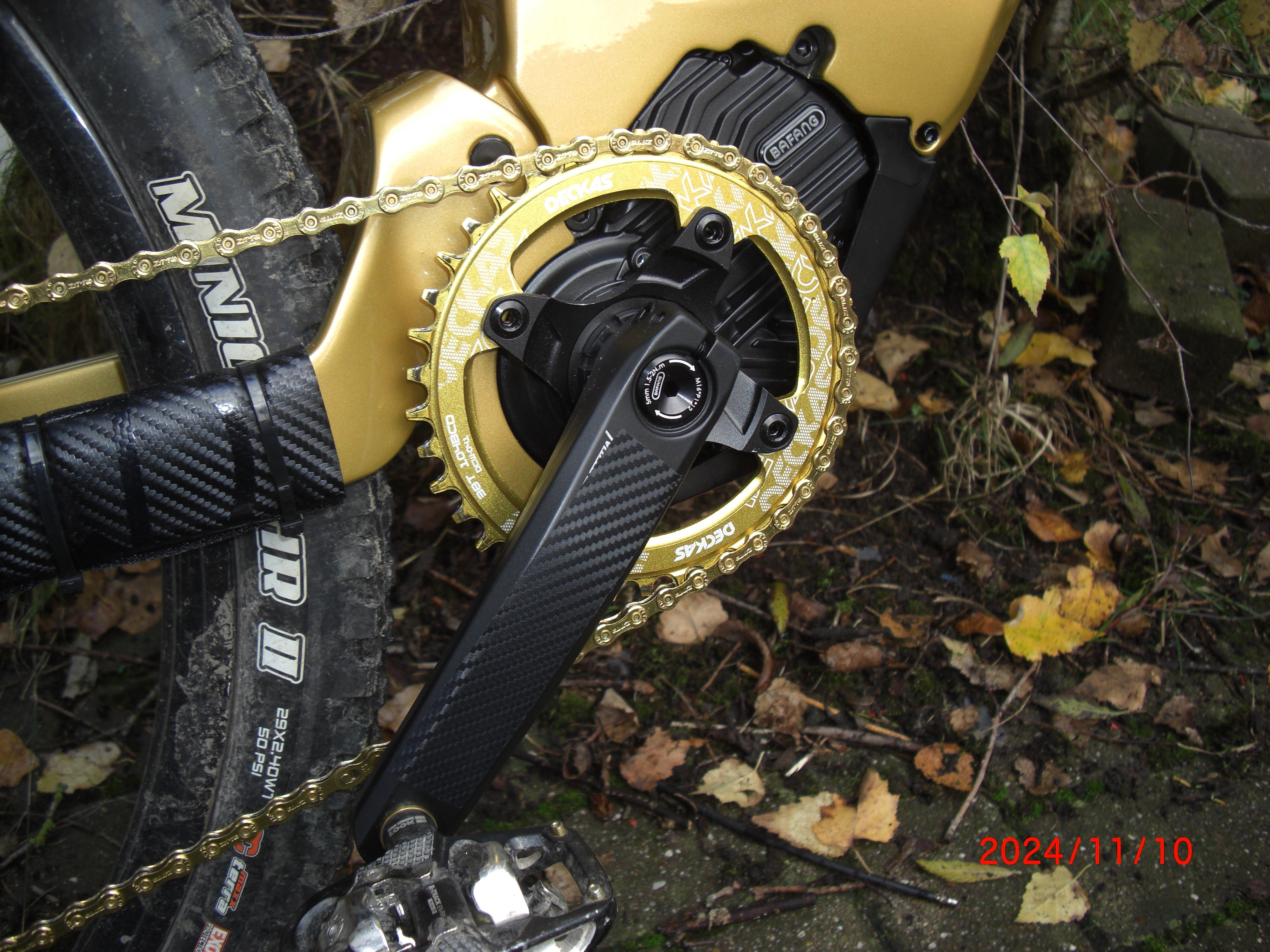

Hello,
at first greetings from Germany.
I have now build up my new E-Bike Dengfu E 82 with Bafang M 560,750 Watt Version.
Size Large,special gold color.
Specs:
Formula Cura 4 Brakes in gold,Reverse 203 mm Rotors in Gold,RS Zeb Ultimate 29 Fork with 170mm Travel.
40 mm Stem in gold color.
Magura Veyron Post
Miranda Cranks in 160mm
Deckas Gold Chainring 38t.
Carbon Wheels 6 Spoke with Maxxis Tires.
12 Speed Cassette from ZTTO in gold.
Very nice looking Bike
Hope Headset
Michael
CIMG4266.JPG CIMG4267.JPG CIMG4268.JPG CIMG4269.JPG CIMG4270.JPG CIMG4271.JPG CIMG4272.JPG CIMG4273.JPG CIMG4274.JPG CIMG4275.JPG

Hello,
i have not yet weight the bike,this will come on the weekend.
Price for frame,motor and battery with shipping to Germany are in the range of 2.200 €.
Some of the used parts i have in stock and the wheels are also used for other bikes.
The Fox Float X shock was from another E-Bike and measured 230x60mm
