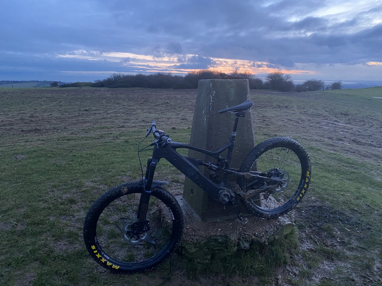

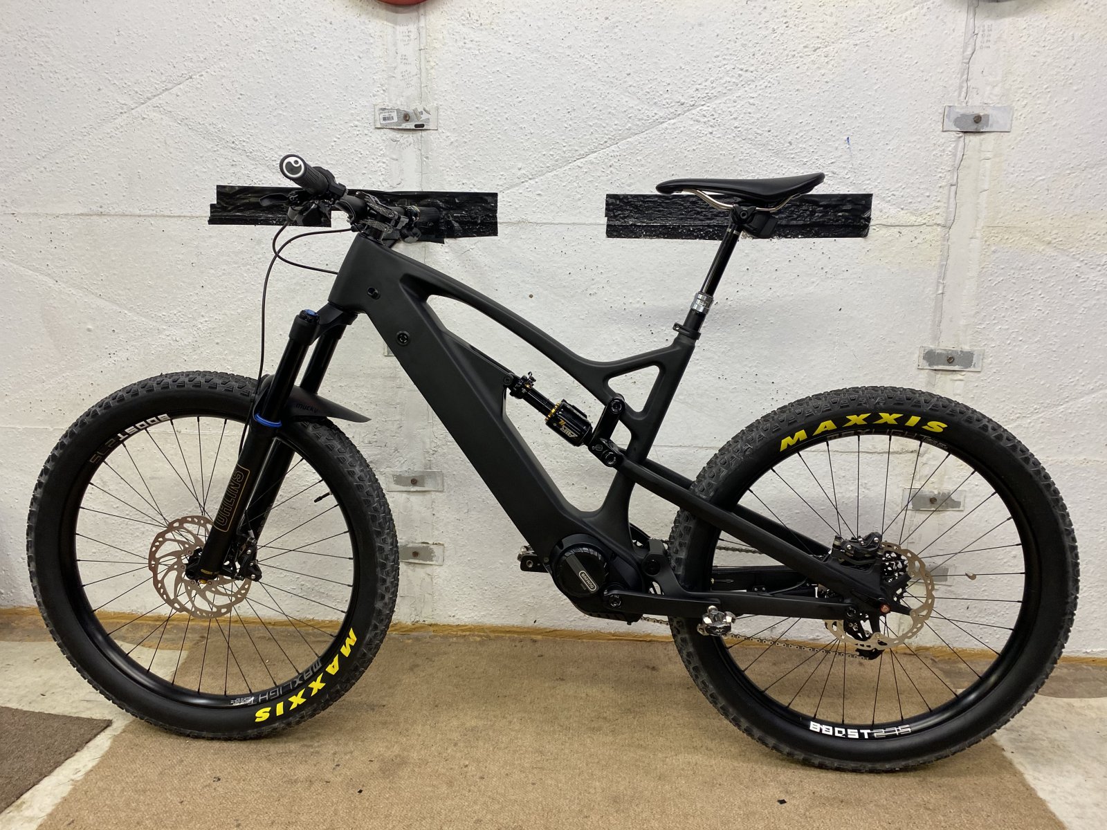

Compared to alot of the aluminium Chinese frame designs and geometry Deng Fu are supplying a full carbon frameset for the Bafang M600 motor and battery.
Trail testing begins today so we’ll see how well this compares to the Seroxat Aluminium ebike I built and tested in 2020 using the M600 setup.

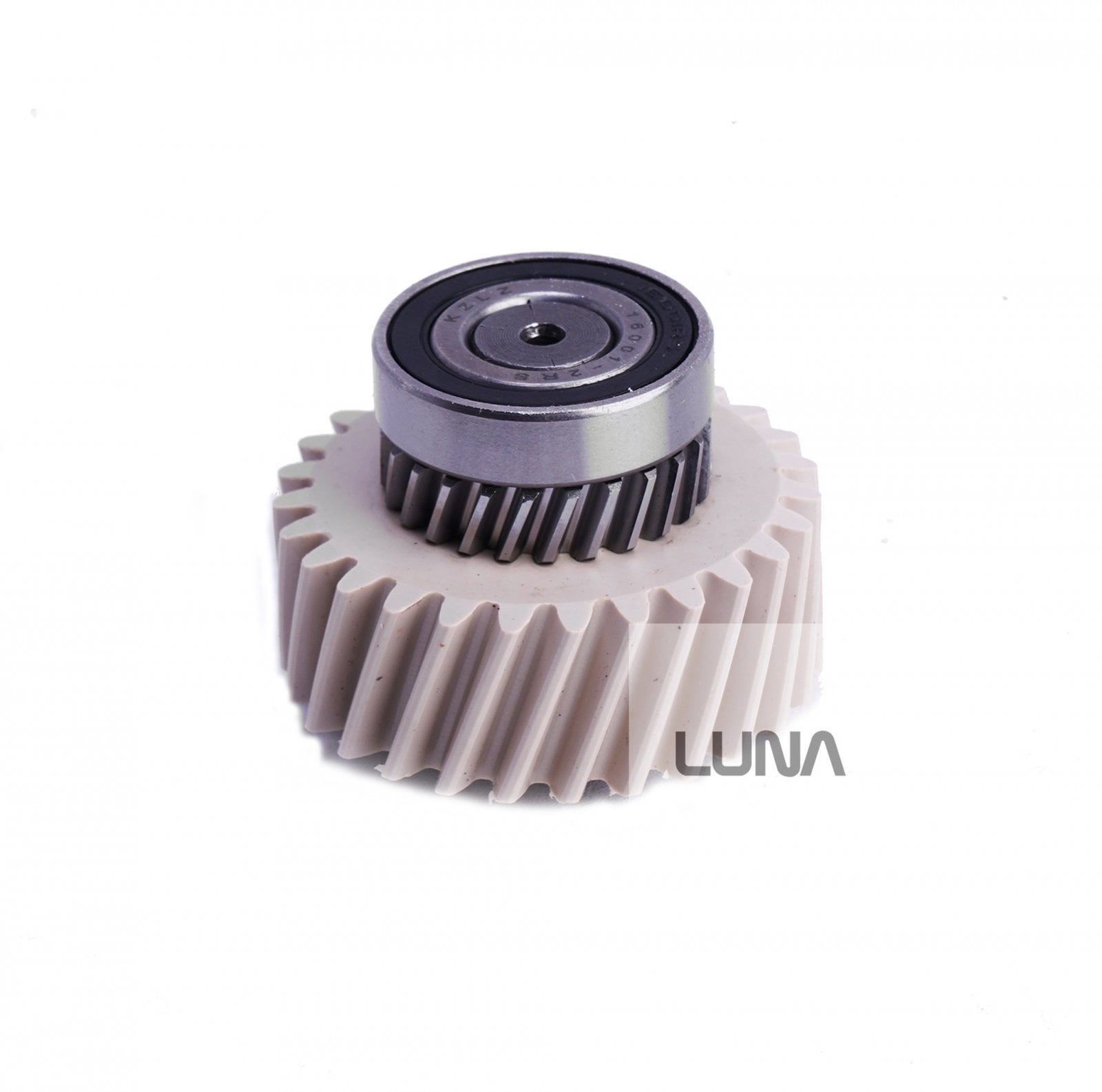

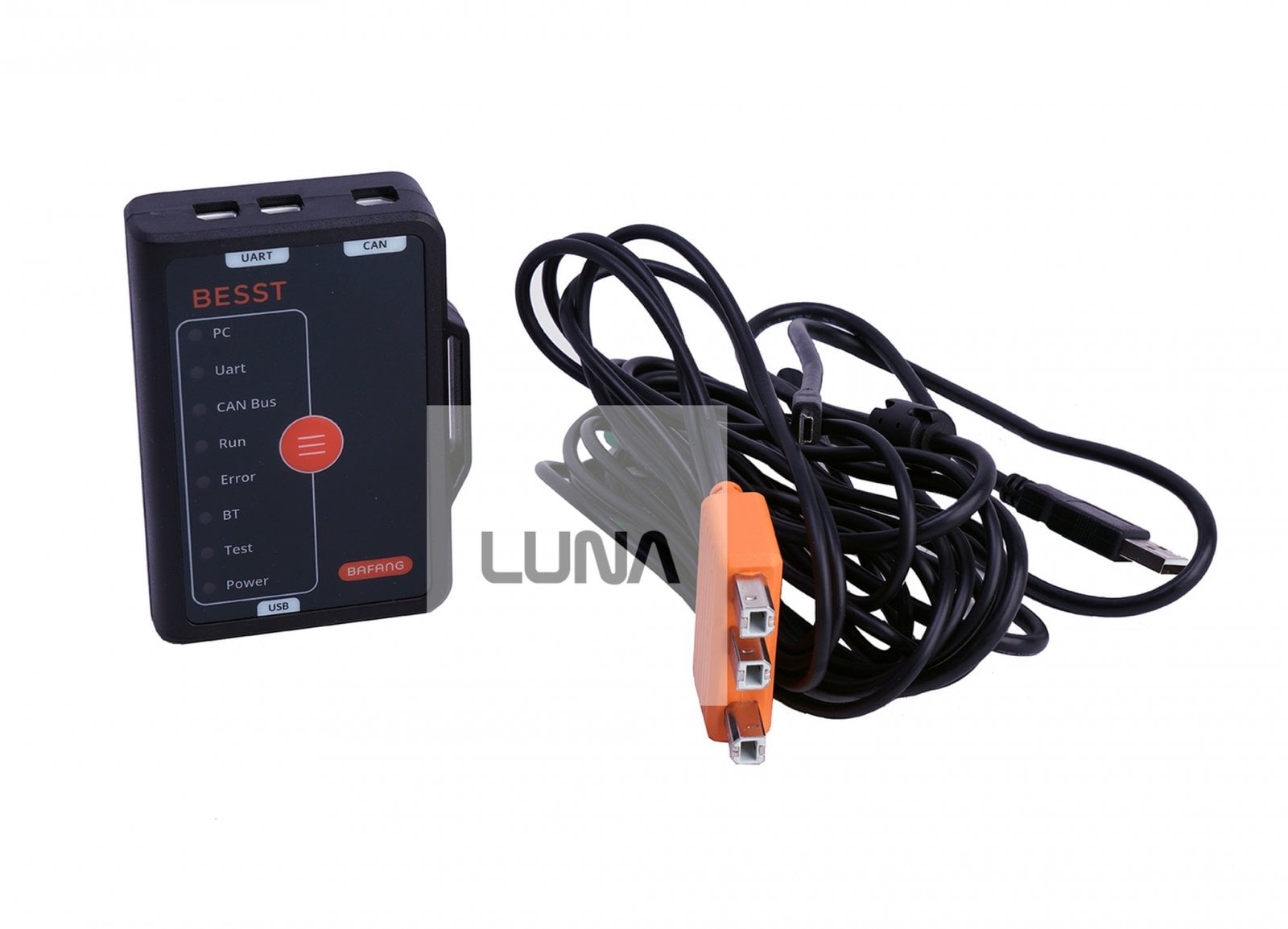

Time will tell with the M600 setup and changing the internal reduction motor gear with the Luna cycles nylon version and uploading the Luna firmware via their BESST service tool has improved the sensitivity from torque sensor and brought the noise level down dramatically.

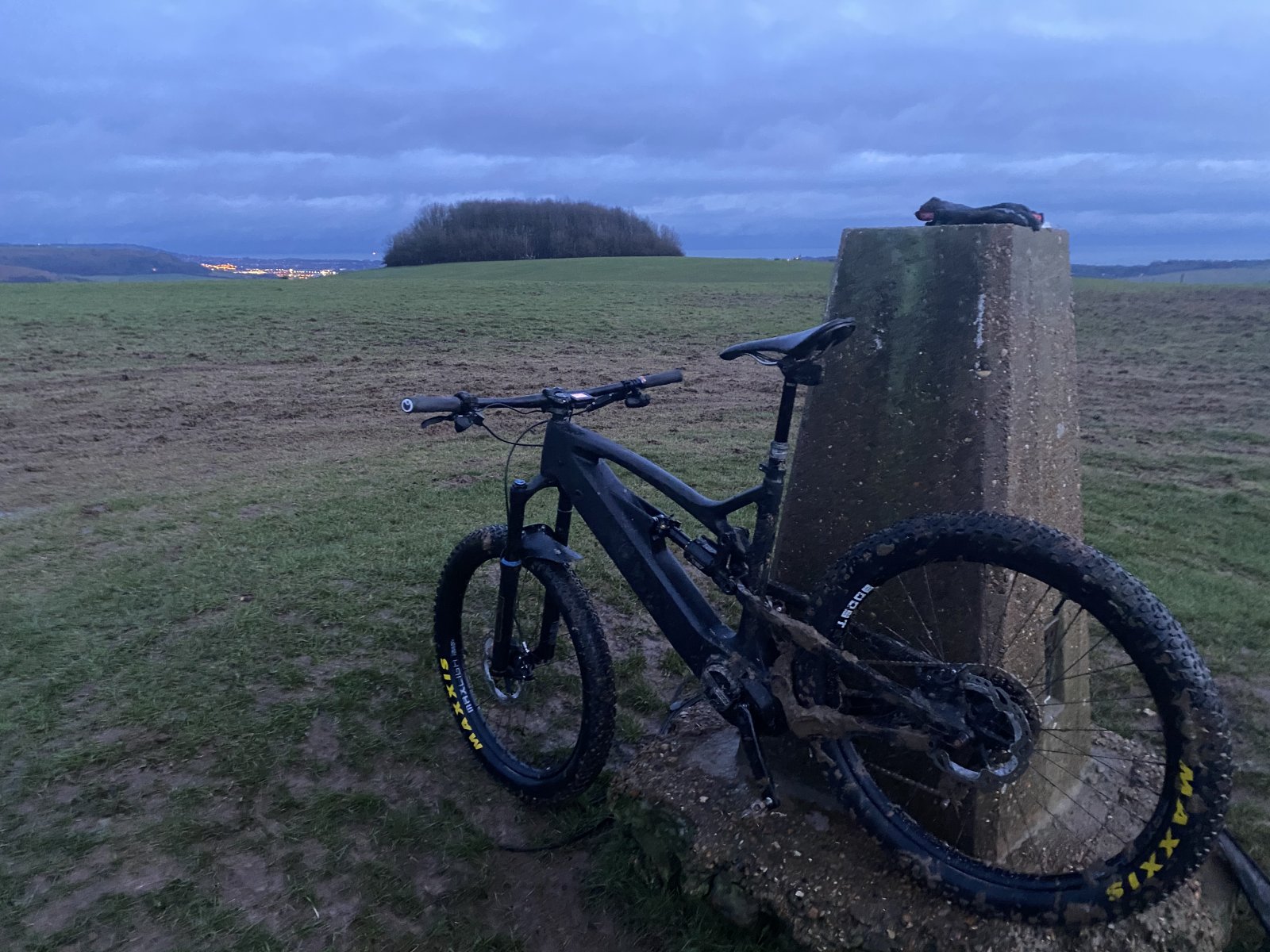

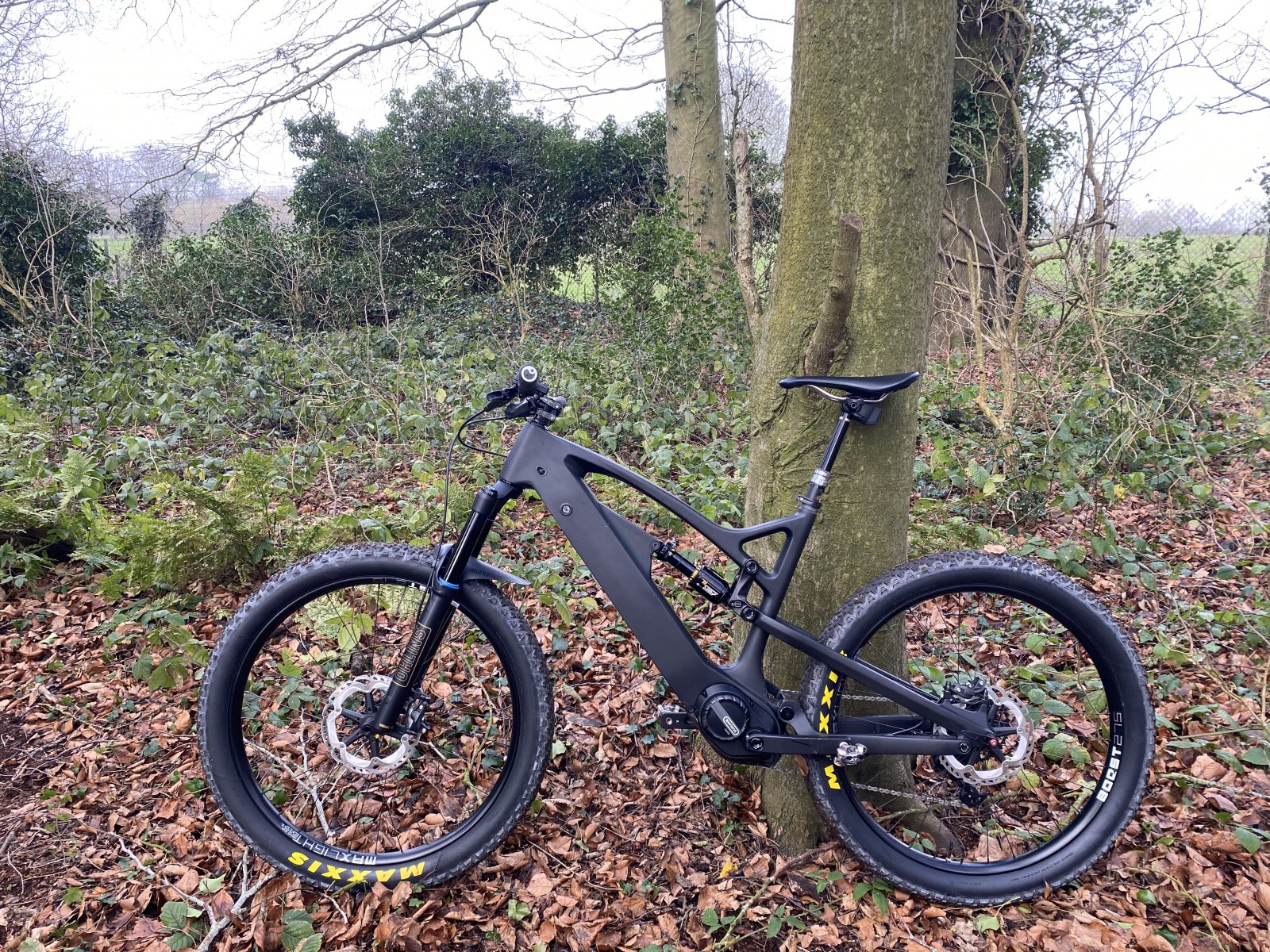

Great 1st ride with mode 3 of the 5 being the most suitable when climbing or technical elements. Rode through 6 inch beach pebble gravel for 1 mile which didn’t stop the bike at all.
Shakedown ride complete, time to hit local woods test loop to get an idea on battery range as it has 48v 14.5ah (696wh).

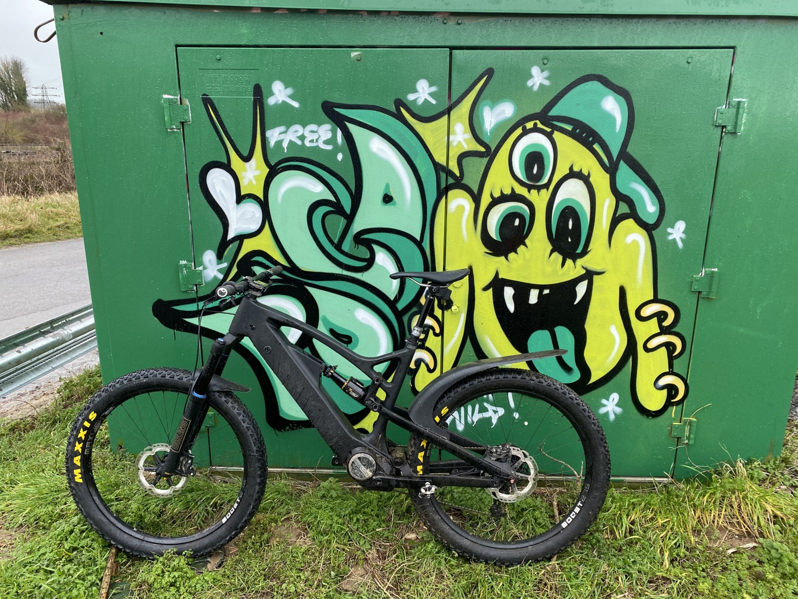

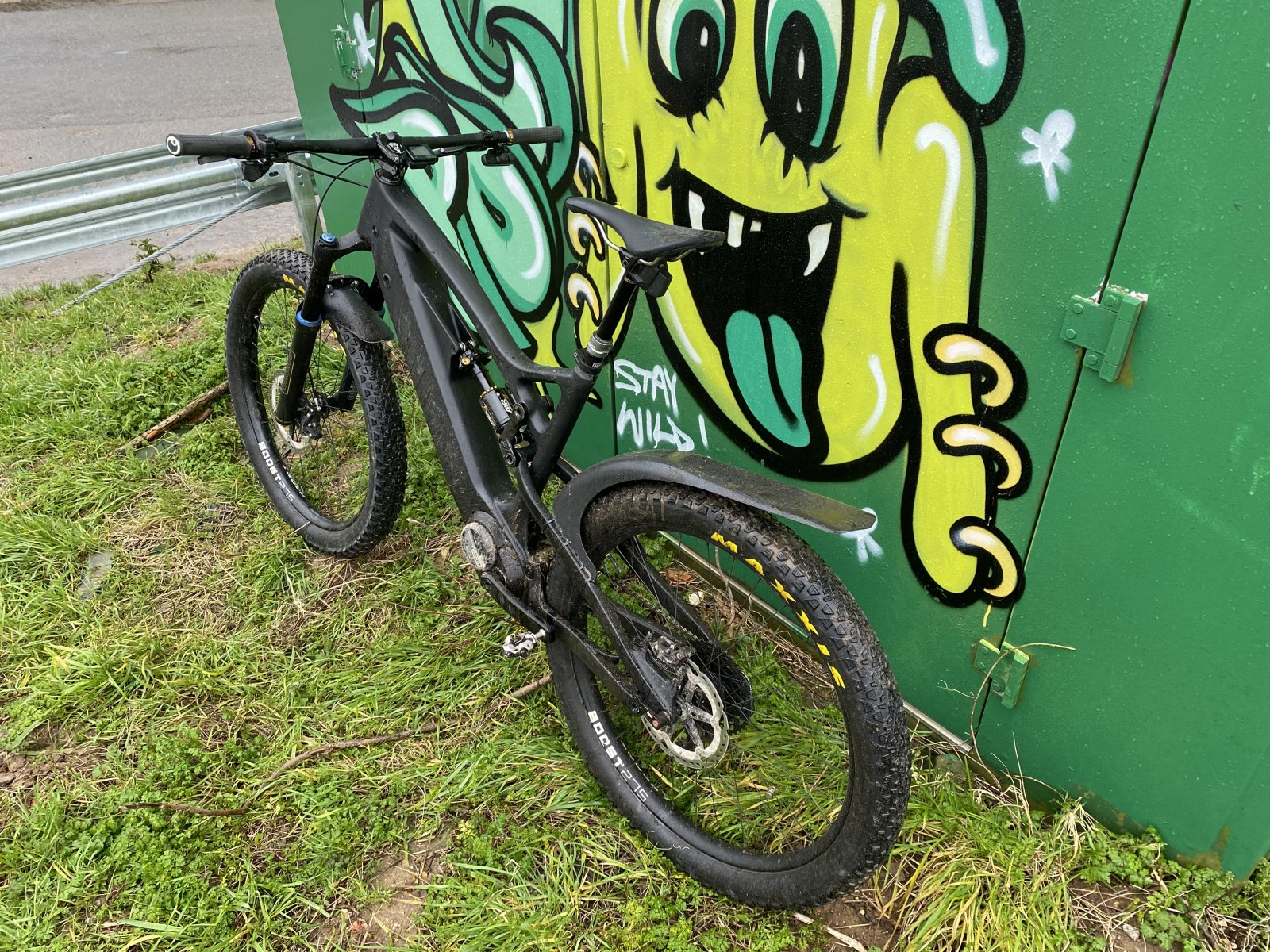

Great ride today. In these cold, muddy conditions the bike performed faultlessly. No electrical gremlins or issues with the frame. Mostly XC with a few jumps and rock garden trials.

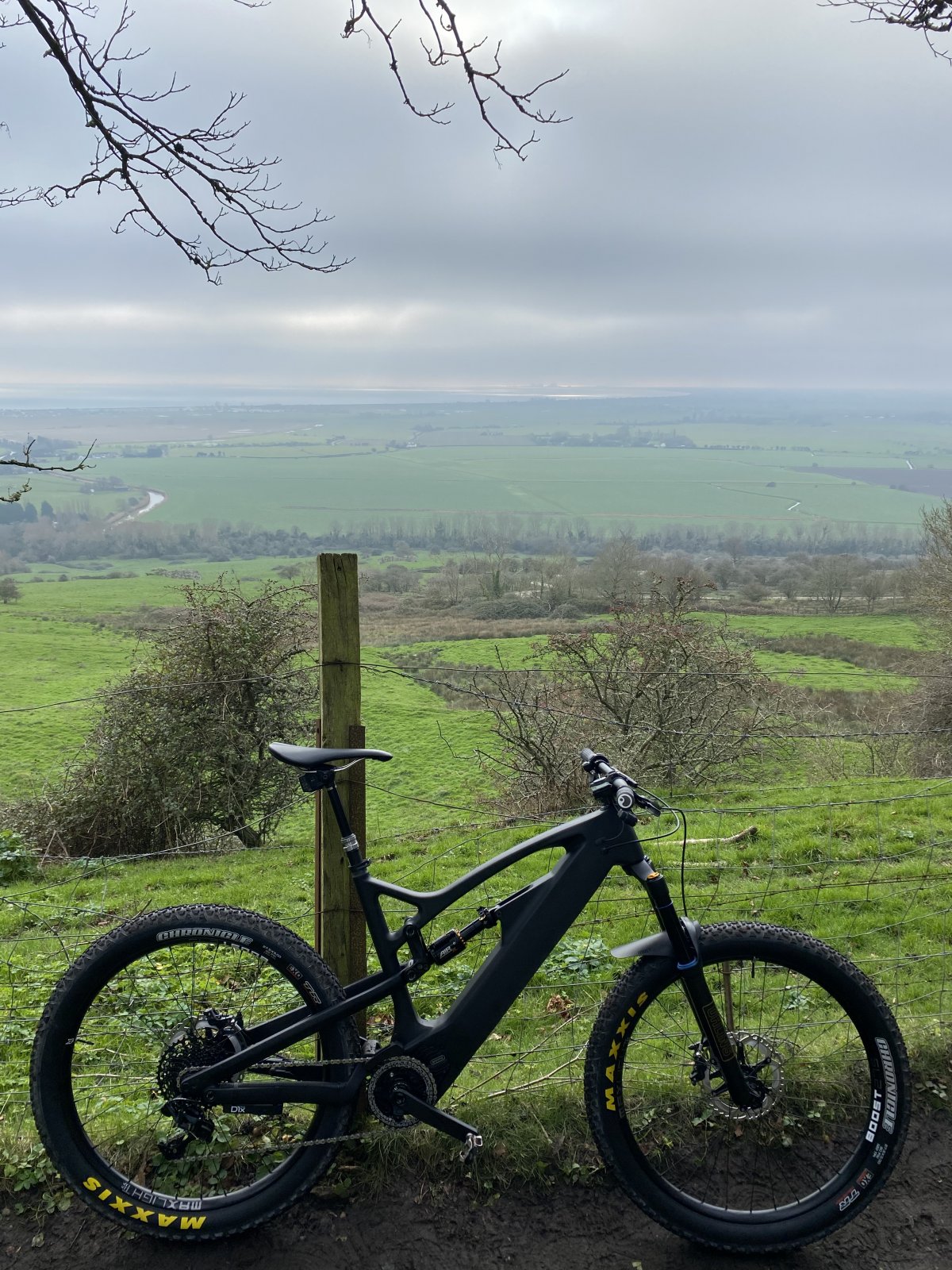

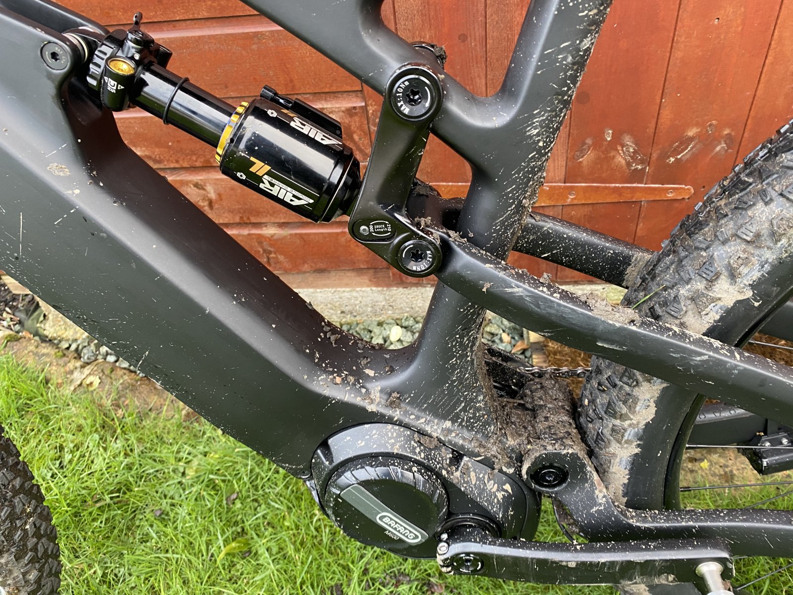

Loaded the Bafang firmware update and went for a ride through deep water and lots of mud. Faster than my Levo even in the dark with no lights?
I’m treating the bike terribly to prove it’s worth.
14.5 miles with 1300ft of climbing with average 16kph speed in mode 5 (Turbo)returning home with 30% battery.

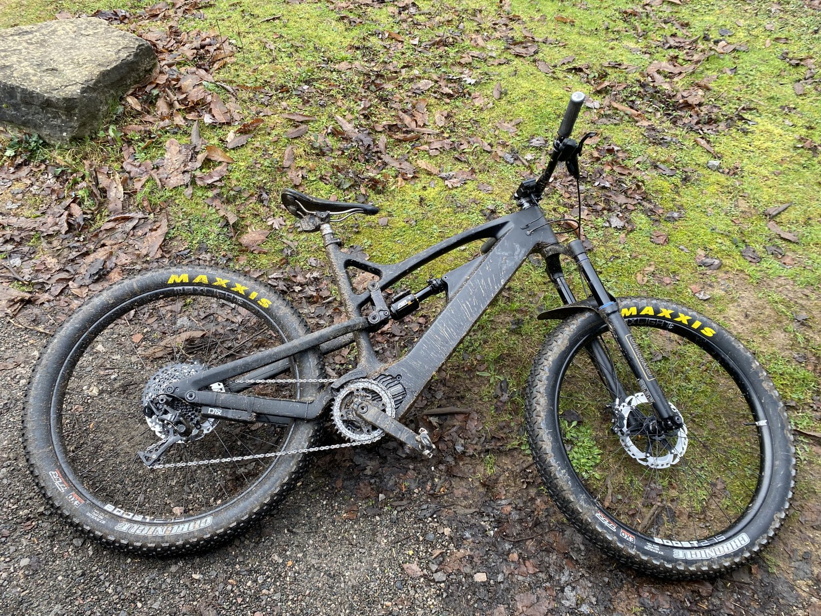

Bike performed very well today. The torque is very smoothly amplified. Torque sensor within the M600 is less sensitive than the Ultra motor which reduces the ‘kick’ felt by riding the brose 2.1.
Mud, puddles and a few bogs I rode through didn’t spin up causing you to put a foot down in the sludge. Whether this is due to the plus tyres remains to be confirmed once the weather dries up.
Very happy to continue testing this ebike and when Bafang allow tuning of motor settings it could open doors to app compatibility and Bluetooth features.

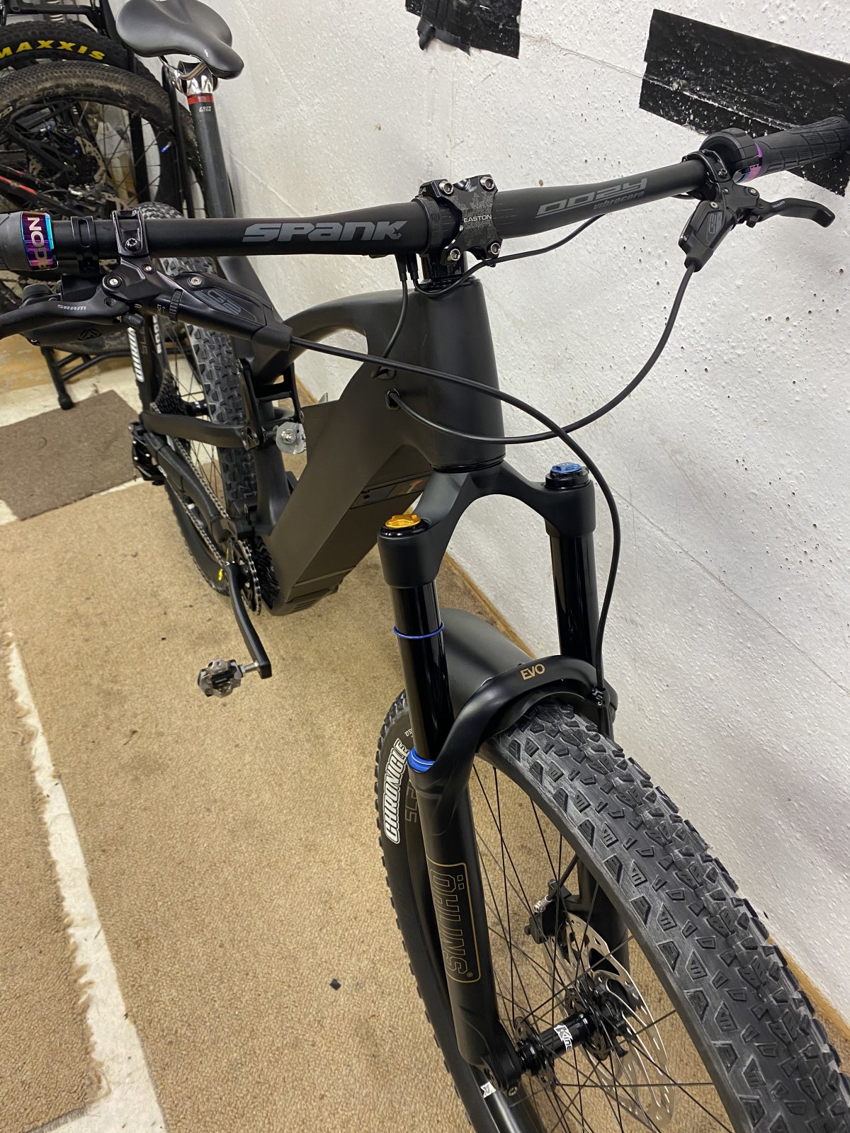

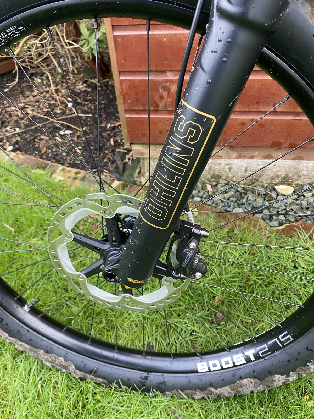

Outstanding build. I'm curious how you got the weight down to 21.4 kg with the heavier motor and almost 700 Wh battery, when Rob's build was significantly higher with smaller lighter battery and what looks to be a lighter carbon fiber frame. Wonder if you could give some details on lighter weight parts in your build?
TrailwattsUK
Trader
Aug 27, 2018
836
709
Kent
I’ll try to do a spec sheet soon. Rob is running a 800wh and all comes down to the small things like wireless dropper/ archer wireless system, selection of bolts, headset etc

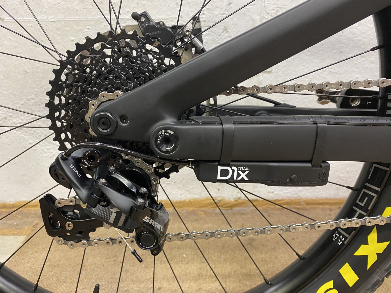

Thanks for the useful info on the M600. I have the E10 Dengfu on order with M600, motor has turned up but waiting on frame & batteries. This will be my first e-bike. I have an XC bike which will be a donor for some components including 1 x 11 SRAM drivetrain. The10-42 cassette cost me an arm and a leg (very light, machined from solid, a work of art), but I'd rather not use it if the M600 will be a cassette cruncher, I'd be dissapointed if the cassette only lasts a couple of months, a couple of years is OK.
Normally when I ride a normal bike I'm careful to avoid shifting under load, is this easy to do with M600? I had a quick go on a mate's SWorks Turbo Levo, and sometimes it was difficult to avoid painful cassette noises from shifting under too much load because motor was still running after I stopped pedalling, but that could just be my lack of exerience with the bike.
I noticed in the photos above that the Seroxat has a gear shift sensor to cut motor power during shifts, but the Dengfu kit doesn't include this, does it matter?

If you learn how to shift, no need for sensor.
