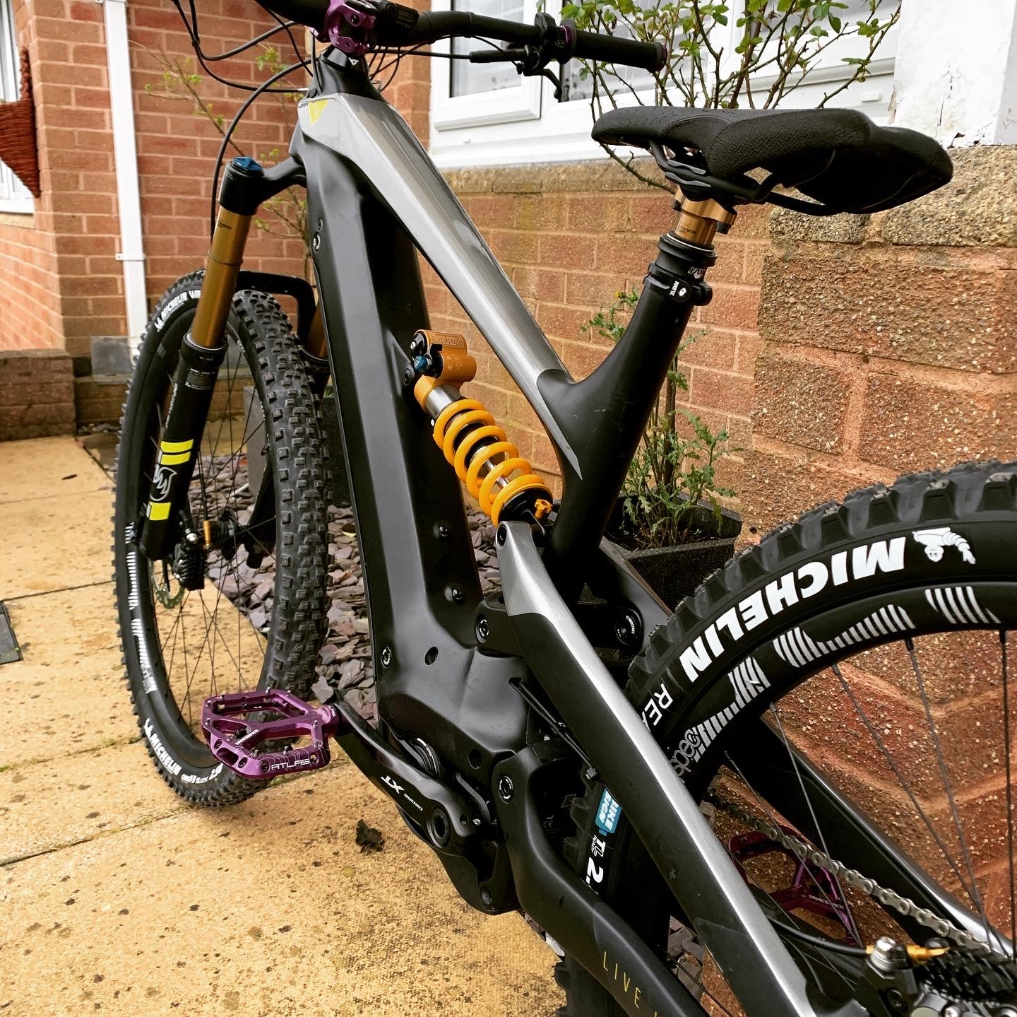

After weeks of struggling with suspension tunes I decided to go with a coil shock as some of you already know. I have been meaning to post this for weeks, sorry its only now I have had the time. The fork on the other hand is still not correct for me so im considering changing them to a ultimate lyric or the new M.2 Öhlins RXF 36 or possibly a coil setup. Some people may have known that the E-bike 36 factory fork by fox has 36mm stanchions and lower legs but 34 internals, damper etc with 3 volume tokens as standard from YT on this particular model year. After adding a token to the already ridiculous harsh ride it did seem to help, but after all day riding they begin to feel very fatigued and slow. I have now removed the token I added, plus one more to try and regain comfort, this seems to work better but I am blowing through the travel a lot easier. Overall the ride is better and I have a lot more grip but there's not enough support in the top stroke witch is a obvious result from removing tokens. Has anyone change the fork for a coil fork? has anyone tried the ultimate lyric or the Öhlins air fork? There just doesn't seem to be a nice middle ground with this fork. The bike is now on Michelin E-wild rear and AM wild front with Cush core installed, 15psi front 18psi rear. I will more than likely drop to 12psi all round as there is more grip to find, and why not having the added bonus of the the Cush core. please let me know your opinions on the fork setup. cheers

Have you checked this thing isnt faulty?
What is it exactly you are trying to solve?

Harsh stiff ride while riding rocks, roots etc. Even riding on fire roads is harsh on the hands and No grip. I have solved 80% of these issues with the wheel set up but fork is still very vague and I feel it’s under performing.

How do you find the Öhlins? Been thinking of getting a coil as well.
Best upgrade I have ever bought for a bike. It can be tricky picking the right weight coil but once it’s correct you never have to worry about it which is another reason why I like it. I don’t wanna be messing about, I just want to ride and with the coil it’s consistent. The öhlins is plush and has a great balance of grip and support. The grip and feel between the öhlins and the x2 air shock is impressive. The x2 is plush but can be too progressive at times and can feel harsh and stiff. The öhlins doesn’t feel harsh at all it’s just plush constantly and it gives more confidence to smash through anything. The down side is if your bottoming out the shock by changing your riding style or trying bigger features the spring will need to be changed, they are not cheap at £95 a spring, there are cheaper alternatives but it can be hassle. The other down side is the weight. It’s very noticeable but by having the motor it gets cancelled out in a way but it will drain the battery quicker. It’s not a huge amount but it did have a slight effect on the range. The balance of the bike in the air has shifted slightly to the rear but again it’s not as bad as I was expecting. I think a coil shock on a E-bike is the way to go in my opinion

What is your weight and what spring rate did you end up with?
My weight is 160lbs geared up and was originally on a 400lb spring (31% sag). The bike felt good but drops and jumps felt harsh as it blew through the travel and bottomed out pretty easily. I am now on a 450lb spring (27% sag) and the drops and jumps are a bit better.

Sounds like your tyres are rock hard to me.
What casing are you running and at what psi?
Just out of curiosity, have you serviced lowers on Fox 36 and check if there is not exesive amount of grease in the negative air chamber as often mentioned on web?

Service the forks first, likely the air spring has a huge glob of grease in it creating harshness.
The best mod for these 36 E forks is a Vorsprung Lufftkappe, despite the documentation saying it is not compatible, I can assure you it fits and works perfectly. Buy the Fox34 version.
It increases the negative air volume considerably and improves mid stroke performance. Well worth the cost.

No I haven’t serviced them, I bought the bike brand new January this year and it’s only had about 5 hours of riding since then.

I will certainly bare this in mind, I don’t want the cost of changing the forks if this problem can be solved.

yes that is the correct Lufftkappe for your purpose.
A coil conversion adds approx. 500g to a fork. I do Vorsprung Smashpot conversions all the time. There is 120ml of Oil added just to the spring side leg alone. The Push ACS3 is slightly lighter however the Vorsprung kit is a better solution IMHO.
Once riding, the weight is negligible, the performance increase is huge. On an ebike the grip generated by small bump sensitivity & sprung weight of the bike is amazing.
I strongly suggest having the fork serviced first, the air side will most likely have a big glob of slickoleum on the transfer port dimple creating harshness. New seals, foam rings and a good cleanout will reap performance gains for small outlay.
