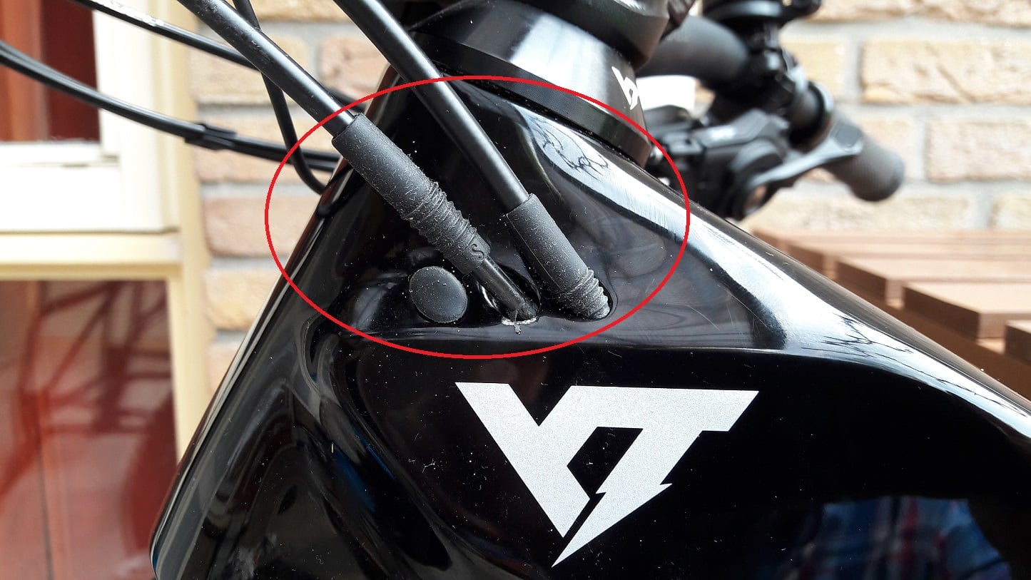

I have 2 additional water inlets: the cable plug for the gear and the cable plug for the dropper. After each ride these plugs have just about free-ed themself from the frame. On the photo even the gear cable shows some wear. I have tried silicon spray between plug and cable but that doesn't solve the problem. Glue them to the frame... ? Any other hack ?
An very expensive solution would be to go wireless ?
A little zip tie will keep them in place

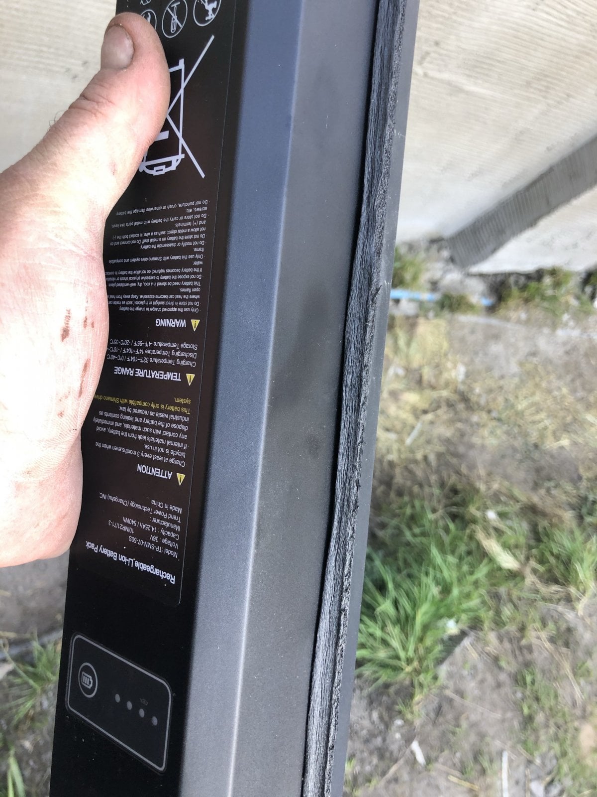

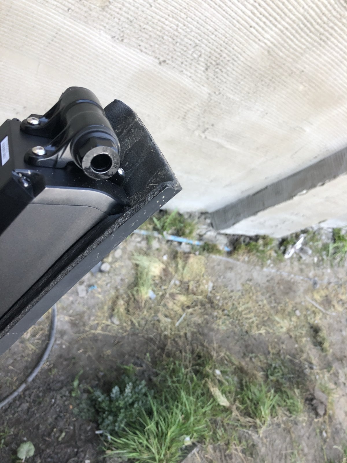

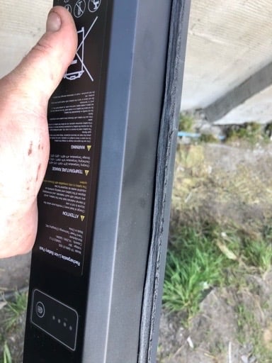

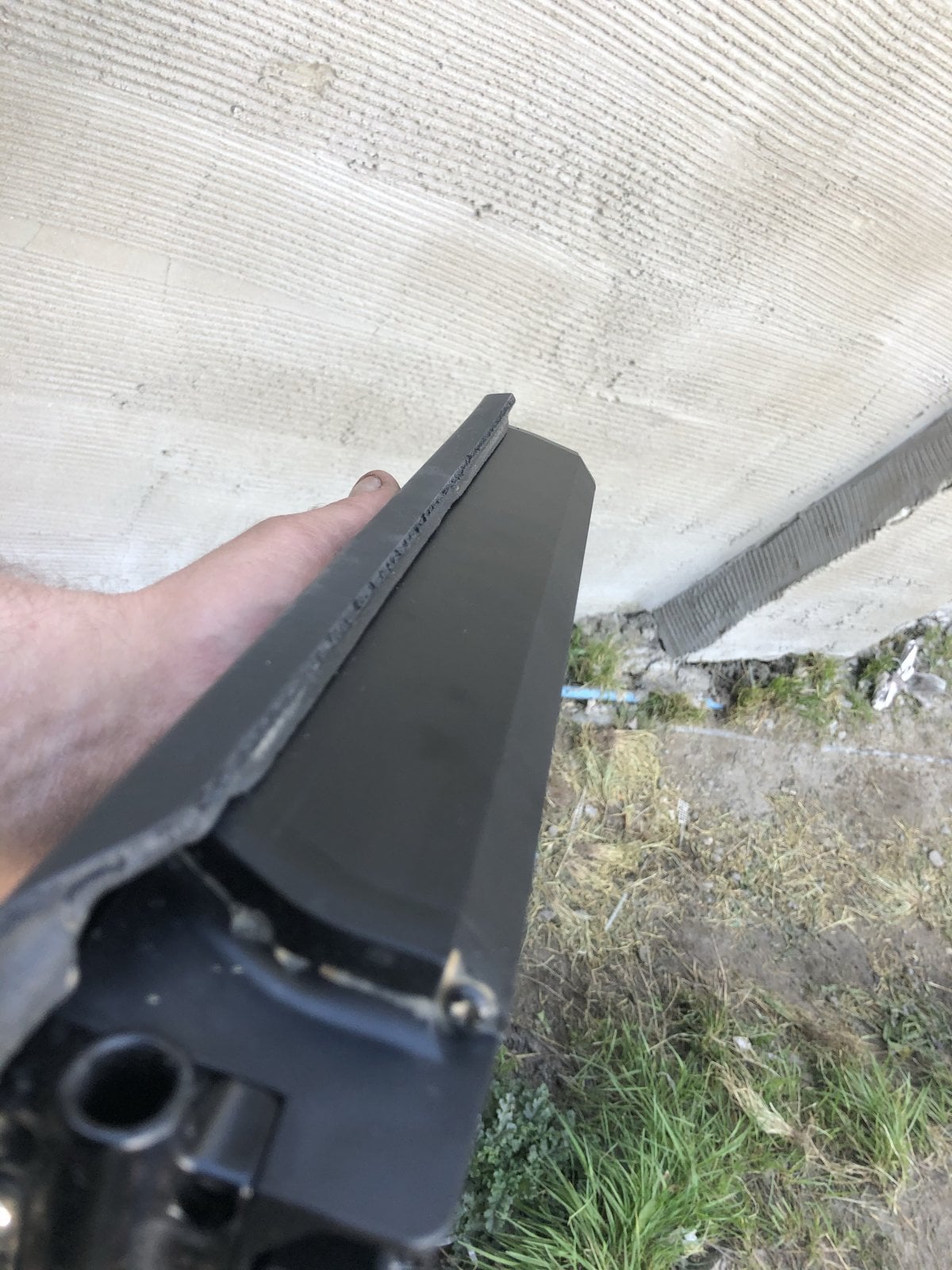

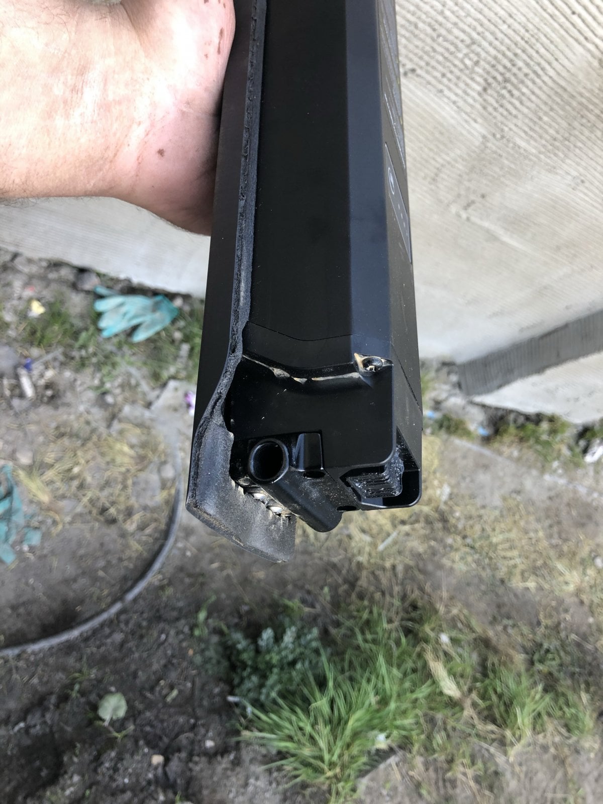

Some more battery issues fixed might help someone. So my mates decoy has been playing up well his battery was, now an then his battery would just turn off, an the other week we stopped to get over a gate an his bike turned it self off, An would not restart tried it in mine an nothing mine in his an works so defo battery. Now when we refitted his battery I pushed it up towards to head stock the bike turned on. It seems as tho the contacts on his battery are too far away. So I put some small washers at the bottom of the battery lower mount to push the battery forward. Bike works perfect an has had no faults for a couple of hundred miles
Did the same thing and no more shutdowns ever since. I used washers from my flatpedals lolololol

That battery’s are strange as in they look adjustable with the bottom holes elongated but are not. I just used some stainless washers an his bike works great now. Glad urs works mate
