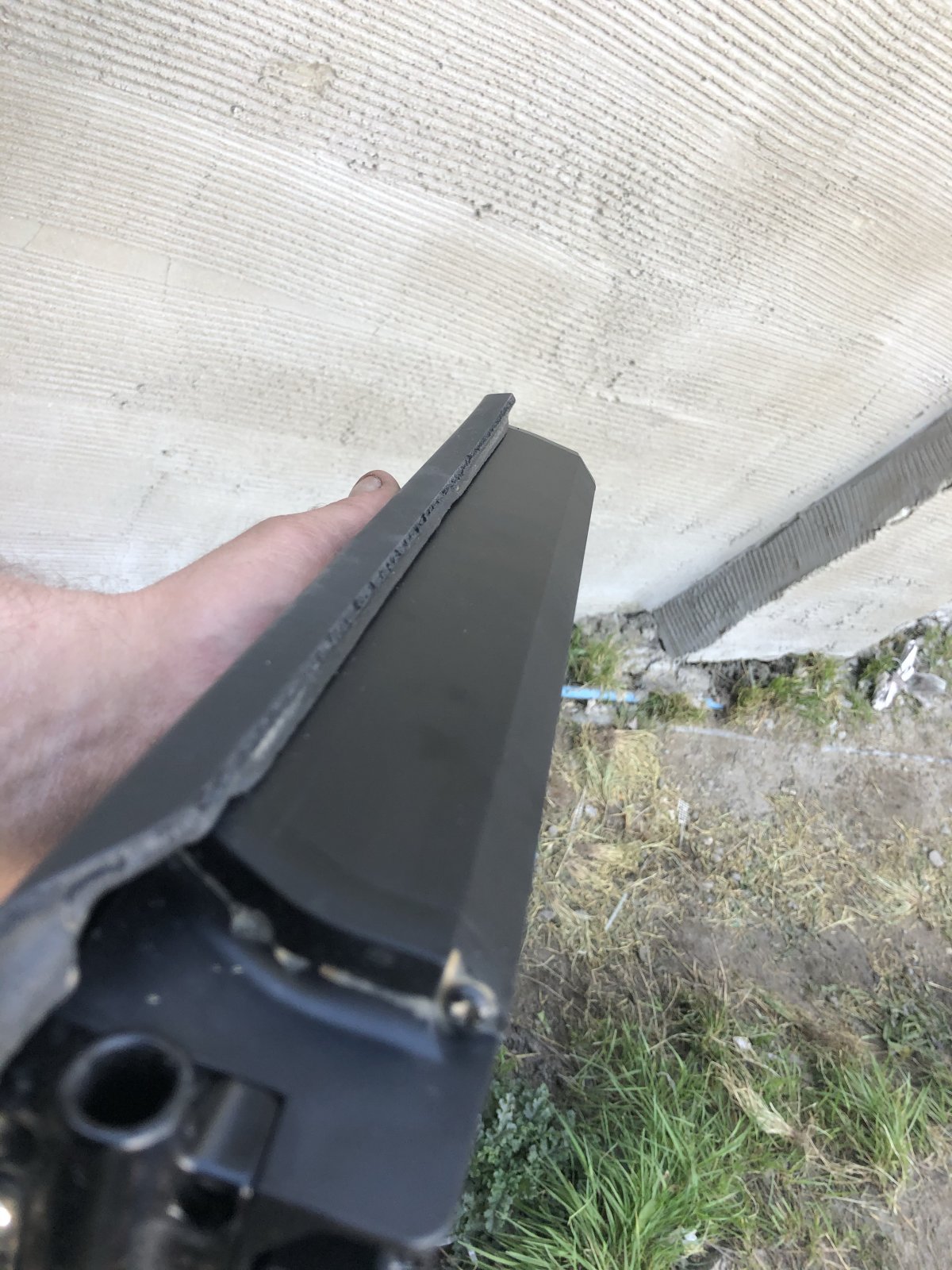

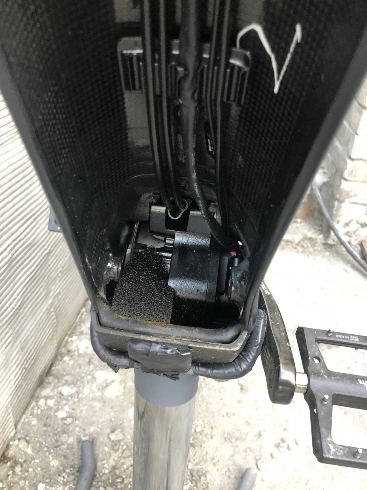

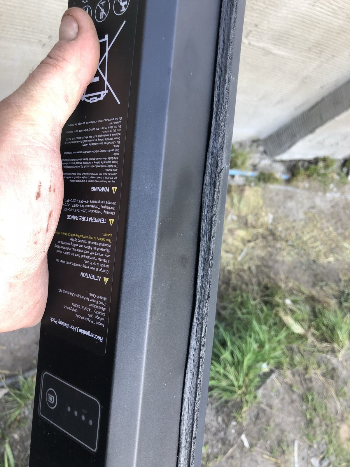

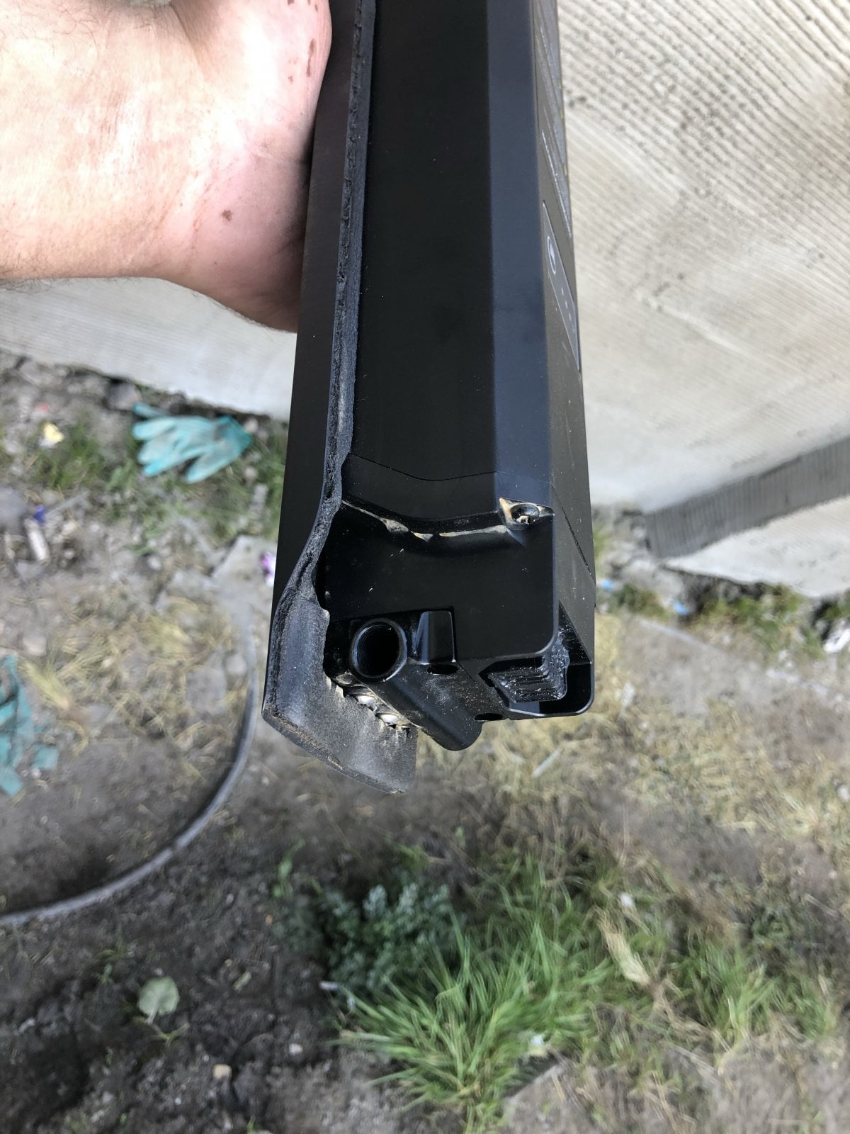

I used a acf50 on all electrics all around motor etc just stay away from ur brakes
Then I made a gasket to fit around the battery I will take a picture as promised to someone els it only took minutes to make out of 3-5mm 3m foam. I swapped my wheels out after 20 ish miles as could not handle the crap e13 cassette. I invisiframed it as soon as I got it. I had to make a shim for the rear pivot as the rear triangle was hitting the frame an making a horrid noise. My best mate bought 1 a few months later an all hes done is invisiframed, acf50, an battery gasket an his has been all good
Yes, please do

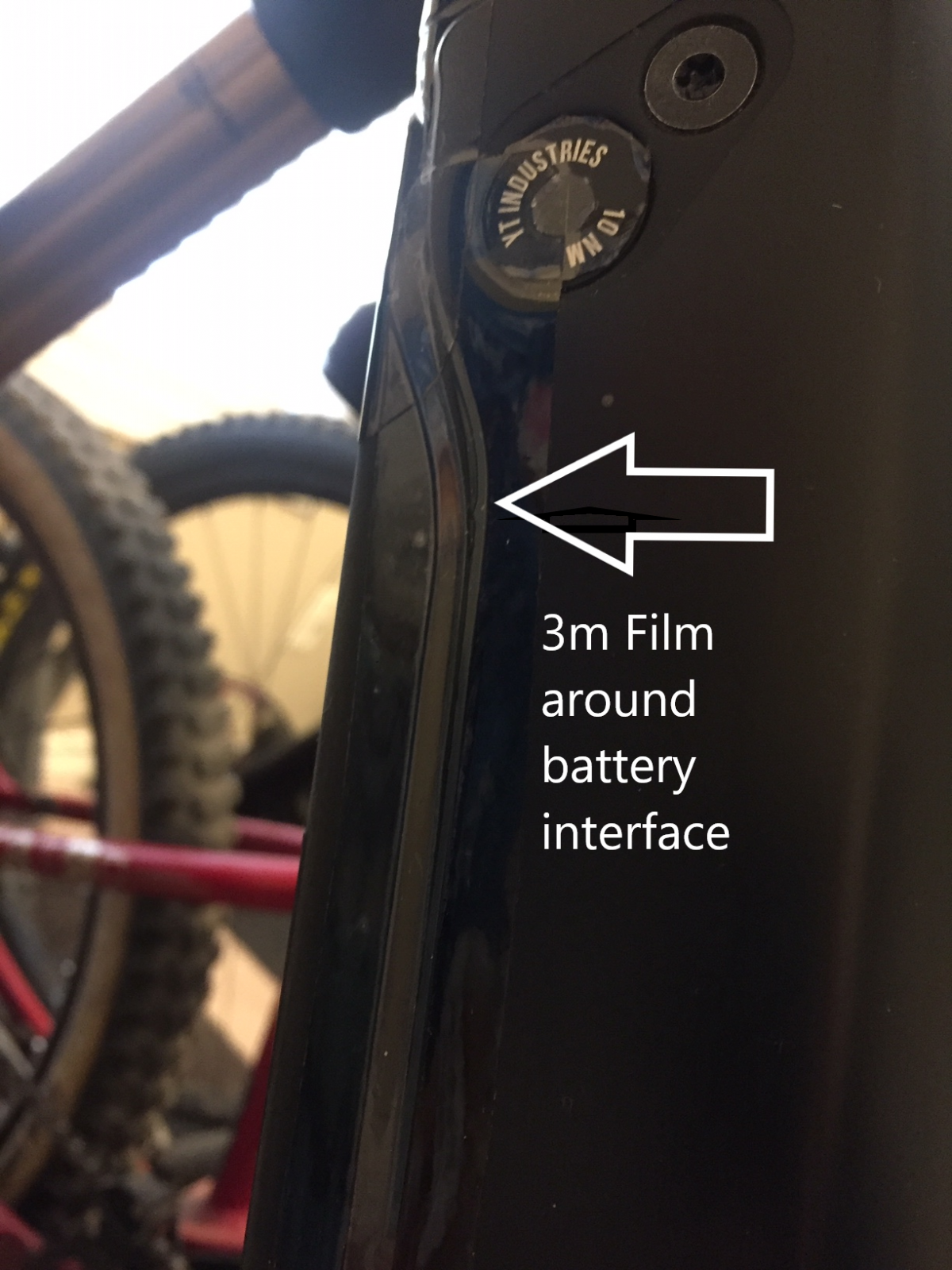

TransAmMan
Sep 18, 2019
154
142
Canada

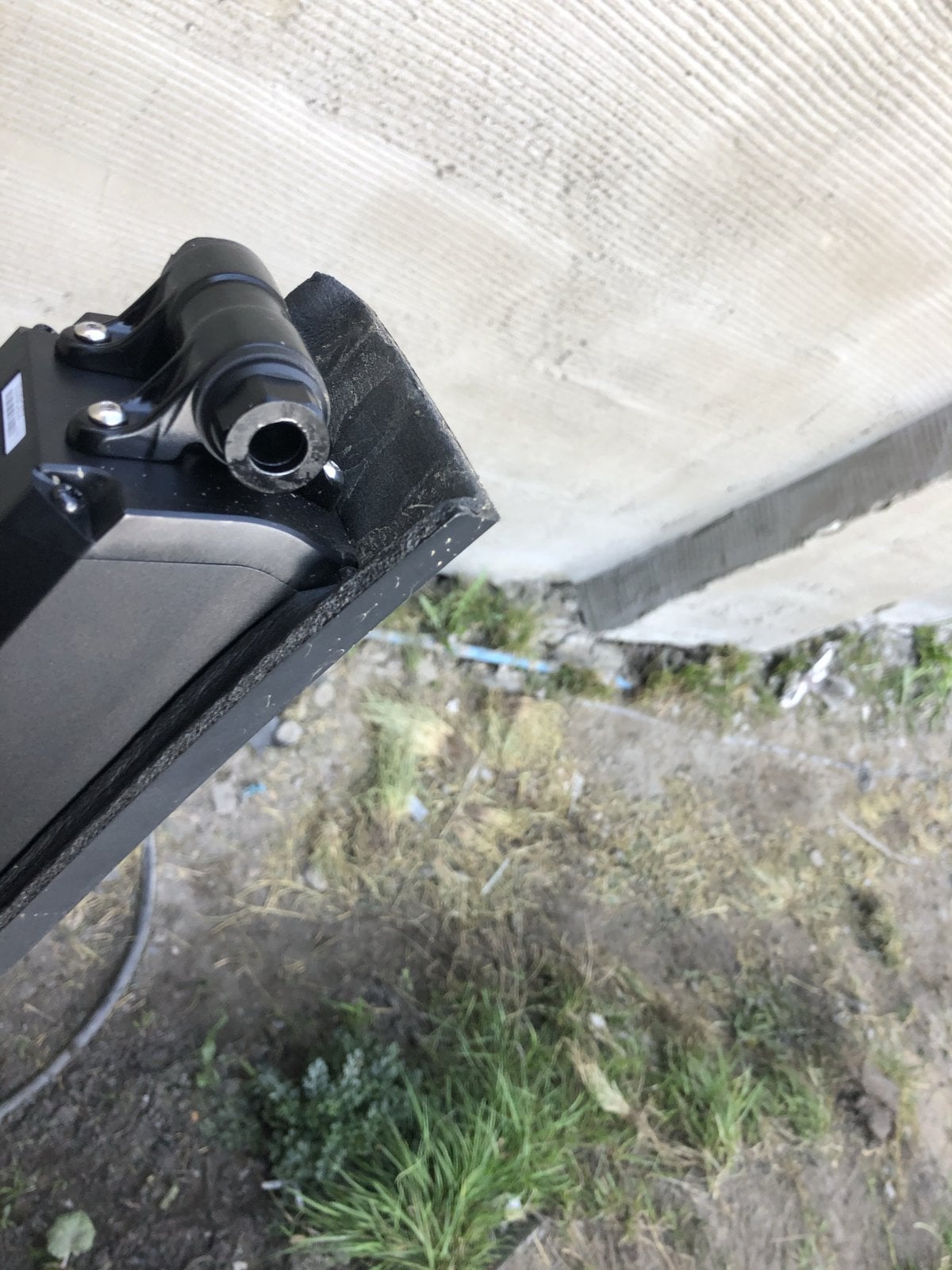

cheap to buy .. 3M clear plastic and 100% watertight
^^ the 3M foam idea looks good too. Do both and you can ride in a monsoon with no issues
Well around the battery anyway .. don't have any motor tricks (y)
Fatbap
Feb 15, 2020
153
150
Rhondda south wales
ACF-50 anti-corrosion like this?
ACF-50 Corrosion Block
Acf50 anti corrosion inhibitor warm the can tho in hot warm water shake well an spray fo a mist remove the straw but a little does go a long way an what ever u do don’t get it on ur brakes

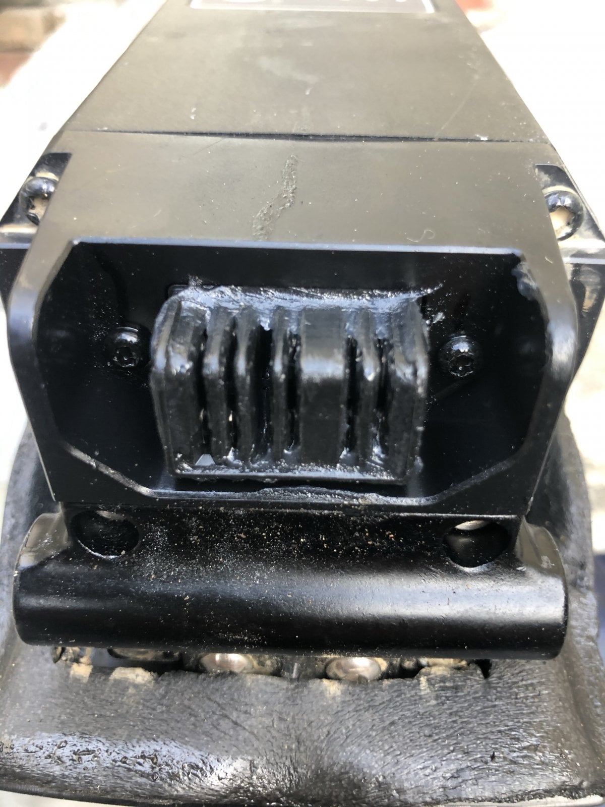

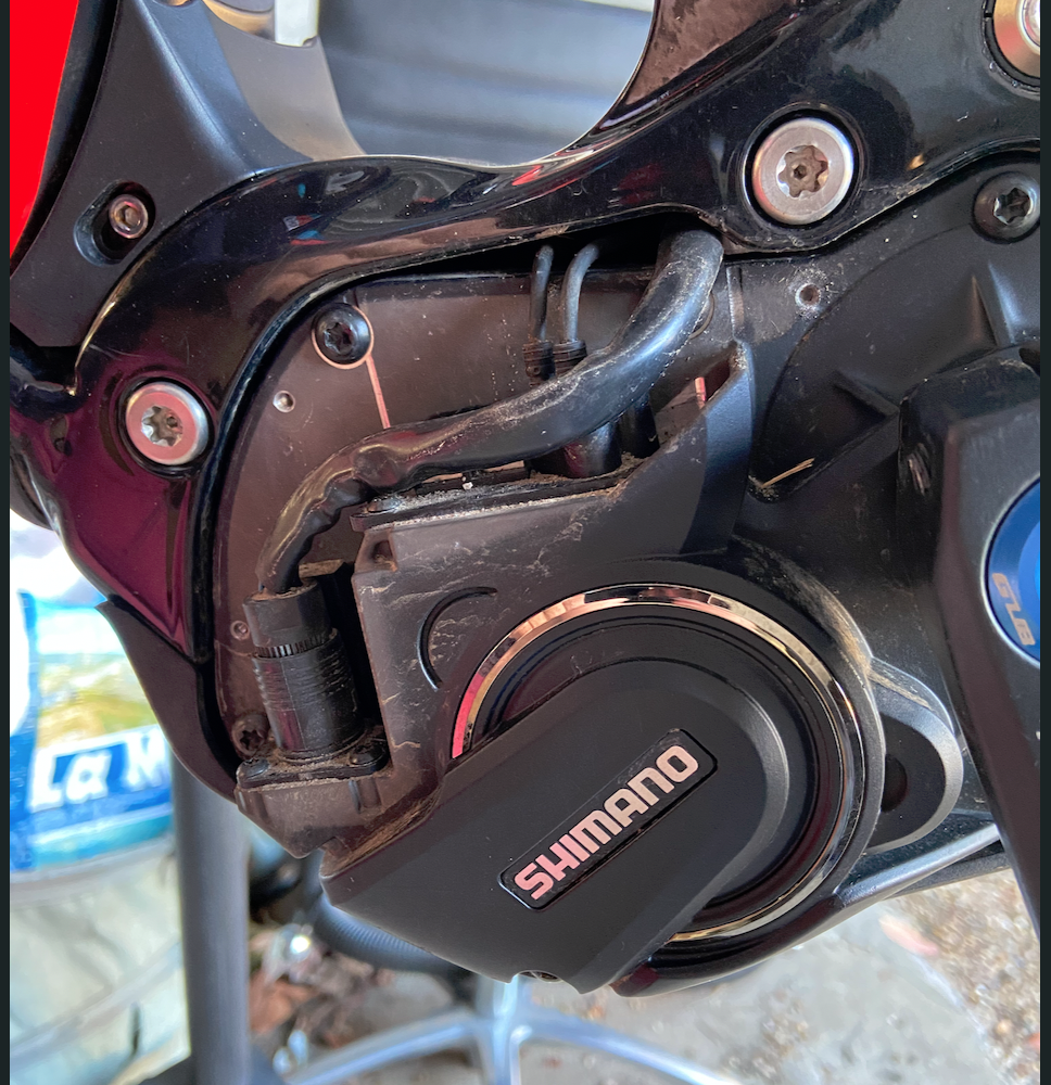

As a general point with the shimano motors, they have a tendency to get crap behind the access cover on the LHS for the cables - it is worth taking it off (3 screws that are very small and easy to loose!) and cleaning it out once in a while. You could also put a small piece of moto foam in there, or some electrical tape or similar over the edge to prevent crap getting in. This is the area in mine, Its pretty clear due to recent dry weather.
Kvasi
Mar 27, 2020
10
22
Norway
YT Decoy
9,190
So you cant access the port without dropping the motor? Serious design fail IMO and a lot of problems stem from crap and moisture getting in there. Personally I would drop the motor and put come Moto foam above the motor between it and the frame to help.

Foam is nice against dust. But it could be a major issue about thermic aspect. No more fresh air to cold the battery...
Tbh mate it don’t get that hot I have removed it after a ride an it just feels warm. Granted i live in South Wales an it don’t get crazy hot here. I’ll keep a eye on it tho an if I do get any issues I will post it up. 130miles so far so good

You do not need to seal the whole perimeter of the battery only the top edge area. This will prevent crap getting on the terminals but allow a bit of air around it for cooling. The main things in a wet Scotland (I live in Innerleithen) is to :-
1. Always make sure the charging port cover is in properly.
2. Every few rides spray wd40 or similar into the charge port socket and blow clean.
This prevents the main and most confusing problem I have had with my Decoy. You can be riding along and get an error which stops the motor, a reboot will then not get past the Startup screen. This turns out to be a bit of crap in the socket which makes the system think the charger is plugged in and puts the system into "charging" mode. I even sent my bike back to YT with this issue and eventually had to diagnose it for myself. I have now had 10 months of smooth running after a few weeks of major frustration.

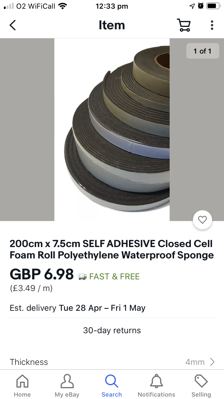

Something like this (4mm thick)?
https: //www.amazon.ca/ dp / B07PBSBNRM/

Something like these will do an just trim the excess down with a blade

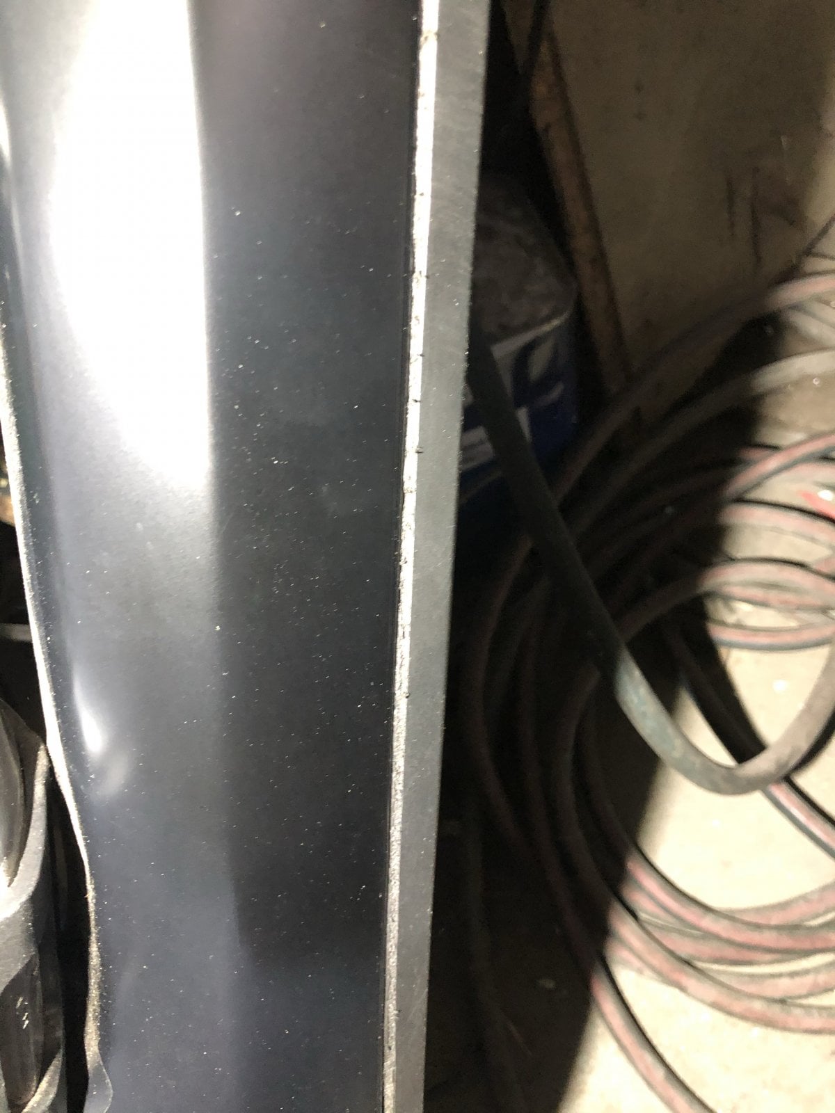

I use black electrical tape to seal the gaps along the downtube. Gets quite wet here in North Vancouver in the winter.
