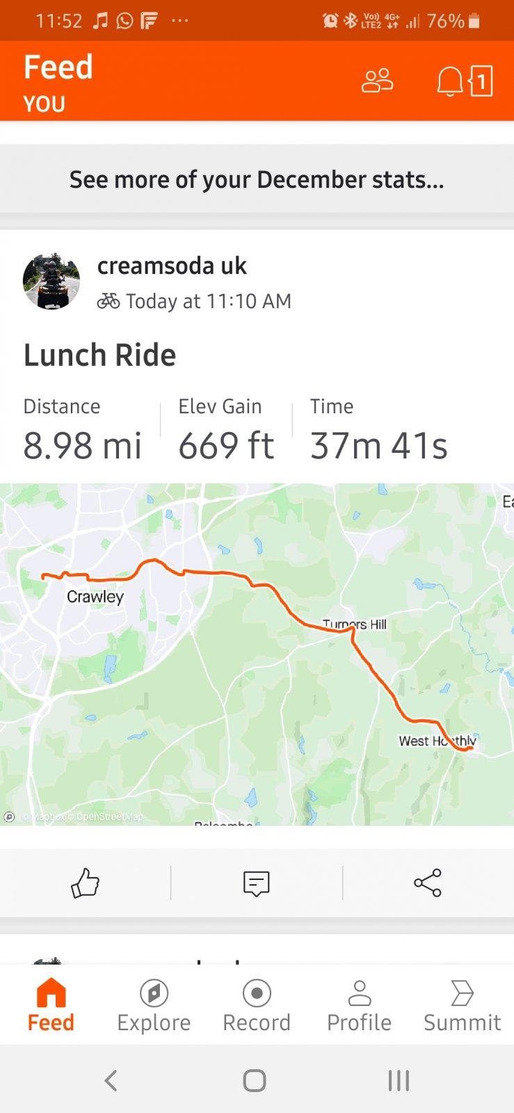

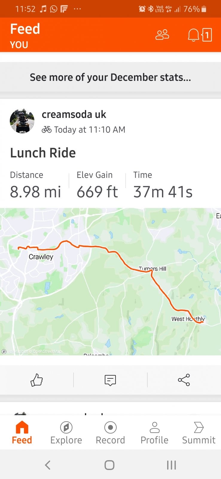

I have had mine a few weeks now but what an amazing bike!
It's a lot of bike for the money .
For some reason it's still €2000 in mainland europe, so you guys are saving at least €130.
Watch your strava, I think you're set on "ride" and not "e-bike" ... so if you get a KOM you'll end up getting lynched (and giving bad press for the e-bikes).

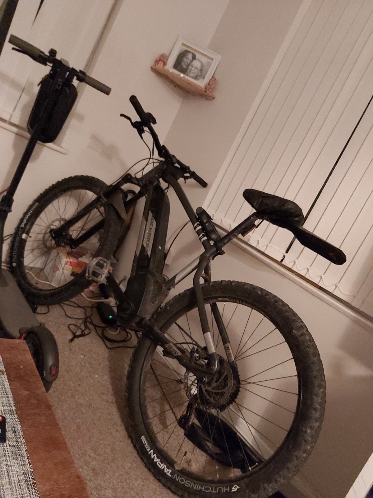

Still enjoying the E-ST900.
With the amount of mud around the Taipan tyres are useless, will tuck those away for the drier days. Just ordered Michelin E-Wild 27.5 x 2.8 front and rear. Was a toss up between these or the Eddy Currents but the Michelins are over £20 cheaper for the pair and are in stock at Tredz (UK).
Only other thing to report is during really heavy mud use chain has eaten into chainstay arm due to derailleur sticking. Also small plastic chain guide on right of motor cover has small crack in it so spoke to workshop at Decathlon Oxford and they said it was part of motor cover but they will order a couple of covers up and then take the guide off for me. Can't fault them so far, nice bunch in the bike dept. (y)
