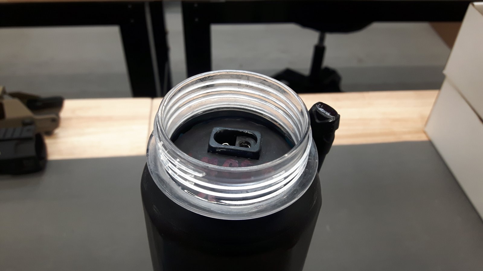

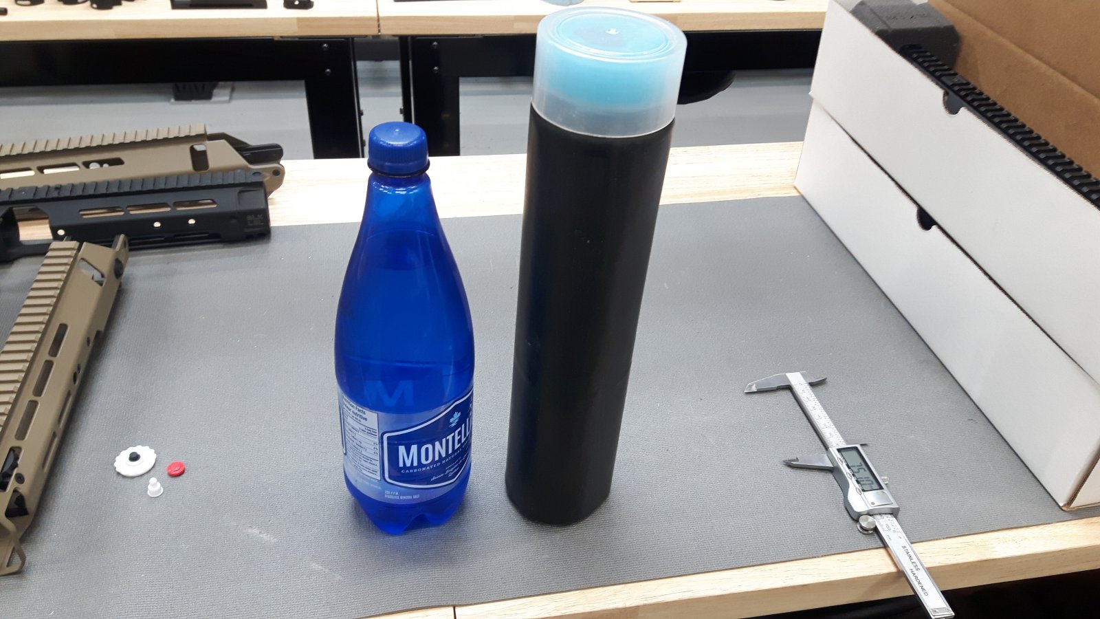

just wanted to share what i made, as i was fairly disappointed with most / all bottle extenders on the market, as they are all way to small "wh's" and physically too large for the wh's they give.

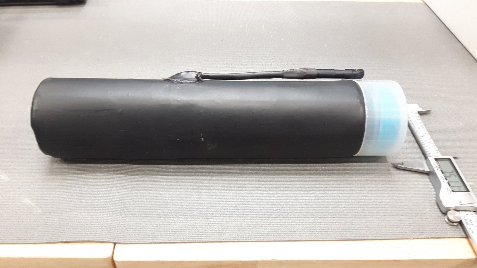

So i made, IMO, probably the smallest 700wh extender pack you can physically make. fits inside of a standard water bottle cage. its abit long but hey, it fits.
specs are:
52v bms (30a)
56x LG-mj1 (3500mah) arranged in 14s4p = 705.6wh
weight is approx 3kg
100% waterproof
i can use this in all of my ebikes to extend the range. i can also use it in my solar battery box or my homes solar battery, and even my protable solar battery inverter.
outside plug is the output.
inside plug is the input
about the same roudness as a standard water bottle, just alot taller

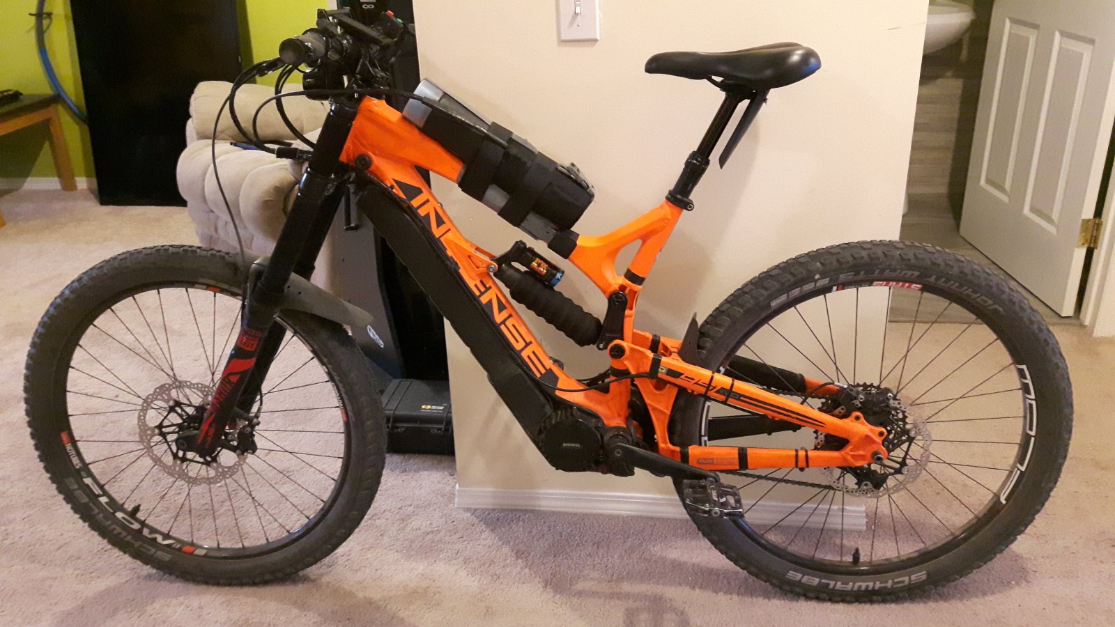

i really like using it in my BBSHD intense 951 hyper ebike as it takes the standard battery of 1,600wh and turns it into 2,300wh's!!!

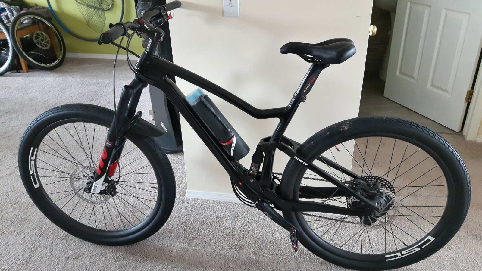

as for my custom carbon ebike which has an custom internal battery of 700wh, this extender pack makes it 1,400wh's of pure fun.
the only downside to this extender is that the cells are packed tight, and there is little to no protection if i was to ever drop the batt and/or puncture it. probably the reason why so many extenders on the market are very large.... to protect them from damage.
