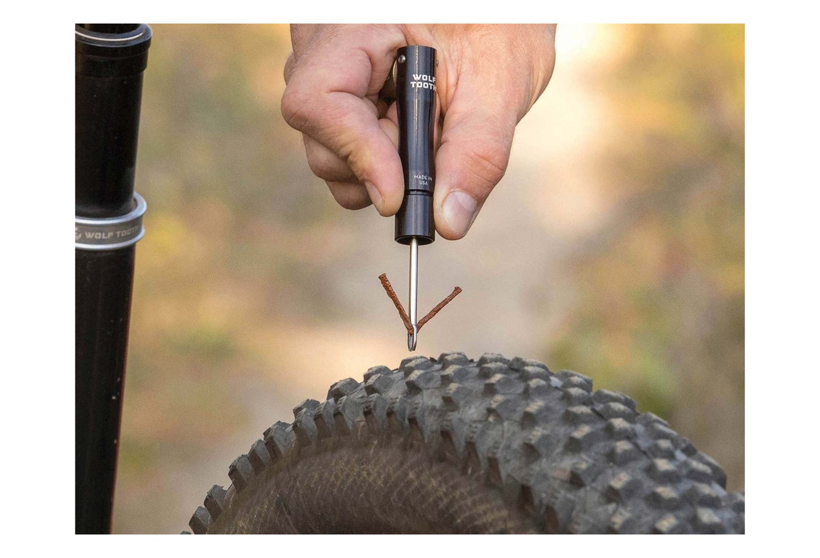

If your tire did not seal with sealant you thought you had in the tire, you either didn't have enough sealant in the tire or the hole was too big and you needed bacon strips. Always carry bacon strips! You should have been able see or hear the air/CO2 coming out of your tire if the leak was that bad! You don't carry a spare tube?

So, if I understand you correctly, you do not think Cushcore was worth it for you? As I mentioned in my original post, to repair a flat that does not seal with only sealant, I use bacon strips. Do you think that is more of what you were looking for? Finally, be warned, its going to be difficult for you to get the tire off with the Cushcore in it when the time comes to replace it! Its not to impossible if you take your time and watch the video.
