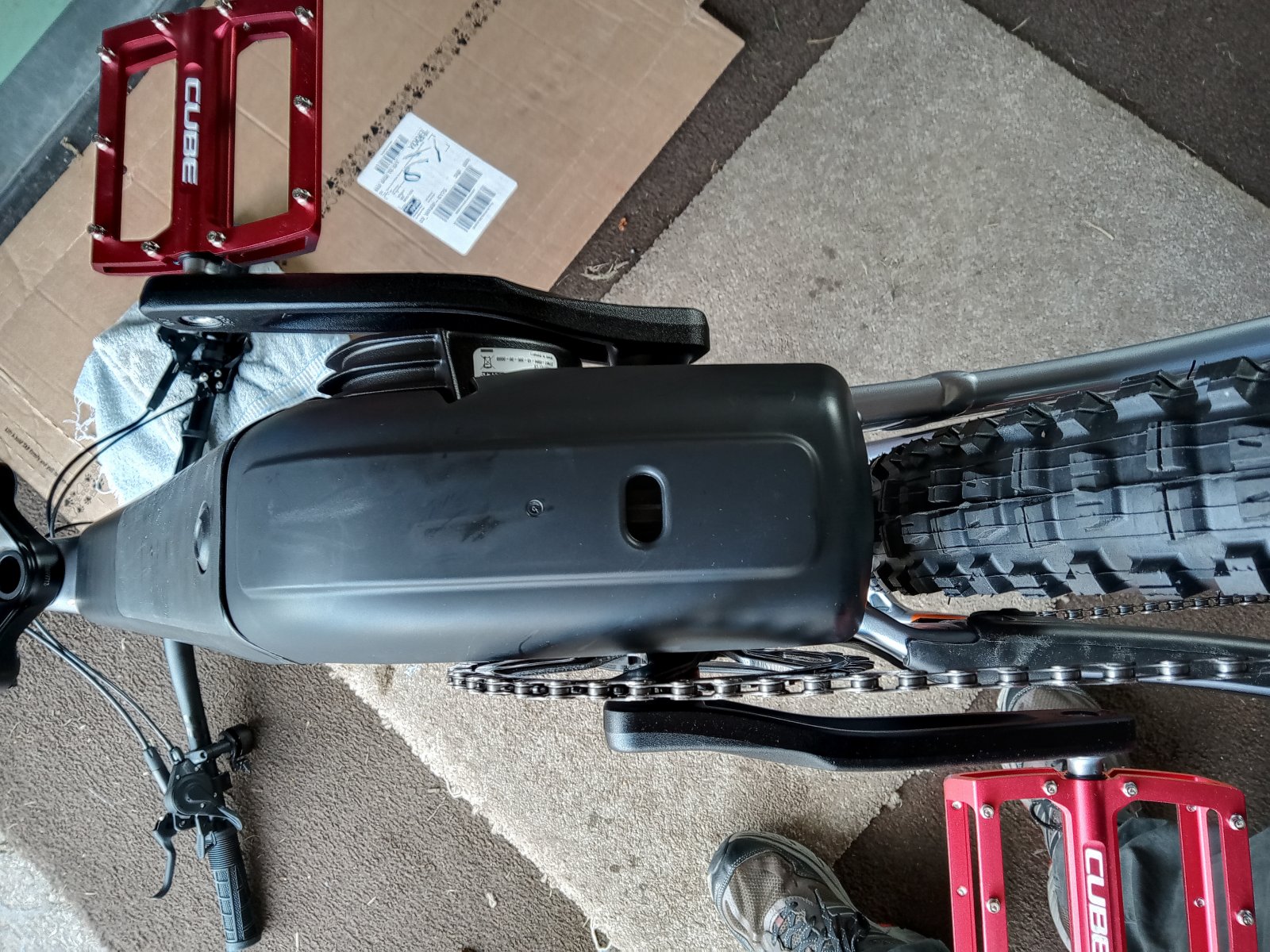

Just had my 2022 160 delivered, with the 750w battery
My 2020 160 has a 'standup' metal plate to protect the motor cover. Used because the plastic plate shattered on my first ride on the bike
But not at all sure where a plate will fit over this. Securing a new plate with velcro not a viable option

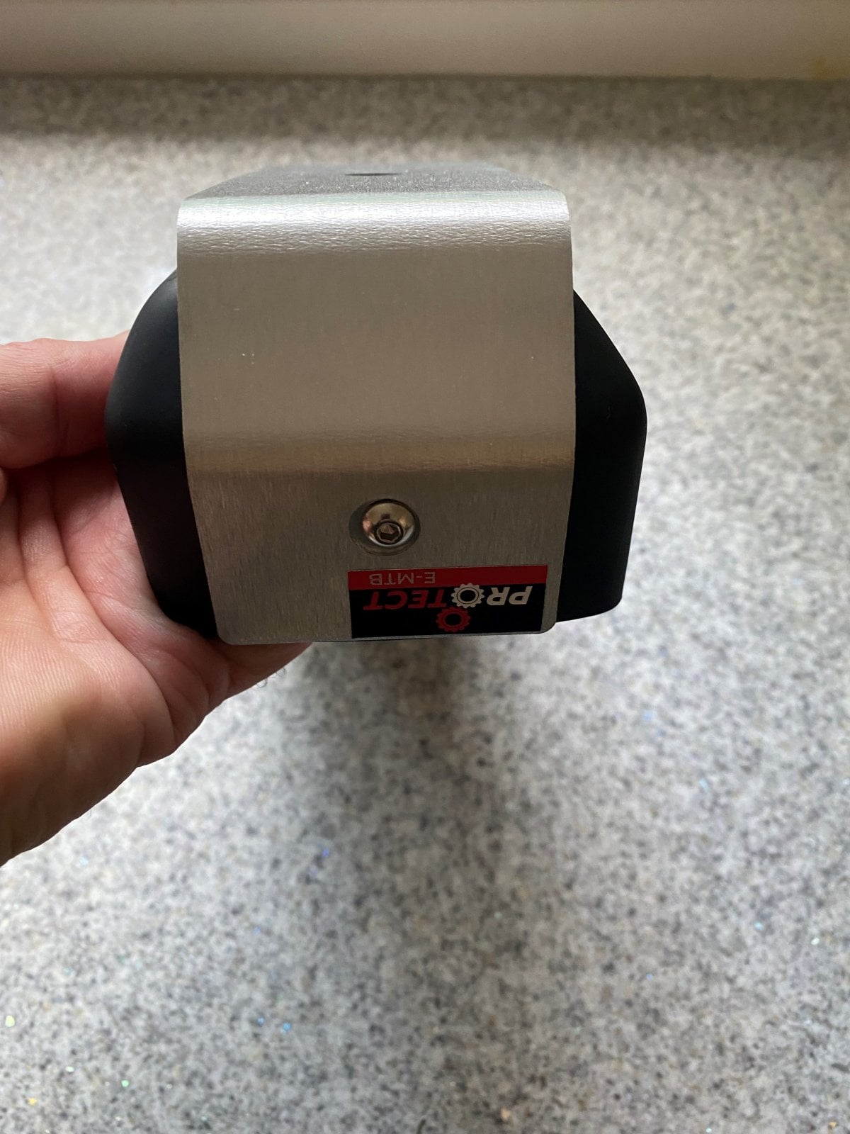

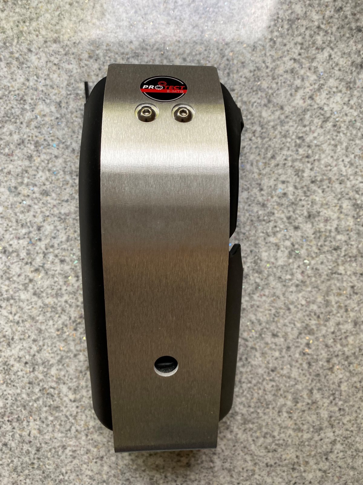

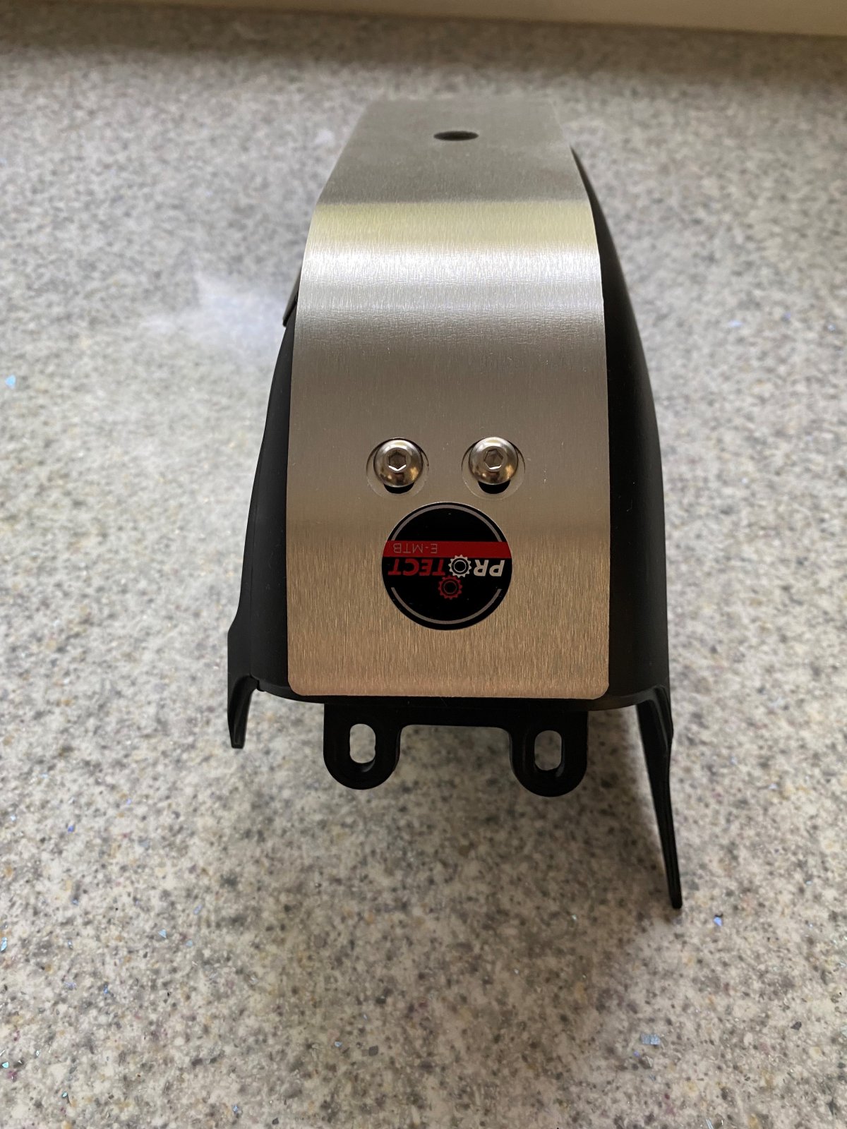

I have received the following email today, so I thought it’d be interesting to see the thoughts of other cube owners on here too:
Hi Nicolas,
Hope all is well. Many thanks for your message.
We do have a guard on test for the 750w. Please see attached. Our original plan was to us the battery push button to secure the front of the guard but we were advised by Cube this would void frame warranty.
Attached does involve drilling two holes in the front of the motor cover , the rear can either be drilled or heavy duty Velcro. Fitting takes about 15 mins and once on is very secure.
We are asking Cube riders for feedback and would really welcome your thoughts, production can start early next week and the hard anodised black ready within 3 weeks for sale.
Enjoy your weekend.
Mike
