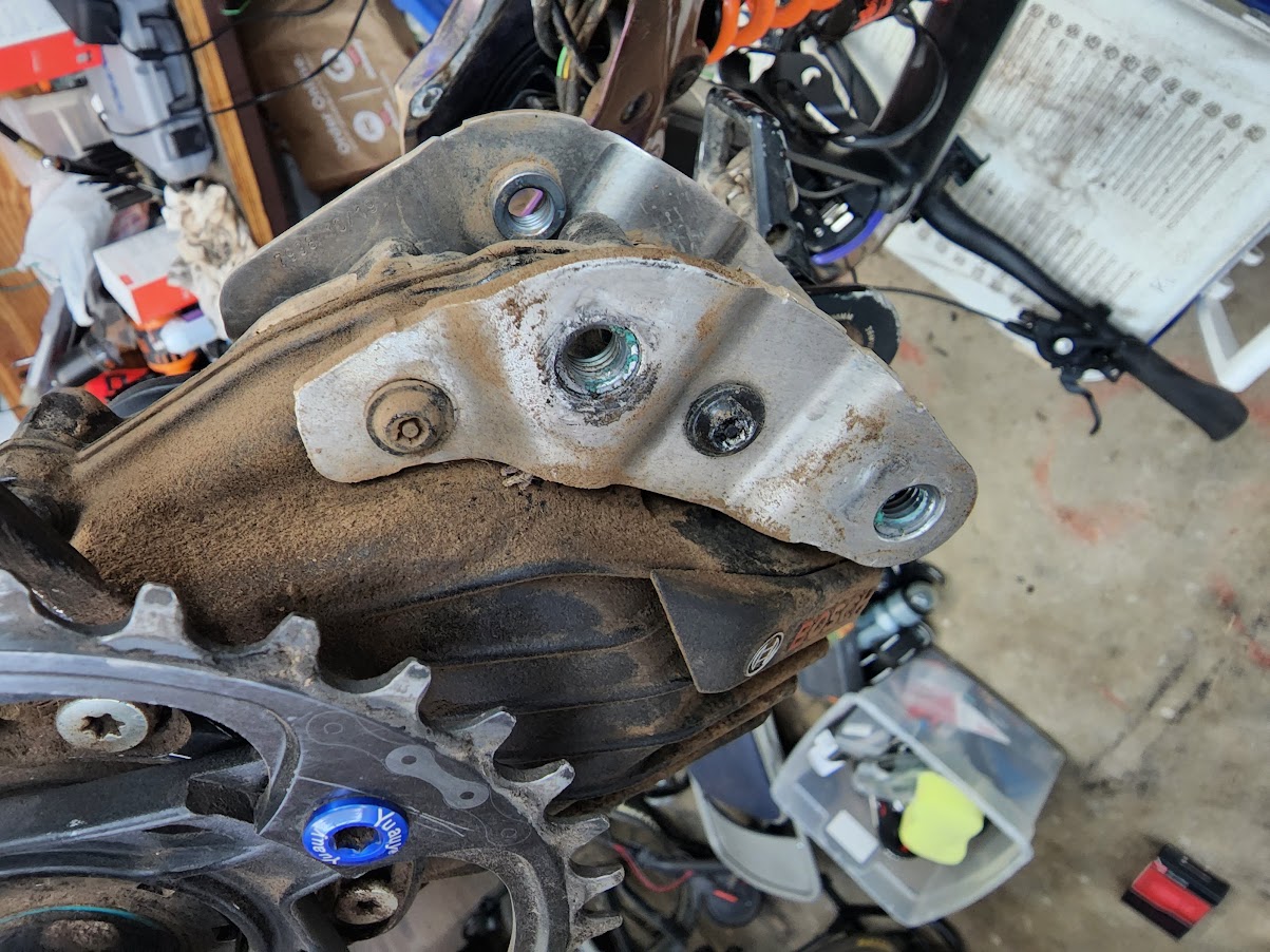

Richiefromboston
Mar 15, 2021
228
123
Boston, Ma. USA
Yup,
Take off bash guard
Remove 6 TX40 bolts
Lift up motor, no need to unplug any wiring
1 of the aluminium plates was loose, I could move the screws with my fingers.
Luckily I caught it before it damaged the plate severely.
& A dab of paint on all 8 bolt heads to see at a glance if bolts move again
@JDM any idea what size those tamper proof bolts are holding the 59 plate on? I just pulled mine apart before heading off for my nightly ride and 2 were simply sheared off I want to replace them all just not sure on size. Thanks
