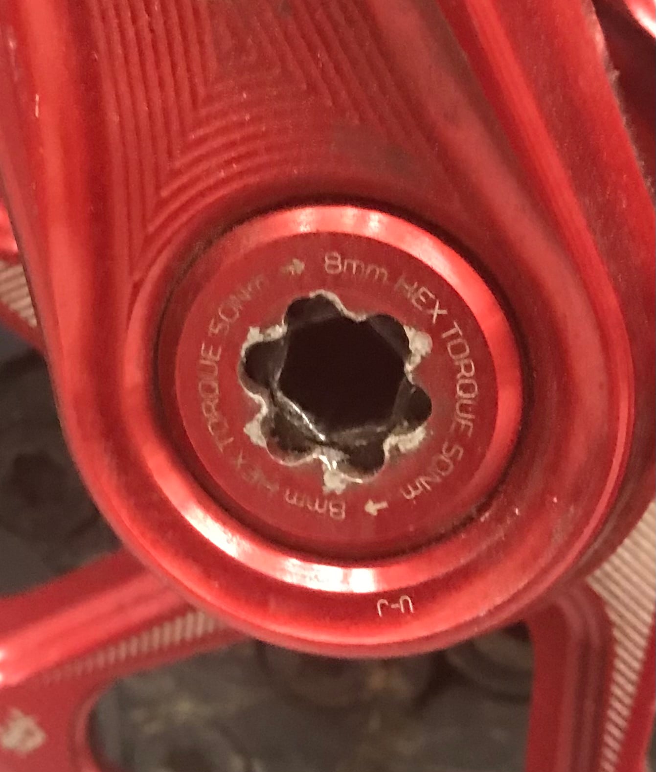

Crank arm cap seized
EMTBSEAN
Feb 20, 2020
1,019
722
Sheffield
Right I’ve had enough of my drive side crank arm coming loose, the trouble is both caps on my crank arms are stuck solid, I’ve tried the Hope removal tool and that’s toast as well now, has anyone got any ideas, the crank arms are still removable but the caps are mullered, I’ve bought some new crank arm bolts and wanted to try these first before I pay another £180 for new crank arms, I’m disappointed with Hope as the removal tool is absolutely shite, it’s just soft aluminium and the points have just broken off☹️ anyway over to you guys please 🙏

you are going to need new caps so i would remove the old ones by first squirting wd40 around the edge and leave for 15 minutes...then squirt some wd40..........and then use a hammer and either a screwdriver or small cold chisel to drift it off. Note it probably only needs fairly light taps with the hammer. It is the "shock" that will break the seal between the cap and the crank which is probably caused by corrosion. Tap fairly lightly using alternate opposing castellations.

Looking at the cap, 50nm is fairly hefty, so it'll be in tight anyway. The cap looks like you've had the wrong tool in there but either way, there's a good chance it's either got a bit much loctite on the threads or the aluminium has done a bit of electrolytic corrosion onto the steel behind. Your heat gun will break the bond, just don't set fire to it.

50Nm is the torque for the main crank arm bolt, the cap is a friction fit but I only nipped it up, can’t understand why it’s in there so tight, believe it or not that’s been tightened with the official Hope tool which is as handy as toothache and without Loc-tite as well 👍

Drill a couple of 3-4mm holes in the top cap. Then either push a pair of needle nose pliers in the holes and twist. Or lever the pliers with a big screwdriver. Or put the end of a steel rod into one of the holes and hit it sideways with a hammer. Then the other hole, then back to the 1st hole....... Then you can still use the top cap's original tool to fasten/remove because you haven't damaged the rounded shape.

I think the only way I’m going to get the caps off now is with a Dremmel and cutting disc attachment and try to cut the cap as deep as I can diagonally into 4 smaller sections and try a split it up and off without cutting into the crank arm cap threads, either way the caps are totally mullered now, I tried soaking them in WD40 and Plus Gas penetrating oil, and tapping them off with no luck, even heating them up had no effect, I’m not beaten though, I’ll try to drill them but in the end I know it’s going to be new crank arms and caps, I had to walk away from it earlier as the old Red Mist was descending and things get very very expensive when that happens, and as I had a hammer close by it would have possibly ended in me needing a new bike 😁

If you have a small enough pin spanner you can drill two blind holes in the cap that correspond to the pin spanner and try undoing it with that before getting the Dremel out.
A make shift pin spanner is easy to make if you don't have one small enough.

Thinking about this, are we sure the cap actually unscrews, or is it a press fit into the crank?
Hope crank arms are self extracting, so it would defeat the purpose if the cap unscrews 🤷‍♂️

I believe he wants to replace the worn bolt which is trapped underneath the cap.
The cap must be independent of the bolt. As the bolt is undone it's head pushes against the cap which forces the crack arm off the spindle shaft.
I don't know for sure but guessing this is how it works.
It would make sense that the cap is screwed in place with a reverse thread.
I think it's been said, but applying some heat from a small torch should help in removing it. A heat gun might not be sufficient.
As for the cranks constantly coming loose, I had a similar issue and found in the end that the Isis splines inside the crank arm were worn which was causing it to keep coming loose.

Let me explain my issue, my drive side crank arm has been coming loose despite torquing it the specified 50Nm, the (extraction) caps are seized in place, I’ve applied heat with no success, I’ve also tried WD40 and penetrating oil which was also unsuccessful, I’ve tried lightly tapping it, also unsuccessful, I am wanting to remove the crank arm bolts to renew them before I pay out for new crank arms, the crank arms are threaded on and are left hand thread, next attempt will be with the pin spanner suggestion, I appreciate your input guys and hope this explains everything 🙏🙏😉😉
