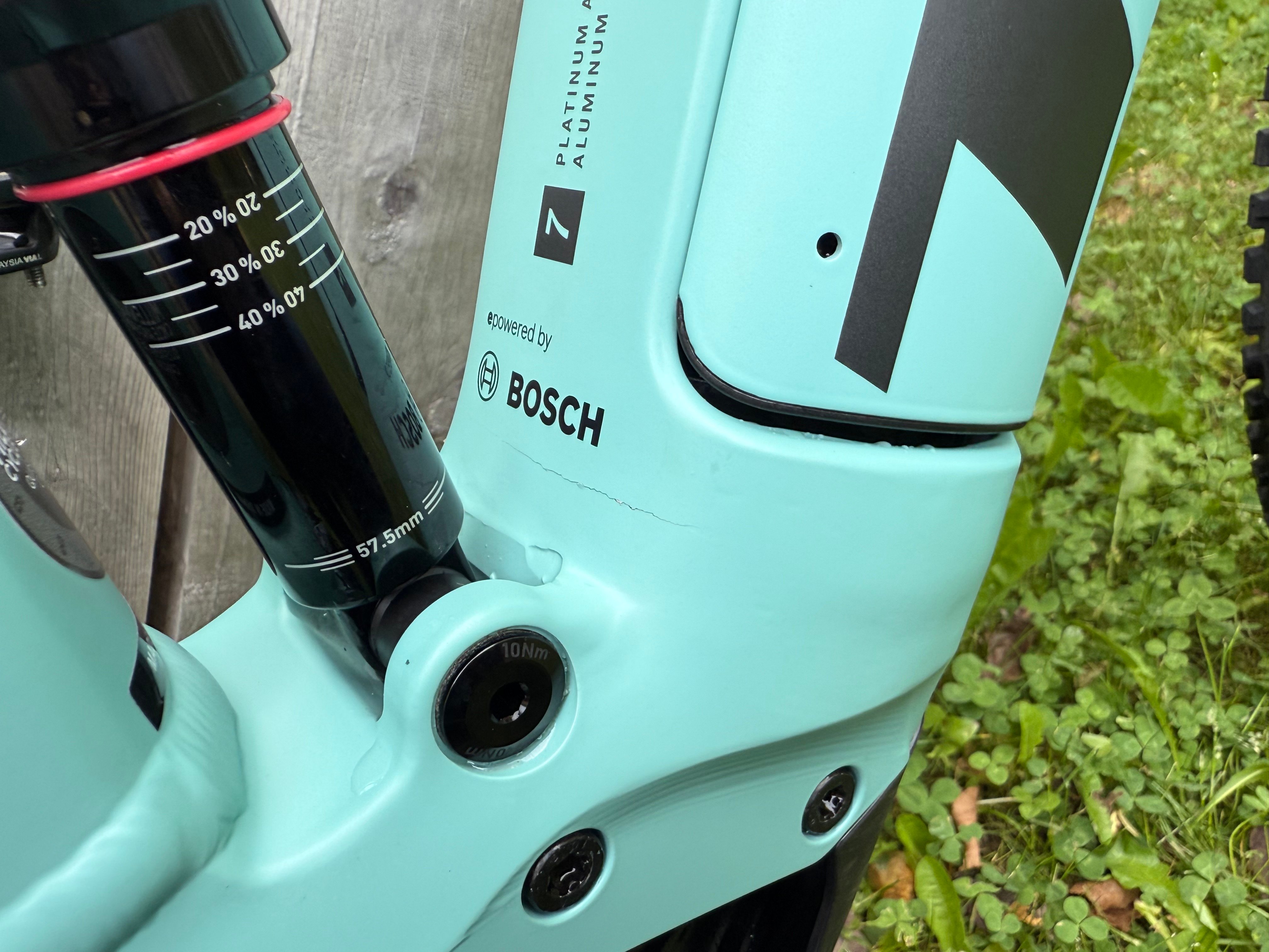

Rail (625Wh) Cracked Rail frames

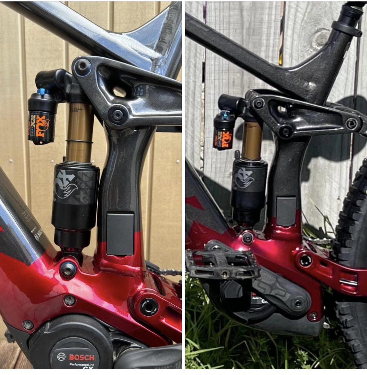

Just an update on my frame. Trek offered me a 9.7 frame for $250. I was told alloy frames would take months to get. I feel like they should send me what they have in stock free of charge but it is what it is. Hopefully they include a matching battery cover but not holding my breath.
This is a decent upgrade in my opinion, but I also feel the $250 is adding salt to a wound.
I'd also look at then getting the frame wrapped for extra protection.
don't think a carbon front triangle makes one bit of difference on a 50lb+ bike I didn't want to wait so I spent the $250. I do like the cable routing better on the carbon frames. Hopefully it shows by the end of the month. It will be Ridewrapped. I still feel like Trek should send whatever they have avaible. They used to send better replacements at no cost. These are expensive bikes even the alloy versions.

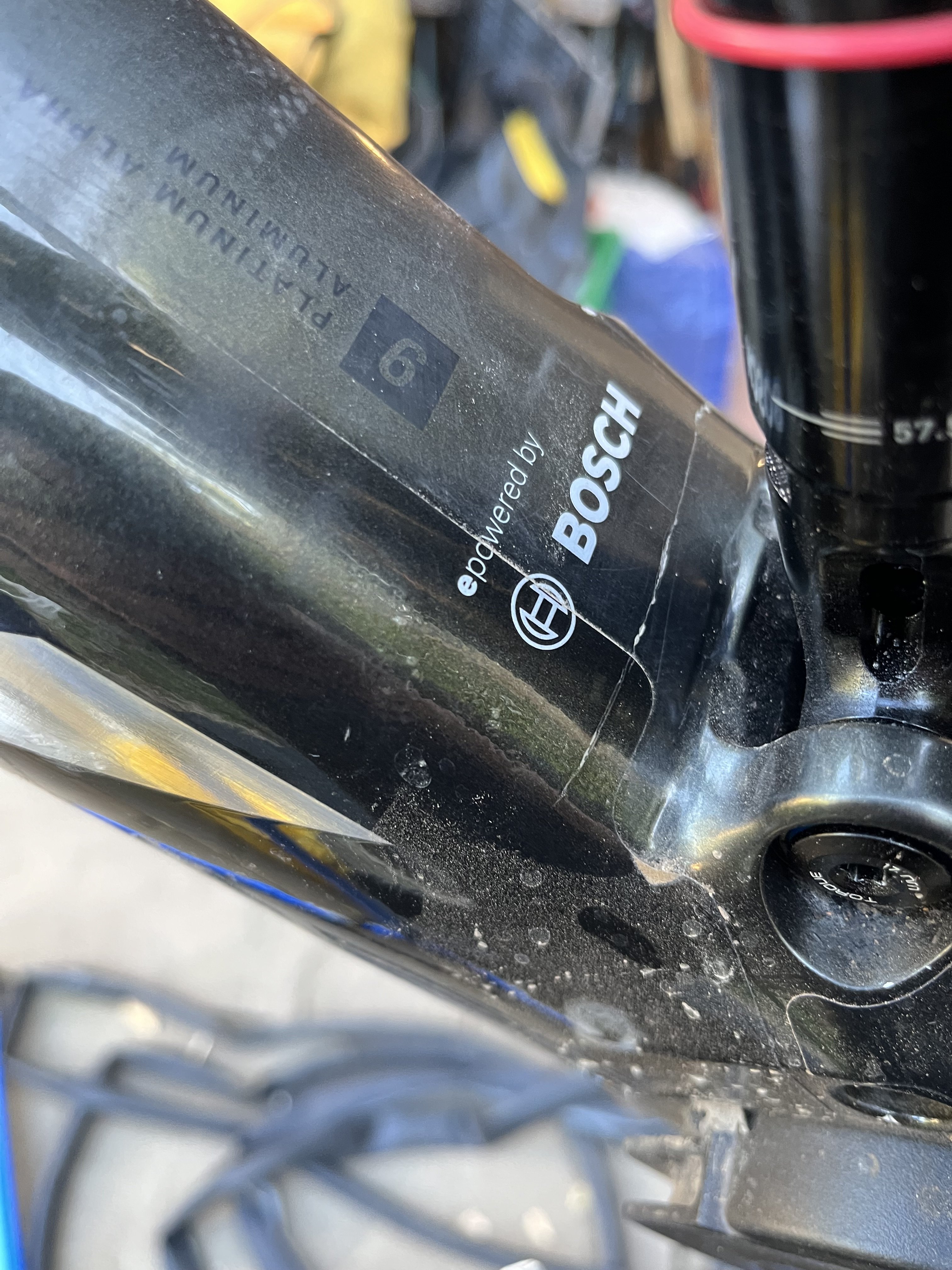

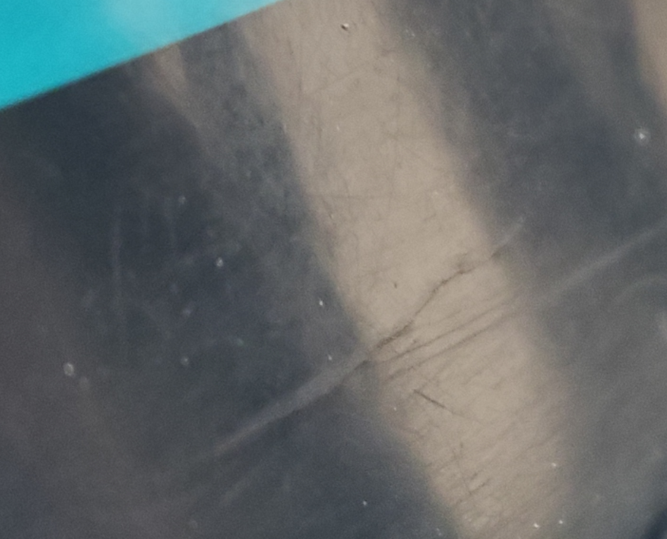

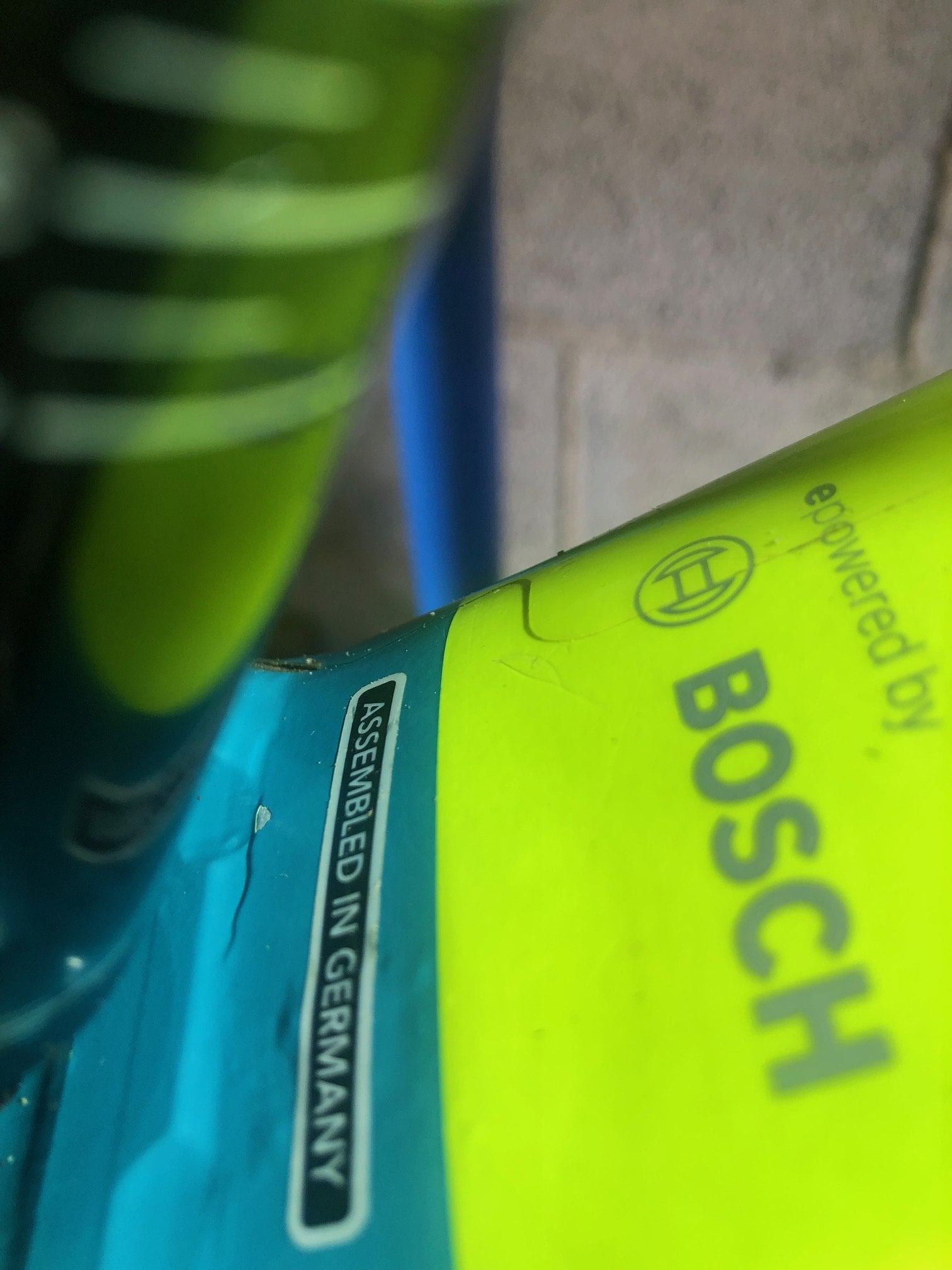

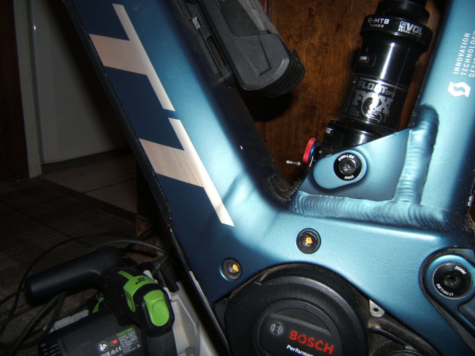

are you sure it's a crack in the frame and not just the paint that has flaked or cracked ?
Was that not the problem as shown with the Giants ?. More due to flexing than actual damage to the alloy
Which is understandable, Paint hasn't the ability to flex, its brittle and any flex would cause it to crack.
Unless you can actually see inside where those 'cracks' are, you couldnt for 100% say they were alloy damage and not just paint damage.
That said. This is a pic of that area on my Scott genius, which shows that the area has a weld across it. So possibly Scott have foreseen that area flexing and put the weld in to prevent premature damage, or believe that continual flexing could lead to cracks forming.
That said. This is a pic of that area on my Scott genius, which shows that the area has a weld across it. So possibly Scott have foreseen that area flexing and put the weld in to prevent premature damage, or believe that continual flexing could lead to cracks forming. View attachment 99562
Some people don't like to see welds like above and want the welds to be finished flat.
I DO want to see the welds because it is prima facie evidence of a solid joint. The weld should be as strong as or stronger than the two components welded together. "Finishing" welds can only weaken them.
In trek rail there is welds shown elsewhere, so the area having defects is not welded but bonded.
If that is the case then if necessary it should be 'over-bonded" for exactly the same reason. The bonding should be at least as strong as the strongest of the two materials being bonded
I don't know what the problem with giant was as I haven't followed that thread much but I think it was frames that cracked.
no, it's difficult to see if it's the paint that's cracked or if it's a crack in the frame, I think I read about a trick you can do to tap the crack a little gently and listen and you can hear if there's a crack in the frame.

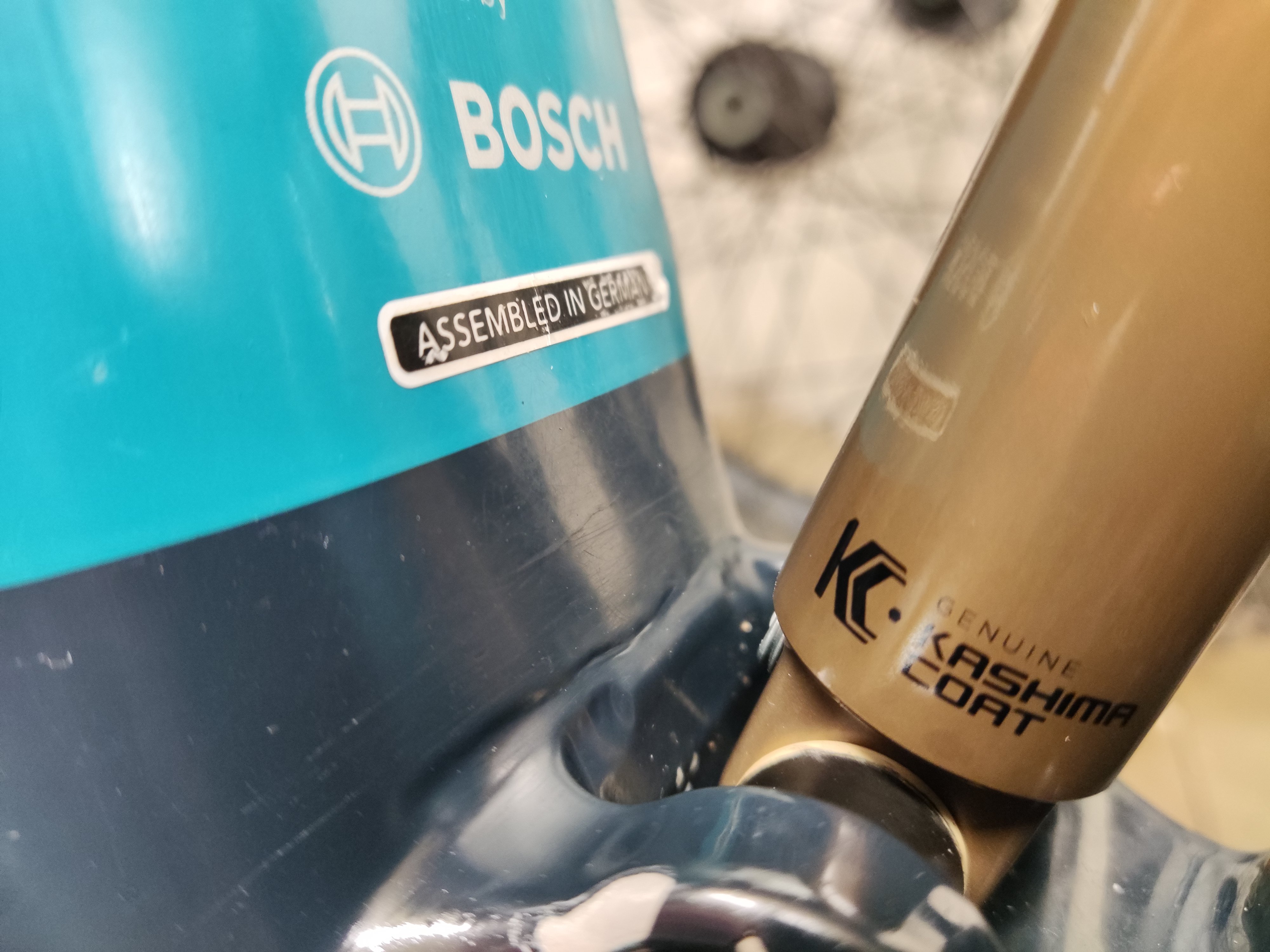

Hi Guys,
My frame cracked weeks ago and was able to receive a warranty frame. I got a Large Trek Rail 7 btw. The LBS transferred all my components to the new frame but for some reason my Fox X2 which used to fit with plenty of space from the frame is suddenly hitting the new frame and there is not enough clearance anymore.
I returned it to my LBS (Evocycles NZ) and they tried to find what’s happening with the new frame and they said the issue is with the frame and they will be happy to just attached my stock shock (Not Fox X2) as that fits with no issue and there is a big chance Trek will not send a new frame. Basically just move on and accept it.
That does not make sense to me as the new frame should have the same measurements and should have the same clearance. A few millimetre closer but still with clearance would be fine with me but this thing has no clearance at all and I’m getting the impression that they just want me to accept that. I didn’t agree with it so they will contact Trek again.
Have you seen issues like this before? Right side of the second picture is my old frame with heaps of clearance for my rear shock.

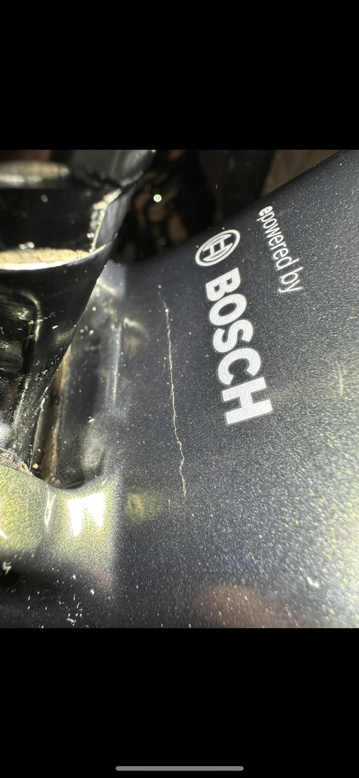

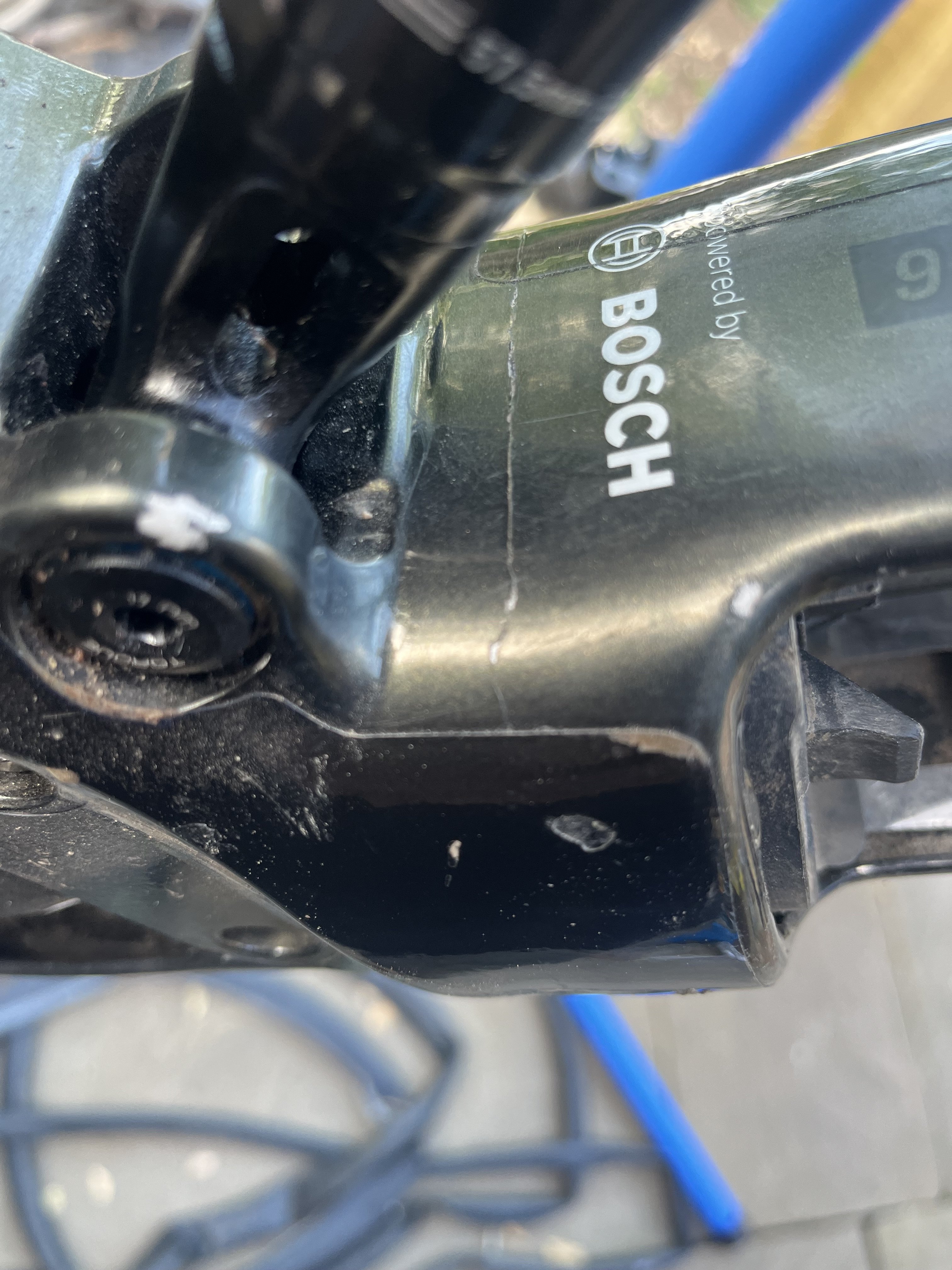

Thanks everyone on this thread, made me go and check my Rail, sure enough, hairline crack exactly where others had them.
Not sure I'd have noticed without this thread.
Local dealer has been great though to be fair, took the bike yesterday and rang me today to say Trek will warranty it for me.

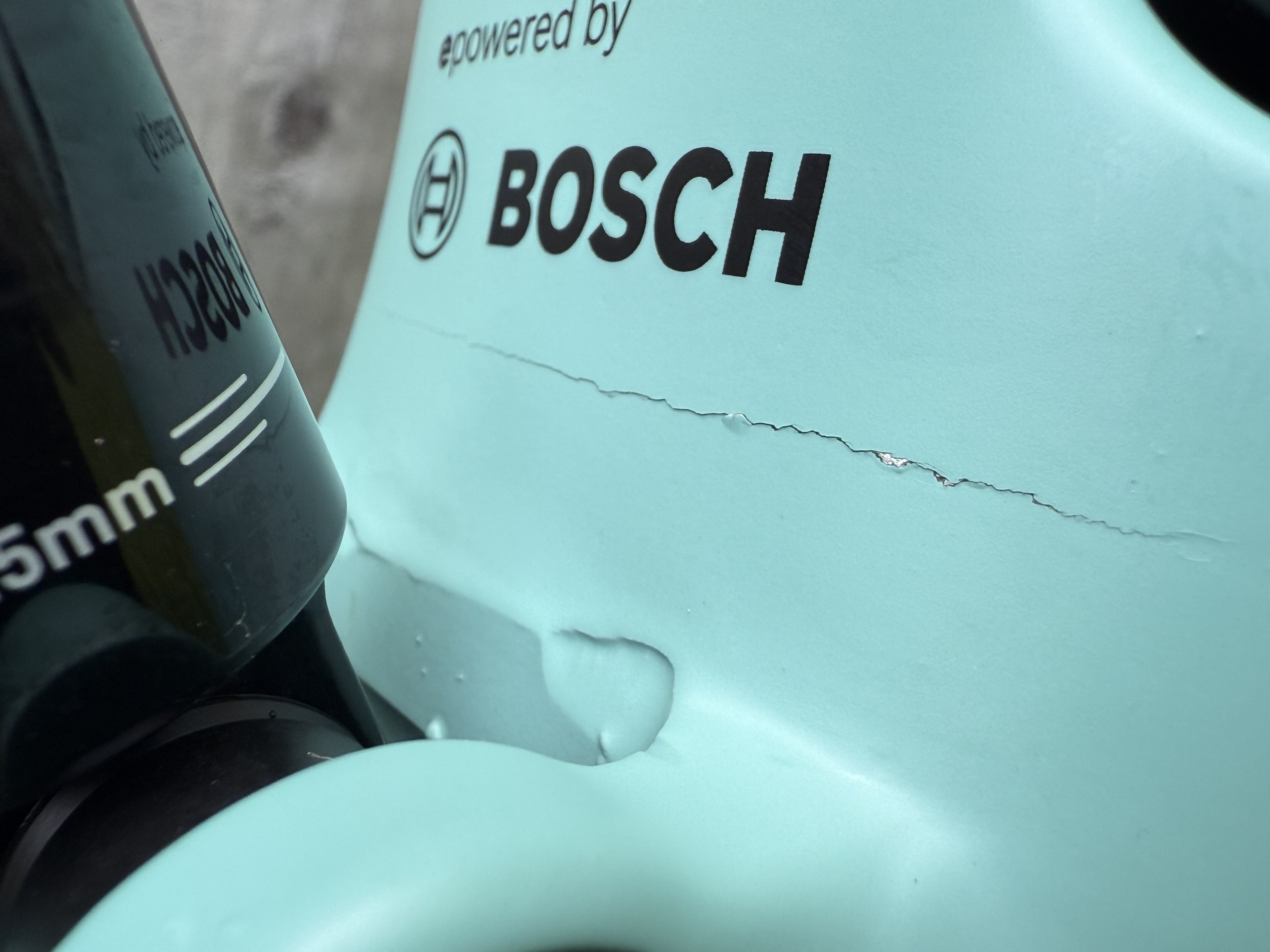

its looking pretty prevalent. unless ive read wrong, nearly everyone who has checked due to this thread has found a crack.
You have no data on amount sold and what age and mileage/use there failing at
Unless you know the total amount sold worldwide to give a statement like you have and of course the failure rate you can then call it .
Could you give us more info ?

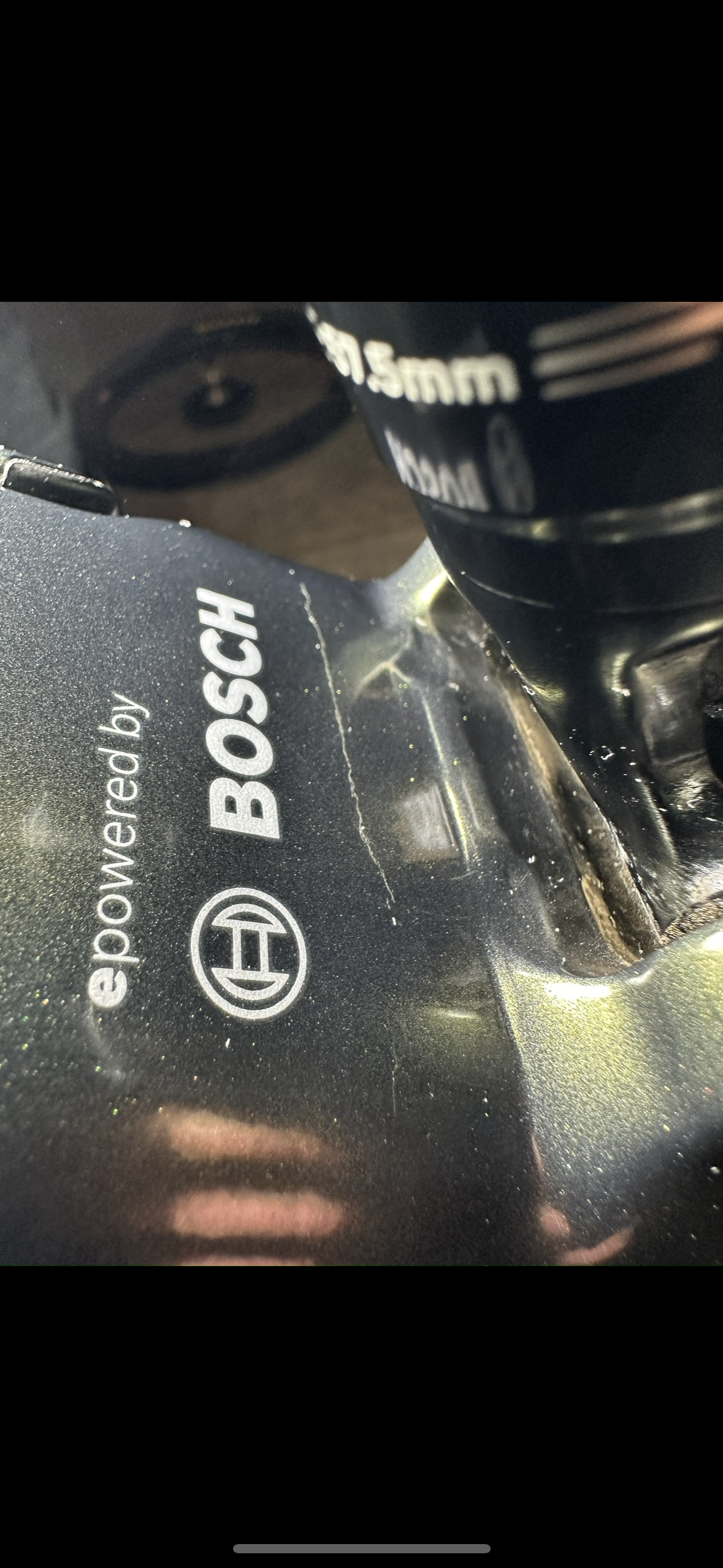

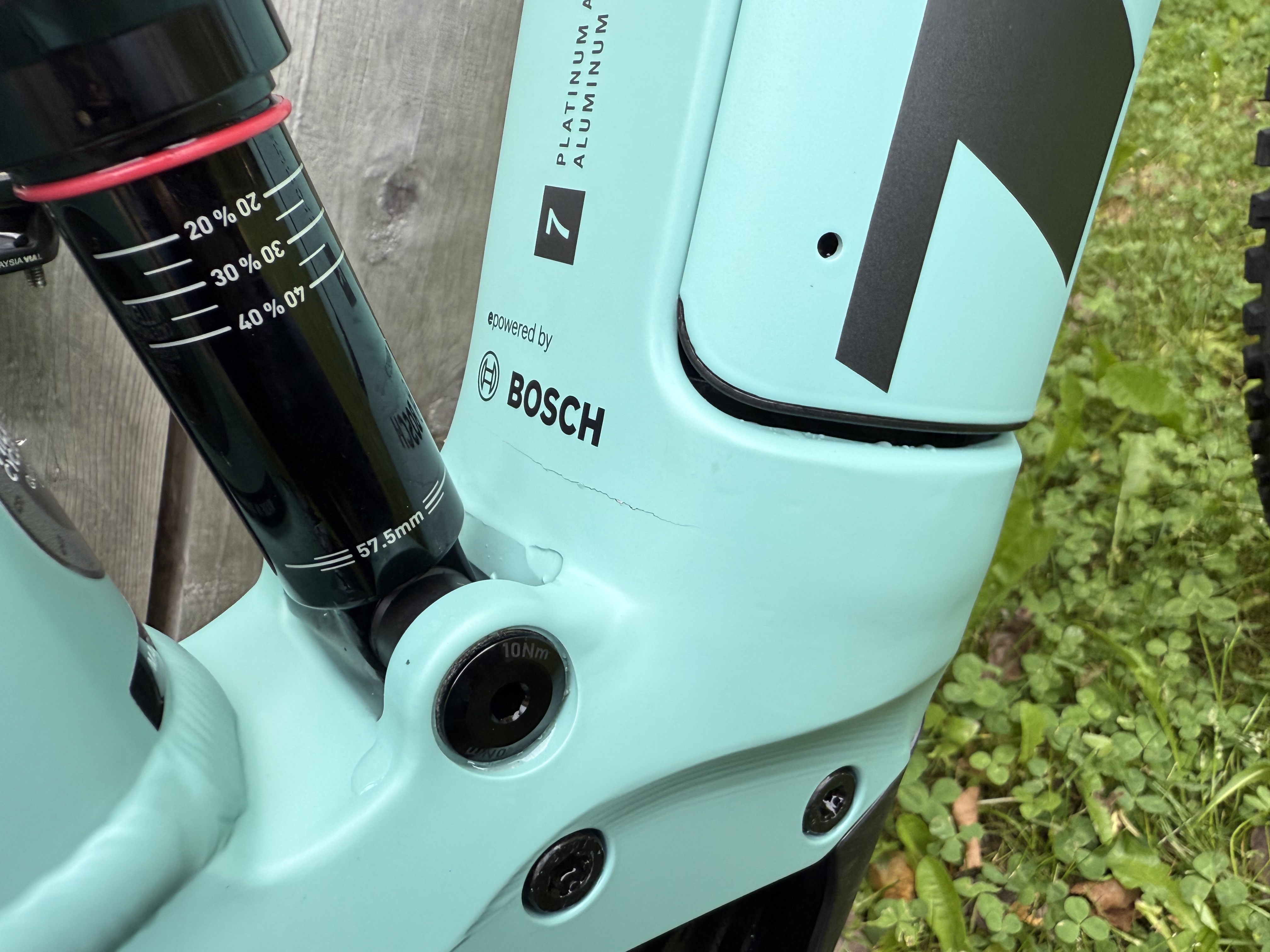

Hi fellas, could I ask is this crease normal? It looks to be in the same area as people's frames are cracking, there is not a crack at the moment but it doesn't look good.
Many thanks 👍
