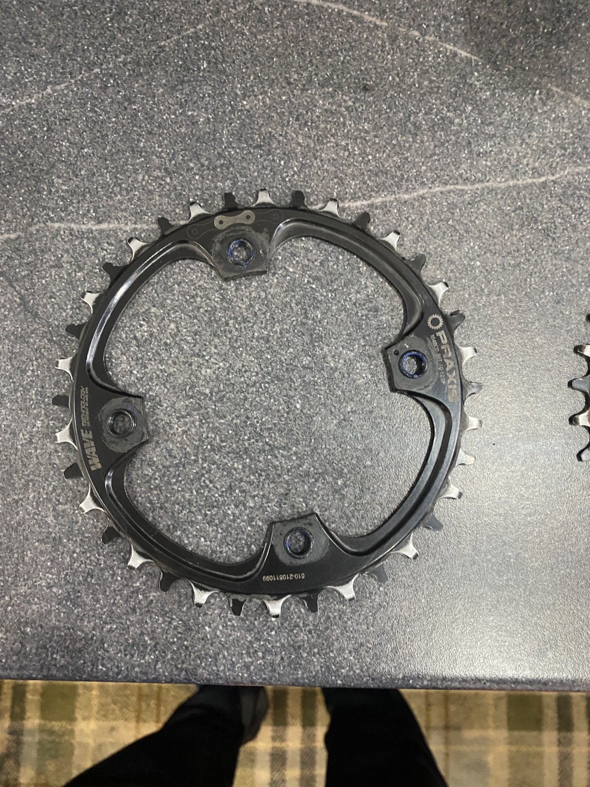

When I first cycle off, there’s a crack, during cycling no noise, what’s the chance of it being chain ring / chain as opposed to motor ?
New chain & cassette around the same time as motor swap
Last night I backed off all motor bolts and torqued circa 18Nm backed off the motor guards bolts and tightened, removed the lower pivot bolt, cleaned under chain stay at motor foam pad, yet today it’s still cracking whether on or off seat
Checked chain wear albeit, not with a 12 speed chain checker and it’s a very tight squeeze to 0.75
Chain is wiped & lubed after most rides with Squirt dry wax…
No notable wear on chain ring
New chain time or ……

I was trying to age the chain ring and failed, can find every other receipt, probably circa 3500k on the chain ring so likely due a change,
I do have the original smaller chain ring, may try that tomorrow with a new chain

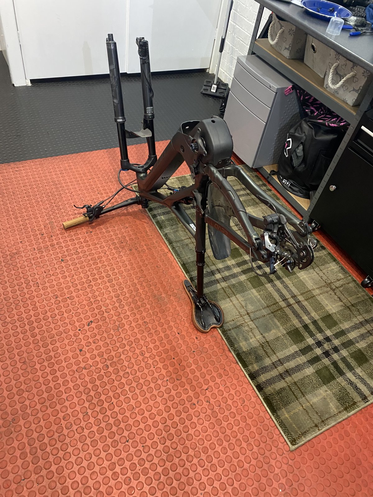

Bike having the full strip down
I did not check the back motor bolts - knowing primarily as chainring restricts access to drive side. so I shall drop the shock pressure & remove to gain access
Dont see much notable wear on the chain ring ? I’ve cleaned the cassette in Prep for new chain

Well after the strip down and ride I’m all smiles
Fork was pulled headset cleaned greased and refit
Seat & Seat post striped cleaned greased and refit
Crank arms pulled cleaned regressed and refit
Chain removed
Chain ring removed, cleaned & inspected and refit
Battery removed bash plate cleaned & refit
All motor bolts (x6) removed & cleaned taper bushings greased and refit
Motor cover bolts removed cleaned and refit
Wheels removed, cassette and discs cleaned and refit
Derailleur striped, jockey wheels cleaned, greased and refit
Rear shock pressured and balanced
New chain degreased cut to size and fitted
Attempts made to install OEM chainring as little use, however chain length with 36t chainrings permitted fitment without losing a couple of links so old unit cleaned and refit
Gear index checked - All good!
”All” mounting bolts torqued per manual spec
In doing the above I trashed my torque wrench trying to back off pedals, so that was striped and pawls switched over to allow interim use and bike refit.
Tyres inflated for Road
Took bike for a mixed 40k ride, Firetrack, road & trail with frequent stops to pull away in different gear and modes, came home all smiles, noting soft compound tyres dont half bite the tarmac
I’m inclined to say, it was the chain albeit with little wear, however, per muzzman1 post (Thank you!) I’m thinking it was the lower motor bolt hidden behind the chainring, both sides were torque checked before removal, drive side was found slightly loose, needing a pull and a bit to reach full torque
