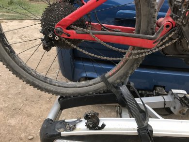

Here’s my take after 4000km - bit over but only maybe 200 km
trek fs7 - delivered with xt shifters n derailler - 1300 km
got a stick chain mangled - broke the rear mech ......1700km
new chain dura race and xt derailleur.
replaced with sun race M8 10-46 , still going strong . Wear is minimal visually
chains i replace @ .75 it’s been a muddy winter here and I caught another stick on Sat , but I have a new chain to go on .
( 3rd chain , so they are good for approx 1300 km - ridden in mud and sand - but lubed - roll n roll lube )
I would recommend the Sunrace - or an XT rear cassette - the XT has the coating which gives better wear ,I’m fairly sure the SLX doesn’t .
but an XT Cassette ranges in price from $150 - $200 aud - so get em on special
Sunrace range from $110 - $150 again on special .
dura race chains are about $85 , but I bought one from a German mob , so it’s was the equivalent of approx $70 (€35) .
I have considered going to an 11-42 cassette , but for $5 is it worth it , there are some hills steep enough to o need the highest cog .
if it was super muddy , I’d say get an slx ,and an chain - any type - as it will be sacrificial !
esp in some of the winter conditions you have in UK .
E090AEA7-301A-485B-A4D1-5A80CB2D285A.jpeg E090AEA7-301A-485B-A4D1-5A80CB2D285A.jpeg
so , sticks are bad - okay ,
deraillieur , speed sensor , chains - oh 3 spokes in the last 100 km ....

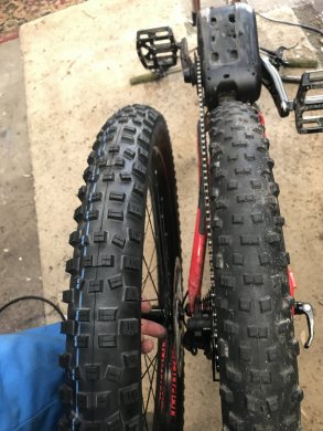

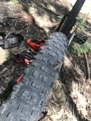

Possibly worn out - Hans Dampf compared to Nobby Nic
sorry , all unrelated to chains n cassettes - but we love pics ! View attachment 49095 View attachment 49096
Yes ! People who live in places with no Eucalyptus trees will never know the joys of riding in Oz .
Sticks on the ground every where waiting to insert into wheels , brake rotors and derailleurs and sticks that fly up in the air and become spears when the person in front of you runs over them .
I too was comparing a worn Hans Dampf with my relatively new Nobby Nic . Close .
