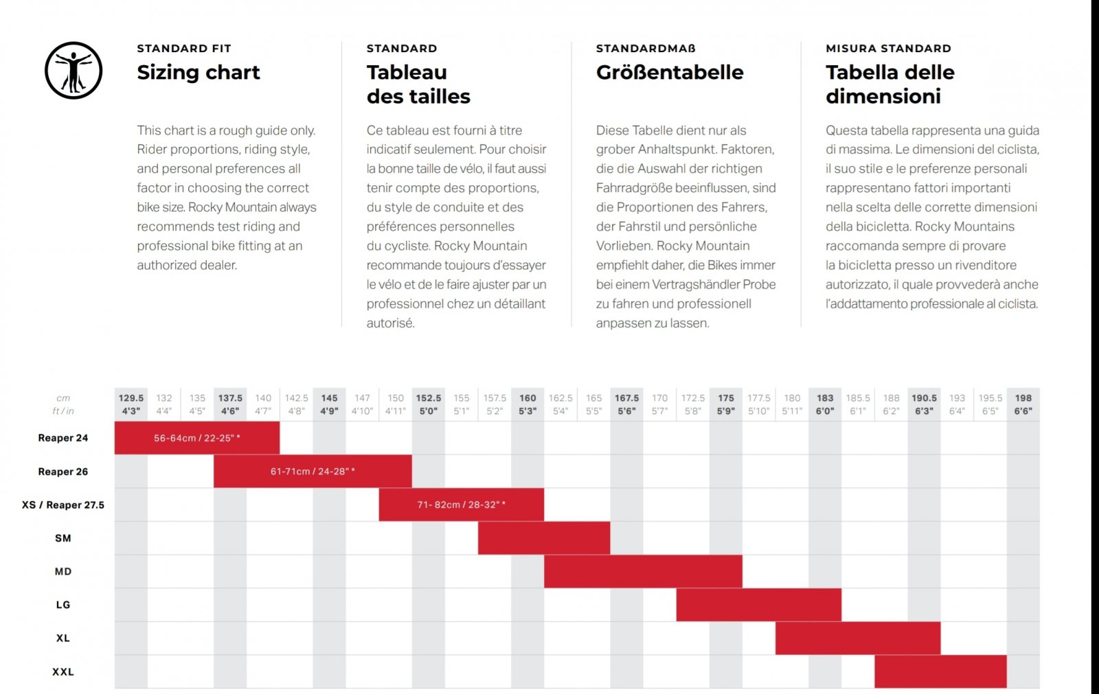

You are perfectly right.... and this is exactly what I have on the back of my mind
So in term of sizing what you would suggest me?
At 165 I am at the top end of the small size and at the bottom of the M size...

Interesting. I focused on the reach measurements (among other geo aspects) of the bikes I was looking at and thought the large RM was actually slightly longer than the large Levo. Does that not transfer to the smaller sizes?

From geometry wise it does seems RM did not embrace the long top tube philosophy that all others are following. Picking up the example of Levo vs Altitude the same frame size has 2.5 cm difference in lenght. This might also be the lively feeling.
Saying that what to vhoose? I'm 165 cm and I could not decide whether to go for a 2019 Small discounted 20% or going for the 2020 Medium...
Hi. If you can, try a medium for fit. An awesome thing about an e-mtb is the ability to ride for miles on varying terrain, and having a bike that has a bit of room for you to move about and be comfortable
can be a bonus. I haven't ridden a 29er Levo, but I would expect it to be quite a different experience to an Altitude. If a Levo was on my radar, it would be an RM Instinct that I would compare it to, but maybe that's just me ?
