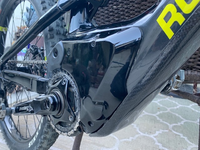

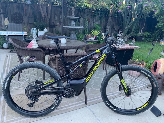

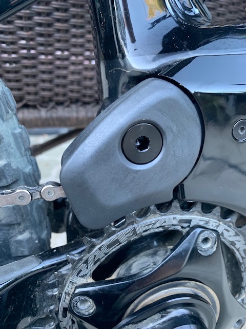

Decision was made and I bought the Altitude. While at the shop they added the new guide for the chain. The chain noise is gone! It wasn't really bothering me, but I'll take it. Both the dealer and I were really surprised at the huge difference. Will find out on next ride if there's noise on trail, but on street nothing.
mtbross
Jul 22, 2019
59
71
Los Angeles, CA, USA
Decision was made and I bought the Altitude. While at the shop they added the new guide for the chain. The chain noise is gone. I couldn't believe it made that much of a difference.
Congrats!
Cool to hear about the noise! Could you share a picture of the updated parts?
Sure. And I just double checked. Just the new guide was changed. I also got the skid plate which should protect the cover of the motor nicely. Thought I would post one of the bike while at it.

Did first ride yesterday since changing to that updated chain guide. The tires made about the same level of noise as the drivetrain and motor. Awesome.
Update: Did a ride today with a few stream crossings. Once chain was wet, there was some noise, but nothing like before the new guide.
