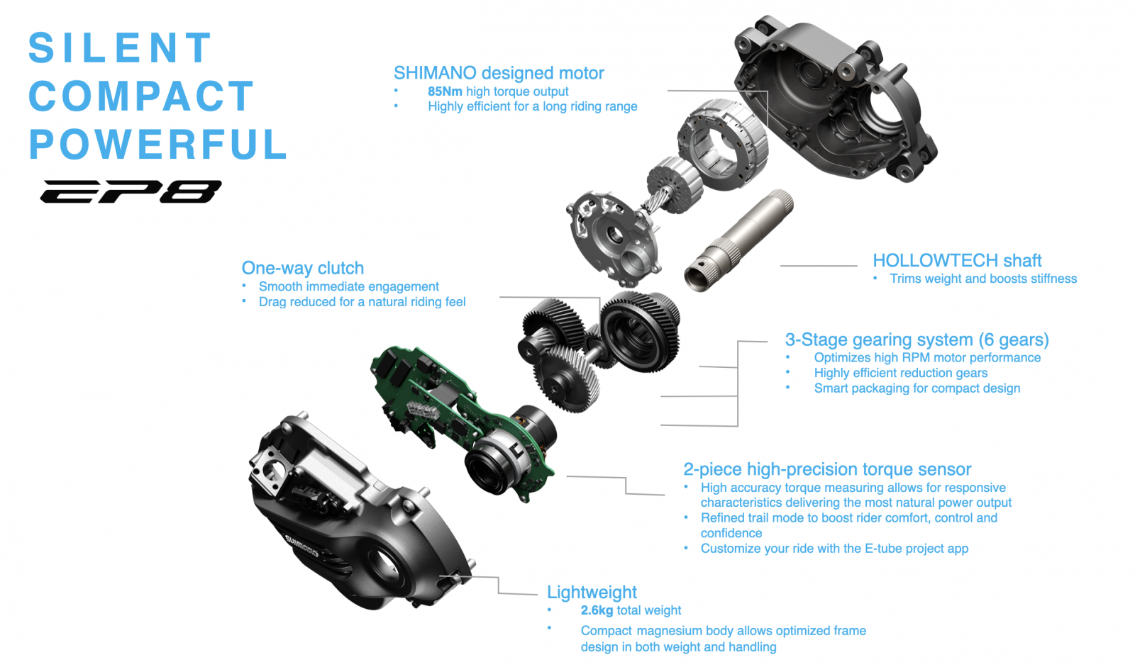

E2A - From Pinkbike article - "A one-way clutch delivers smooth engagement while reducing drag for a natural riding feel. "
Do they use something like this?

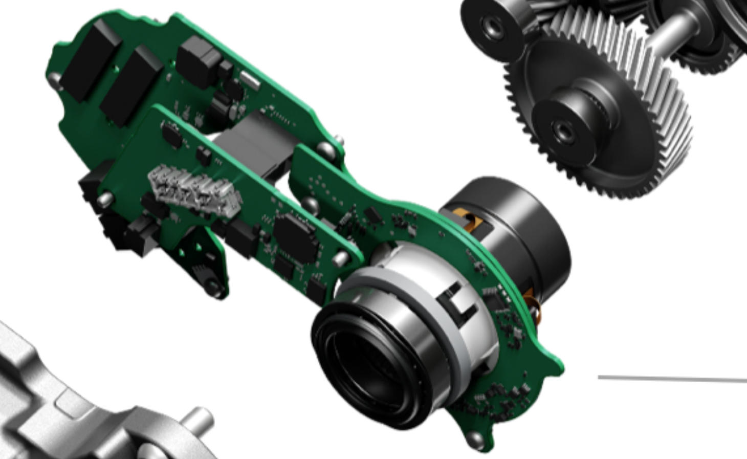

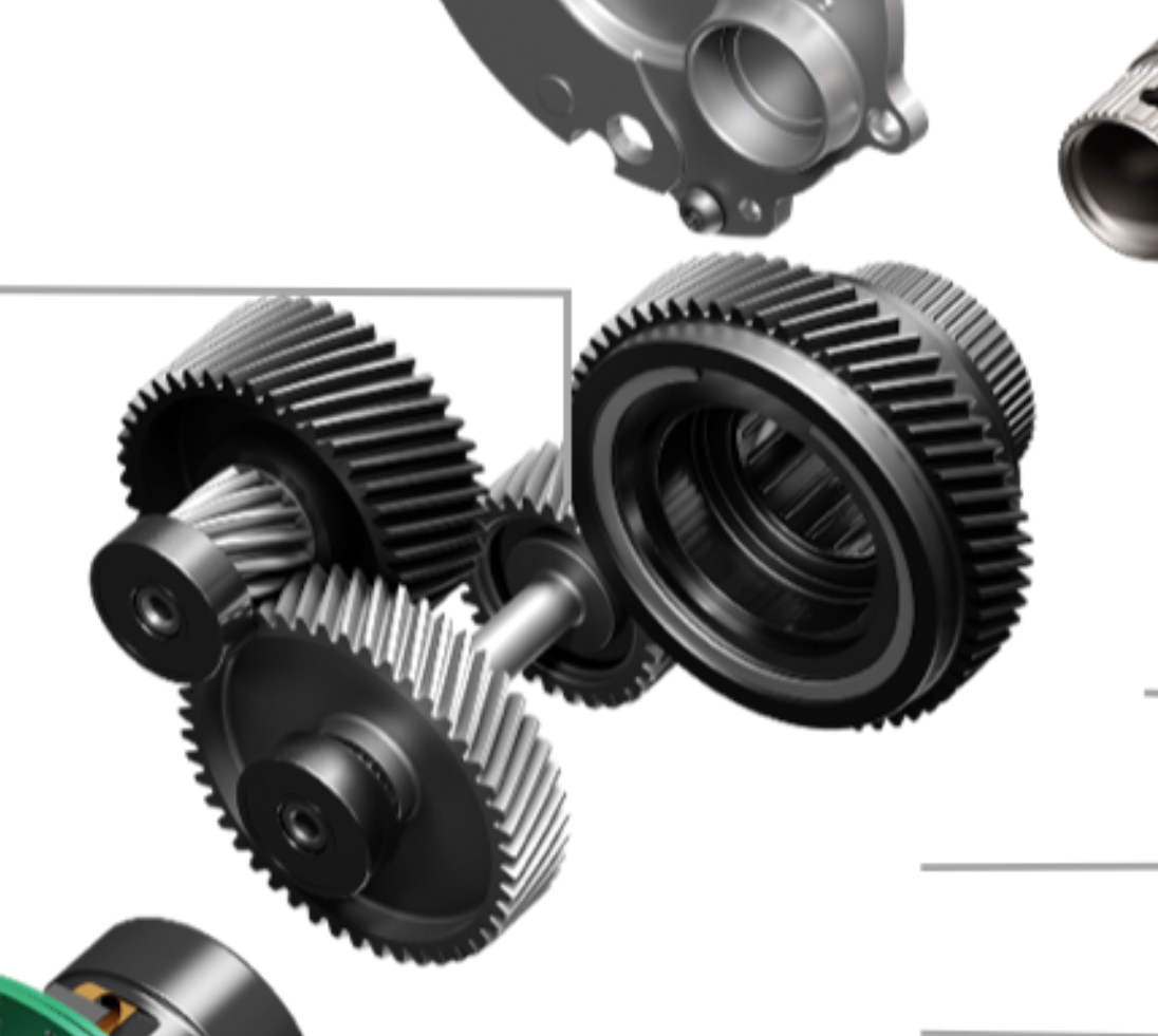

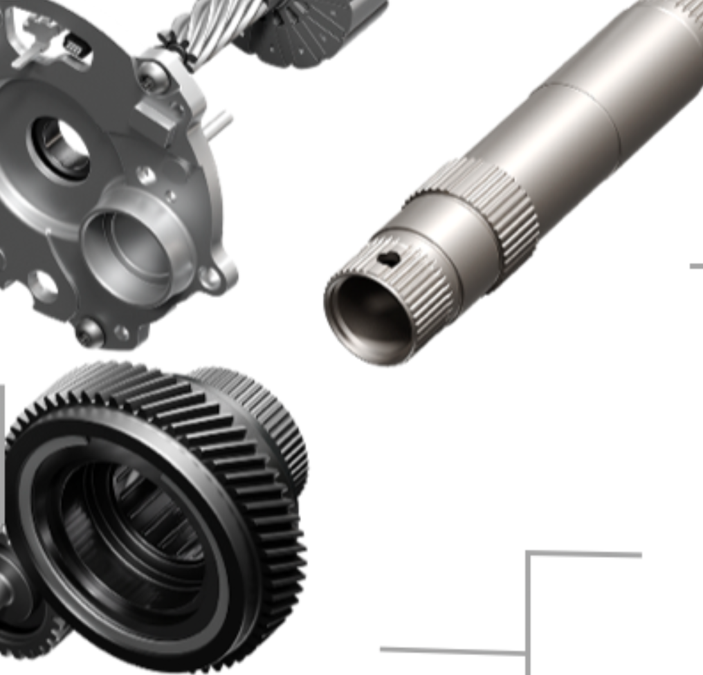

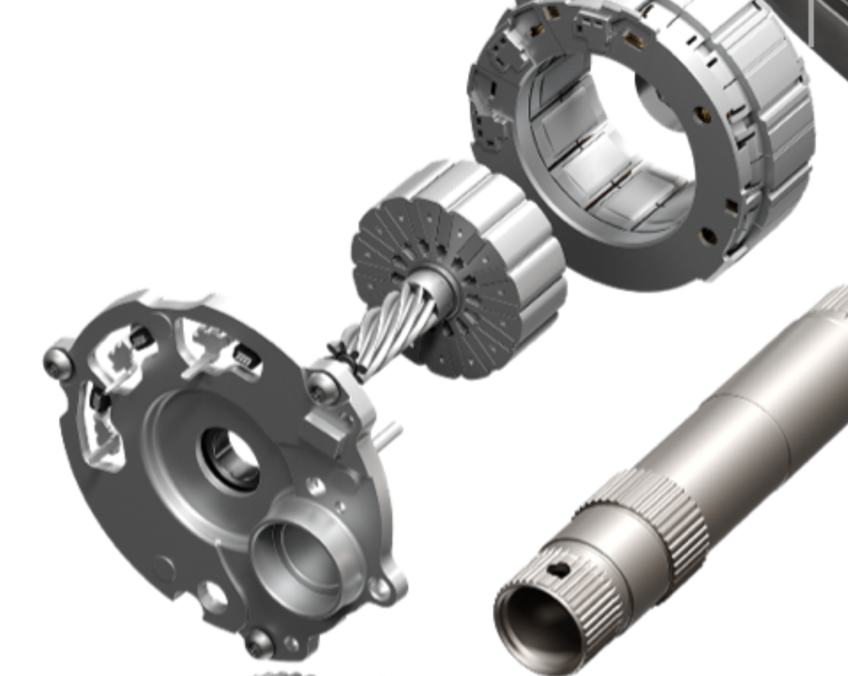

@Bearing Man any thoughts .. this could be our first EP8 failure ...
Some zoomed images ..

Bearings should be alright, looks like they're made from solid steel :LOL: Actually looks very similar to the E8000, nice touch that they have added security screws to the internal parts.
I was speaking with the company that manufactures the clutch bearing for the EP8 and I can guarantee that one will not be available to buy :(

I'm being super dumb .... so a technical question ..
I'd imagined that the chainring/spider connected to the "crank shaft" :p via it's own splines and had the equivalent of it's own freewheel/ratchet. I think you can sometimes feel this on say a Bosch - or imagine you do ..
Looking at the pictures it looks like only the torque sensor connects to the shaft via splines.
Which suggests that the "clutch" contacts/releases directly against the crankshaft :) ... ??????
So it's then locked/closed to the shaft by default ? Therefore, you can pedal with the motor off, otherwise the chainring wouldn't turn when you pedal as there are no splines connecting the shaft to that section which has the spider connected to it. But it has a one way ratchet mechanism in there so when you pedal backwards the chainring doesn't turn ??
From what @rb. is describing, either the "ratchet" ? if there is one in there and it works like that, is disengaging in both directions somehow . Or, the "clutch" isn't engaging the shaft by default ???? If it's a ratchet, is it something like a sticking or dislodged pawl ? If the pawl design is different, is this what the descending rattle is that people hear ? The pawl bouncing around ? Does @rb. just need to nail the crap out of it on a bumpy descent ? :unsure::devilish: "Pawls out" so to speak ! :)

The clutch bearing is a ramp roller or jam type bearing that is in the big black steel gear and works by gripping the torque sensor the other end of this gear supports the chainring. This is very similar to the Brose system where drive from the pedals is put through the crankshaft and transmitted to the torque sensor through the splines in the crank, then into the spider via the clutch bearing fitted to the opposite end of the torque sensor.
There is a second clutch bearing inside the smaller black gear that disengages the electric motor. This is a standard clutch bearing, so no pawls, no ratchet mechanism.
