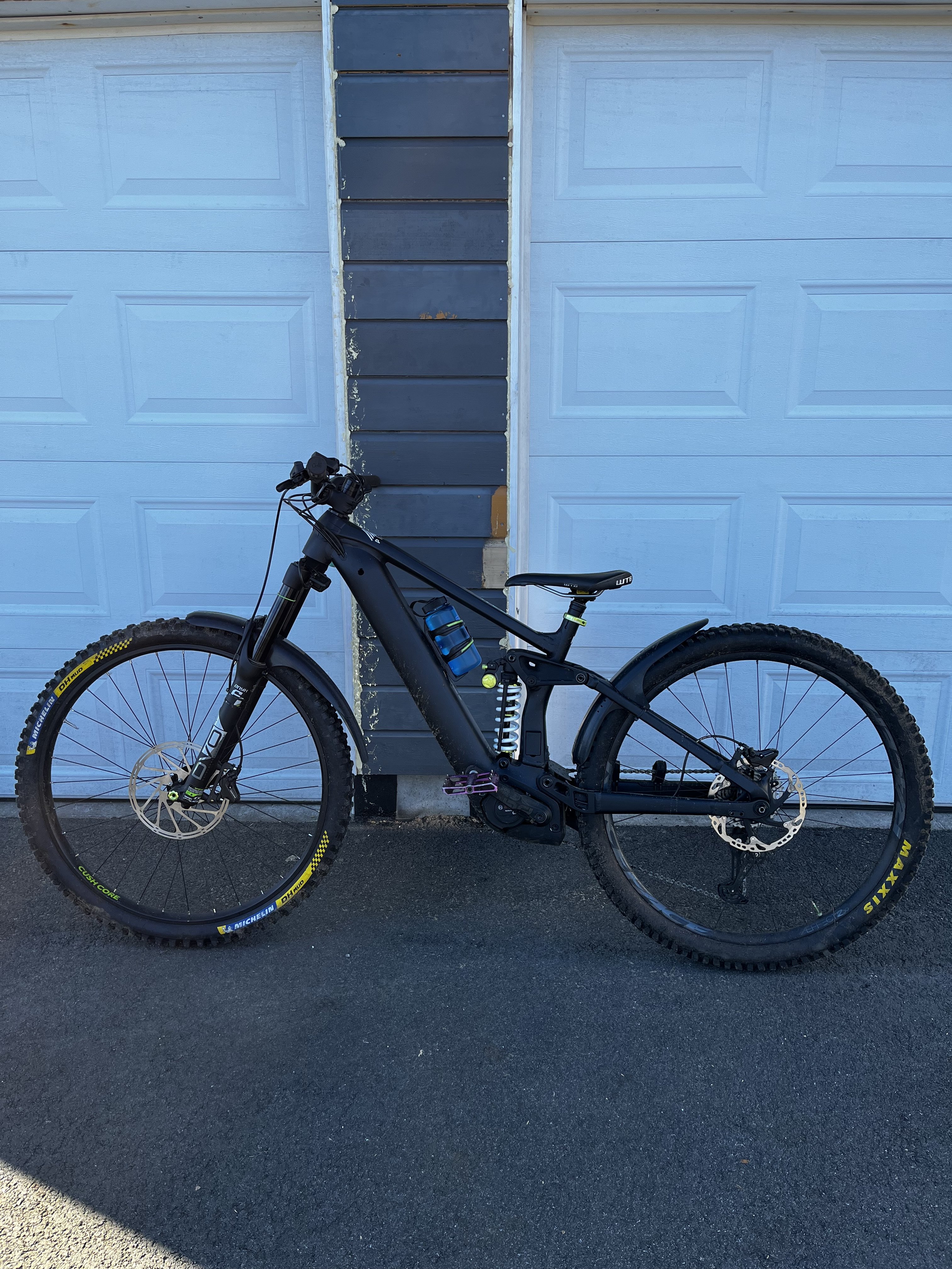

Hi everyone,
I’ve been running my 2021 rail with a EXT coil shock in it and as far as I can remember it has always had this “free play” is the best way I can describe it. When you pick the back of the bike up the rear wheel drops slightly. When I do this with the air shock installed it’s solid. Anyone else out there with a coil shock of any make want to let me know if yours does the same thing? video attached showing what I mean.
Thanks in advance!

Hi.
I just did that test on my Rail. And it's solid. Maybe maybe moving 0.5%.
But will say solid. Have a DVO Jade X.

Wind a bit of preload onto the spring.
That said, if you arent bottoming out and its buttery..... well.
Does it really matter?
PS Make sure its not loose shock eye bushings.
thanks for the advice. I have wound on the preload to take this out - the only worry with this is the instructions state a max of 2 turns preload. but its not clear on when to start counting the pre load - if its once it has absorbed the slack shown above then its only about 3/4 of a turn. if its from contact with the spring its about 5 turns!
Tighten the preloaded ring until it just prevents the spring moving (ie there's no slack but the spring is not compressed). Then give it max 2 more turns. What I do with my Ohlins TTX22m.2
Edit: forgot to say to gently tighten the stop screws to prevent the adjuster moving.

So when I tighten up the top cap of the spring it applies pressure to the spring one it makes contact but it’s minimal until it takes that upwards movement out of the damper. I think it’s ok now but will give it a ride this weekend and see 😅

IIRC I gave mine one turn.

If yu speak to mojo they will tell yu its how ext get the shock to be supple at beginning of stroke don't worry ride it!
