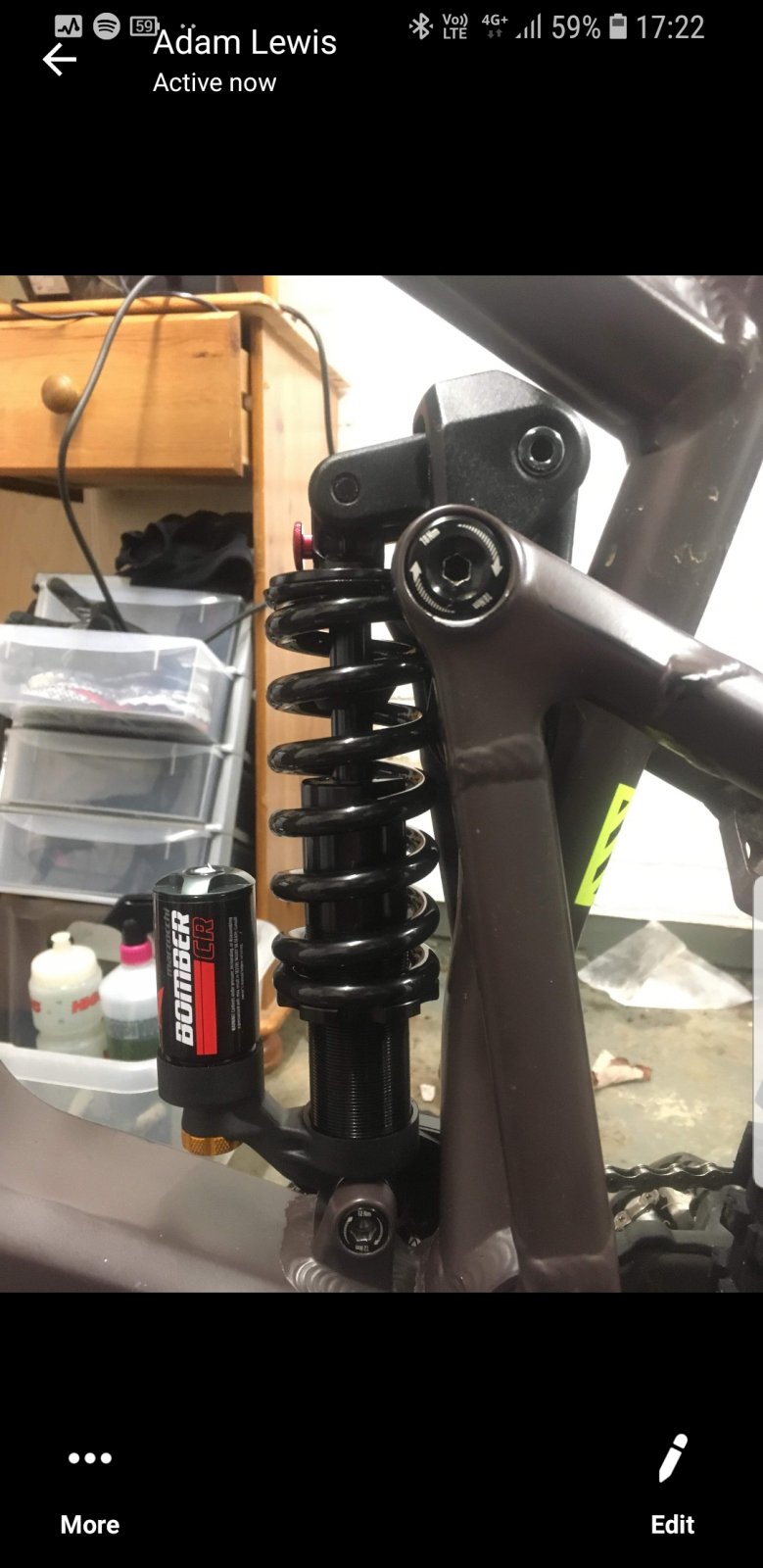

Here we have a Marzocchi coil shock with a 500 spring on the large jam2, 4mm clearance on the frame and it rides superb.
Hi Billy - how does bomber CR spring feel compared to super deluxe? Is there enough mid stroke support and bottom out resistances? I’m in Santa Cruz CA also have Jam2 thinking of doing same swap. Not sure about spring weight or mounting hardware needed. Let know what fox hardware you ordered and spring. I’m about 185, 195 geared up and I ride hard techy stuff fast.
Billywhizz
Jun 24, 2019
15
7
TS147LN
Hi, I am 165, I took in to consideration the weight of the bike. A 500lb spring and no headwear required . It feels better than the fox dpx on square edged hits, it also climbs better on steep rough climbs. Better all round shock imo. Also The Tec pac has plenty of room as some people don't think there is. Hope this helps.

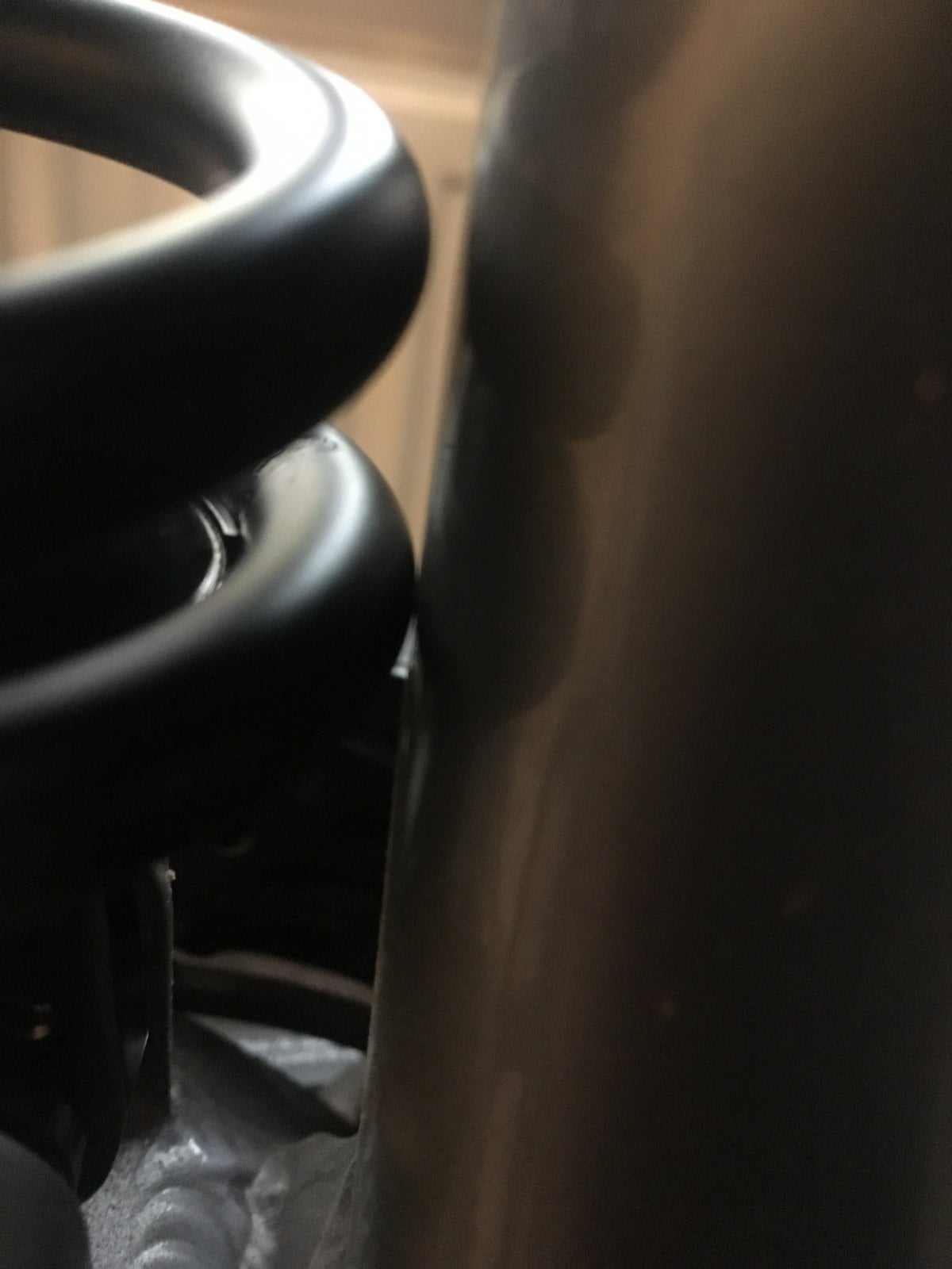

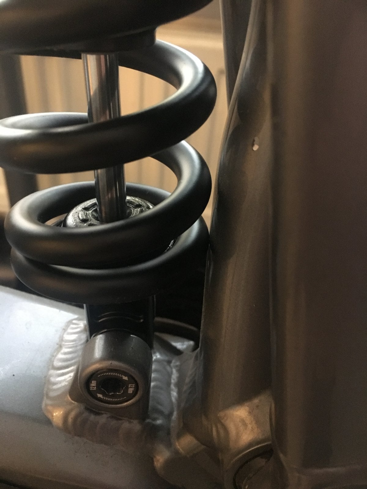

Hi all, I've got a 2017 Jam2 Plus with 27.5 wheels which originally had a Revelation 140mm up front and RS Deluxe on the rear, I fairly quickly switched to a Yari 160 mm and then added an old Fox DHX5 200x57 coil that i had lying round. This setup was way better then the original and much plusher on the rear. Then about 1 year ago i played round and found out i could probably fit a 216x63 coil on the rear if i used offset shock hardware - so ordered a Bomber CR with Valt spring, fitted it on and now have 160 mm on the rear, and no frame rub with the coil. I also switched the Yari air shaft out for a Smashpot and this machine is ooohhhhh so plush now - a completely different beast to the original and awesome for enduro trails - i'd never go back (and i'm nearly out of warranty period so not worried about that either). If anyone is interested i can put some pic's up.
Cheers
Stu
Kiwi_Stu
Nov 5, 2019
9
Slovakia
Hi guys, i have a Bomber CR with ohlins spring on my Jam2 for the past year or so and had no issues, i have a photo at this thread:
One thing to note i have an L frame and not sure this works for M frames
