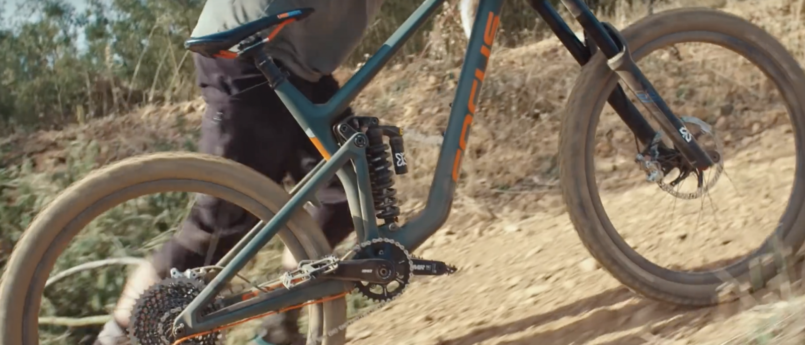

Olly Wilkins has a coil on his analog Sam, saw him riding it at Peaslake last week. He is sponsored by X-Fusion, so may be one of these? Or more likely a prototype:
VECTOR HLR
MRP Hazzard is available with progressive springs, and is designed for bikes where a linear coil would not be ideal.
Hazzard
9,190
Heres is OW's bike

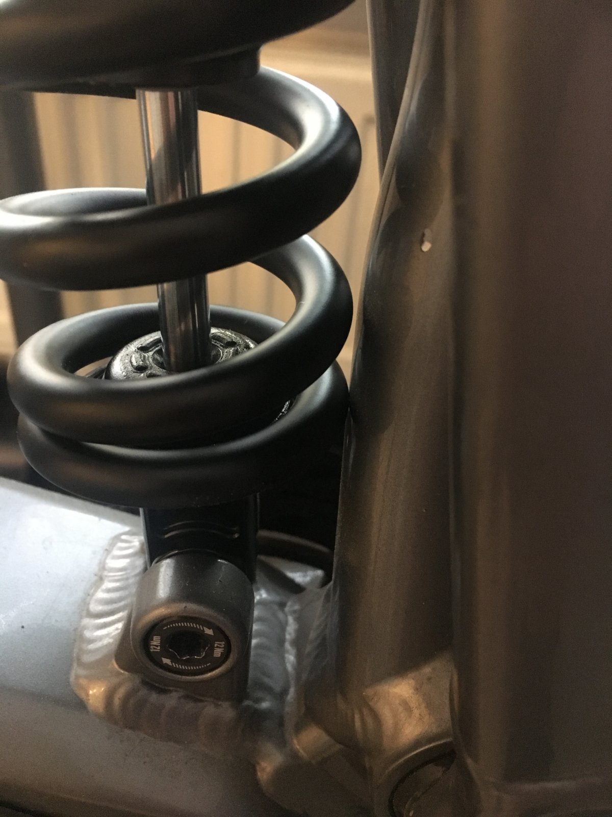

Decided to get the dbcoil inline. Now I don’t know what the eyelet size should be, there’s open eye 15mm too but I don’t think that’s what I need. The size is 210/55 with 25x8mm hardware right?
You should ask Focus directly, they always gave me satisfying answers...

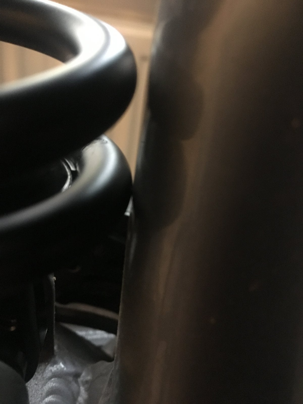

Bumped into a problem :| Cane Creek DBinline coil with valt 2.25” spring and after install it’s touching the frame... what’s the next step?

Actually when it gets compressed it moves further away from the frame.
Agree with regards to the leverage factor, however when you compress a spring it will expand a bit sideways and/or even go into a slight arc.
That setup will rub the frame for sure but it’s your bike and it’s a free world so do whatever you like ;)
