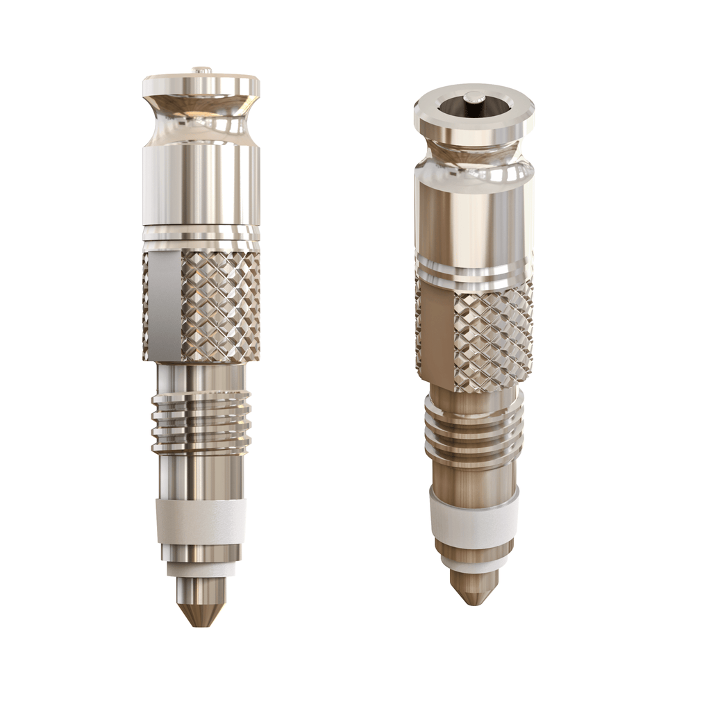

Just bought a set of Clik Valves
The Presta valves always seem to need a tool to loosen every week, even though I only ever finger tighten after adding air.
It will be interesting to see how these do...

I was tempted by these when I saw an ad. for them by Schwalbe (who also offer them for Dunlop valves) but then I thought about it and:- I already have one of those little screw on adaptors to use a car valve (AV) pump or air at a filling station and my wifes Cube came with AV valves anyway. So I would not want to permanently adapt my home pump or the emergency compressed air cannistor thingy and that little screw on adaptor would no longer work, I would still an adaptor but a different one!
I am no fan of the Presta valves but I'm not sure the click valves are the solution, better to convert to AV valved tubes when possible imho.
Schwalbe version
and a retrofit kit including adaptor for AV pumps etc.

Been on the Click valves since just before Xmas. Absolutely love them.
Checking tyre pressure and adding more air if necessary is much better than with Presta and I would argue better than Schraeder (car) too.
With Presta and Schraeder you are trying to make a seal between the pump head and a sharp thread. This inherently is inclined to leak (through the thread) and by wiggling to the side as you try to clamp on a fairly short length of thread. The thread also slowly chews up the rubber seal. You also have the extra step of tightening (or screwing on) the pump head.
I haven't seen any coverage of this but the Click valve seals on the INSIDE of the valve. A stainless thin walled tube (like a giant hypodermic needle) goes down inside the Click valve and is sealed by an O-ring; whilst the outside clips on to keep it down.
As well as sealing perfectly (very quickly) this also stays on without any supervision even if you are pumping like crazy with both hands on the track pump.
It may sound trivial, but the time saved:-
1. Unscrewing a valve cap, (which you have to do with both Presta and Schraeder and Muc-Off and Fillmore etc etc)
2. and (in the case of presta) unscrewing the valve itself.
3. Screwing on or toggling the lever of the pump head.
4. Keeping the pump relatively steady so that the pump head doesn't leak on the valve.
5. Unscrewing or removing pump head.
6. (in the case of presta etc) re-tightening the valve itself.
7. Re-screwing valve cap on.
Which is now just:-
1. Pull cap off.
2. Push pump head on.
(pump without worrying about head coming loose)
3. Pull pump head off.
4. Push cap back on.
Is really noticeable. (though I do have 2 valves to check on each wheel so this was always more of a pain for me than most people)
It is also nice that whatever pressure I get on the pump it seems like there is zero leakage when disconnecting so I feel confident the pressure is spot on.
I was also pleasantly surprised that my existing Presta mini-pump and Topeak D2 digital gauge work on them with zero issues.
100% recommend.

Well this is interesting...
The Clik valves showed up today. Wasn't expecting them until next week according to tracking.
But... the surprise is that they shipped the pump adaptor head with them, which I did not order!
Lucky bonus day for me! Might not be until the weekend until I try this all out and convert the Presta cores, but big grin on my face anyway!
DaveMatthews
Aug 12, 2018
493
332
Vancouver, B.C. Canada
For what it's worth, the Clik cores are made in Italy, and oddly, packaged in Taiwan. The caps snap on snugly, so I suspect they'll stay on no worries.
The Pump adaptor head is made in Taiwan. It is aluminum and very nicely machined/made. You can use it on different pump types.
