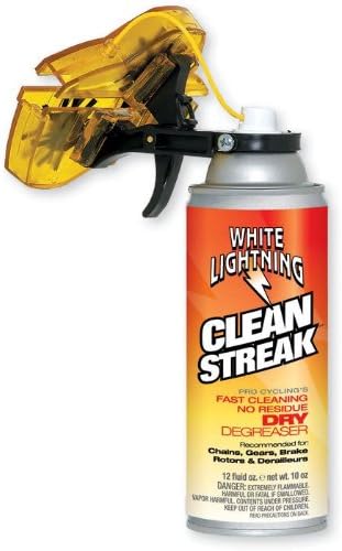

a stand and
White Lightning THE TRIGGER Chain cleaning system
