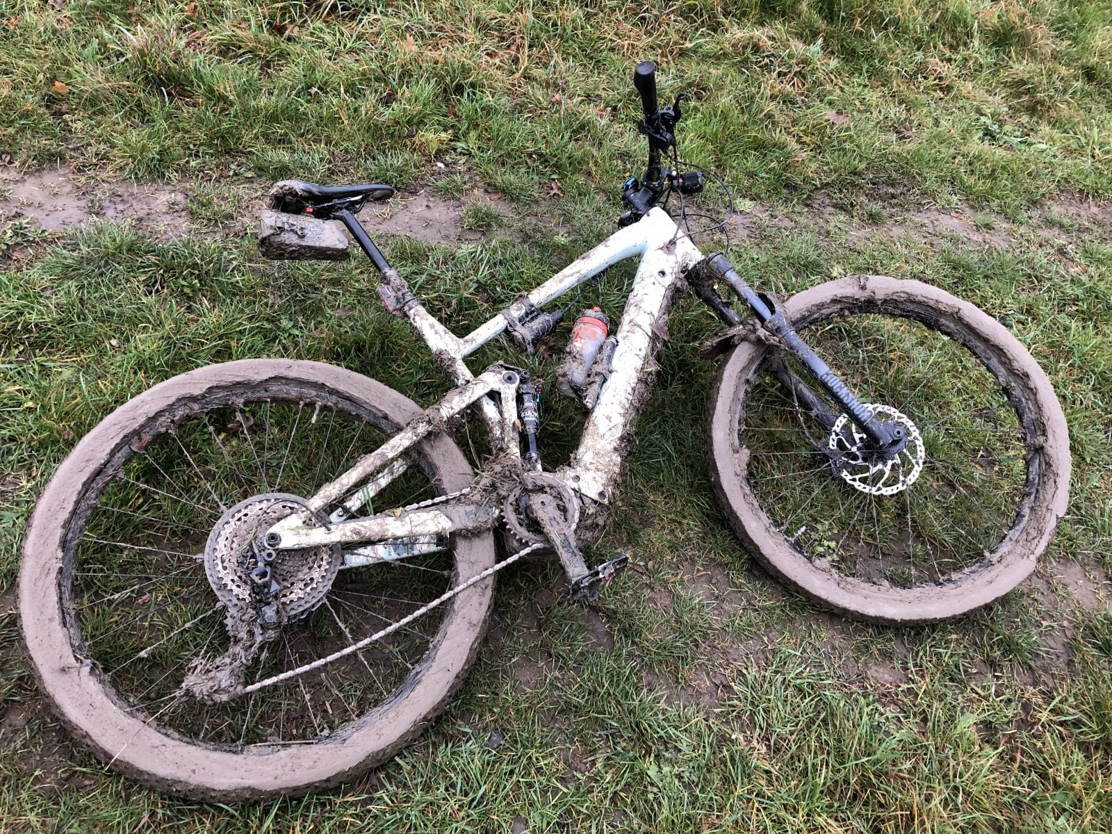

Been giving the chain somd much needed love today, and to be honest I am once again very dissatisfied by my Mucoff chain cleaner. Really messy, not very good, can’t really get it to work as it should due to not being able to back pedal, all in I’m thinking there must be better out there. But where and what is it?
Thanks in advance.

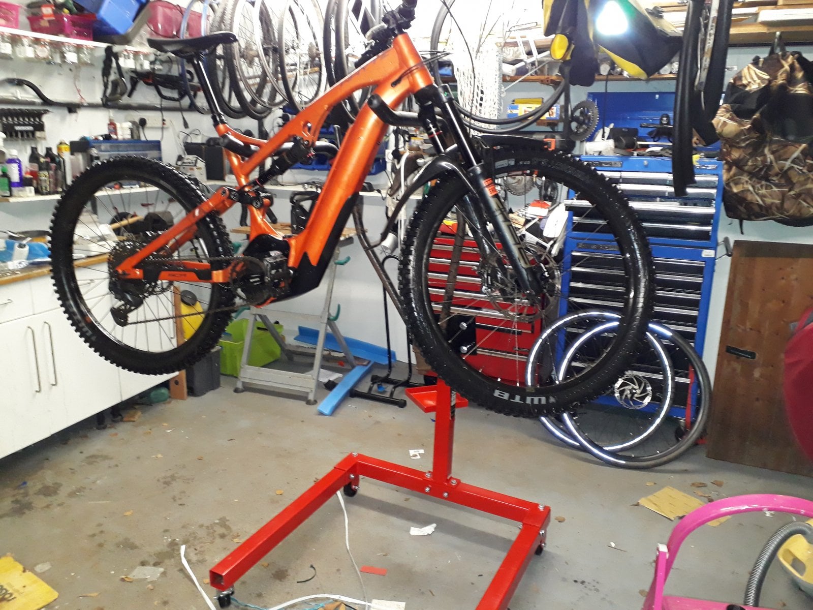

I use my MOABS 1 see photo so it is easy to pedal forwards for chain post ride chain clean. My back is so knackered I can't do the bending over thing.
then every month I take the chain off and stick it in a cheap ultrasonic cleaner.
I admit it is a Rolls Royce solution, but the ultrasonic cleaner was cheaper than 1 cassette, so has paid for itself several times over.
