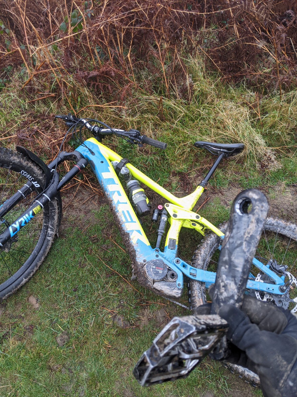

Yeh 3 rides in and lucky enough I found the bolt about 20 metres away

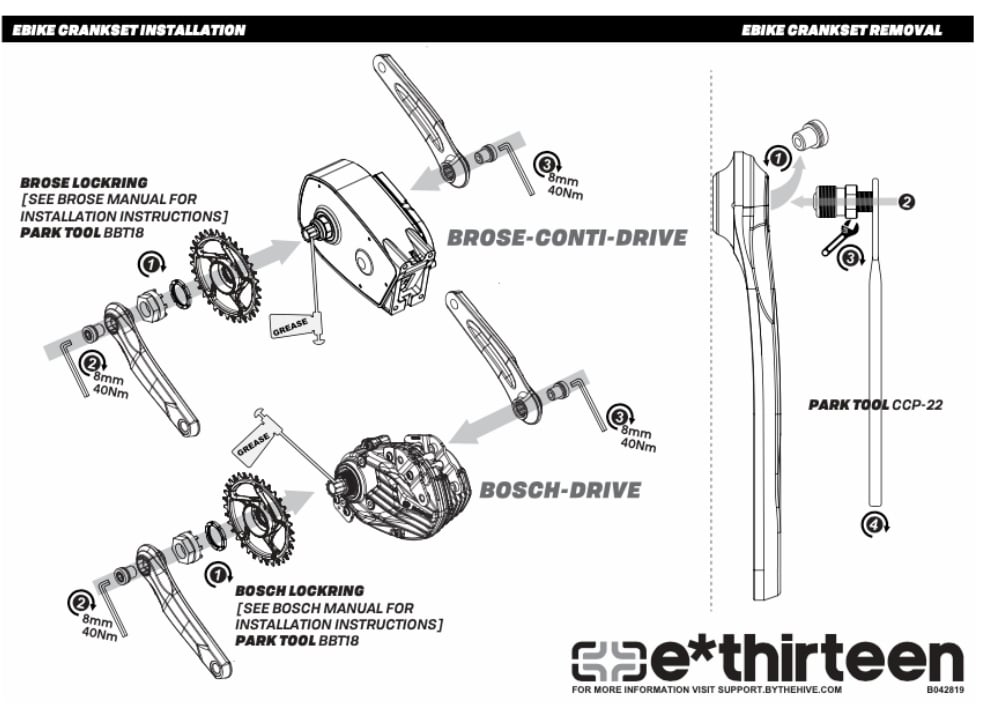

Maybe worth a mention that e*thirteen appear to have listed the wrong Park tool to pull isis (splined) cranks ... it's not the Park ccp-22 (or equivalent) which is for square taper and won't work ... it should be the Park ccp--44 or the cwp-7 (or equivalents)
I'd rec the cwp-7 as it does both and you can get a bigger wrench on it if needs be.
