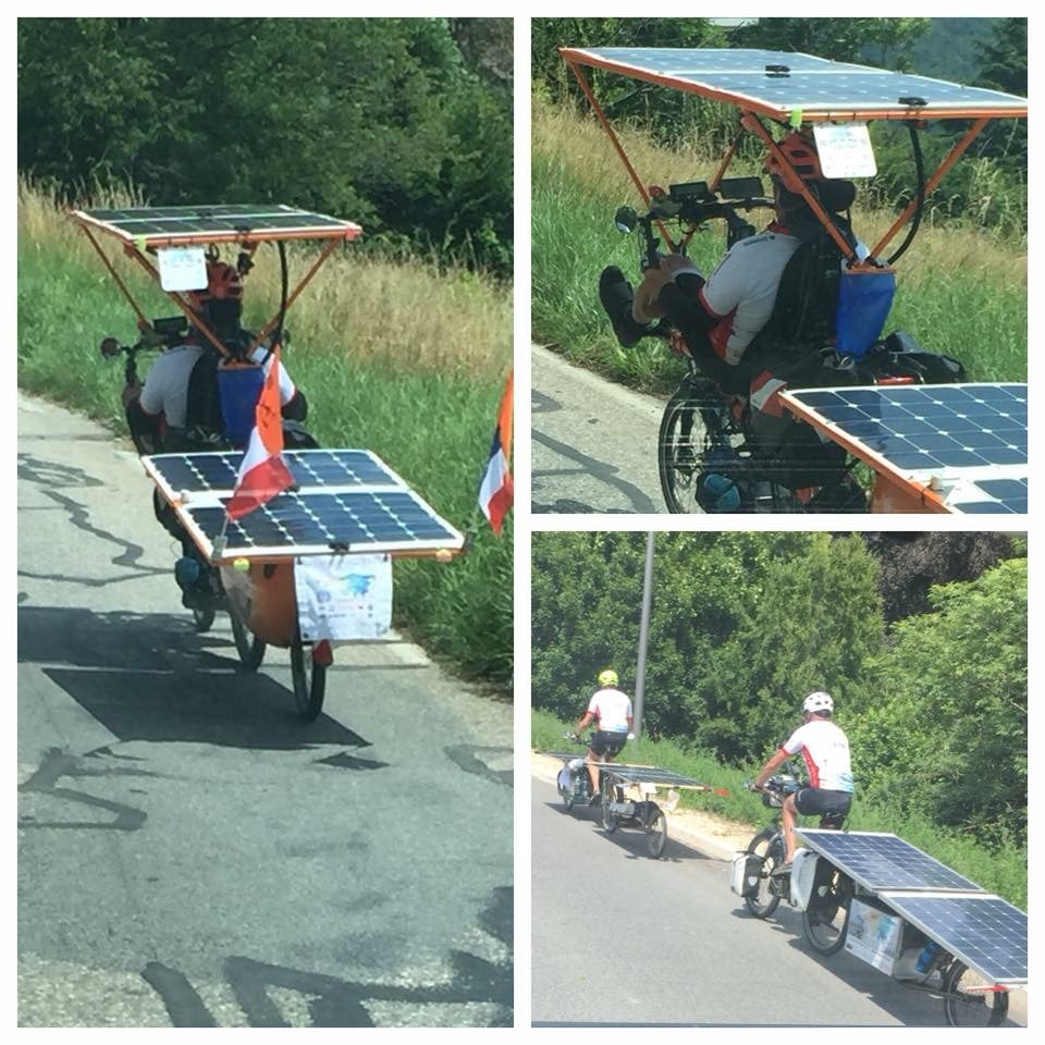

Charging problems solved

I dunno, they might be a bit of a handful on decent singletrack...
