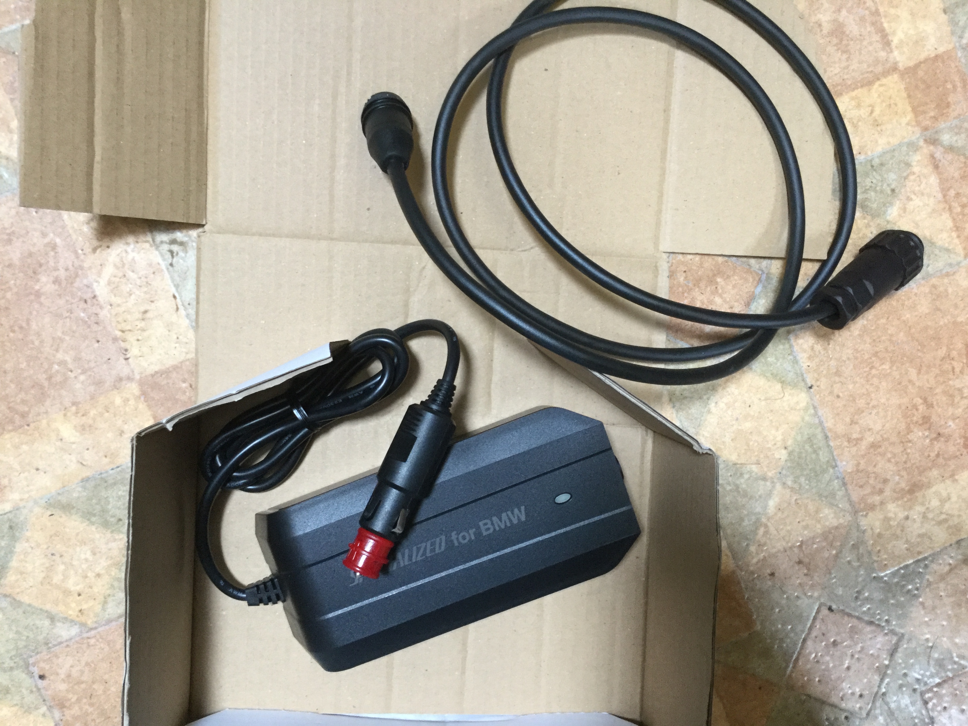

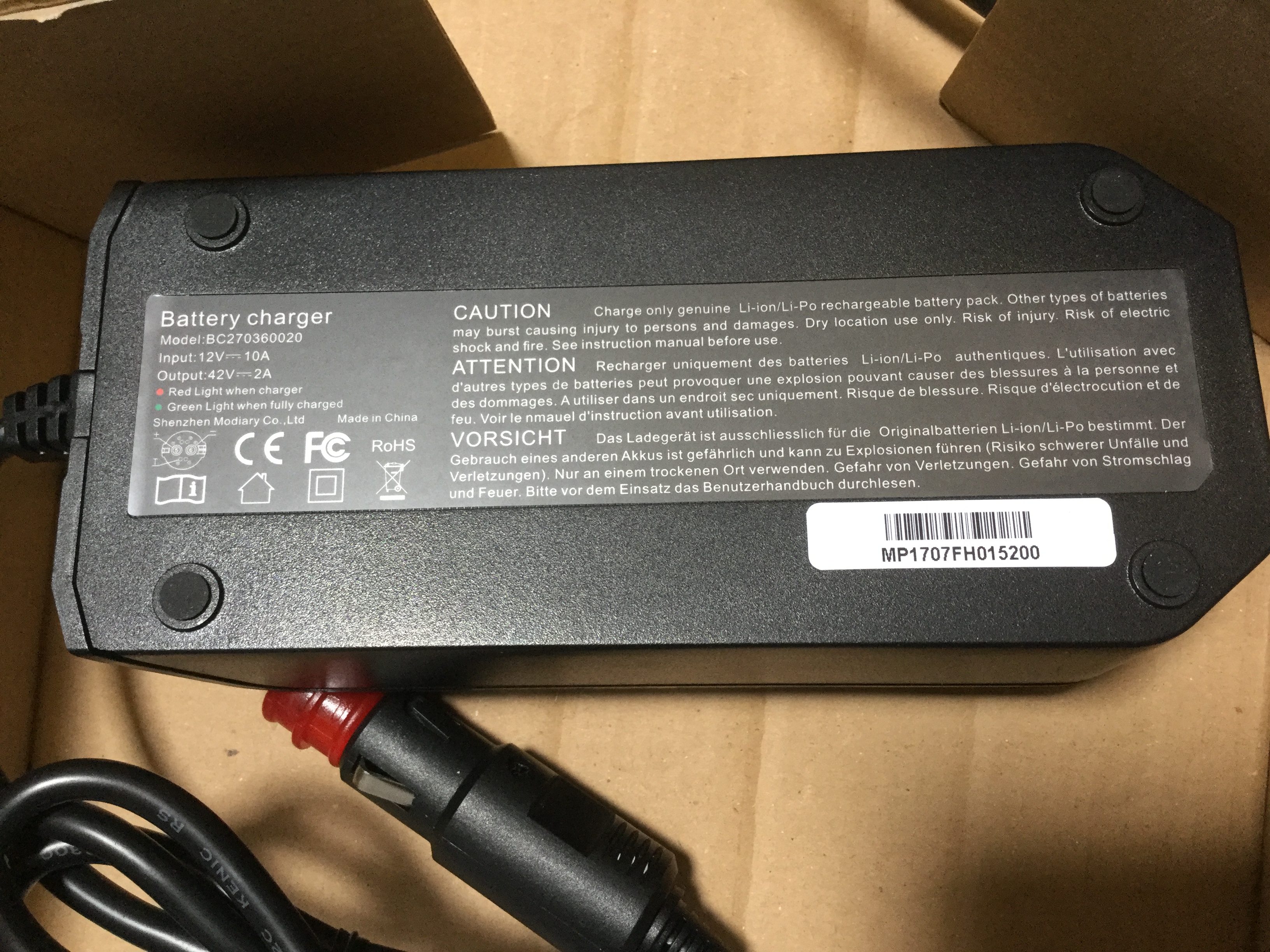

Hi kernow here’s a slightly different approach. My bike is The BMW version of the Levo and comes with an additional vehicle charger. Probably a BMW part so probably won’t be cheap, I haven’t used mine yet but it is purpose made for the job. Still needs a reliable power source though ie a running vehicle or charged battery. I guess the number on the back of the photo is a part number? Hope this helps.
A63C1114-E0C5-426C-986E-1DB3FB0413D2.jpeg 5AADDE7C-75EC-4FA0-A169-EFCE7738E5CA.jpeg

Has that an RoPD connector on it? Would save me having to use an inverter. Only downside is charging at 2A where I can do 4A with my current setup.
