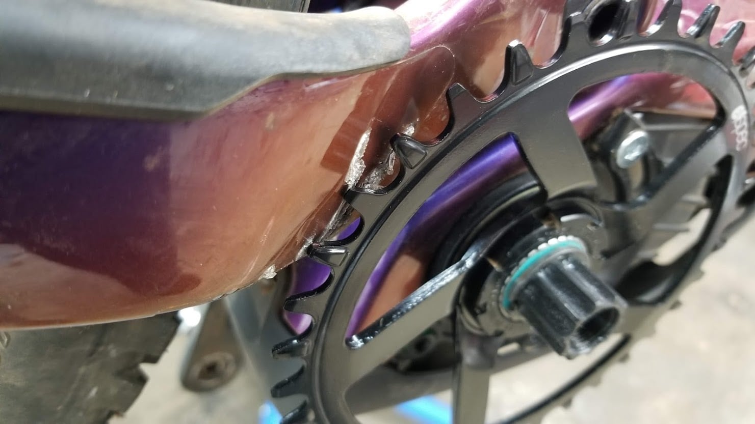

I have a 2021 rail 9.8XT (carbon) and the ethirteen espec steel 36T won't fit. Believe me I tried. It rubs the chainstay big time. I barely have clearance with the 34T. I feel that for quick sprints on fast and flowy trails the 34T is just a little short. The bike should come with a 36T stock!
Check out the 36T below. No way!!
