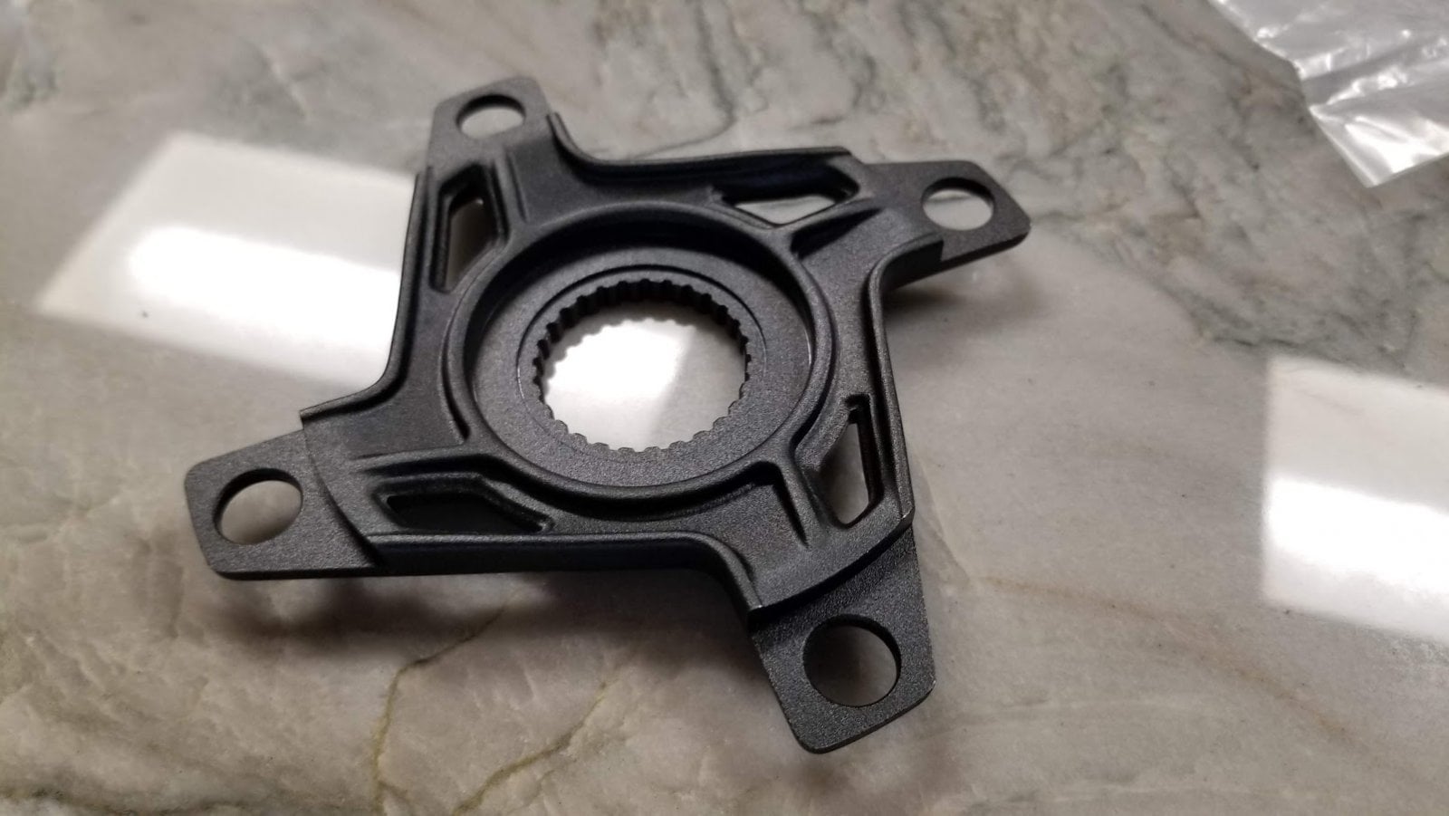

My new spyder has more offset than the steel factory gear. I believe I can fit a 38 tooth sprocket (no spacers needed). I removed plastic chaingurd because my chain was rubbing slightly against. Here is correct part number for the FSA Bosch Gen4 Boost 148x Alloy Spider BCd104 SB black(CL53)
380-0372000050
The new Spyder is a tight fit, but it will slip on eventually...do not give up.
I discovered that my chain ring nut was loose so I used blue loctite to reattach.

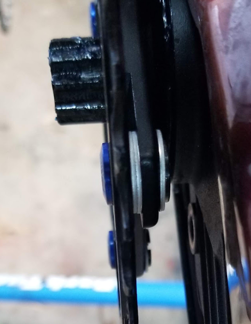

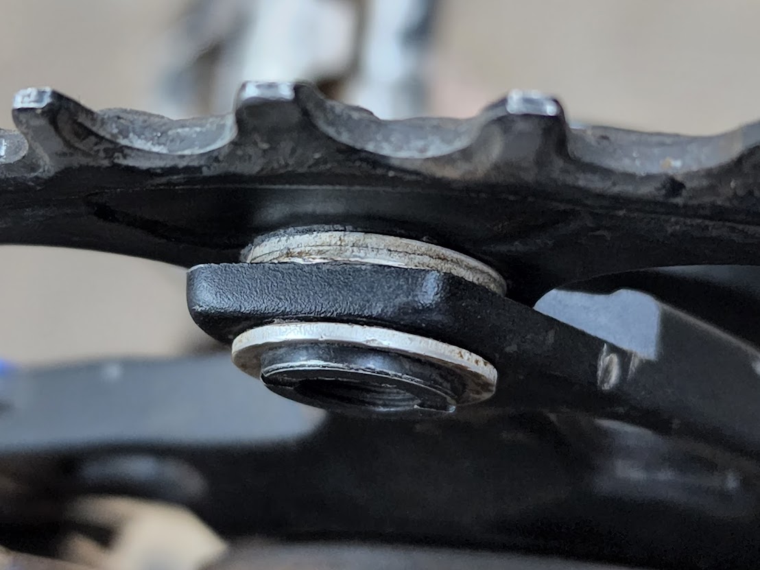

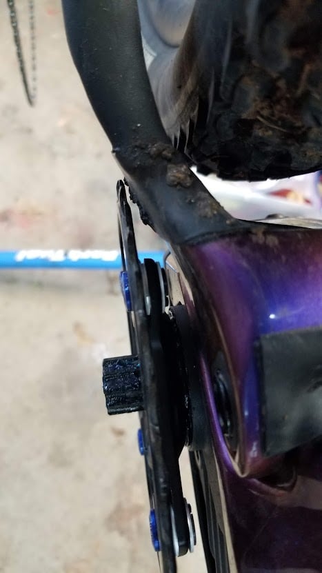

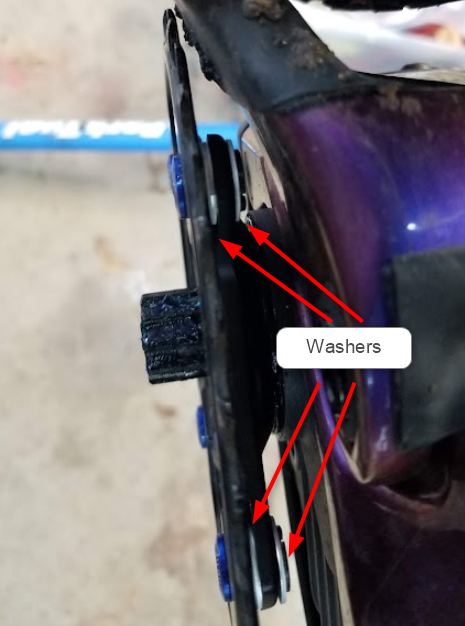

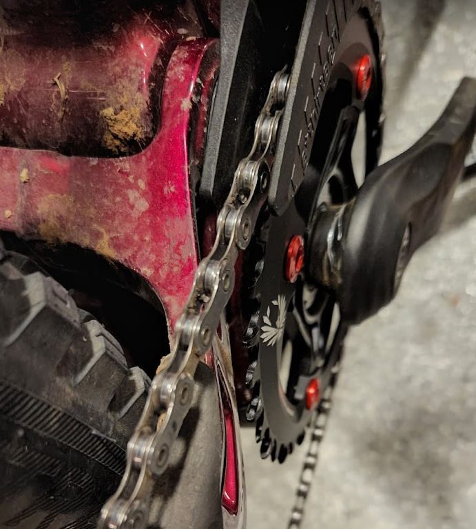

Aviserated, I've tried three spiders so far and the best one for the 36T is the FSA 1X Spider Boost 104mm BCD for Bosch Drive Unit Gen4 - W0138. With the FSA W0138, I added two thin washers and now the chain line is as close to stock as I can make it. The 36T is almost rubbing like the 34T was. The washers are thin enough that the chain ring still rests in the spider alignment grooves.

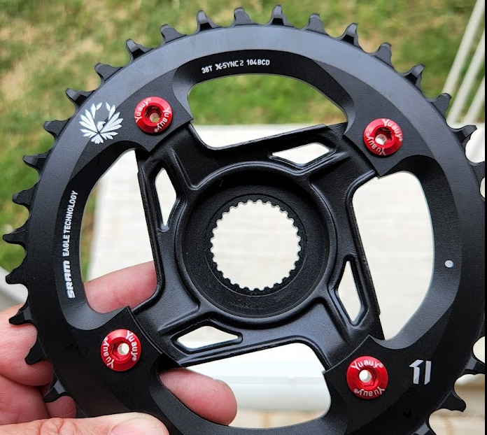

I want to do this upgrade too. I've read over this thread about 5 times now and since there are so many options to choose from, I think I want to try the last configuration that dixie600mhz did except using the SRAM chainring that Link used. I have listed below what I think will work except for the washers. I figure I'll head to Home Depot / Lowes and find what will work (matching what is shown in the pictures)
I'm hoping either of you have a few minutes to verify that this is what I need. I'd rather not order this stuff twice.
Shopping list:
Spider 1x boost 104mm BCD Bosch: (ships from 4 US states) $26 + $7 shipping
SRAM Chain Ring: (ships from Colorado) $51.95 + free shipping
Yuauy Chain Ring Bolts: $8 + free shipping at Amazon
http s://www.amazon.com/gp/product/B07V7534WY (remove the space between http & s to make this amazon URLwork)
Thanks in Advance!

The washers are kinda visible in two of his pictures above. There are three washers per lug (I think) 2 on one side and 1 on the inside. His other picture shows this better.

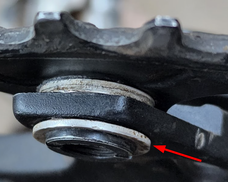

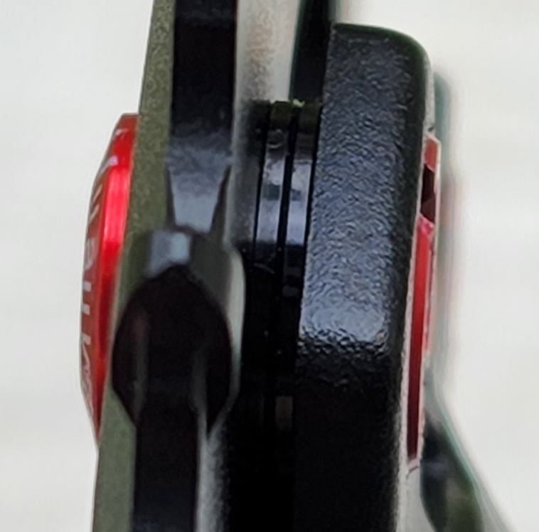

Here's some better pics of the washers. The 36T is perfect with the FSA 1X Spider Boost 104mm BCD for Bosch Drive Unit Gen4 - W0138 and some really small washers to help tweak to perfect chainline.

dixie600mhz I'm curious, was this washer needed? Was the hole in the spider too big for the chain ring bolt?
dixie600mhz
Oct 13, 2020
174
160
Austin, Texas
Thinking back to when I did it, I think the chain ring bolts were slightly long and that's why I added the washer on the back. I remember that the bolts weren't threaded their entire length and the nut would bottom out on the end of the threads unless I added that washer. I'm super happy with the 36T ring. I even went 10-46 on the back and have enough low end grunt to do the black trail rated technical stuff. I think the bike is happier in general after moving away from the tiny 34.

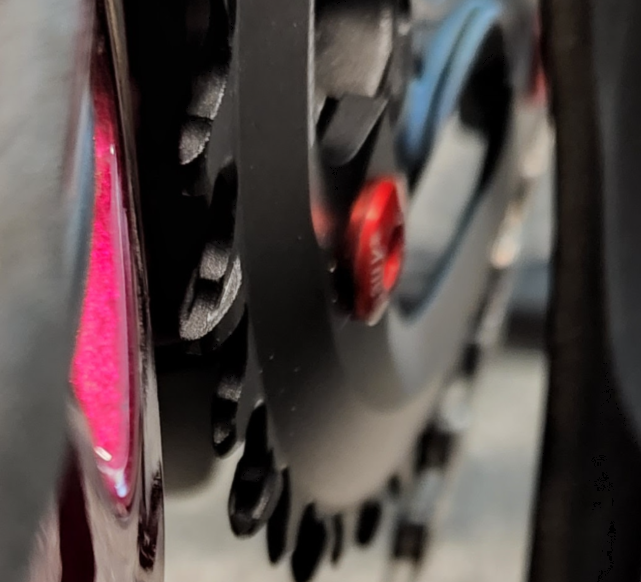

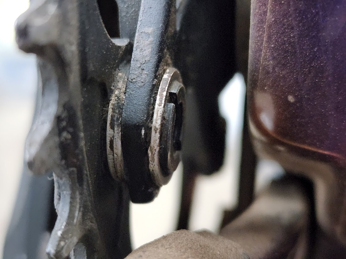

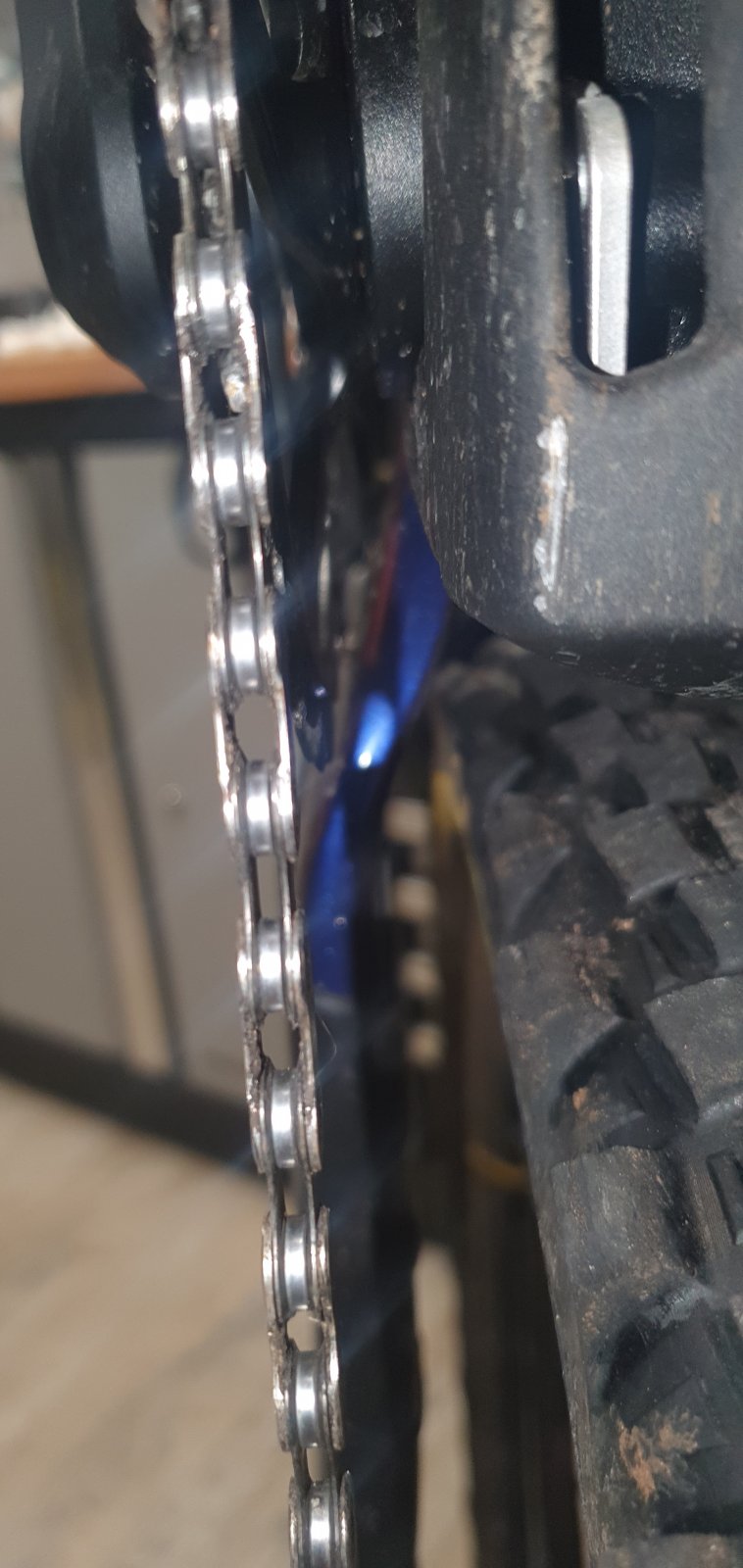

I have this much clearance with the new 36 tooth chainring. So, I ordered a 38 tooth chainring today. Hope it has clearance too as going from 34 to 36 is not that big of a change.

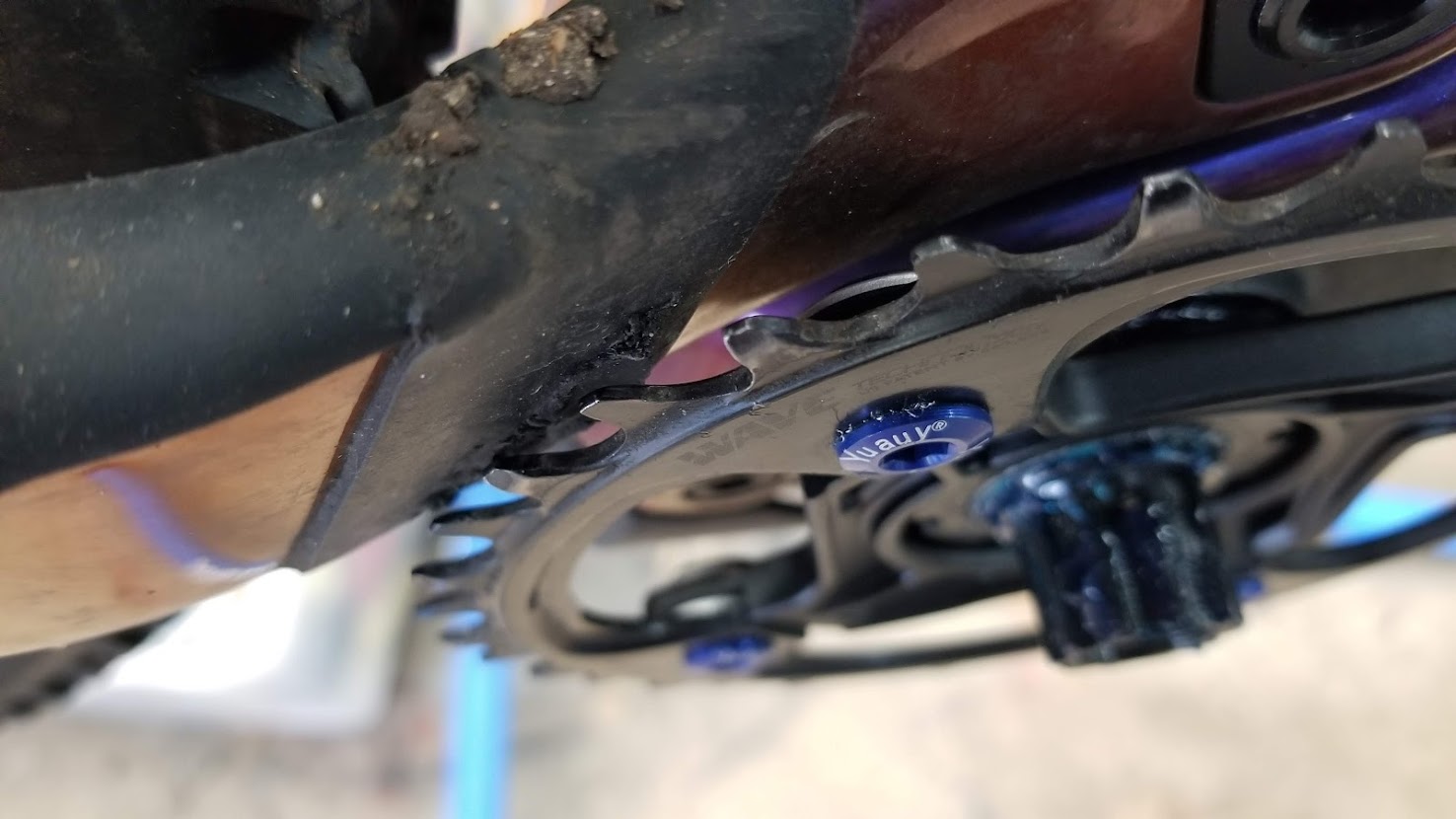

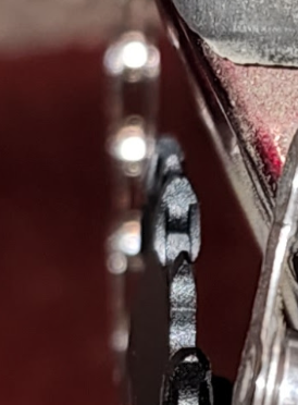

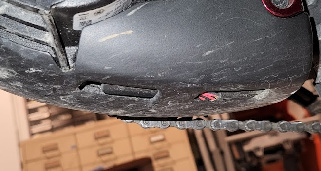

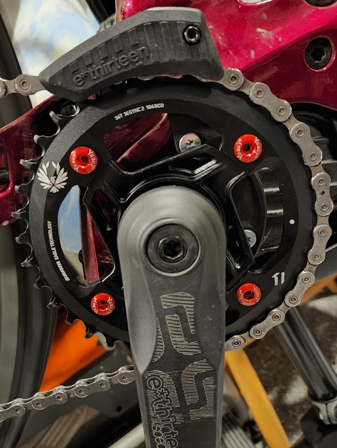

Anybody want to use a 38 tooth chainring on your Trek Rail? Yep, it fits! ... ... ... I'll post a write-up in a few days.
I have clearance!!!
Even the chain guide works, but this is the extreme limit for height adjustment.
I used two washers, but it looked like it would work with just one. Each washer is 1mm thick.
I may have to worry about the chain and chainring being too low, Gotta be careful when traversing rocks I guess.
