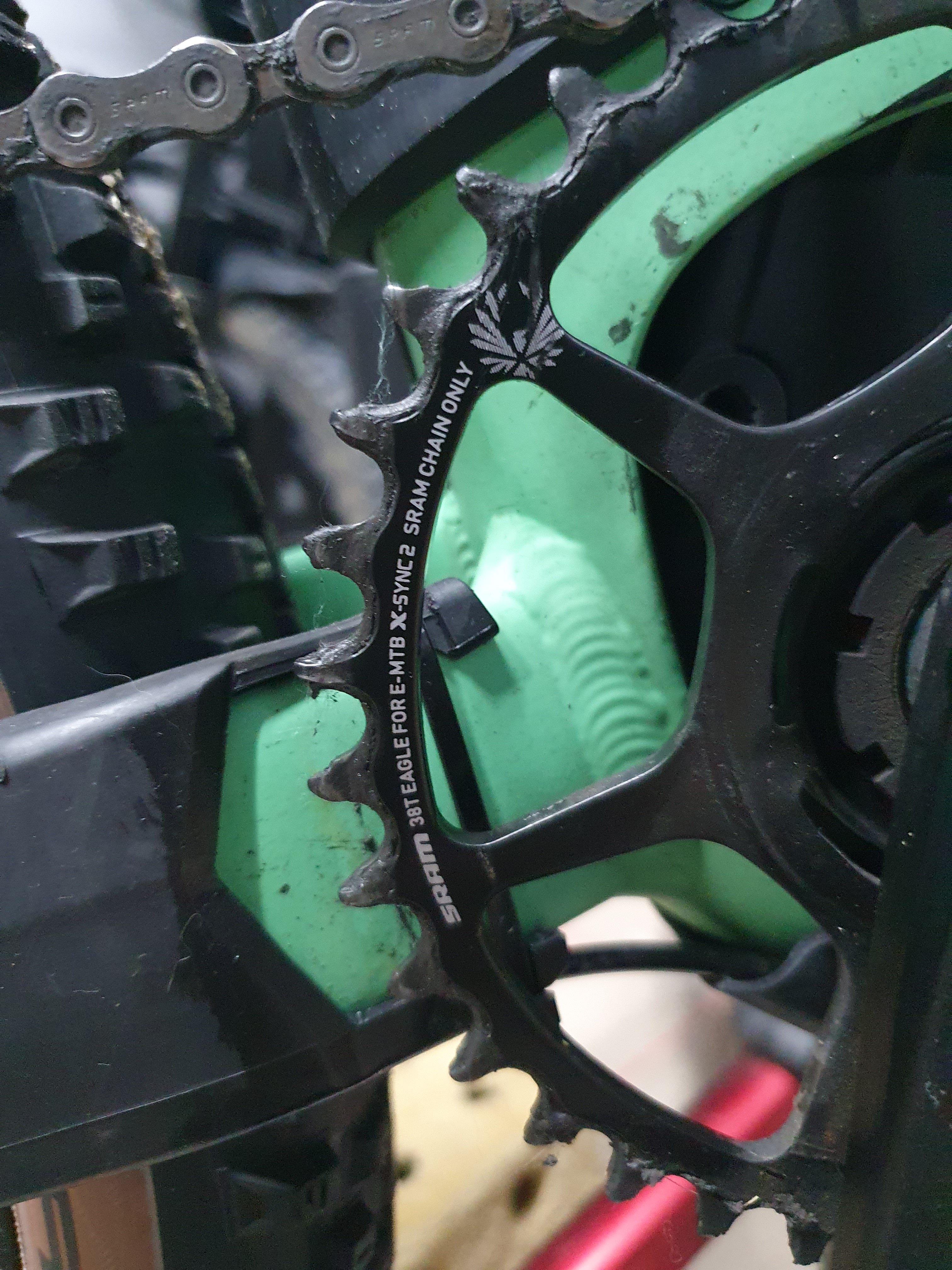

I have recently bought a Cube Reaction Hybrid SL 2021 and I want to change it's Sram X-Sync 2 Eagle 38T chainring (see image) with a smaller one 36/34T because I'm fat and I live in the mountains and I don't want to strain the motor/transmission when going uphill.
The problem is that I do not know if this is a boost or a non-boost chainring so I don't know what to buy.
Can you help me identify it? Thx!
L.E.: What tool do I need to mount/dismount this?

The answer is that it comes with BOOST chainring, you can can identify it by looking on the backside, it has "BOOST" engraved to it.
From my experience I can say it does, I have bought a 34T chainring, 4 teeth make a huge difference, I also have a Scott Ransom eRide that has the same 29+ wheels, same engine, same transmission and the 34T chainring on it doesn't seem "really low" on steep climbs.
