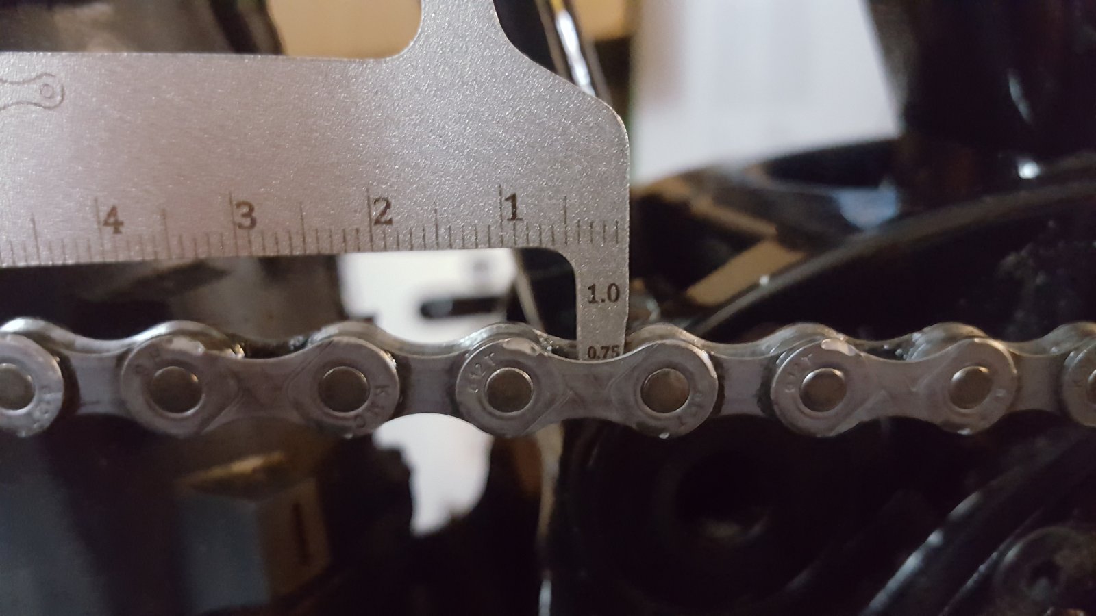

I had the original kmc 12 speed chain on my Trance, and measured it after around 300 miles:

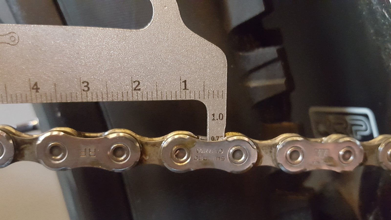

I read that as 0.75 so repaced it with an slx 12 speed chain, pictured here after one ride:
to my untrained eye, they measure the same, so I guess it's either a bad tool (cheapy one from amazon), or I'm reading it wrong, and the chain didnt need to be replaced.
I'm still using a crappy tool that was a giveaway with a magazine. Really must invest in a decent one.
