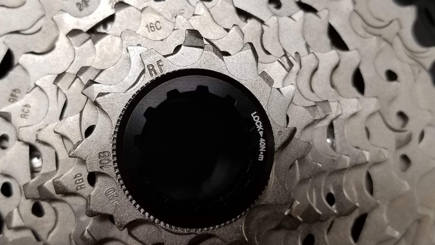

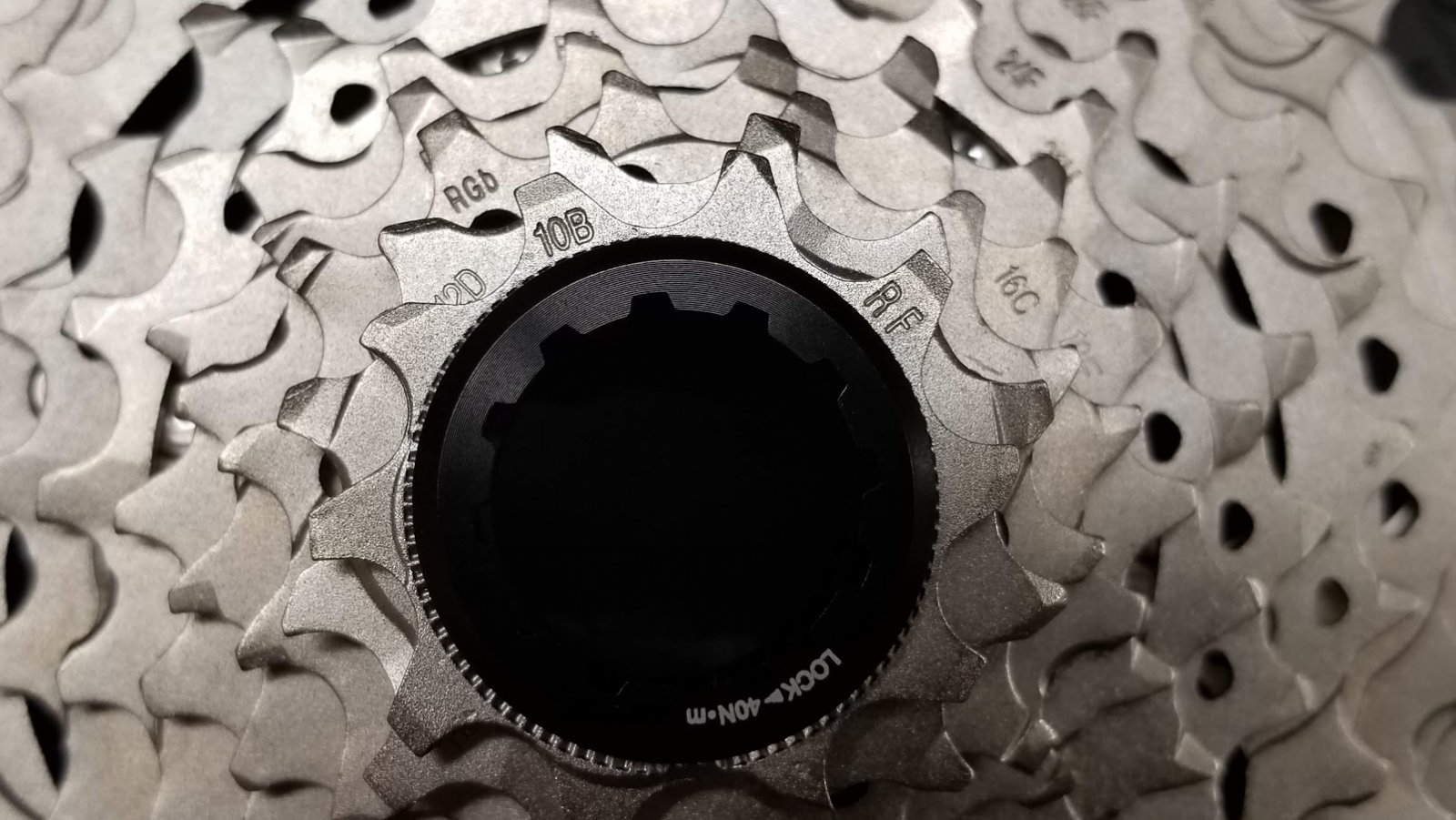

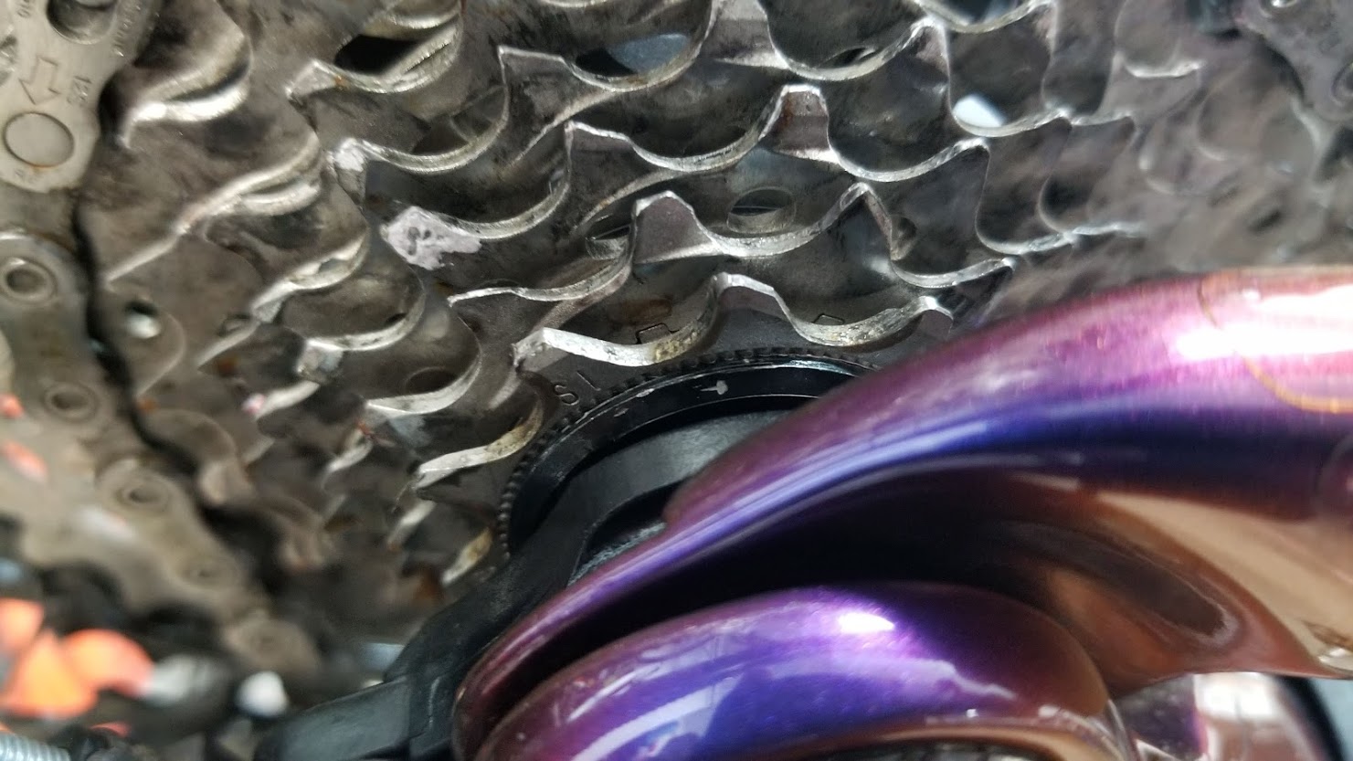

From the last picture you can clearly see that the smallest gear has been worn.

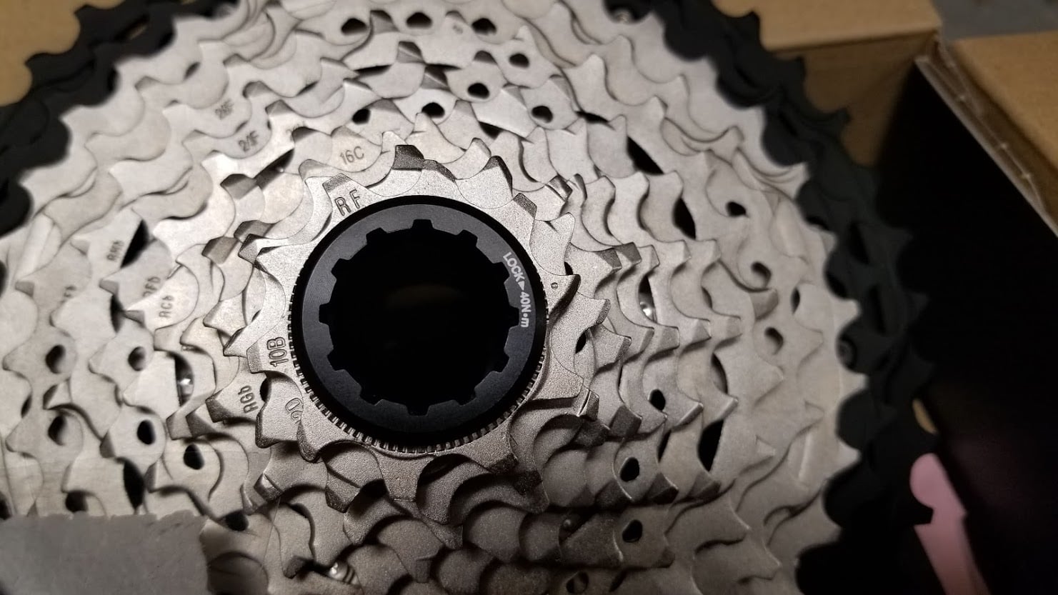

I have the new 10T rings and am carefully comparing old and new. There's two posts saying the wear is obvious. Considering that each tooth has a unique shape, when I compare old and new exact tooth for tooth I can't see any significant wear. Maybe at the very tips of some there is slight burr. It's not clear to me that the old one is badly worn. Keep in mind it does only have about 400 miles on it.
For the record I'm usually in eMTB mode but I'm quick. Trails in Texas are usually hard packed and fast and flowy so I spend most time in the higher gears just to keep pace with other riders. 36T front spider and chainring can't arrive soon enough.
See old vs new below.

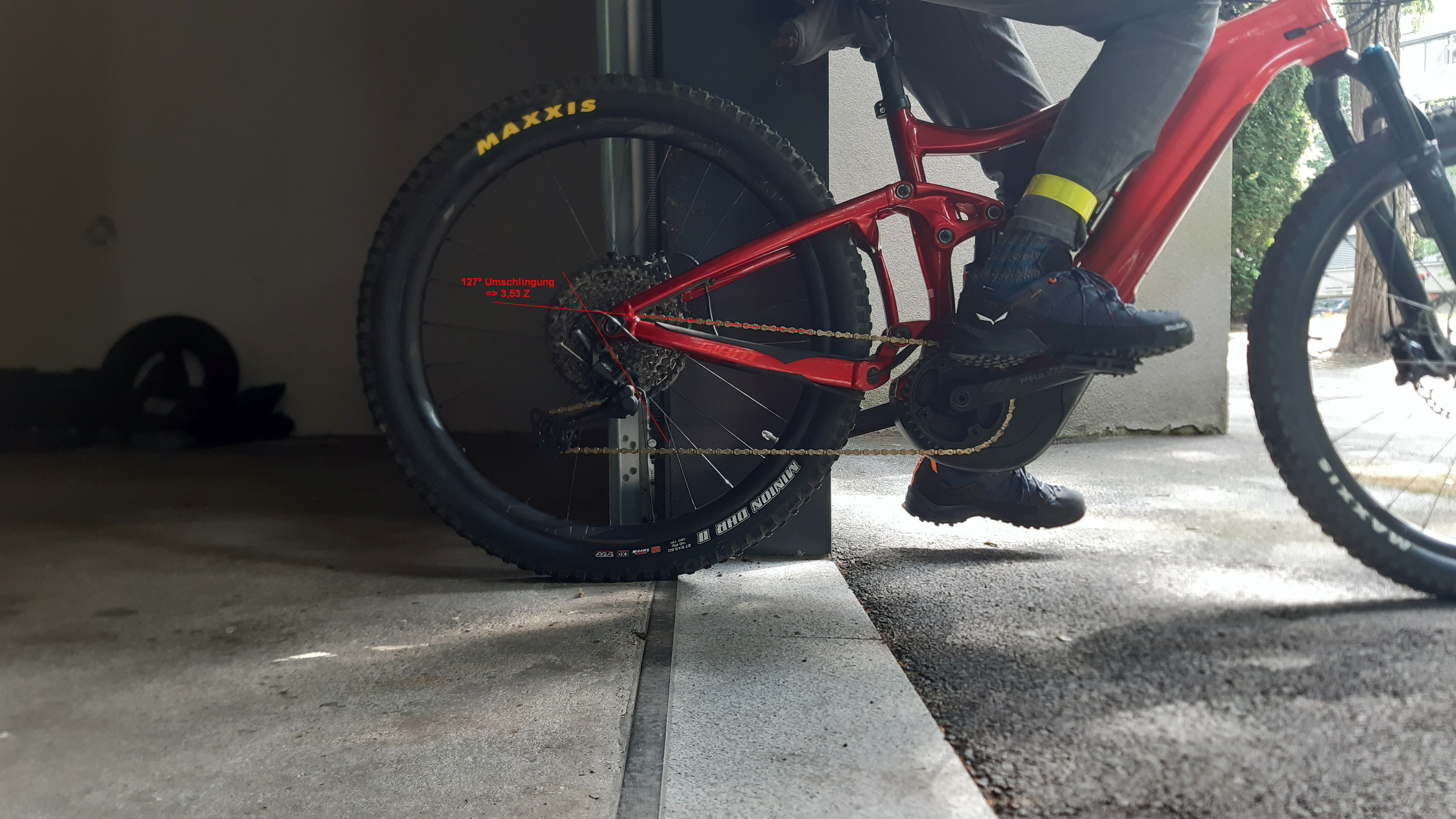

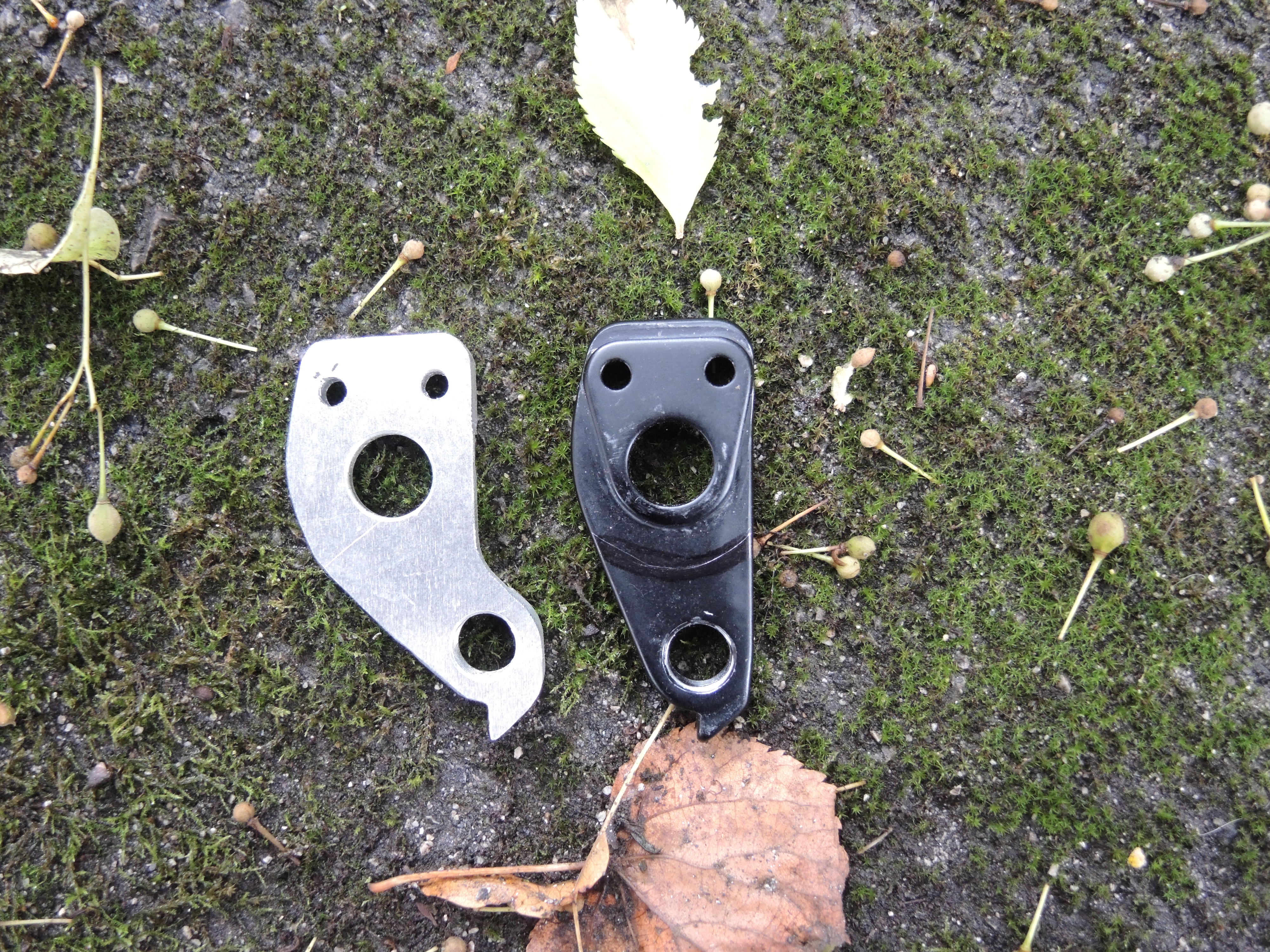

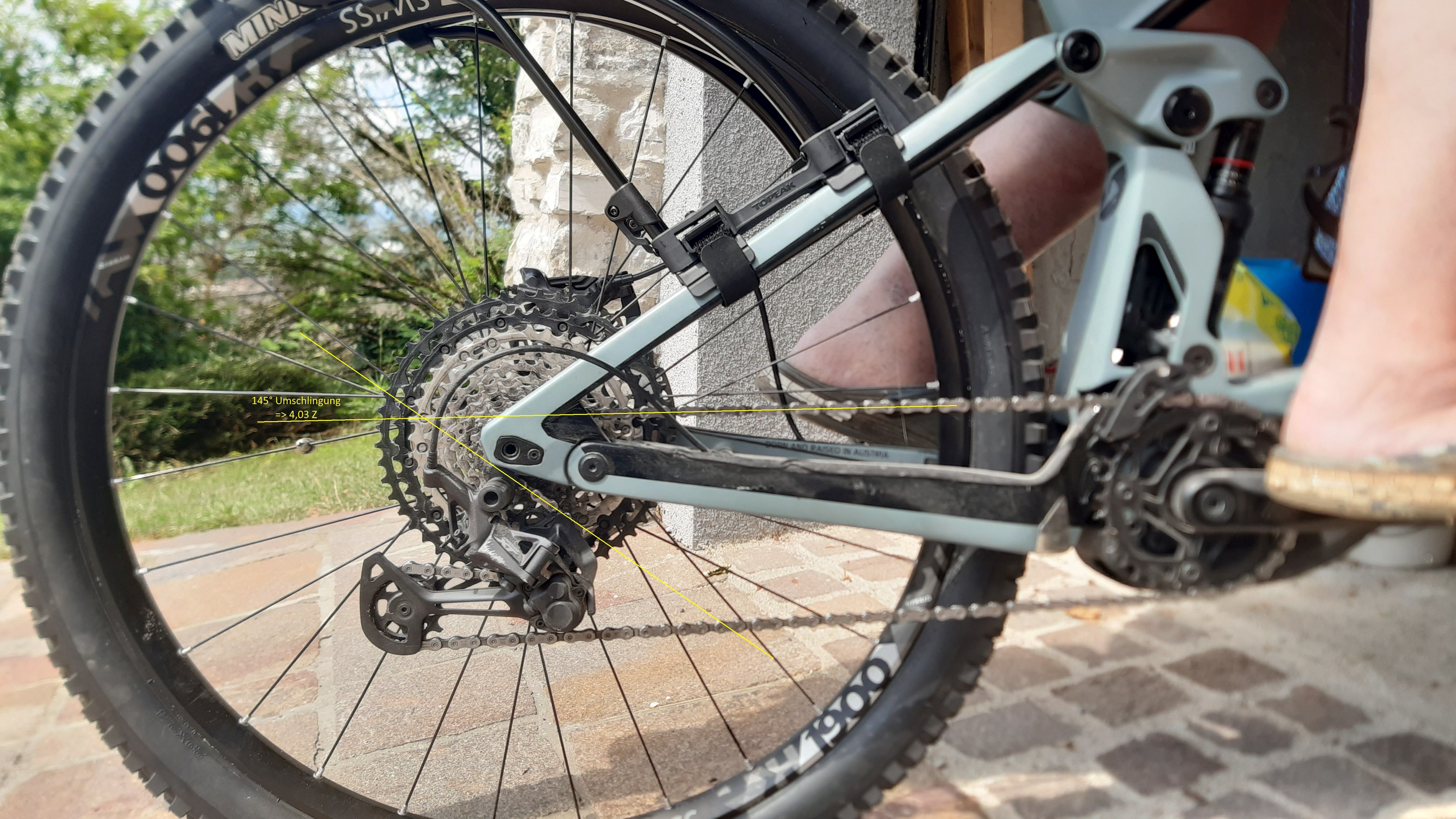

This thread is not new - so you see, this topic is an every-day-trouble.
So for me.

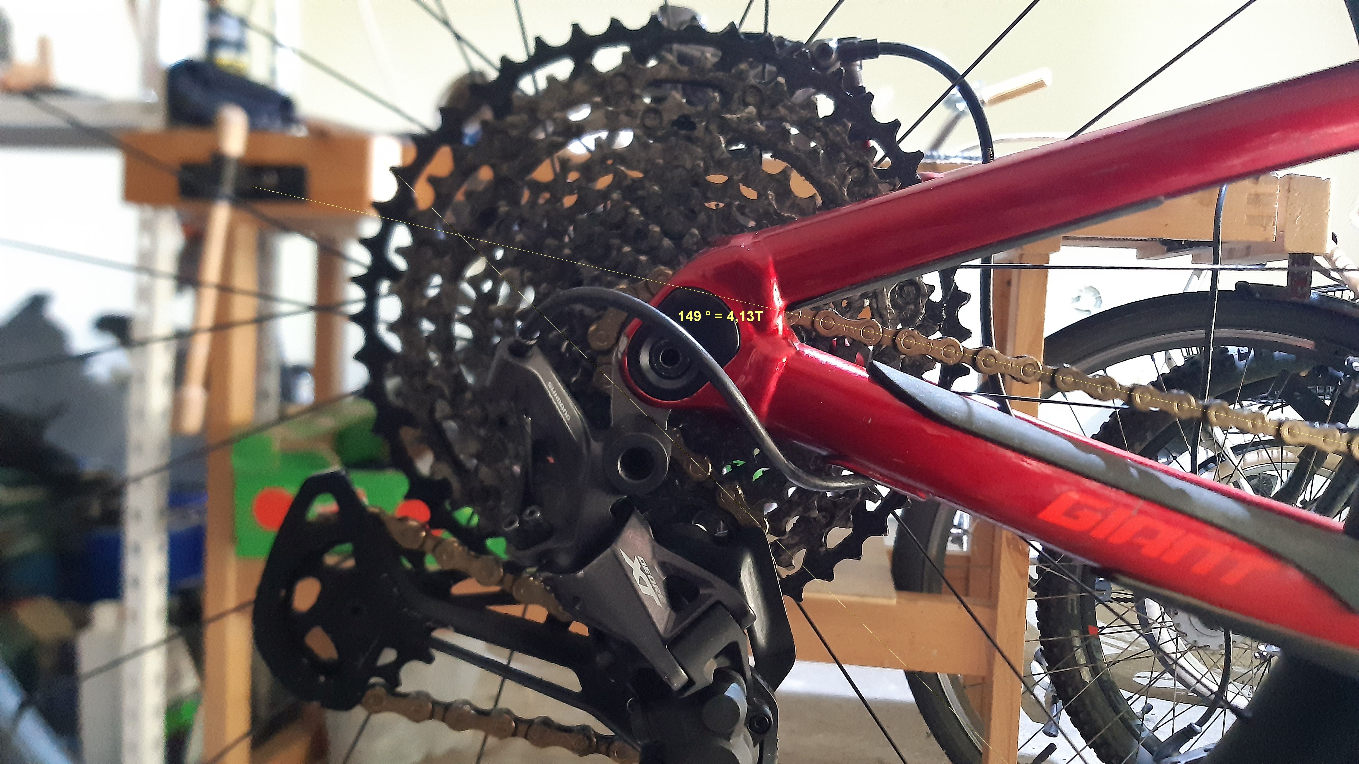

I bought my Giant Reign in autumn 2020. At the 70 km at riding from dealer to home I experienced first time chain slip on the 10T gear. (The fastest gear, smallest cog)
I am going to solve it as follows:
Chain is brandnew, the to smallest cogs are also nearly new.
The derailleur is adjusted perfectly! (B...)
I testet longer Chain, higher preload angle on the derailleur and the gap between 1st and 2nd gear and different chain manufacturer.
Nothing could solve the slip - it only disappeared with the wear and elongated chain and high preload angle of the derailleur.
Now I proved my theory with a friends bike.
See pics below. ("nn Z" means "nn Teeth")
Draw your own conclusion!

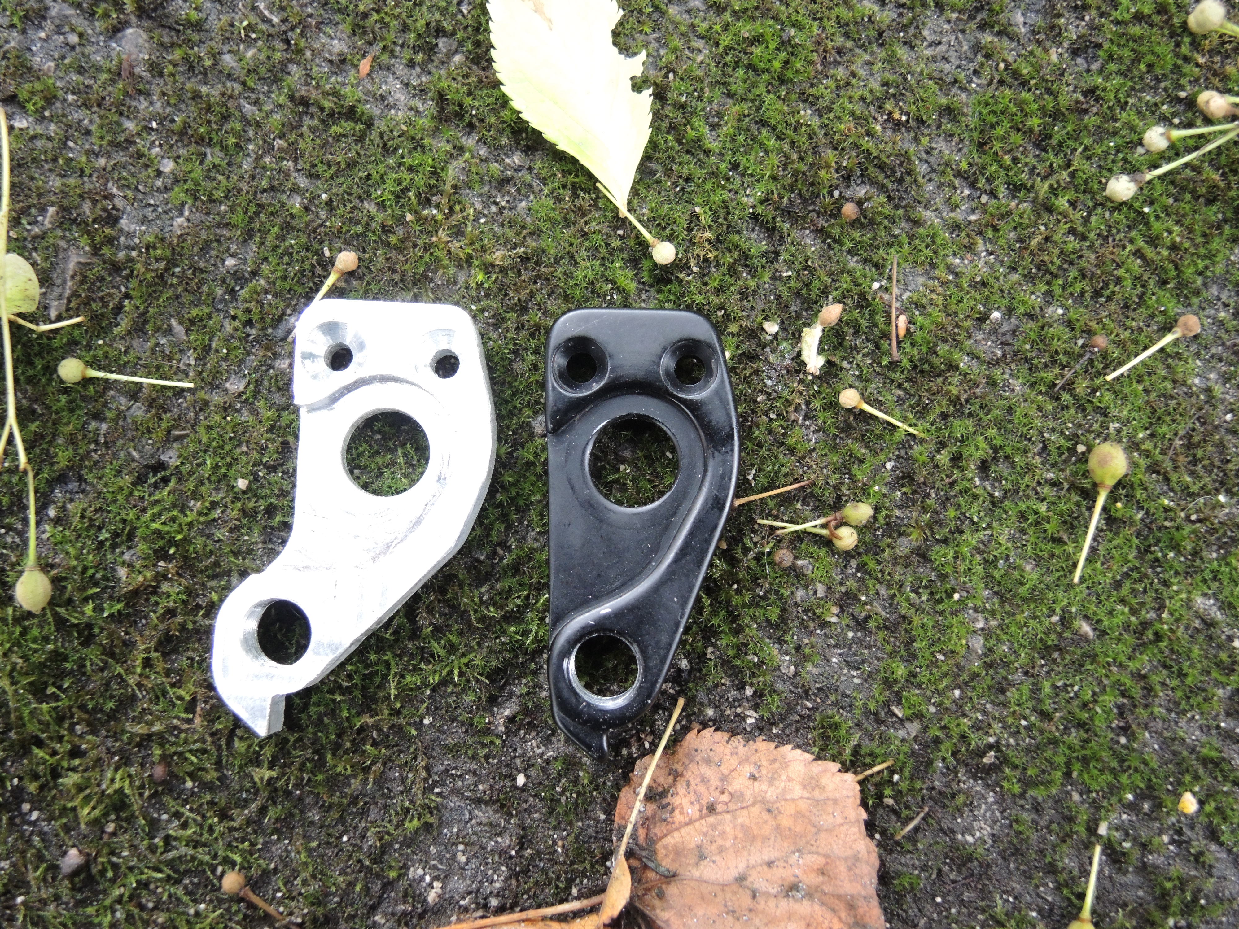

My conclusion is a "home grown" hanger, so that the derailleur is finally about the length of one chain link in driving direction positioned.
Discussion welcome.

Good idea Kanitfastan, thanks for posting!
I had no skipping issues with my bike (YT Decoy 29), 2000 km on chain and cassette, B tension set as per Microshift. Chain had no measurable wear when removed.
Today with a new chain, same brand but e specific, skipping. Had to adjust B tension to increase chain wrap to eliminate it. (Not sure how the new chain caused this. Fresh grease on rollers, very tiny difference in pitch?) No issues with reduced clearance between jockey wheel and large cog.
I was curious, so adjusted my daughter's bike (Orbea Rise), with the exact same drive train, to the same clearance. It was very unhappy going to large cog set up like this.
The difference must be down to the position of the derailleur hanger. The YT with a UDH has derailleur hole 26 mm below and 30 mm from axle centre. The Orbea, 31 mm below and 33 mm to centre. Chain lengths on both bikes are correct.
It certainly seems the B setting, and prevention of chain skipping, are dependent on hanger placement, as you have advised. May be why some specific models of bikes seem more prone to the issue. Going forward, when I am setting the B tension, I will only treat the measurement from the manufacturer as a starting point, especially with the highly loaded (overloaded) e bike drive trains.
