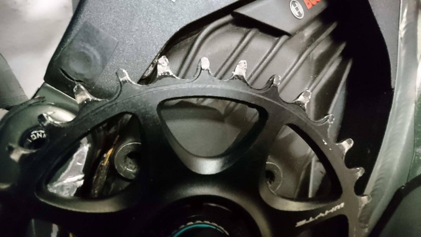

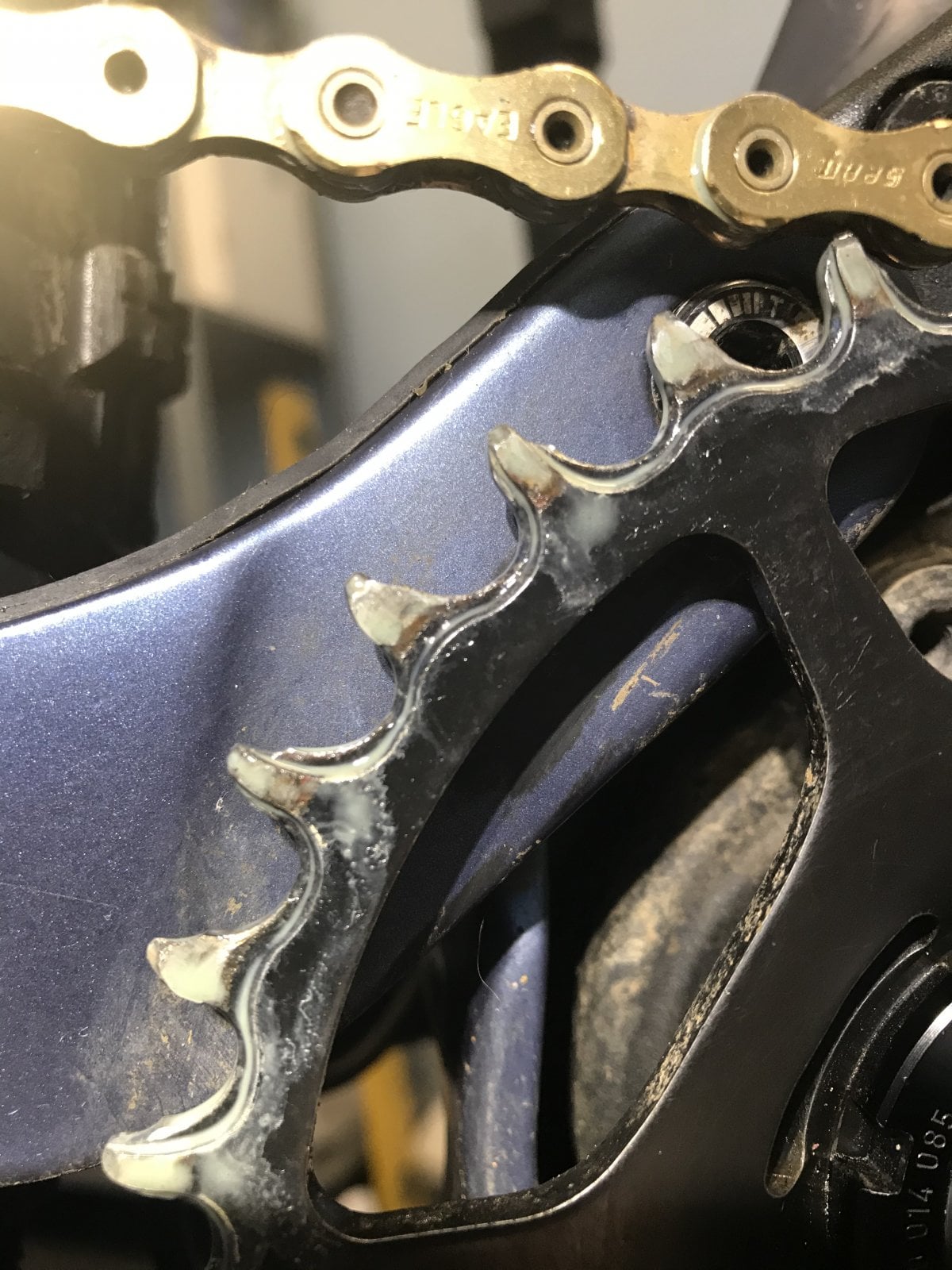

This thread could turn into "rate my ring".
I haven't seen a pic of this type anywhere yet.
After exactly 492km this chainring (with up to 85Nm of torque) wrapped the chain around the crank axle 1.25 times (the chain does go past the chainstay when the suspension is compressed).
The new chain it does seem be "hanging on" to the chain a bit.
With it being alloy is this the sort of lifespan you'd expect?
The chain is less than 0.5% on the chain checker (it's the best looked after chain I've ever had :cool:)
(It's "Whyte" branded and it has that special "E" as well)
I think I'm going to try to get a steel one...

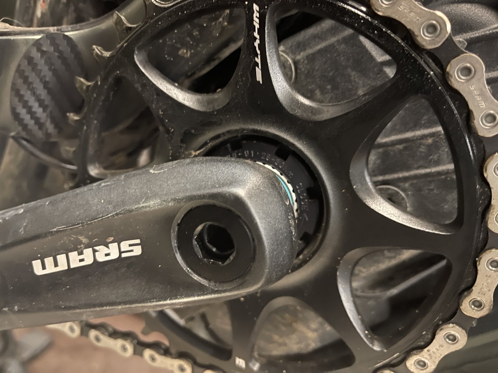

2021 E150RS - any ideas what this chain set is ? Different to the SRAM ones shown above - can’t find one like this online - Whyte spec sheet says Sync2, direct mount, 34T for Bosch Gen 4 ! Has Whyte emblem on it ?

Just noticed this pic after I’d posted mine !! Any joy with a replacement? Mines same as yours !! Can’t seem to find a replacement like for like
Mikerb
May 16, 2019
6,570
5,063
Weymouth
With " Whyte" etched on it the chainring is probably a batch specifically made for Whyte but I would have thought any 3mm offset chainring designed for Bosch Gen 4 would do........preferably steel for better wear.
( not sure on this point but I believe the Bosch Gen4 axle is ISIS standard size so as long as the chainring is ISIS I do not see anything else that makes a chainring specific to Bosh Gen 4 fitting?............happy to be corrected if that is wrong!)
If the chainring was supplied by SRAM the serial number should be etched on the back.
SRAM serial number for Bosch Specific SRAM XSYNC 2 is.............. CR-XSYNC-BOS-B1

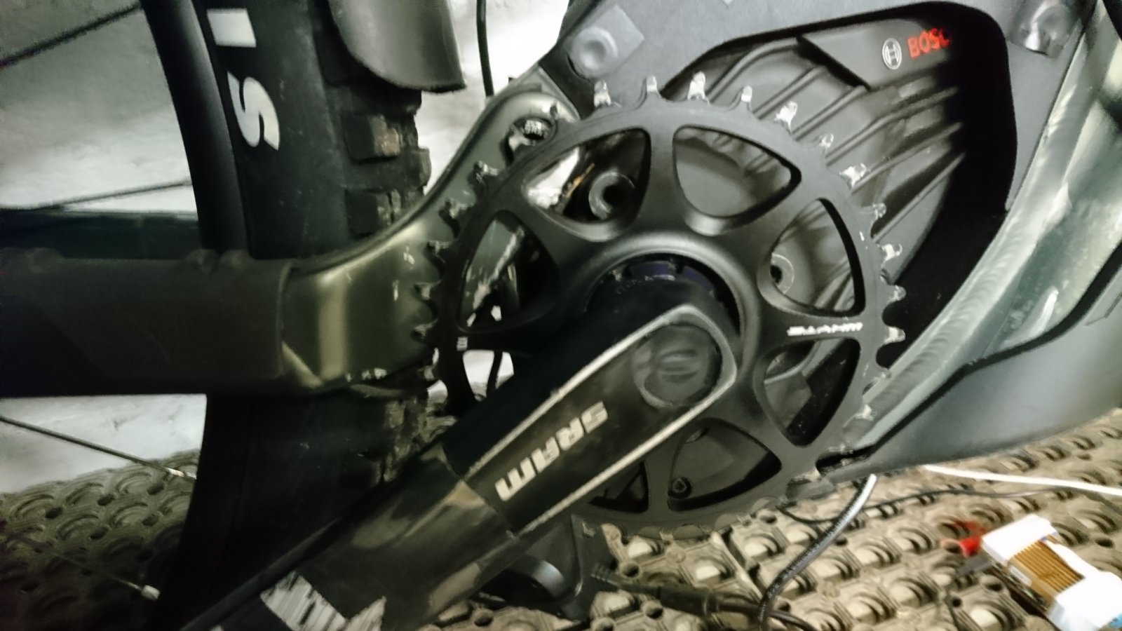

I scoured Europe and eventually found a 'standard' steel 34 tooth and put that on.
Didn't fancy replacing it every 4 months - my riding buddy has a Cube with standard ring and has over 1000kms with no problems - as far as I can tell (failing the magnet test) the Whyte marked one is alloy.
The chain line was pretty much the same - maybe 0.5 - 1mm different (but my measurements weren't super accurate either).
I've done about 250km on it since and no problems.
This was the one i got from Italy
Ended up buying a spare from France (xxcycles)
Also JINX on the photos!!!
