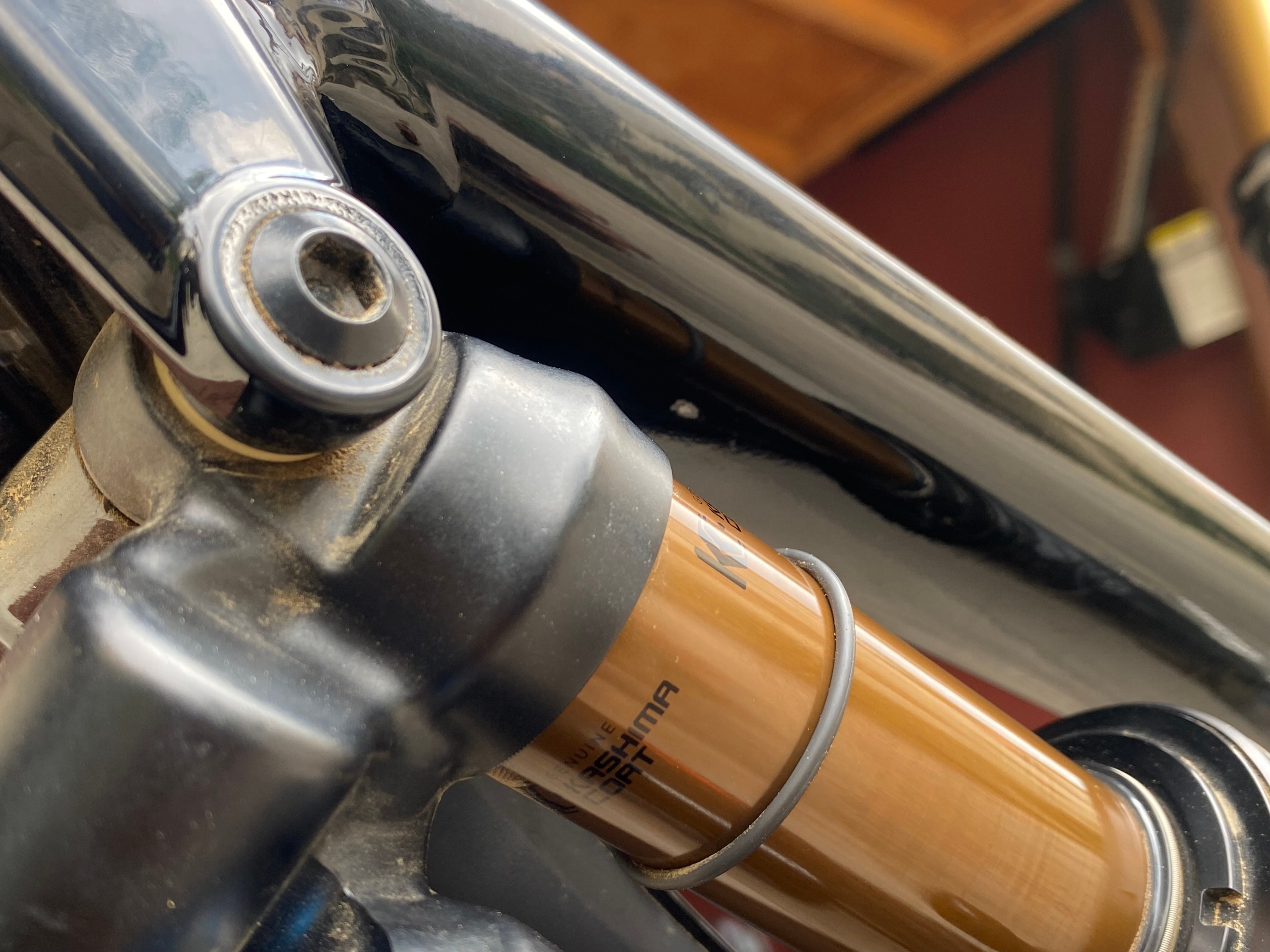

Read a separate thread about an S3 alloy with the alloy specific long shock kit having rubbing issues with an S3, but thanks for the input.
I’m experiencing rubbing issues on my 2023 S4 comp alloy Levo paired with the X2 and long shock linkage :/

I think he meant the molds from Specialized. There’s definitely something different going on with all the rubbing issues popping up lately. When I talked to the guys at Cascade they told me they think the front shock mount isn’t in the same spot on every frame, that’s why some shocks clear fine on one bike but rub on the next.
MTBJay661
Sep 20, 2023
16
7
Los Angeles, CA
Thats what I meant, although I did notice a lot of flexing coming from the linkage, even after it being torqued to spec.
As of now I’m still running the X2, I painted over the frame rub & now watching for new run to appear.
I tested it this morning at my local bike park and seemed to hold up without rubbing. Gotta take it down some chunk for the real test

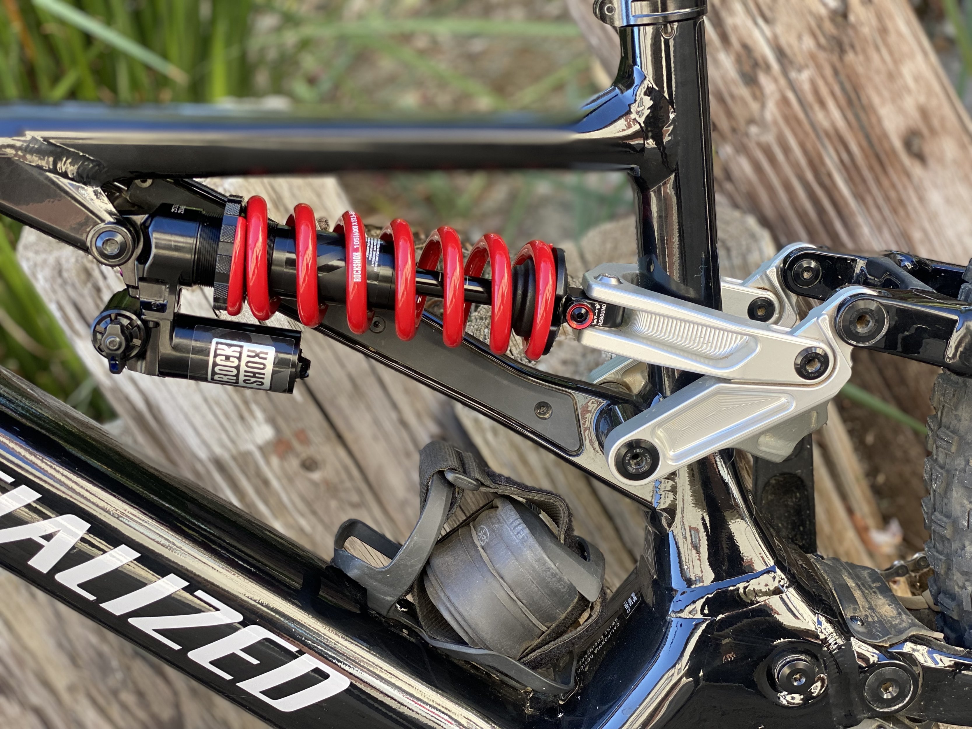

Quick update, just installed the RSD ultimate coil shock on my 2023 Specialized Levo with cascade components long shock linkage. Running a 600lb spring for now. Haven’t gotten to dial it in, only parking lot rides. No rubbing on the frame & no issues with the install.
Looks good, and thanks for the update. My ling shock kit and super deluxe coil are set to arrive Monday actually.
You mentioned you have the 600lb spring, so curious as to your weight and to know how that spring feels. If you’re not offended, lol.
I am about 140lbs and ordered the 400lb and 450lb spring as recommended by cascade.

Quick update. I bought a super deluxe ultimate coil to replace my X2 that was contacting the frame on my S3 carbon. The shock no longer contacts the frame and I have no issues with the fit. This is a great shock. I like it even more than the X2. Traction is much better and shock has good midstroke support and I was surprised it still has pretty good pop. I’m 180lbs full kit. 500lbs spring. The HBO on this shock absolutely works. I had it open and had a couple small bottom outs with a “Thunk”. Added 2 clicks of HBO and never experienced that sound or sensation again. It’s a super useful feature on a coil shock where exact spring rates for different individuals is hard to find.
LSC-
2 in from fully open
HSC-
2 clicks from closed
Rebound-
10 from closed
HBO( hydraulic bottom out)
Shaft sag 25%

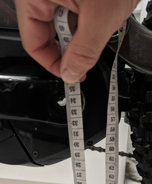

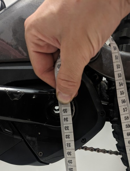

short link, short CS, 27.5x2.4, 170mm Zeb, -1* HS - BB height about 33.5cm
long link, short CS, 27x2.4, 170mm Zeb, -1* HS - BB height about 34.5cm

My mate just tried the RS Vivid on his S3, rubbed all the paint off one spot on the shock can and his frame. I guess that’s another shock that can be added to the list that won’t work on the smaller frames.

What is it when you measure at sag? I found them to be the same so while riding the bike its the same BB height but when I'm off the bike it is a tad higher.
i won't be changing links soon, but, you can easily calculate that, all info is available:
travel, suspension leverage ratios, chainstays, front centres :)

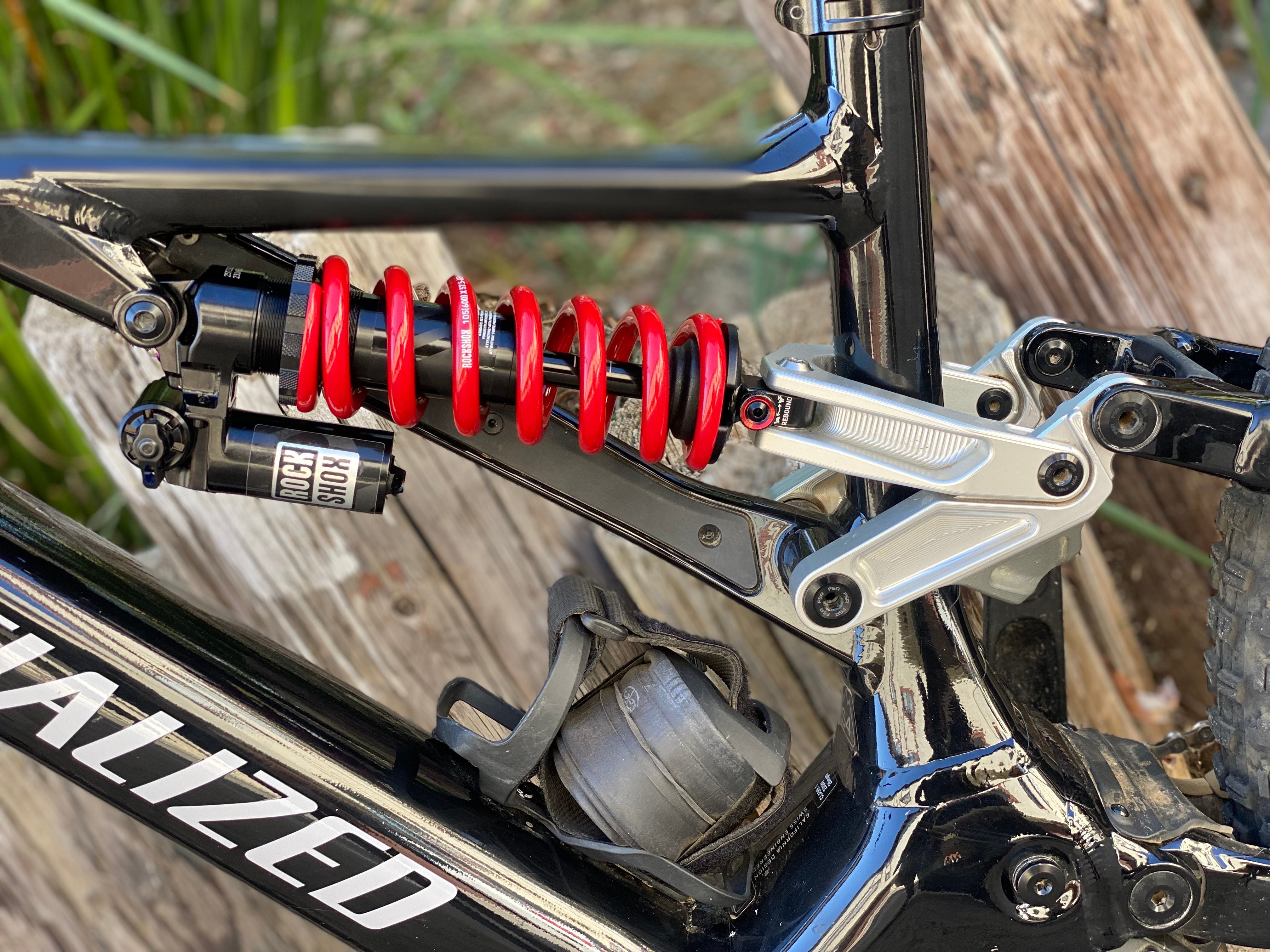

Just upgraded to the long shock kit and threw the super deluxe coil on it. Went with a 450 lbs spring and looks like I’m sitting at about 20% sag. Using most of my travel and can get it to bottom out if I really want to, but I know they recommend 30% sag.
I’m feeling good with 20% sag and definitely wouldn’t want to go lighter on the coil. Anyone else running less sag than suggested?
