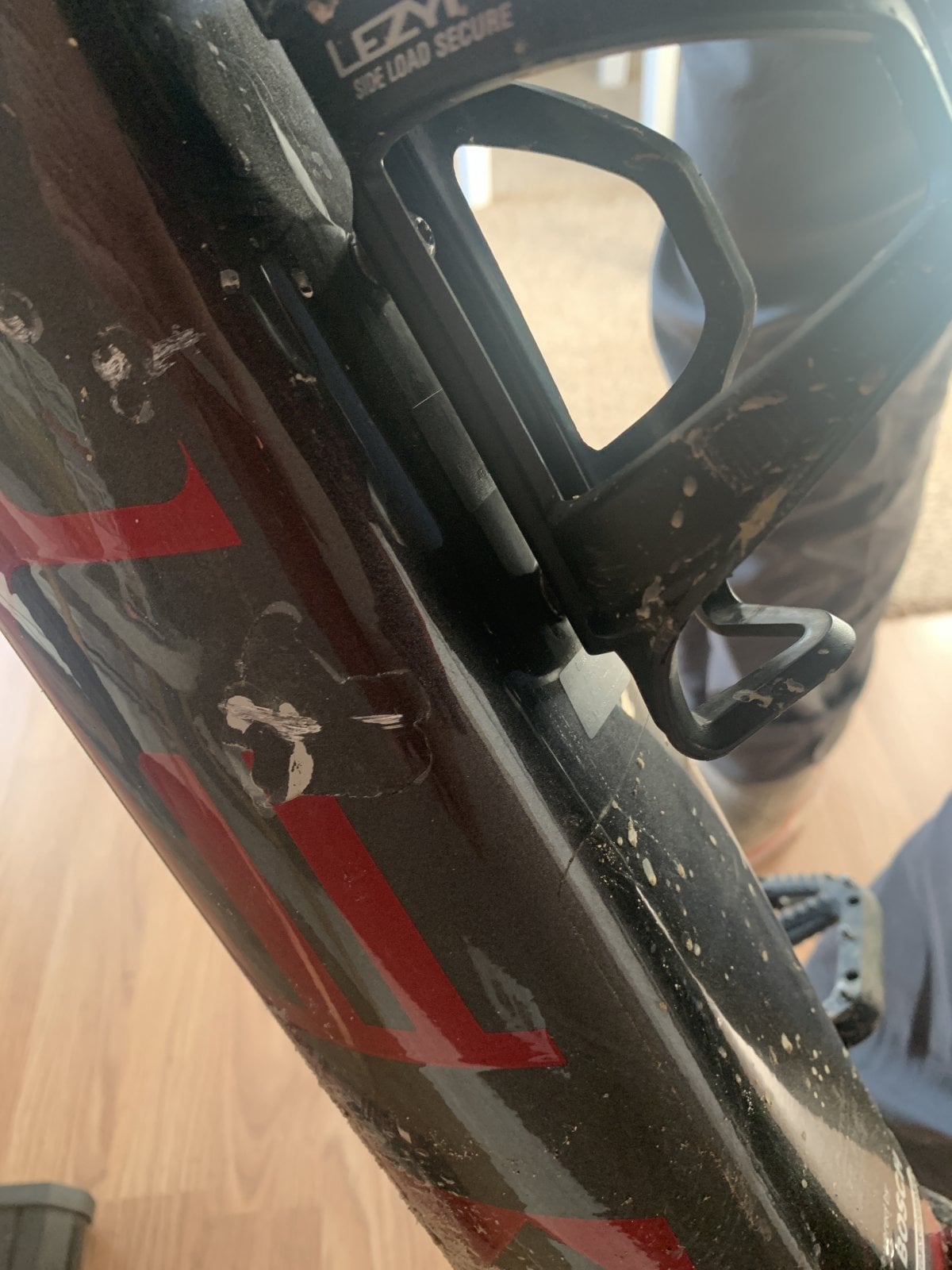

What do you think the outcome would have been if this were carbon ??

My frame had a dent big enough to hit the battery. Ball peen hammer pushed it right out. Not an option with carbon. But I was lucky to have access to the back side. Usually not the case. Would just have to live with a dent normally
