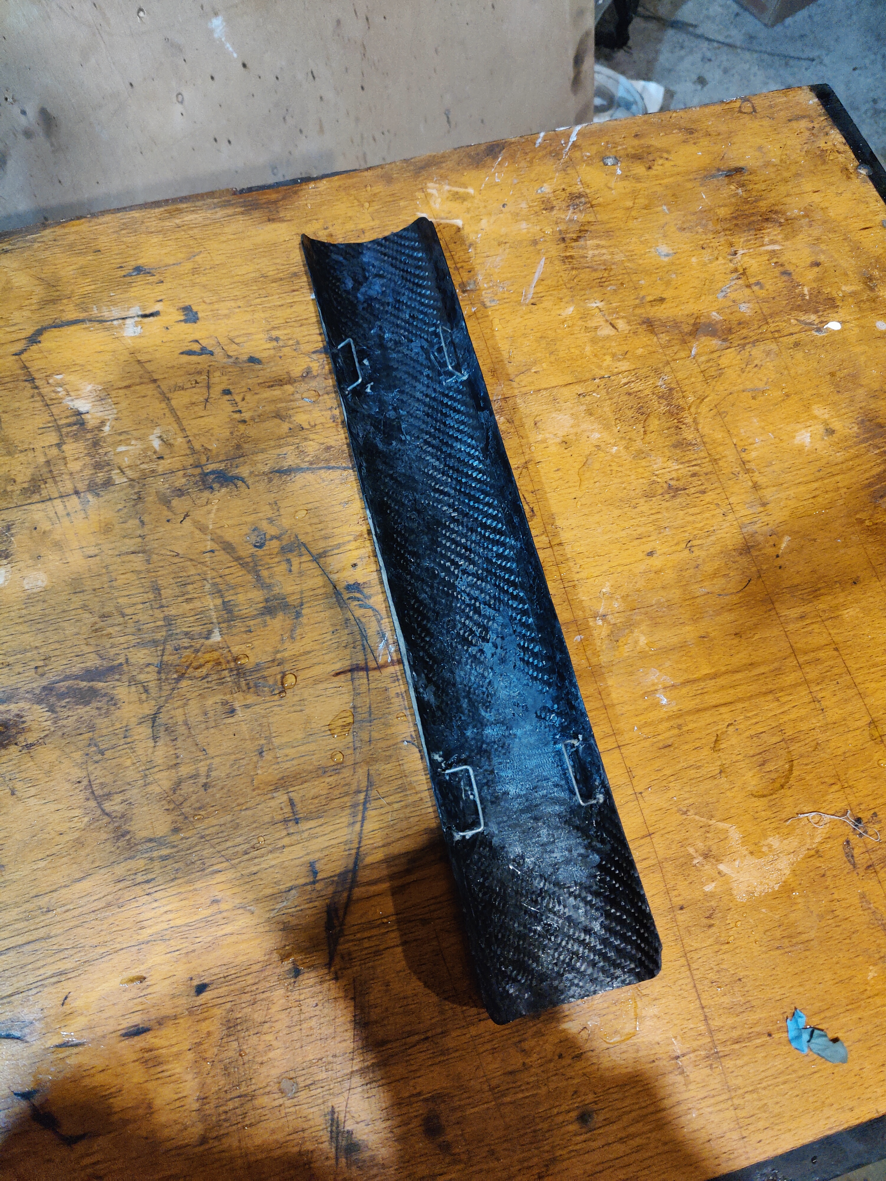

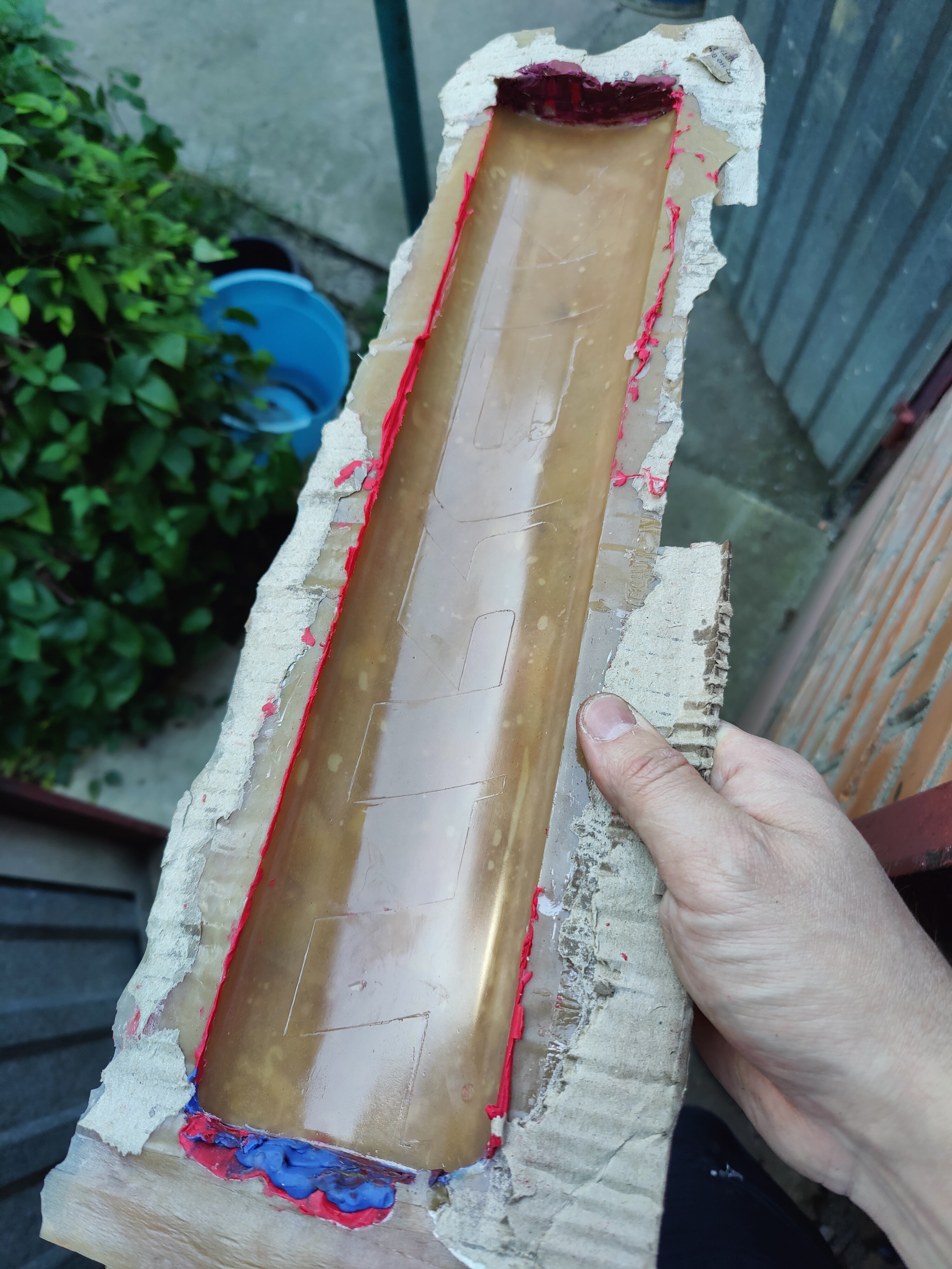

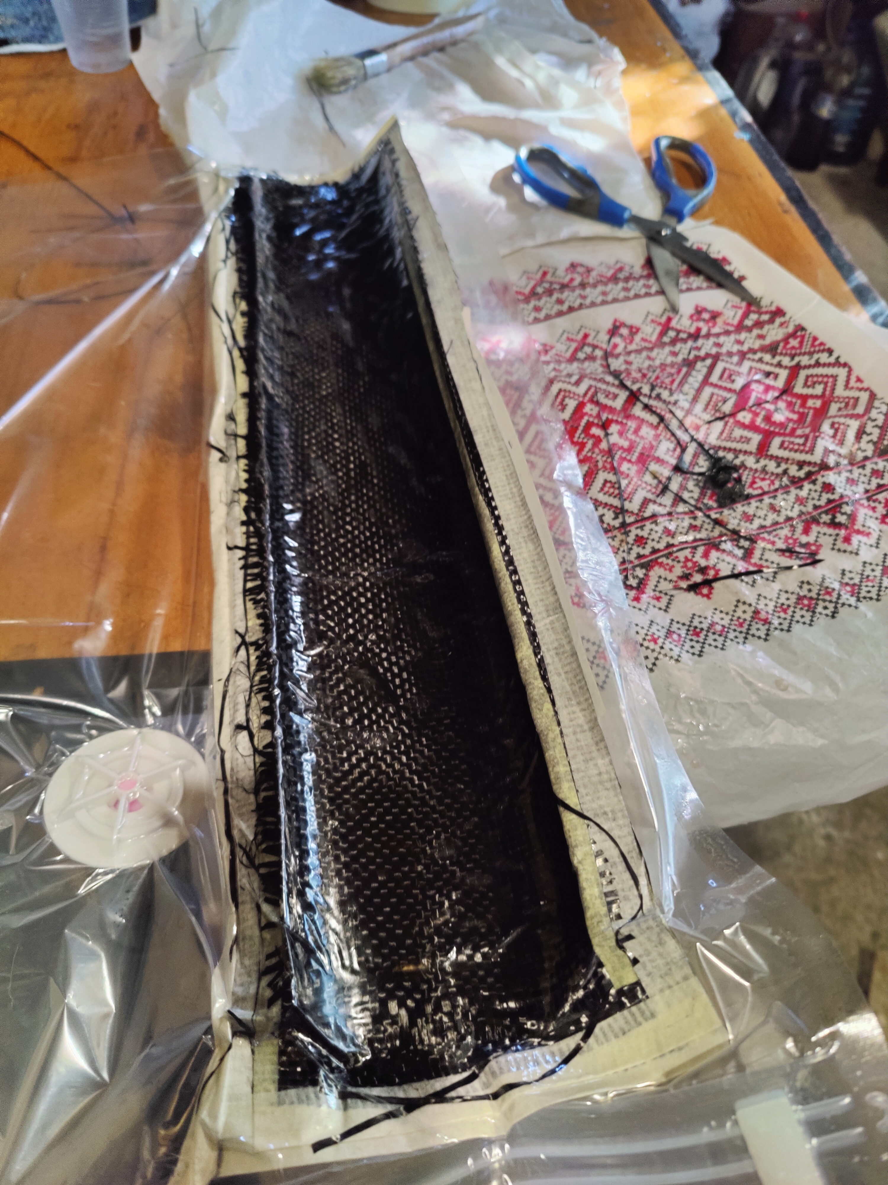

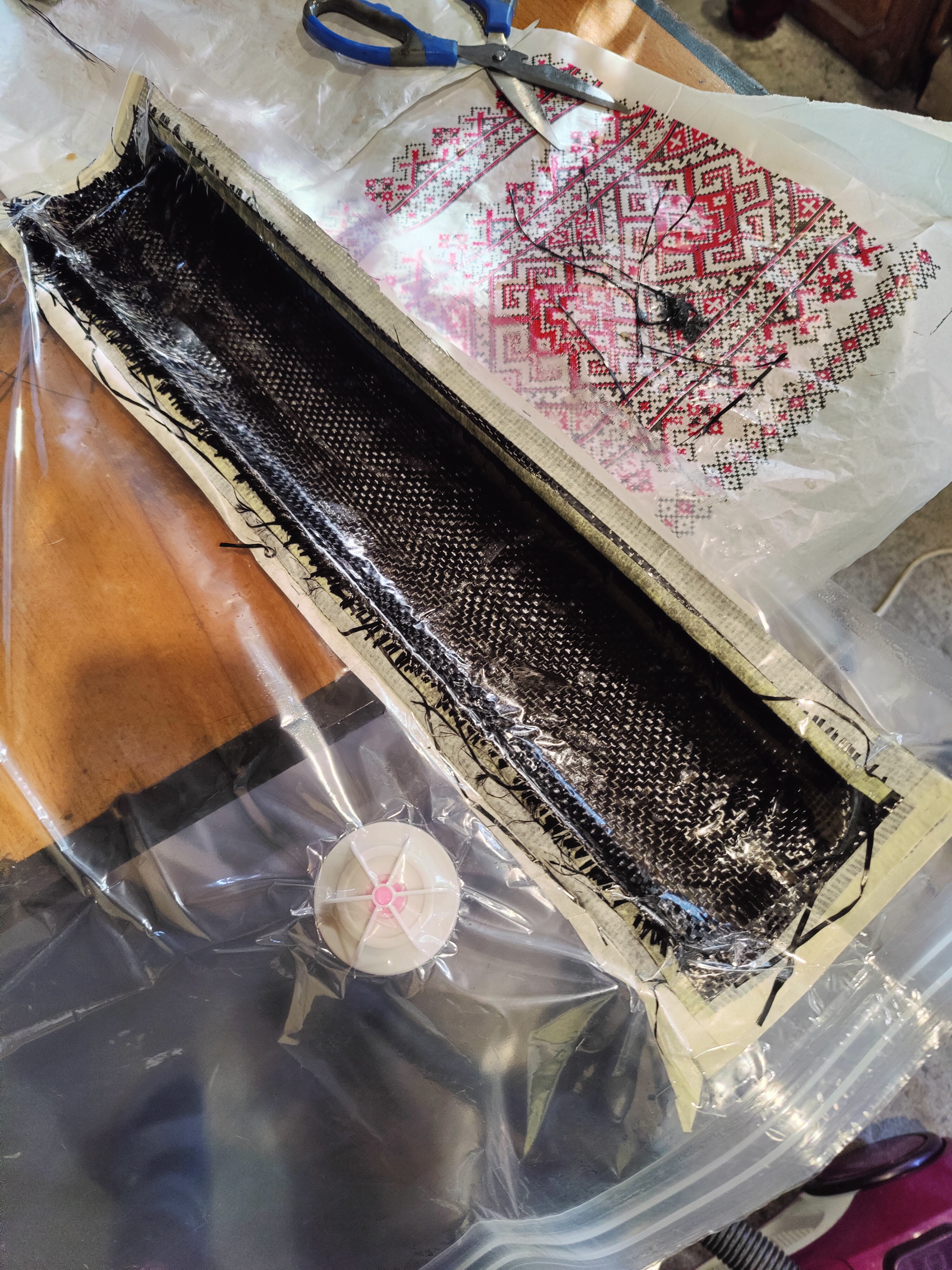

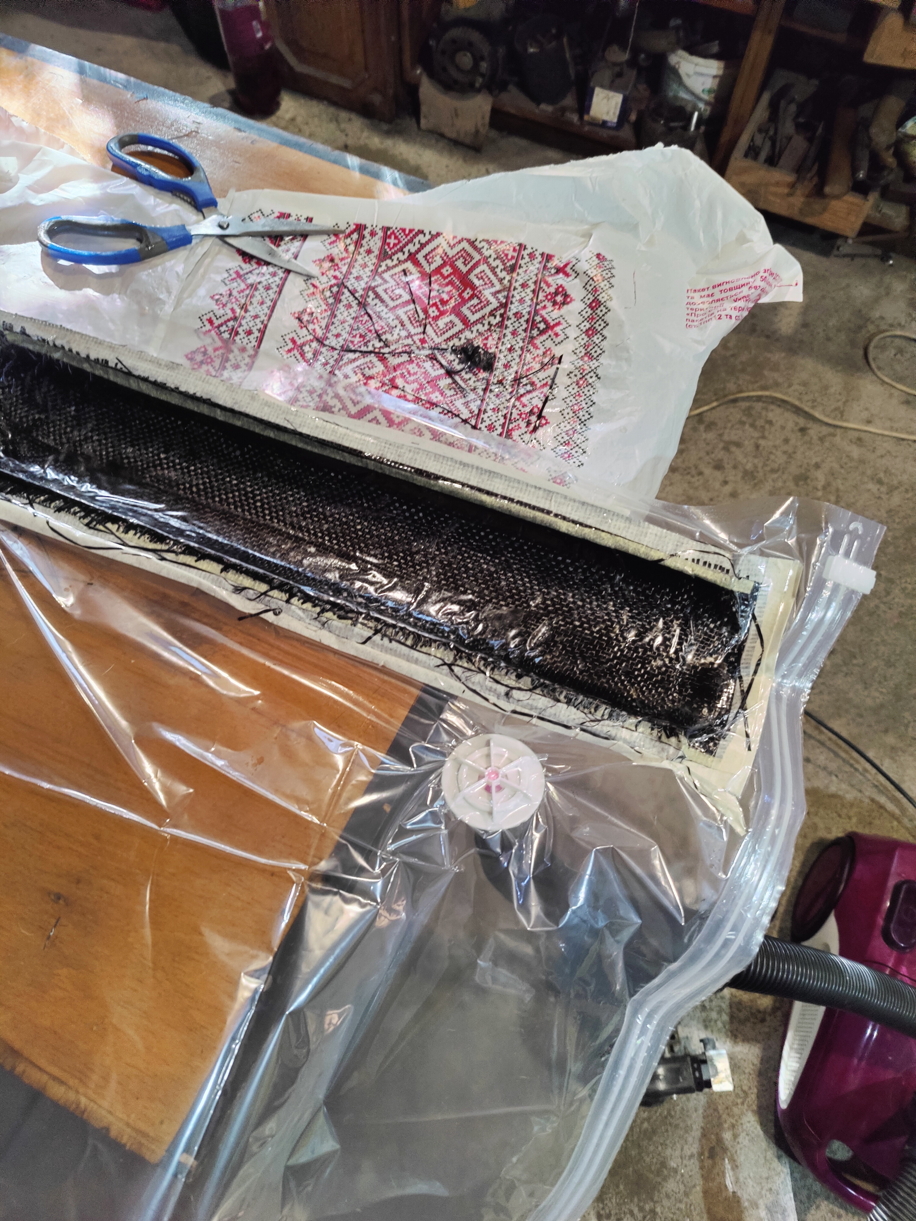

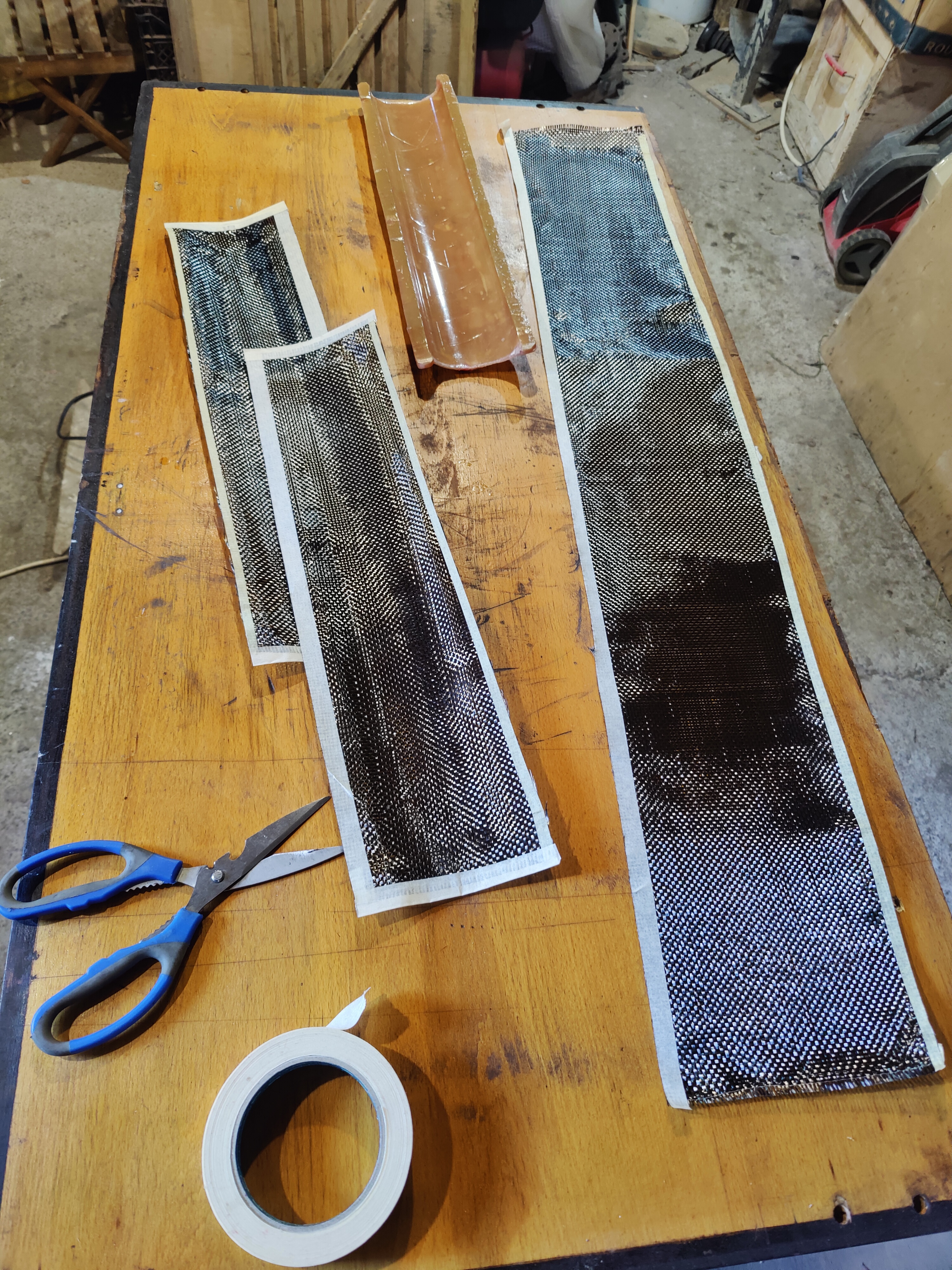

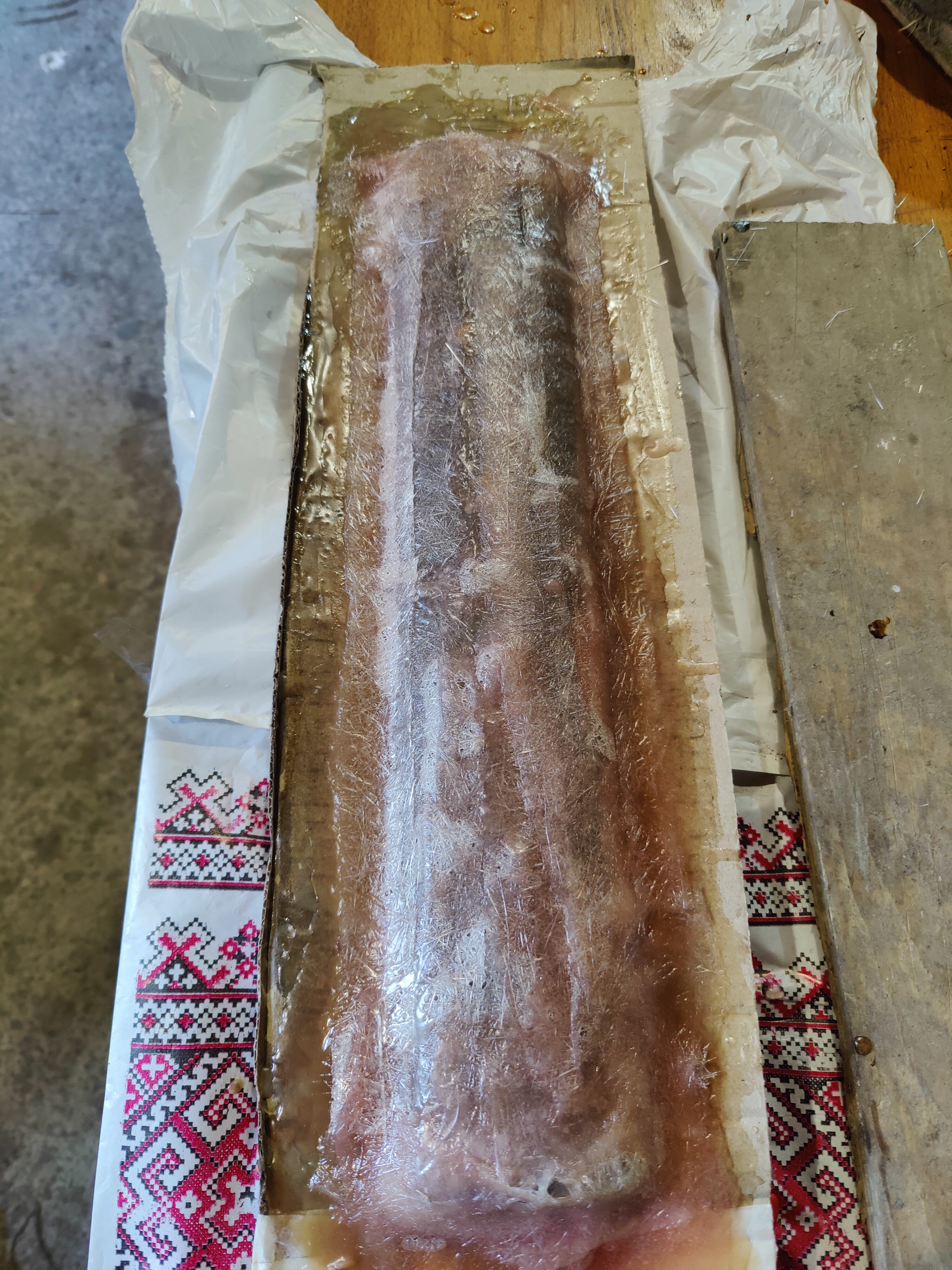

Hello everyone, I have trek rail 9.7 carbon.
I saw a video where a guy made a carbon cover for his rail. Has anyone done something like this?
I'm thinking of trying to make myself a similar thing out of carbon.
Has anyone tried it or know where to buy and at what price?

but the first steps have already been taken, I started trying to make a carbon cover

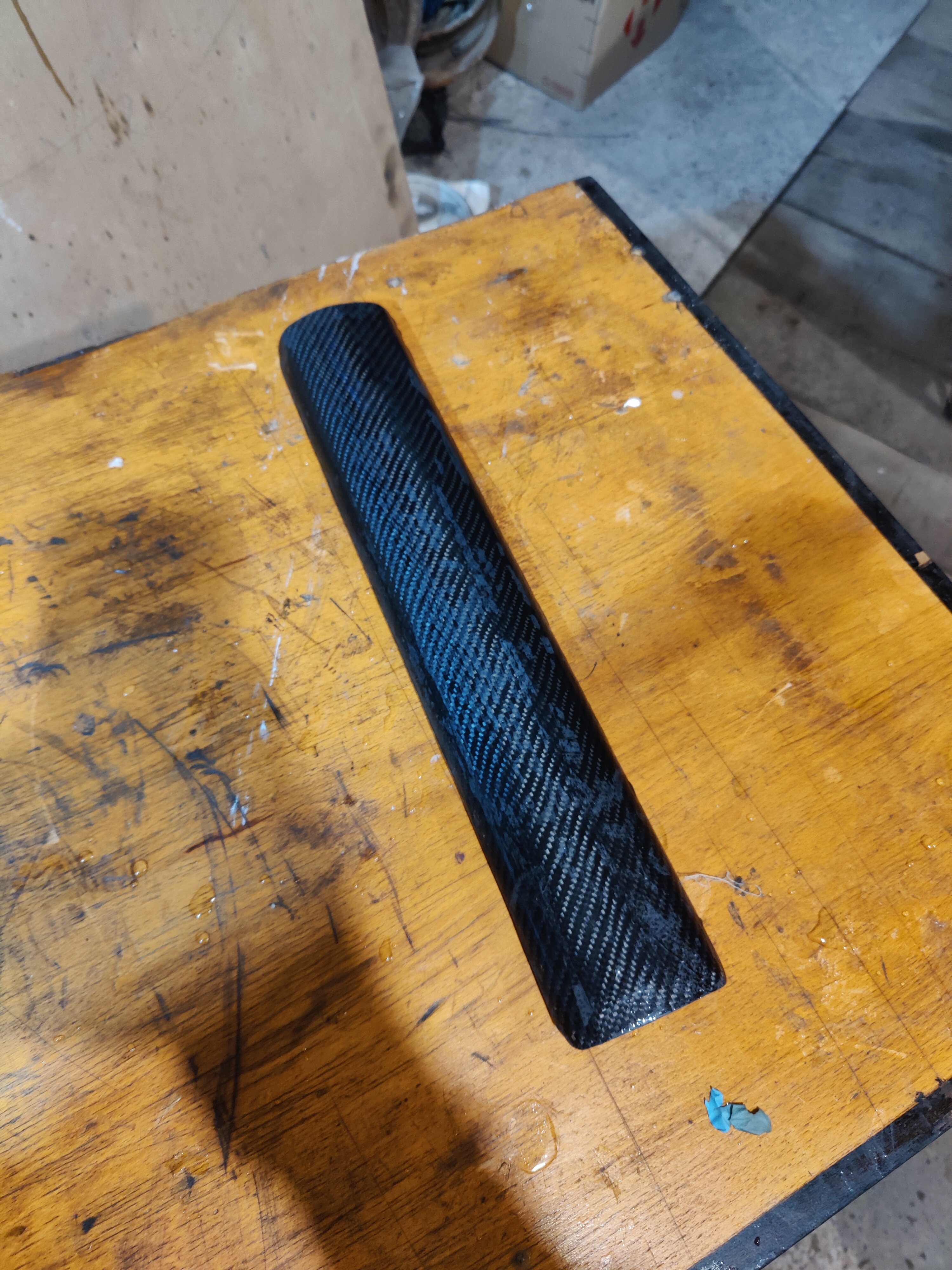

I finished making the carbon cover. its weight turned out to be slightly less than 100 grams.

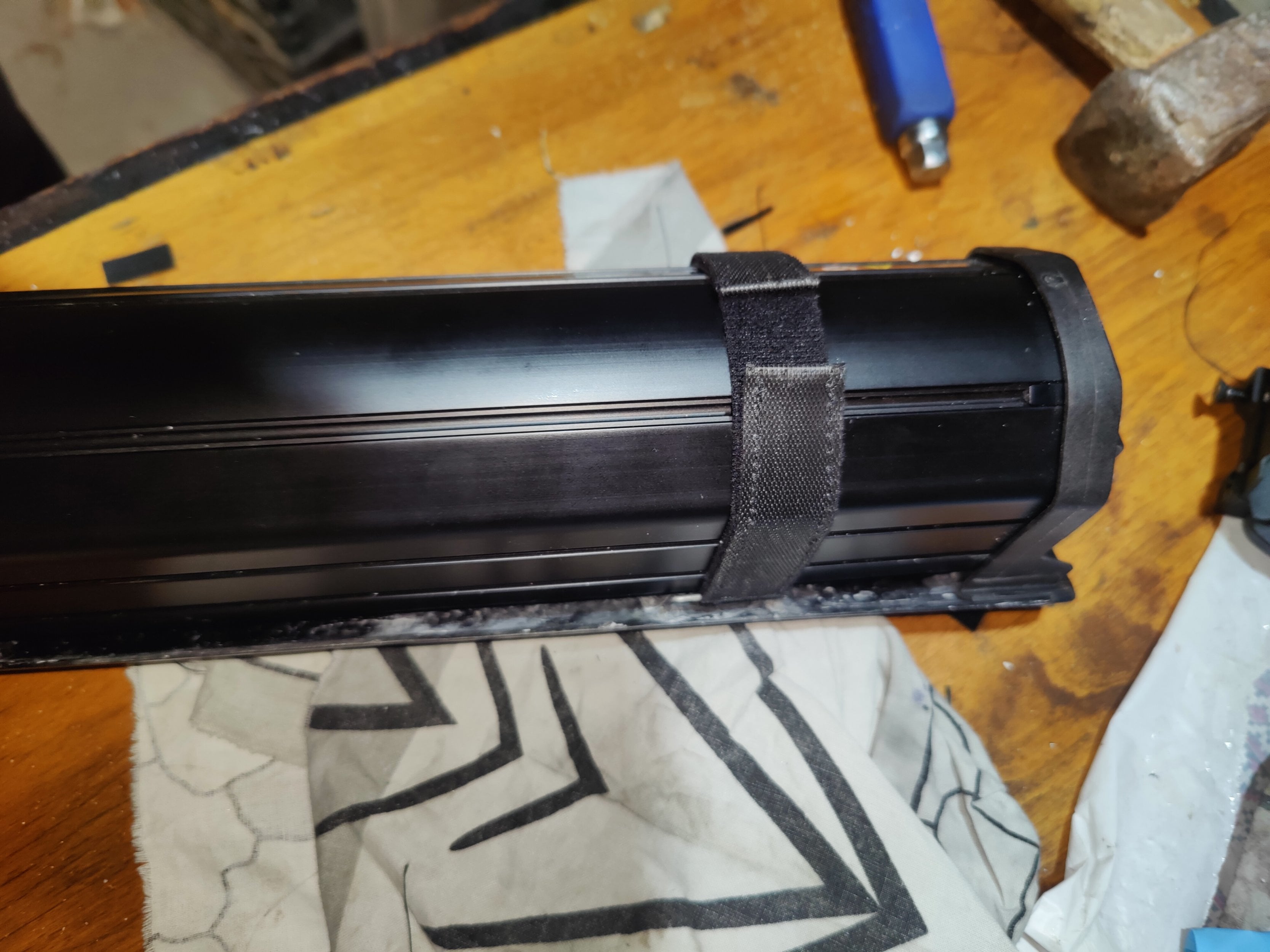

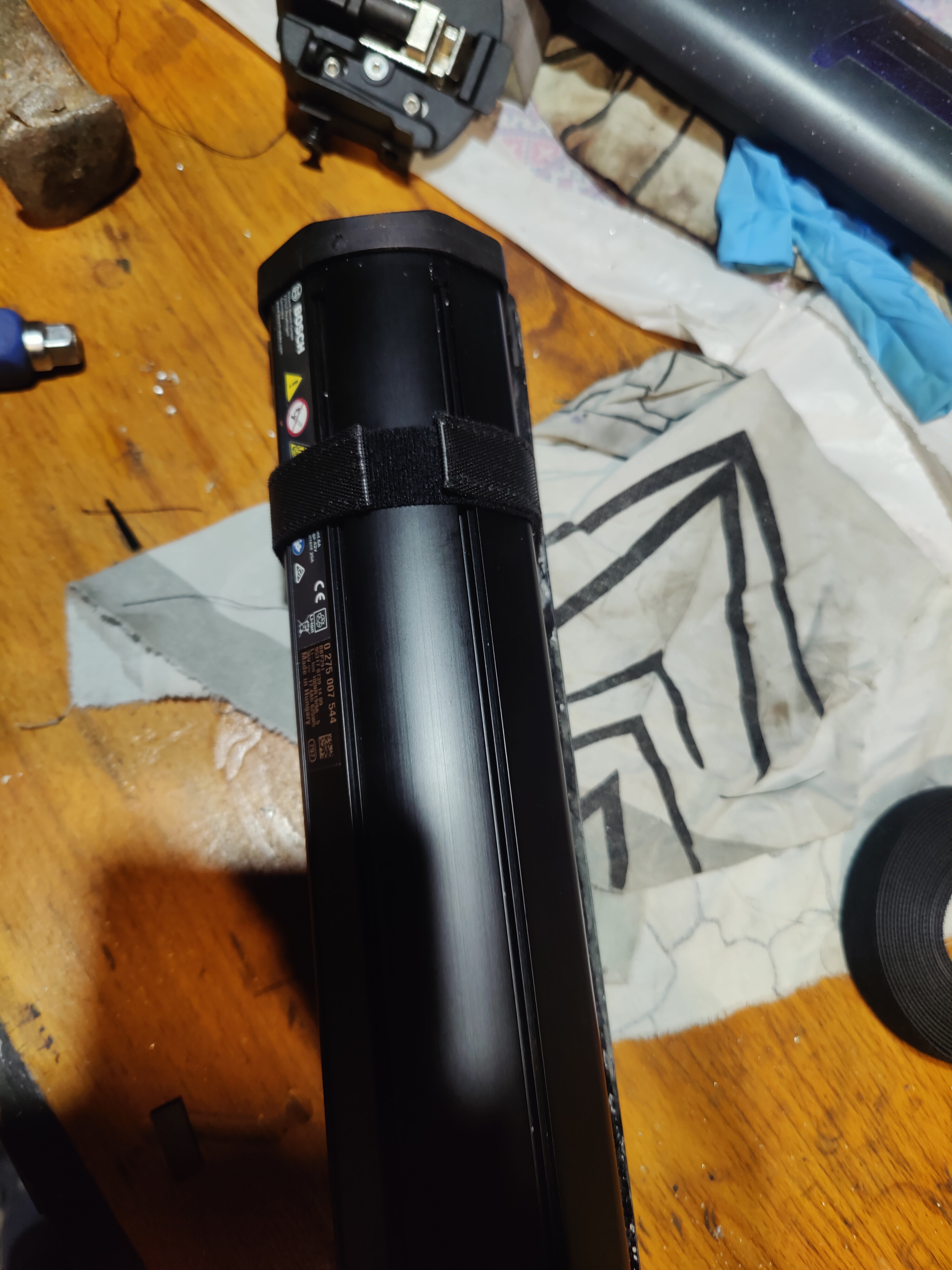

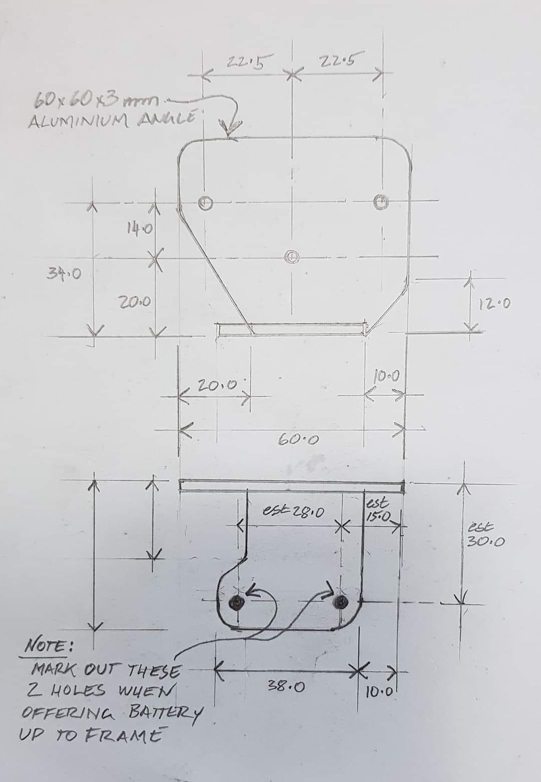

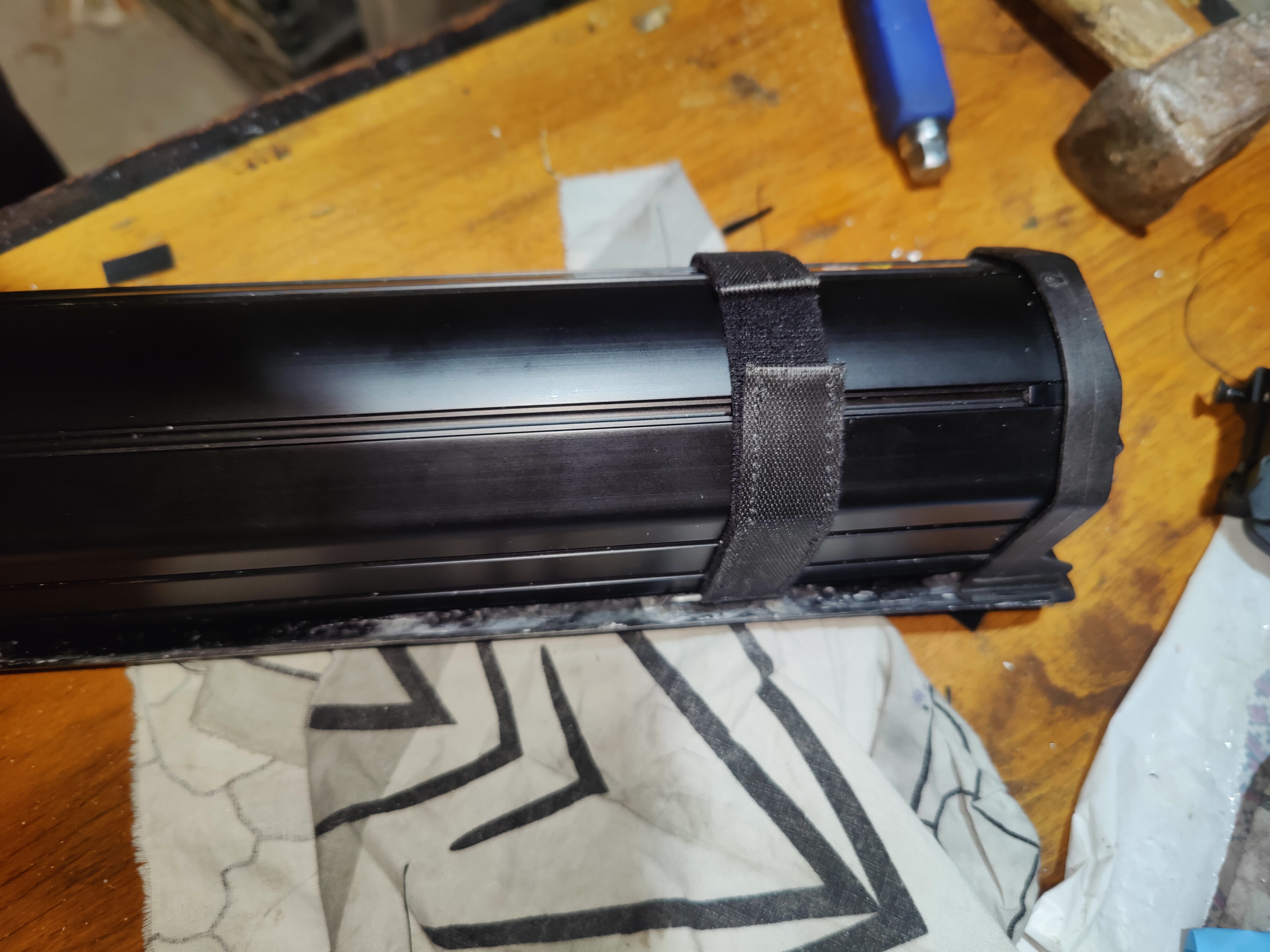

I also removed the lock with the battery mount and made the battery mount from an aluminum angle with 2 bolts, now I don’t need to carry keys with me to remove the battery.
I also plan to replace the keyhole hole with a power delivery type-c connector for powering flashlights and recharging gadgets.
I saved about 600 grams

The battery mount was made in the likeness of this drawing. Attention! Make the frame for the holes in the frame in place.
