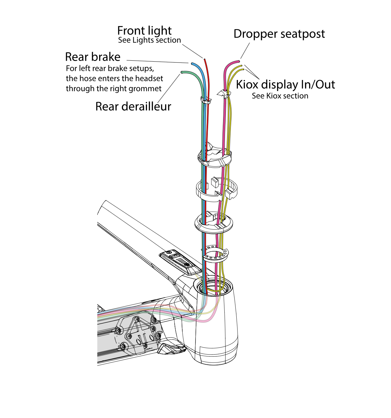

Its probably down to the cables for the Kiox having to go through the headset, assuming you want the display 'out front'.
The current cable attached to the System Controller mounted in the top tube is disconnected and will have to be re-routed through the headset and into one of the ports in the Kiox mount, a second short cable goes from the second port, through the headset and into the port on the System Controller.

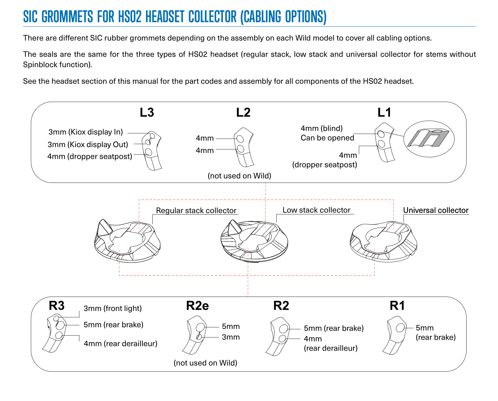

Depending on the seal/surround under the stem, there may not be room for the additional cables.
The factory fit option will have been specced with a seal/surround to take this into consideration.
Although it may be available as a spare to achieve this on a non factory spec conversion

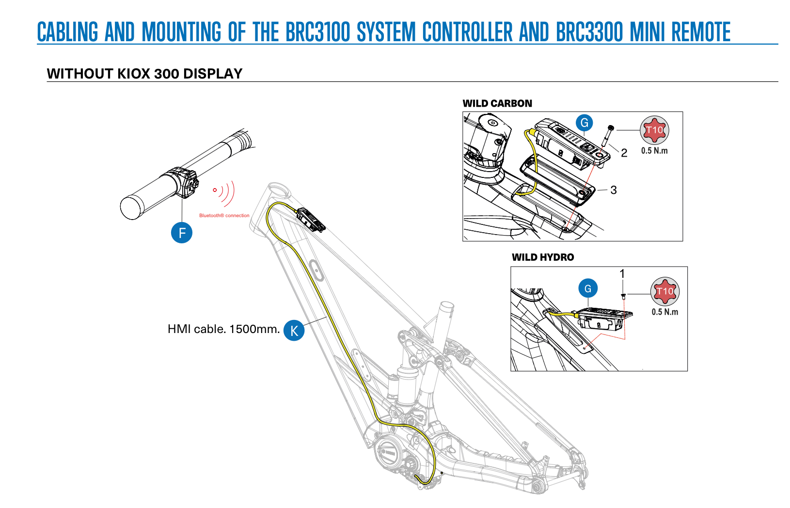

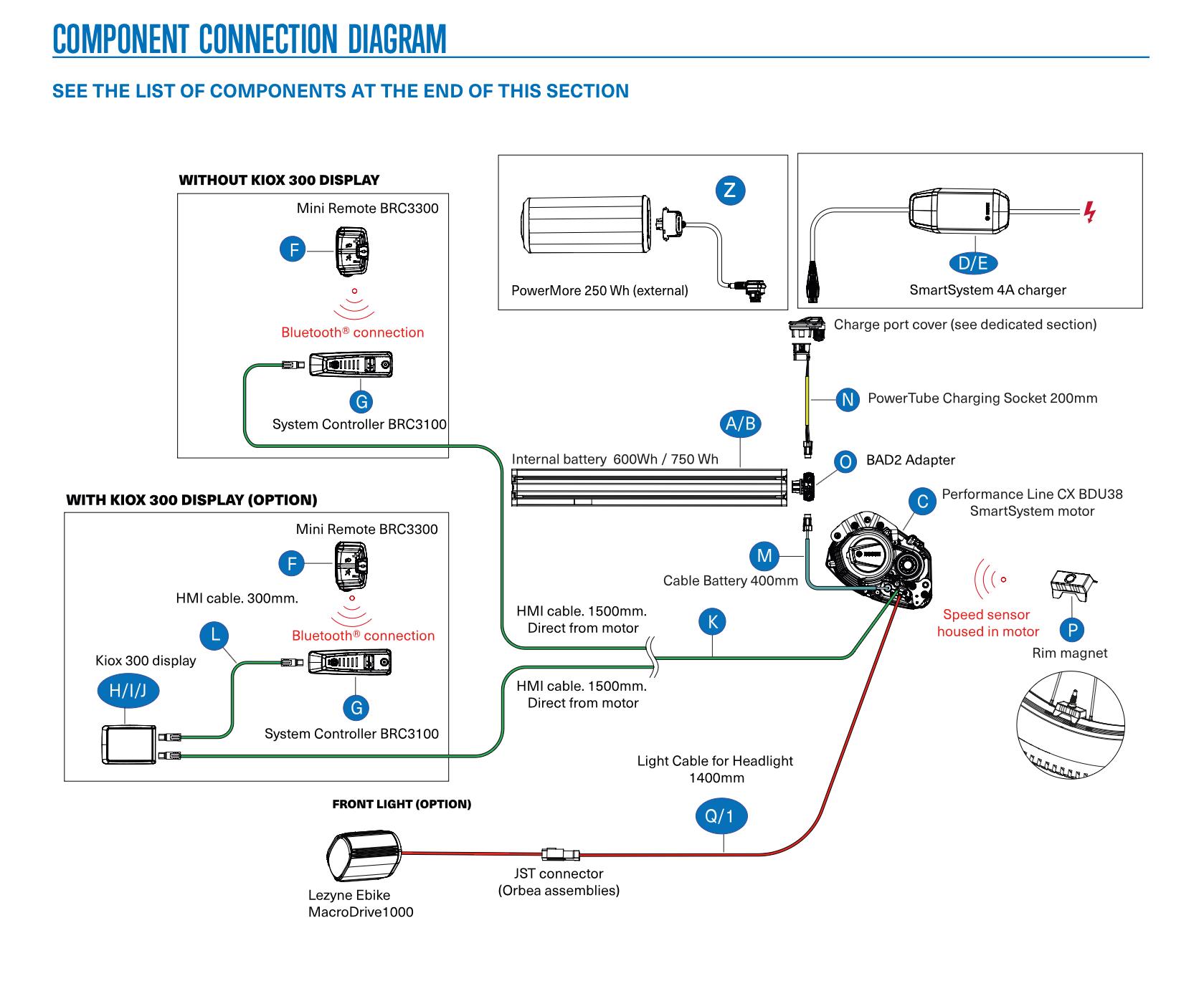

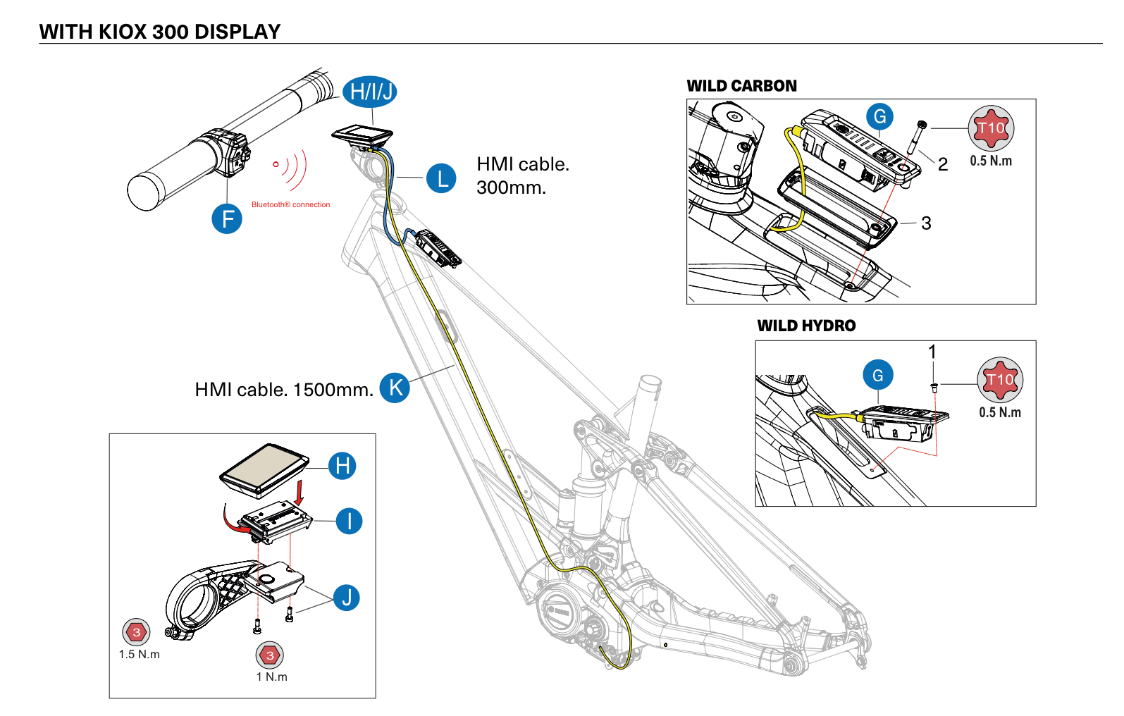

According to the newest Orbea Wild blue paper this is not correct.
As mentioned by @MrPeaski the main motor cable is routed from the motor to the system controller. Orbea uses for the Wild with or without the Kiox 300 option identical 1,500 mm long cables. This will be long enough to reach the Kiox through the headset. An aftermarket Kiox 300 or 500 upgrade kit includes the additional 300 mm cable needed to connect the Kiox display to the system controller. You will have to route both cables through the headset. The one used by Orbea has enough space for additional cables.
See the relevant diagrams from the blue paper below. You can find the full version here: Dash

I bought the kiox and installed it myself the kit - is easy - whats a pain is that headset. I ended up pinching the wire a little and so got the shop to redo the headset and cabling when it was in for something else.
