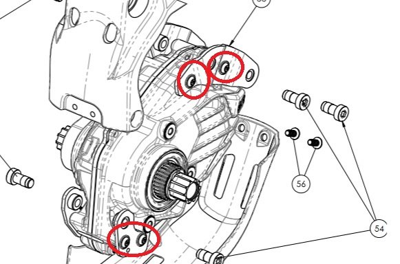

Ok, I understand better now, thanks. I also found some information about this issue. See drawing below showing the bolts in question I think. According to bosch, these should be tightened at 13-15Nm by the bike manufacturer. I'll keep an eye on them 👀

That's a good point. I have not had to get one yet as Bosch covered the first one under warranty and I am still waiting an answer on this the second motor however the key I think is to periodically check that bolts don't loosen which I am afraid probably means dropping the motor more than you would prefer and then you need a 25 mm security torx at 15 NM of torque in order to check it. It's a bit of a faff and it doesn't sound like many bikes suffer from this but am tending to think it depends quite a bit on how the bikes are being ridden and I don't think it's a consequence of pedal strikes

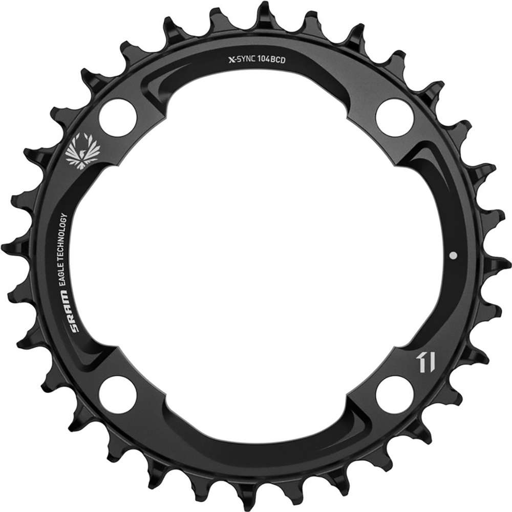

Has anyone managed to fit a 36 teeth chain ring ? Does it make much difference ?

On my moterra neo 2 (2021), 10-52 cassette, I also decided to change my chainring from the original 34T to 36T. I fitted a 36T Sram x-sync 2 aluminum chainring.
The reason for this change was not to gain top speed, but to optimize my cassette usage and maintain straighter chain line.
With my riding and a 36T chainring, I'm now mostly using the cogs in the middle of the cassette. A more balanced use of the drivetrain. And no impact whatsoever on my climbing ability (52T was overkill for eMTBs anyway and rarely used).
Since the chainring is spider mounted (104 bcd) the install was fairly quick. I just took down the pedals.
With 36T, my chainstay / chainring clearance is 2-3 mm. A 38T chainring would not fit though and touch the chainstay.
Also going with 36T (from 34T) didn't require a chain extension. I could keep the current chain length.
From a riding experience, my top speed on 10x36 was not much increased. But I now use my cassette more efficiently.
In retrospective, going to 36T was a good upgrade for me.

I stand corrected I really thought the 36 would rub on chainstay. In your case the 36 makes perfect sense. For my riding a 34 coupled with an 11 50 cassette works pretty well.

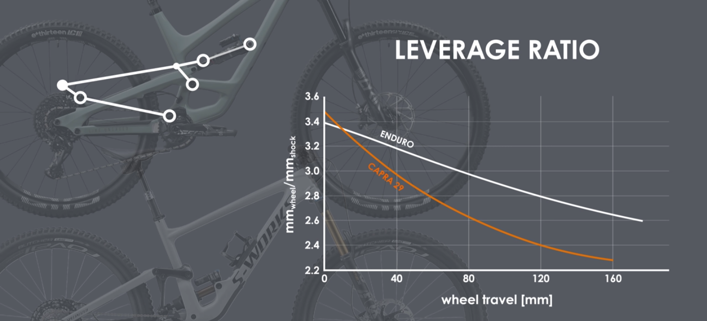

From a design standpoint, I've been wondering how progressive (or linear) is the Moterra 1/2/3 (2019-2021) rear suspension geometry. And if in theory, a coil-sprung shock with linear compression would be better suited than an air shock (progressive by nature)?
Not finding much information about this, I came across the YT Capra rear geometry which looks similar to the Moterra's. See leverage ratio (orange plot) below from POV Trail.
The chart shows a leverage ratio that is very progressive by design, so it would be much better suited for running a linear coil shock than an air shock. What are your thoughts about this?
I also fitted the 36T X-Sync 2 and it works great. Was worried about the clearance but it works. Did not change spider or else. Chain length is also the same while I upgraded to the 10-52 GX.
