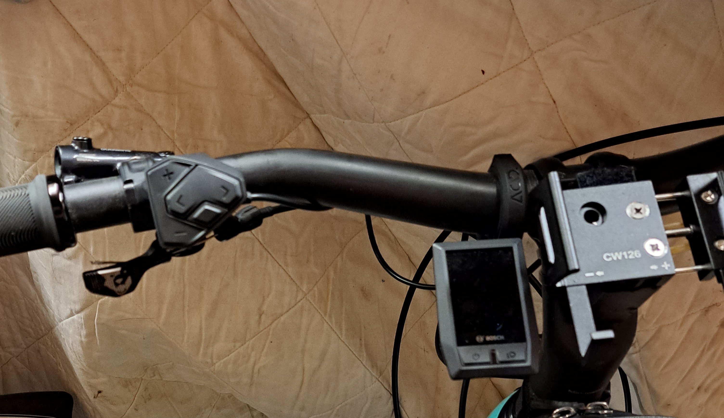

I gave up on the same idea. Instead upgraded from the Bosch Purion to Bosch Kiox Retrofit and also bought a Cube Acid Bosch Kiox Bracket to mount the Kiox display behind the bars and lower down. I also have a central phone mount (Amazon: Arkham phone holder) butchered to fit onto the stem because we use (UK) OS 1:25,000 maps when we ride in new (to us) terrain.
