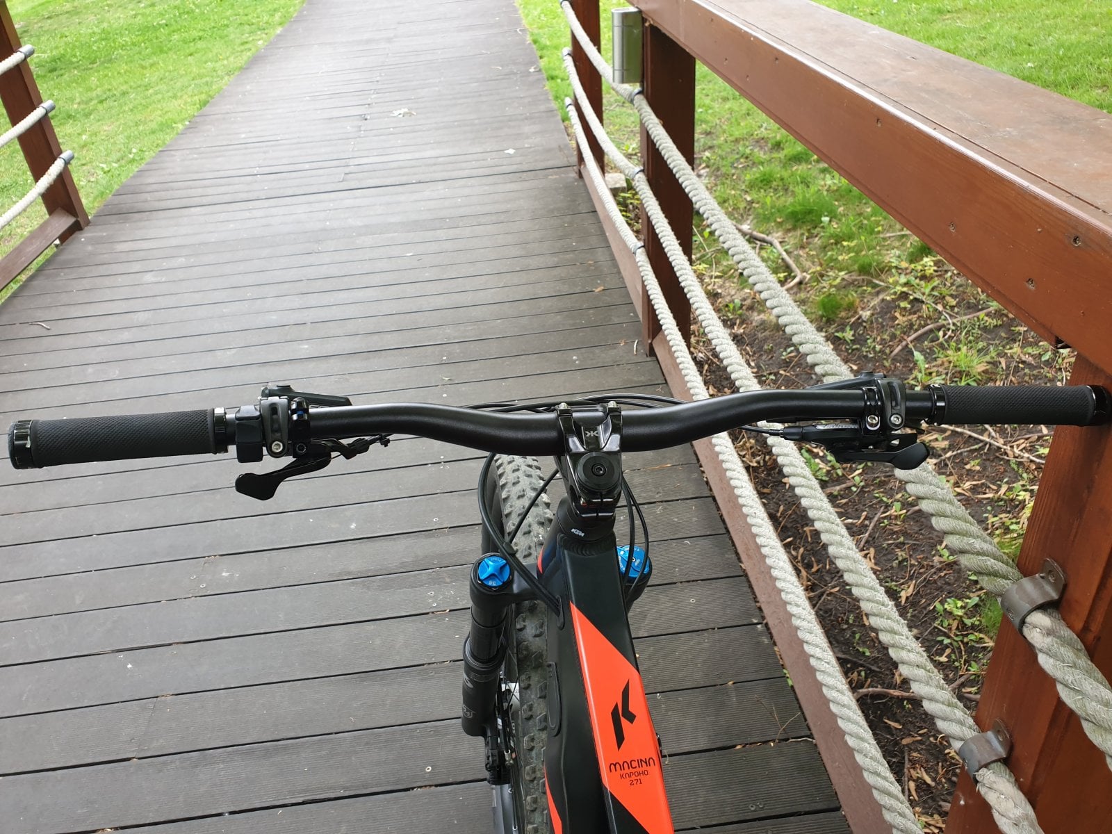

I dissasembled a cheap used (around 50euro) purion,soldered wires directly to the switches on the pcb,and used a shimano E7000 switch for mode selecting,and installed a small switch under the toptube, to power the bike on. I placed the purion inside the frame.
I have a bluetooth capable "tuning" module installed so i can check the necessary data on my phone,like battery percentage,etc..
Its been several months i did that,never had any problem with it. Its not for everyone,but if you are capable,it can be done fairly easy. I kept my kiox also,so if i ever need to go to get diagnostic,i can use that.

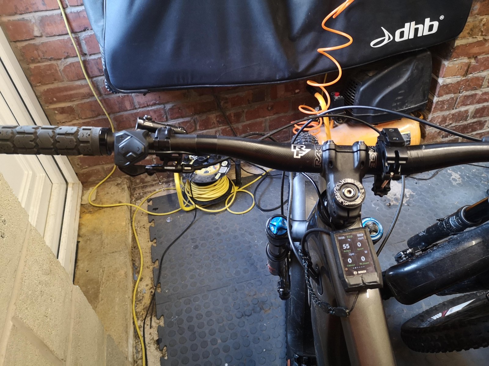

I ended up getting a top tube mount for the kiox, and getting the kiox controller with the longer cable - its a pretty effective solution.

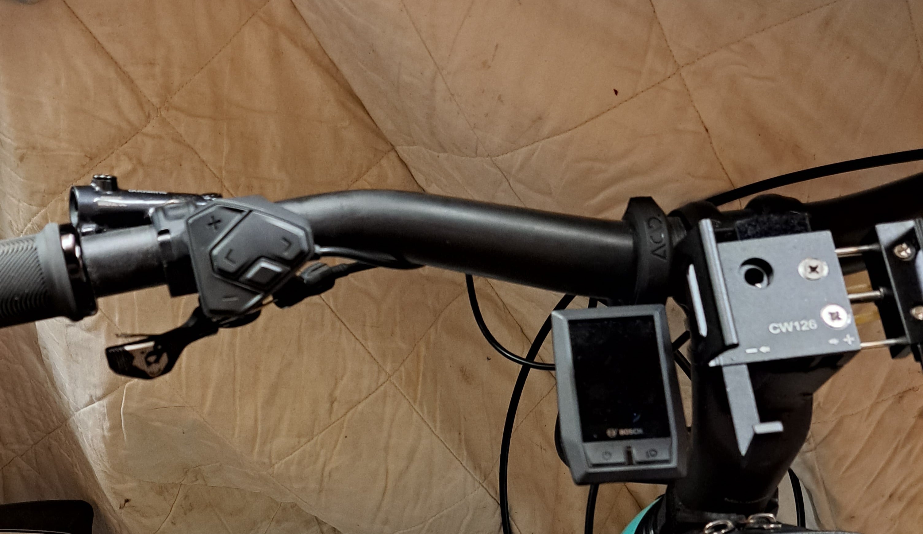

I gave up on the same idea. Instead upgraded from the Bosch Purion to Bosch Kiox Retrofit and also bought a Cube Acid Bosch Kiox Bracket to mount the Kiox display behind the bars and lower down. I also have a central phone mount (Amazon: Arkham phone holder) butchered to fit onto the stem because we use (UK) OS 1:25,000 maps when we ride in new (to us) terrain.
Is there a part number for the Kiox controller with the longer cable? I’m going to grab a Trek top tube mount for mine when my retrofit kit arrives but from what I understand the controller cable is not long enough.
