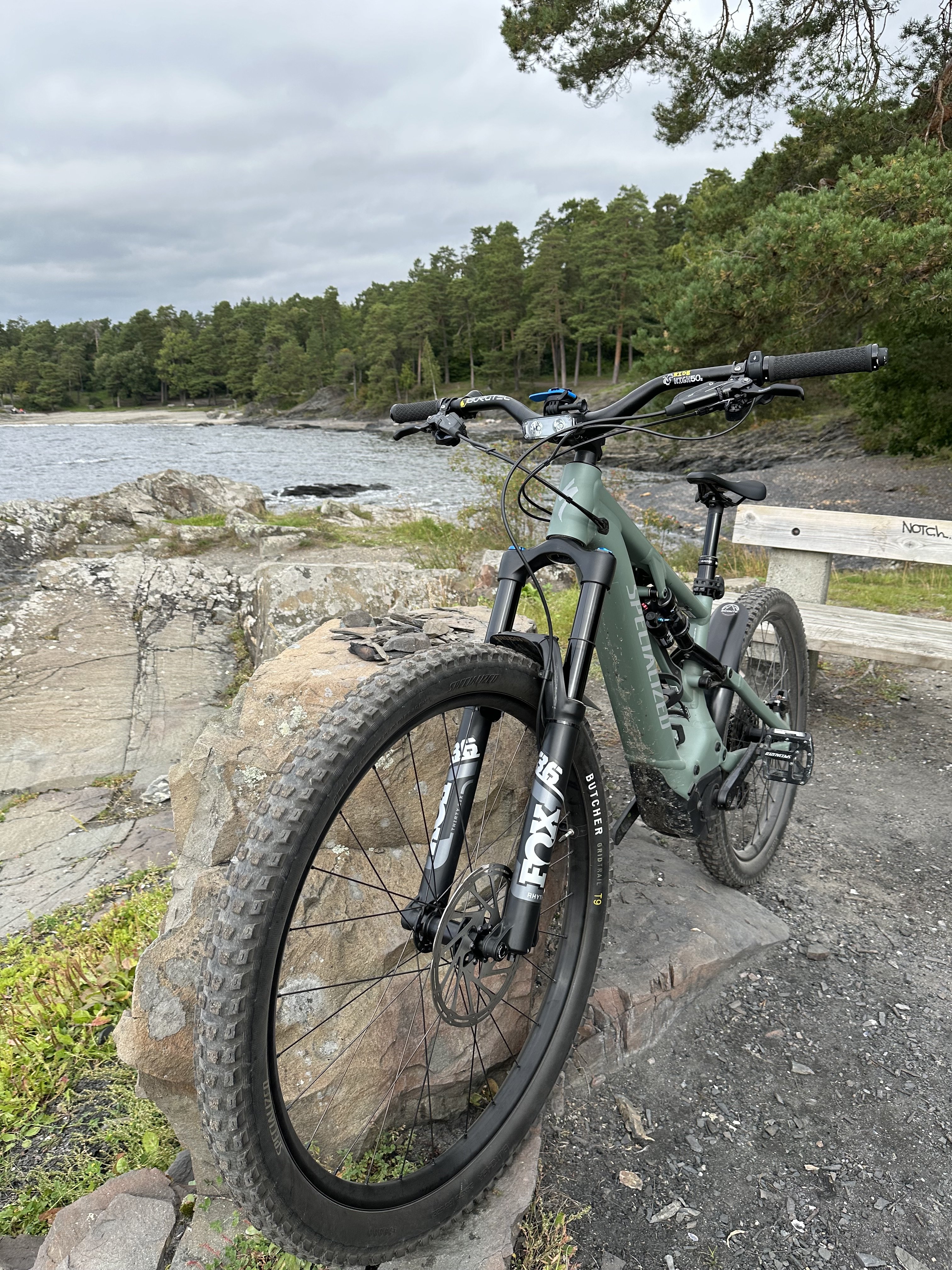

As the title says. I have a turbo levo and the specs say it’s a 35mm diameter bar. I want to get a bar with slightly more rise but All the bars I’m looking at are 31.8mm. I don’t suppose that would be a direct replacement or do I have to replace the stem as well?
If that’s not doable does anyone have a link to a good 35mm riser bar/brand?
Burgtec ride high 50mm

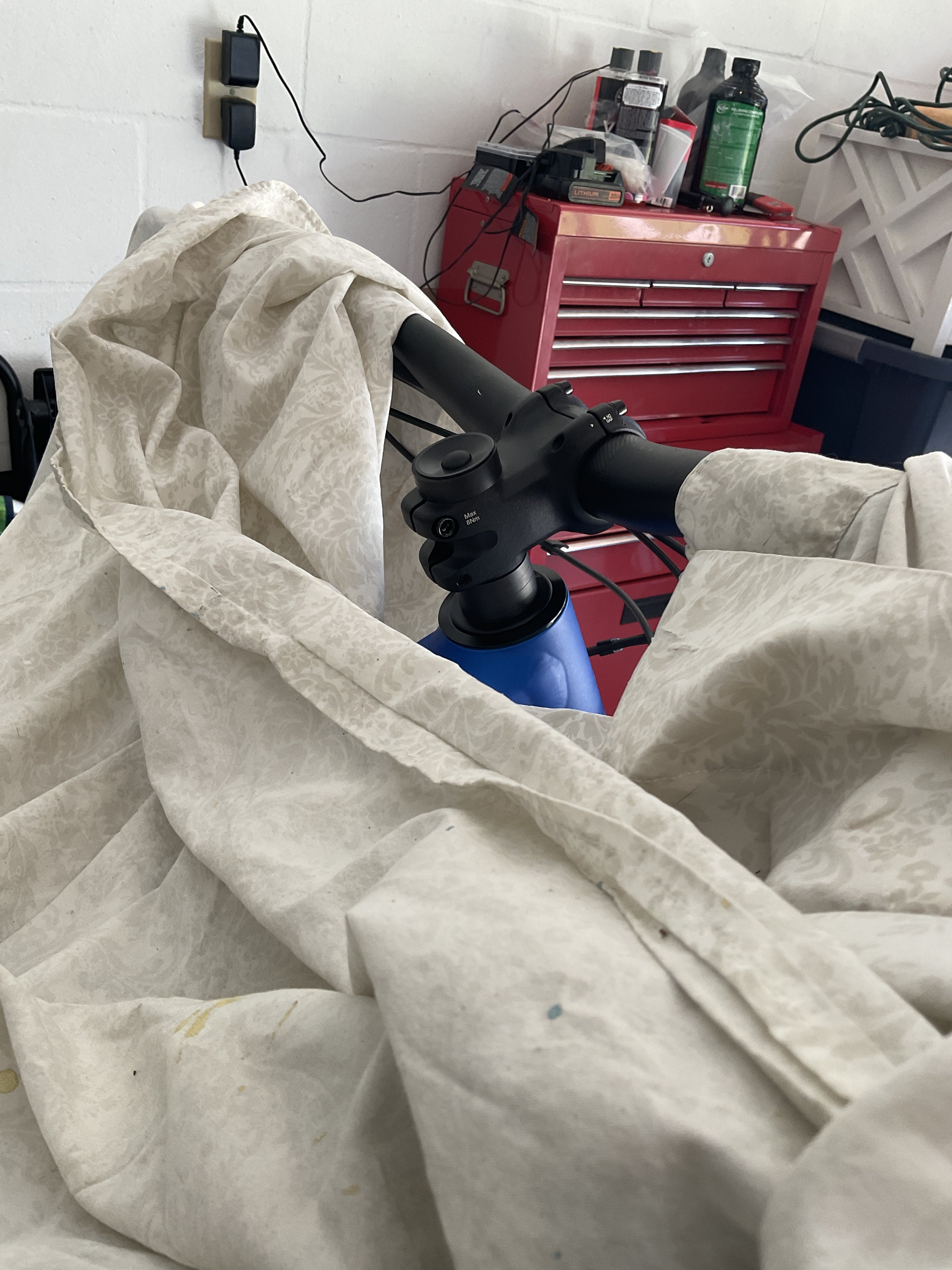

Sorry. I’m the noobiest noob in noobville. What do you mean Maxed on spacers? On the stem?
Why did you want change the rise of your bars in the first place? Spacers (shown in RED) adjust the placement/height of the stem which holds the bars on the steer tube. You may have extra spacers above the stem (you always need at least one spacer above the stem) which could be placed under the stem to get a little more height if that is what you are looking for.
If you are feeling too much pressure on your wrists maybe a bike fitting is a good idea as putting bars with TOO much rise can be difficult to ride.

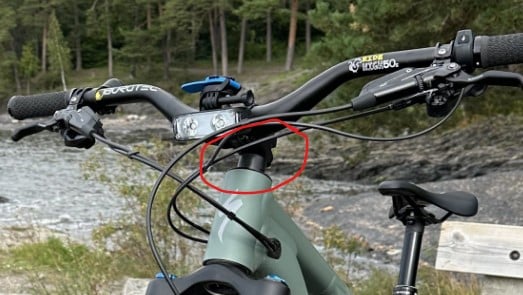

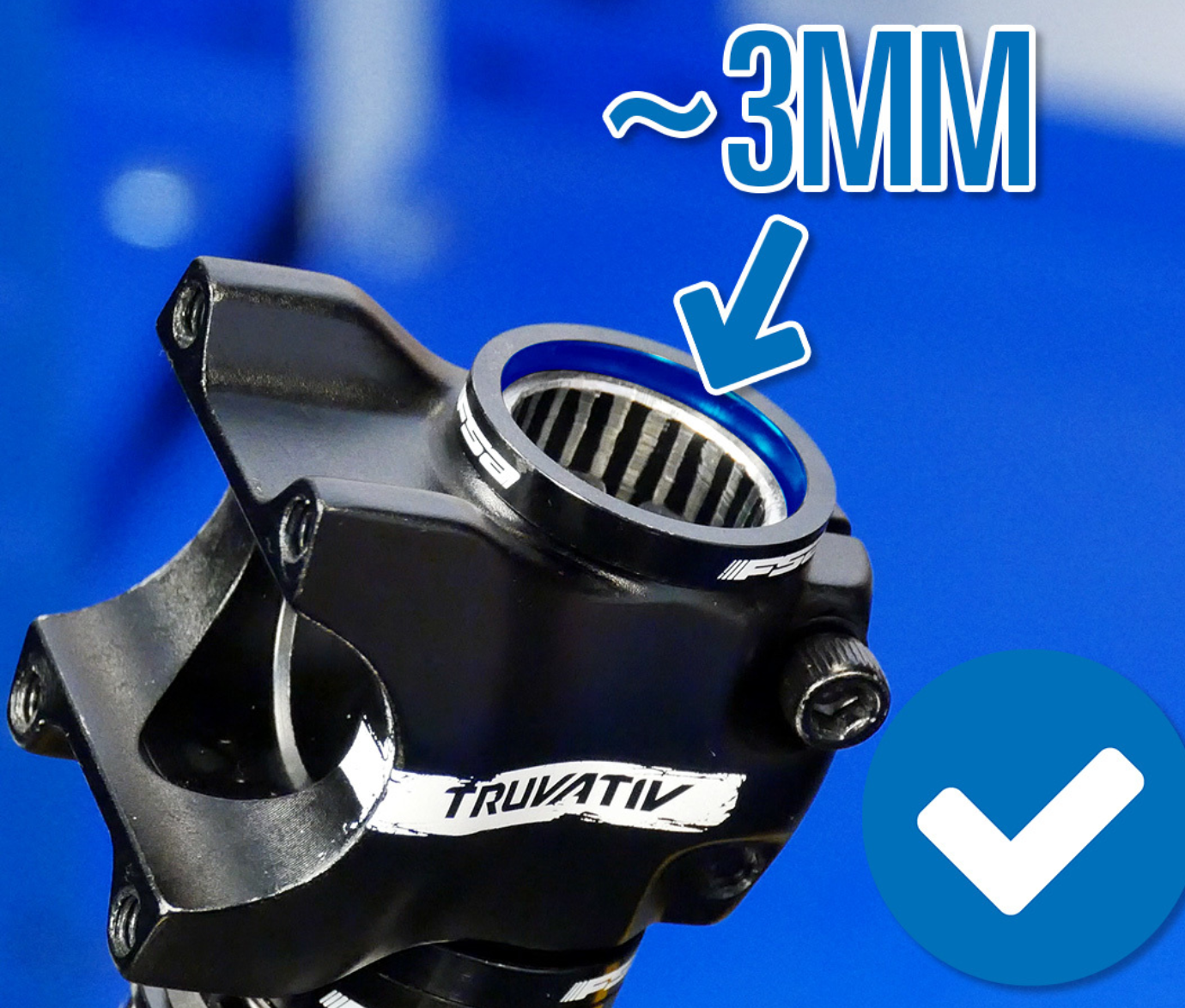

@force11111, I've replaced stems and bars on my ebikes a few times. While you can adjust stem height by using different spacers above and below (the stem) to your personal preference, always make sure to leave a ~3mm gap between top of steering tube and top cap.
It is also recommended to have a 5mm spacer above the stem and not to exceed ~50mm of spacers below the stem.
Take a look at the photo below. It should look like this.

Yep!

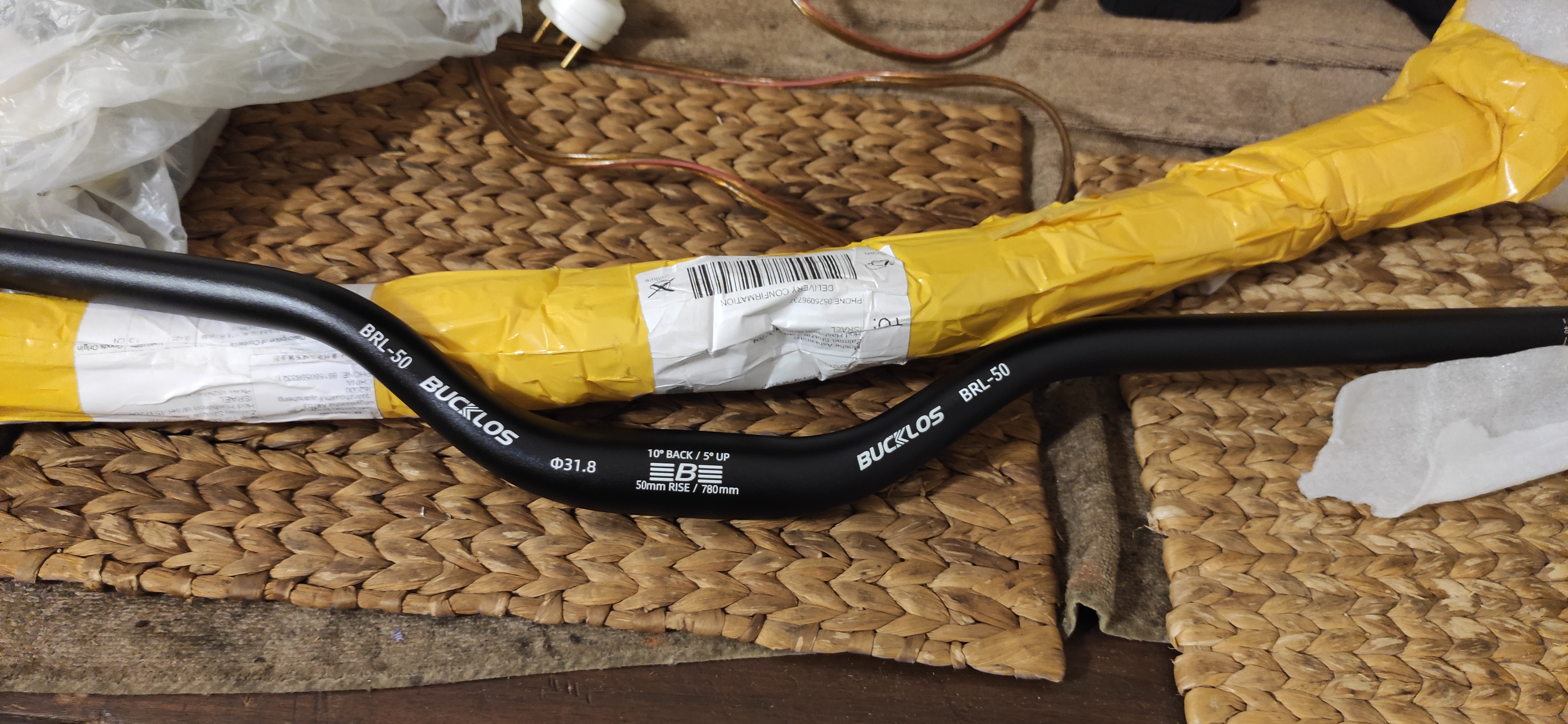

I used these last year to install a set of Renthal 31.8 bars I already had on my 35mm stem to get more rise. It was only going to be temporary but really like the way the bars ride so have left them on. I haven’t had any issues. YMMV
